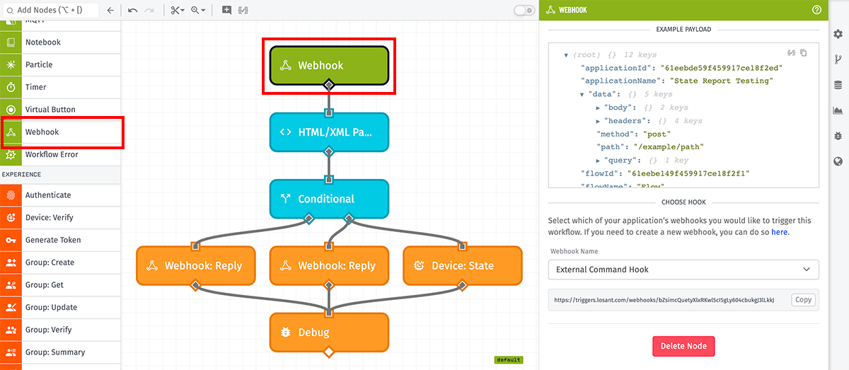

Webhook Trigger
The Webhook Trigger takes a single configuration property: the webhook for which the workflow should trigger when an HTTP request or WebSocket event is received. After choosing a webhook, the webhook's URL will appear below the selector.
In the above example, the workflow will be triggered whenever the "External Command Hook" webhook receives a request.
