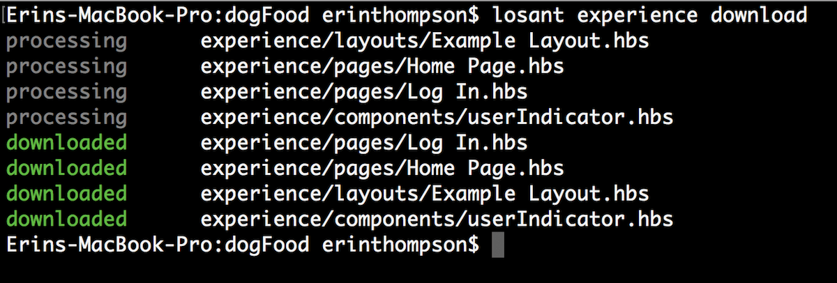

Download
Usage: losant experience download [options] [pattern]
The download command is used to download your experience and to resolve conflicts between your local experience views and your Application's (remote) experience views. When you download a view the name of the file is the name of the view. To start a download run losant experience download. The pattern options allows you to limit the download by matching on the name of the views, e.g. 'error*' means download an experience view who's name begins with error.

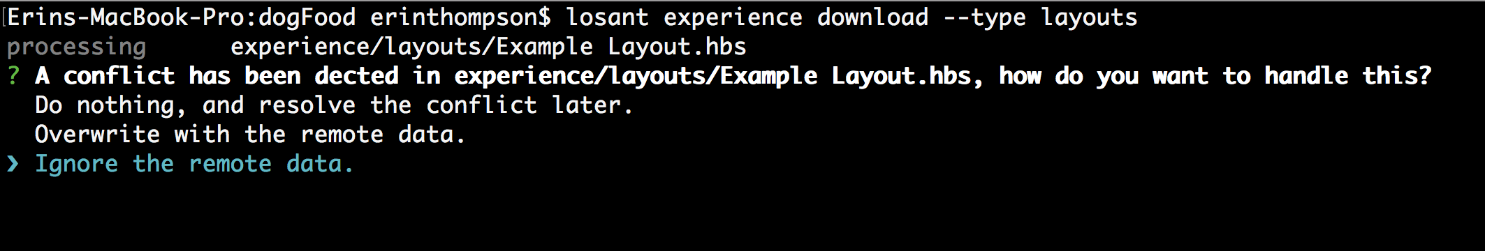

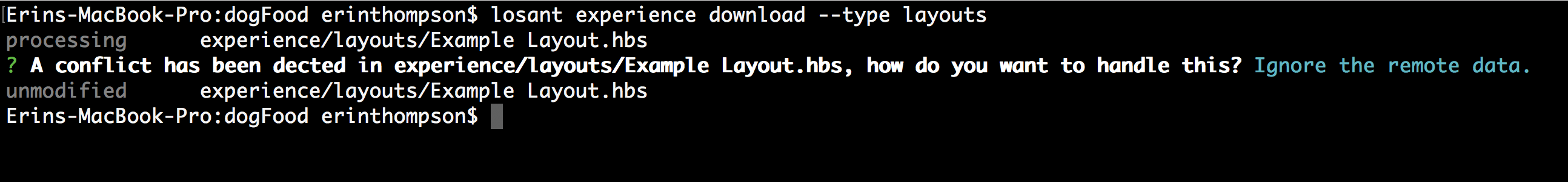

If you have conflicts (which can be seen when running losant experience status) when you try to download you can resolve your conflicts. When a conflict is detected for a file you will be prompted to choose one of three options. They are the following:
  • Do nothing, and resolve the conflict later. - resolve the conflicts yourself meaning you will update both the remote and your local copy to get back into a non-conflicting state.
  • Overwrite with the remote data. - use the data from the remote experience view
  • Pull remote data, and apply my local changes. - this will download remote data but keep any file that has changes the same.
Download Resolve Conflicts
Download Resolved Conflicts

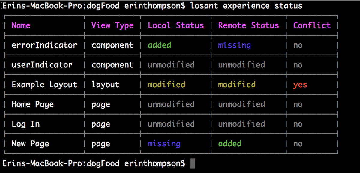

Status
Usage: losant experience status
The status command prints a table for each experience view indicating the status locally, remotely and whether they are conflicting. This command will tell you if you have added views locally, or you need to download new views from your Application, or any modifications have been made to a view either locally or remotely.
Experience Status

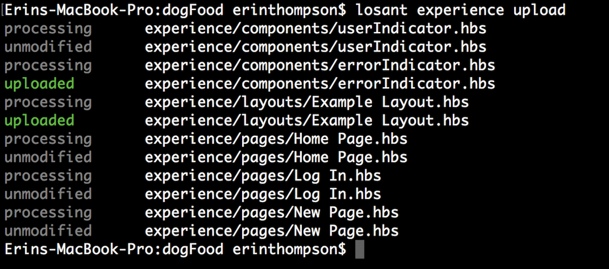

Upload
Usage: losant experience upload [options] [pattern]
The upload command pushes any changes from your local experience views to the remote experience views. If you run this command and any uploads are found to be in conflict (unless the force option is set) that will halt the upload until conflicts are fixed.
Upload has the following options:
  • -f, --force force all changes by ignoring modification checking
  • --dry-run display actions but do not perform them
  • --type <viewType> the type of experience view you want to upload e.g. layouts, pages or components
Upload Experience

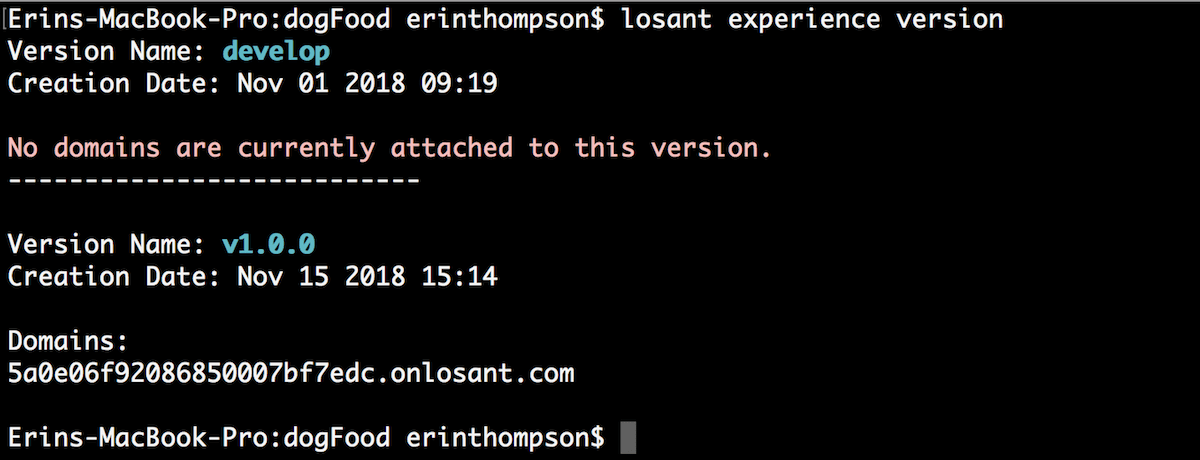

If you run losant experience version it will print a list of all your current versions, and the domains or slugs that are pointed to that version.
Version List
If you run losant experience version v1.0.0, then it will try to create a new version with the name v1.0.0 and you will be prompted to choose domains and slugs that you want to point to that new version.

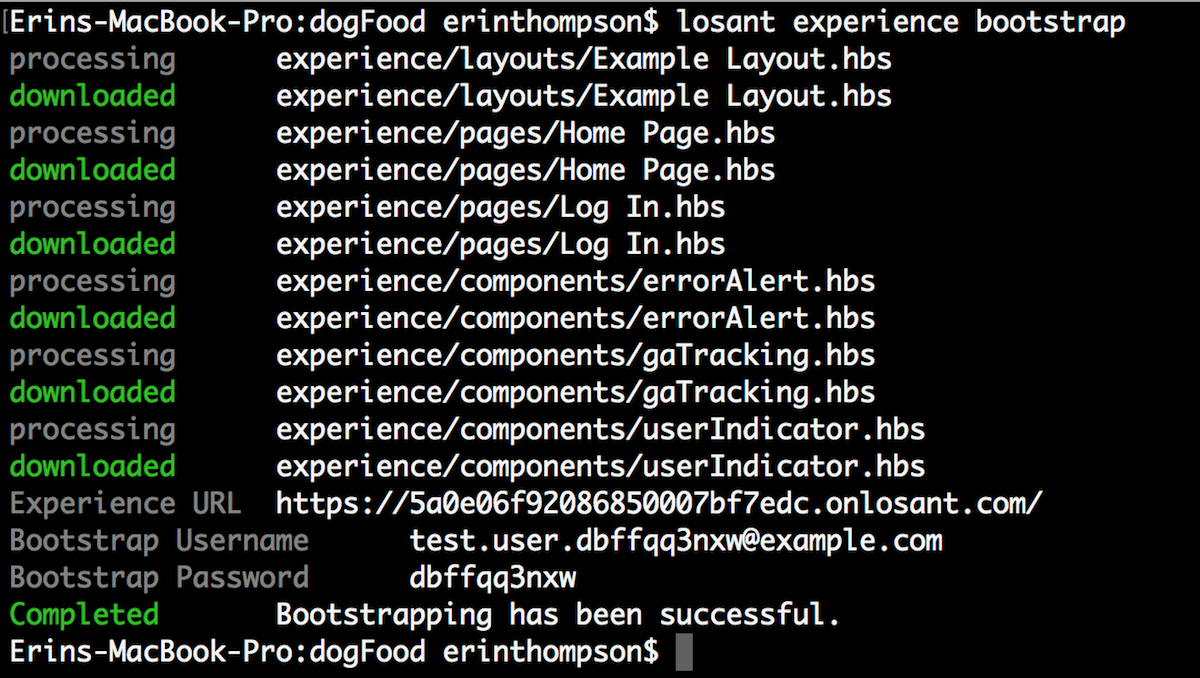

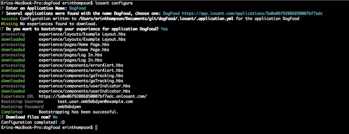

Bootstrap
Usage: losant experience bootstrap
The bootstrap command will build starter layouts, routes, workflows, users and user groups to get you started on your Experience. You can only bootstrap your Experience once.
If you run losant experience bootstrap, it will automatically download all of your newly created views, prints out the email, and password of a generated user and gives you a link to your new Experience.
Bootstrap
This is also a new prompt when running the losant configure command. After you have selected the Application, if that Application does not have an Experience then you will have the option to bootstrap.
If you run losant configure and do not have an experience you will see the following:
Bootstrap On Configure
