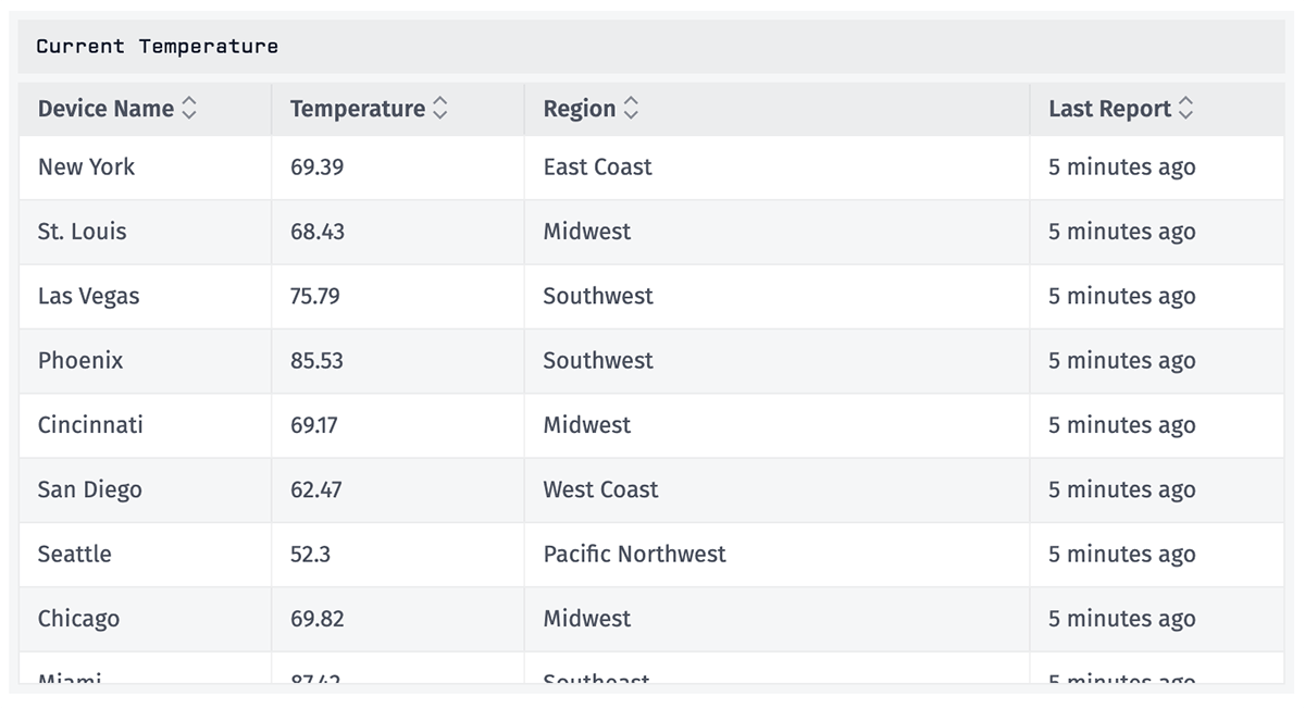

The Device State Table allows you to display attribute data from one or more devices.
Device State Table
Configuration for the Device State Table takes several properties.

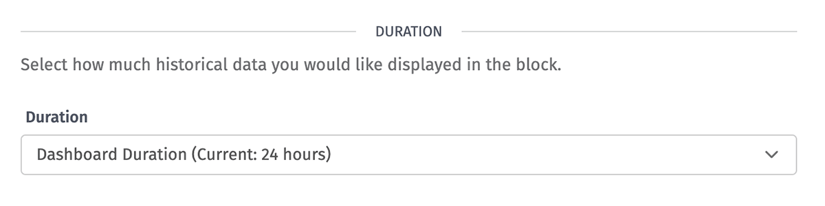

Duration
To view only the current state of your device(s), select "Last received data point". To view device states reported over a longer period, select any other option. This defaults to the global dashboard duration.
Device State Table Duration

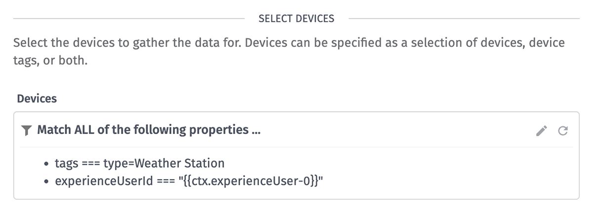

Select Devices
Here you choose which devices are queried for data for the block in the form of a device query. Each reported state for each device is given a separate row in the table, and if a duration other than "Last received data point" is selected, a device displayed only if it has state reported within the the selected duration.
Device State Table Devices

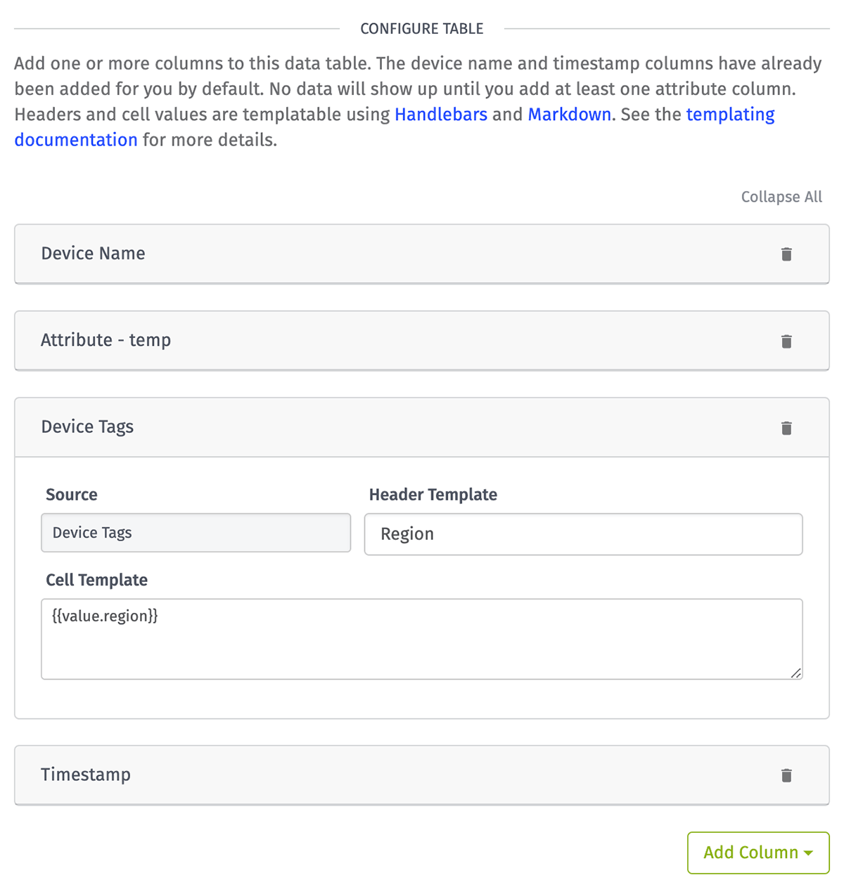

Configure Table
Once you have selected the devices, you can now configure which columns to display in the block. You may add as many columns as you would like, and columns may be rearranged by dragging and dropping the headers of each column's configuration panel.
Rendering Cells
Each column accepts a Header Template for rendering the table column header, and a Cell Template for rendering the contents of each cell in the column. Both inputs accept string templates and support limited Markdown.

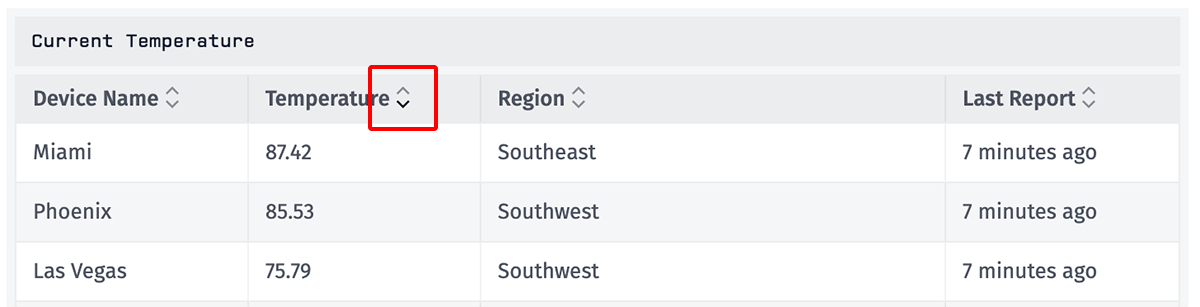

Sort Your Data
After all columns have been added to your table, you have the option of setting a default sort method from the block editing screen. In the block preview, click on a column header to select it as the default column to sort by. Click the column a second time to switch the order from ascending to descending. All columns are sortable.
When viewing the block on the dashboard, you may sort by the other columns at any time by clicking the appropriate column header. However, should you refresh the page, the block's sort order will revert to the default method that was set while editing the block.

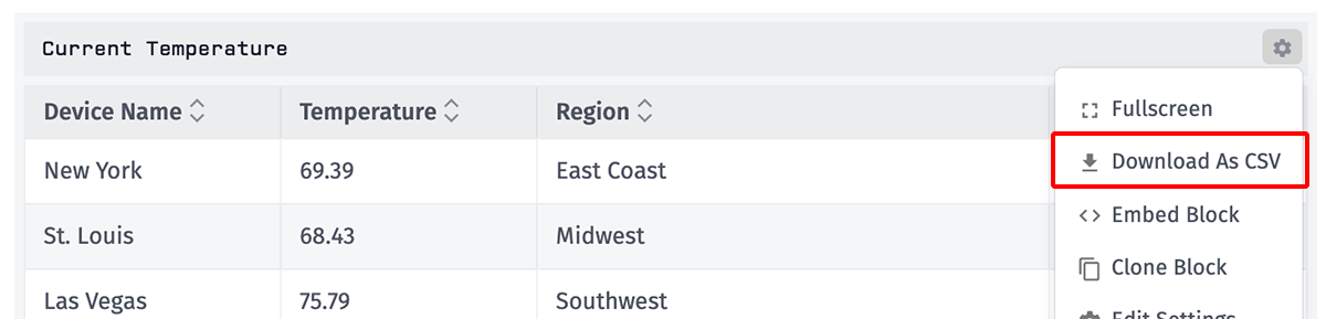

Download As CSV
You can download the contents of your table in CSV format. Click the gear icon on the top right of the table and select "Download As CSV".
Device State Table Download As CSV
Only visible columns are included in the export, and formatting rules applied to the table also apply to the exported CSV.
