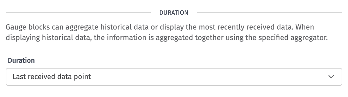

Duration
When Data Type is set to "Historical", you must also choose a duration (time range) from which to pull data for the gauge. To view current state of your device(s), select "Last received data point". To view an aggregation of your data over a given time period, choose any other value.
Gauge Duration
When "Live Stream" is selected as the Data Type, this section is not applicable and is hidden.

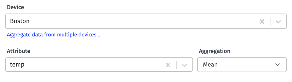

Block Data
The block data specifies the source of the raw value to render within the gauge. It takes three parameters:
Gauge Block Data
  • Device: Choose a device from which to pull data from the block. If you wish to aggregate data from multiple devices, you may instead define a device query. This may reference device ID, device tag, or experience user context variables.
  • Attribute: Select a single attribute from your device(s) whose value should be displayed in the gauge. Depending on the block's other settings, this may be limited to just number-type attributes. This may reference device attribute context variables.
  • Aggregation: Choose an aggregation method for reducing the returned data to a single data point for use within the block. Depending on the block's other settings, certain methods may not be selectable, or the aggregation may not be applicable and the input will be disabled.

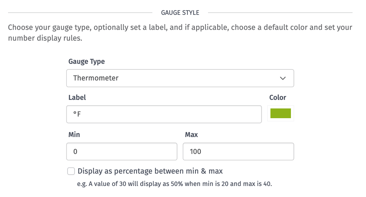

Gauge Style
Next, choose the type of gauge to display and its additional configuration options ...

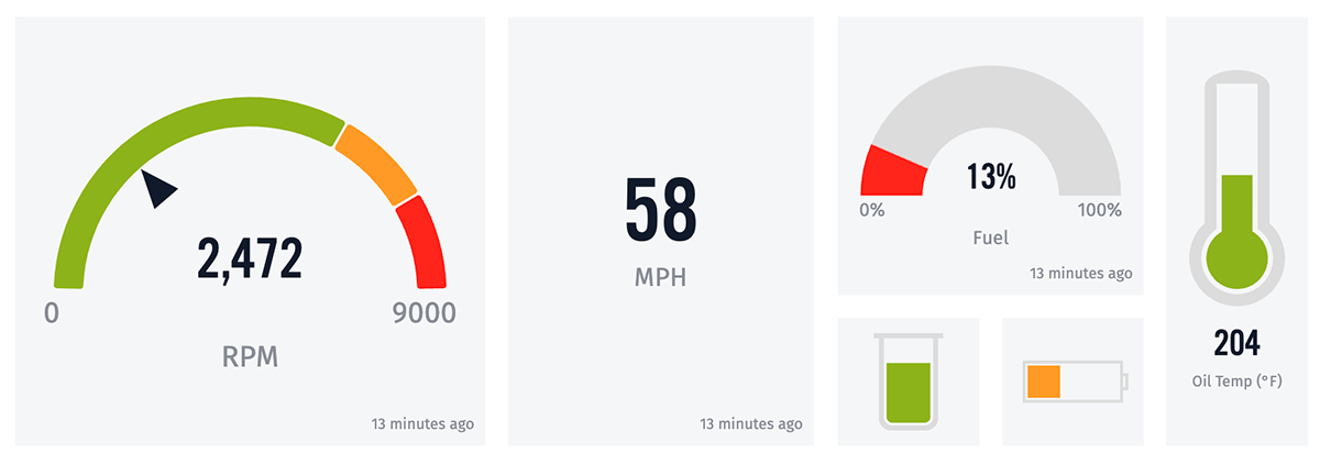

Gauge Type
  • Gauge Type: Choose one of the six available types ...
    • Number displays a value as a single number.
    • Dial displays the value along with a filled semicircular dial.
    • Battery displays the value along with a filled horizontal battery.
    • Thermometer displays the value along with a filled vertical thermometer.
    • Tank displays the value along with a filled vertical tank.
    • Needle displays the value along with a needle pointing to a color-banded arc.
  • Label: The text displayed beneath the gauge. This is templatable from your dashboard context, and the label supports limited Markdown. If not provided, no label is visible beneath the gauge.
When any Gauge Type other than "Number" is selected, additional configuration options become available:
  • Color: The default color of the gauge's fill section. This can be conditionally overridden based on the gauge's value. (Color is not applicable for "Needle" gauge types.)
  • Min: The lower boundary of the gauge's fill area. This value must be a string template or a number less than Max.
  • Max: The upper boundary of the gauge's fill area. This value must be a string template or a number greater than Min.
  • Display as percentage between min & max: Optionally, choose to display the gauge's min and max boundaries and value as percentages instead of raw numbers.
Min and Max are templatable from your dashboard's number-type context; when using templates, if the resolved value(s) causes the Min to be greater than the Max, the gauge will revert to a Min of 0 and a Max of 100.
Values that go above or below the resolved Min or Max will continue to display in the gauge, but the gauge itself will either be empty or full, depending on if the value falls below the Min or exceeds the Max, respectively.

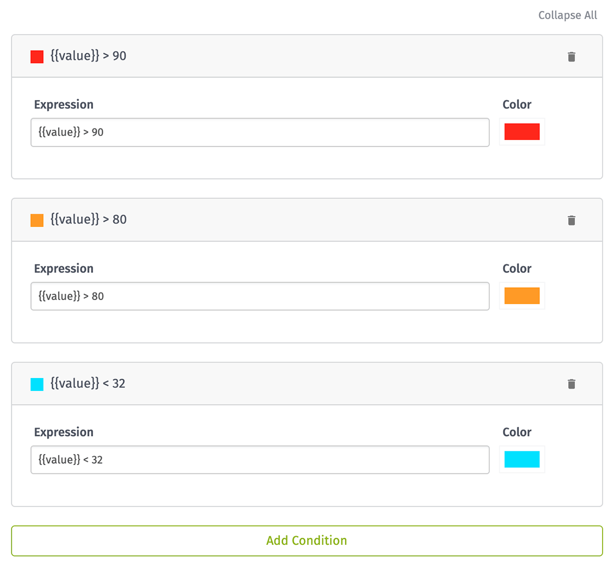

Conditional Gauge Colors
If the Gauge Type is set to anything but "Number" or "Needle", you may optionally create a list of conditions that change the color of the gauge depending on the query's returned value. This works similarly to the Indicator Block, in that the first expression that returns truthy determines the gauge's color. If none of them return truthy, the default color set in the Gauge Style will be the gauge's color.
Gauge Block Conditions
The conditions can be arranged via drag-and-drop to set their priority relative to one another. The following variables are available when writing the expressions:
  • {{value}}: The result of the query's data transformation expression if one is applied; if not, the raw numeric value returned from the query.
  • {{percent}}: The percentage that {{value}} represents when compared against the minimum and maximum values set in the dial gauge configuration. For example, given a minimum of 10 and a maximum of 50, when {{value}} is equal to 40, the corresponding {{percent}} is 75.
  • {{ctx.VARIABLE_NAME}}: The value of a given context variable.

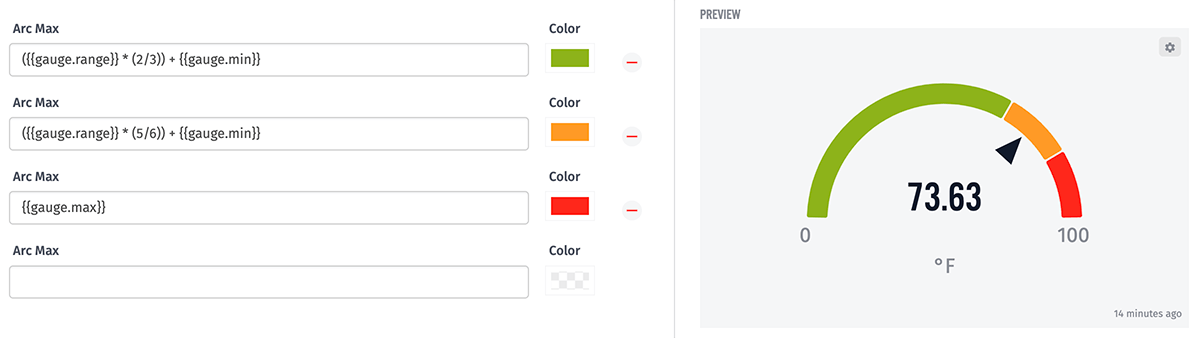

Needle Arc Ranges
For "Needle" gauges, you may optionally define color ranges for the sections of the arc (akin to "OK", "Warning", and "Danger" levels in a real-world gauge). For each arc, you must provide ...
  • Arc Max: An expression that resolves to a number for the maximum limit of the arc. The resolved Arc Max must be ...
    • Greater than the previous Arc Max, if applicable.
    • Greater than the gauge's Min.
    • Less than or equal to the gauge's Max.
  • Color: The color for this section of the arc.
Gauge Block Needle Arcs
Each Arc Max is templatable, with the following values available as context:
  • {{ctx.VARIABLE_NAME}} - Value of a given context variable.
  • {{gauge.min}} - Resolved minimum gauge value.
  • {{gauge.max}} - Resolved maximum gauge value.
  • {{gauge.range}} - Equal to {{gauge.max}} - {{gauge.min}}.
If any Arc Max resolves to an invalid value, the arcs revert to an uncolored state.
