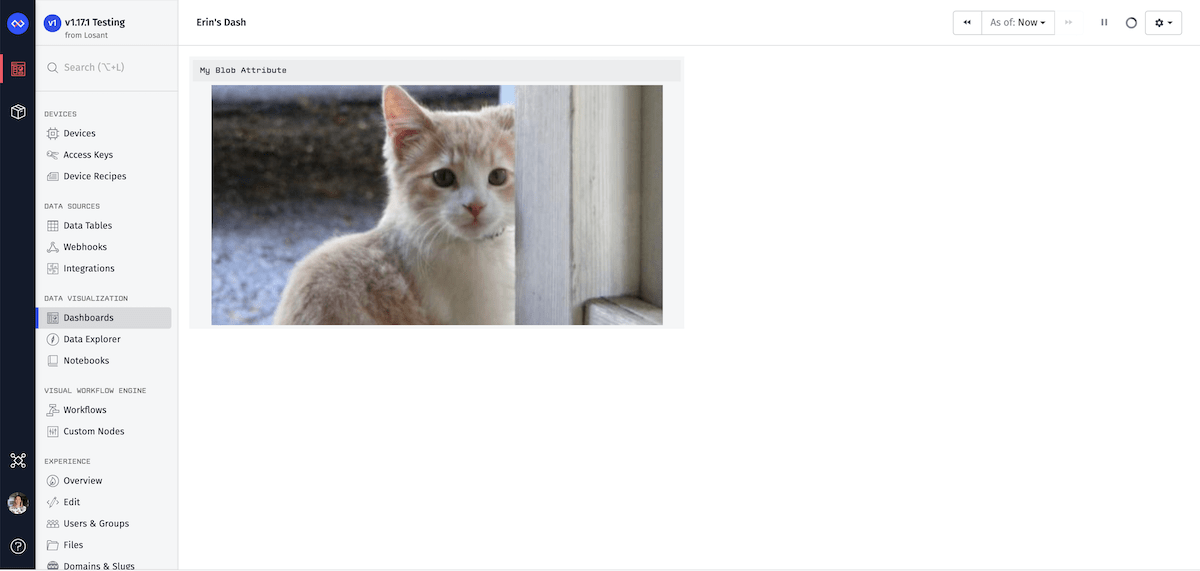

While storing Blobs that represent images, you may use them in the Image Block or the Custom HTML Block within a dashboard. For example, this allows for your dashboard to display the most recent image of a device.

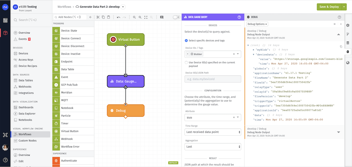

The following is an example Signed URL payload of a device state from the Data Gauge Query:
"data" : {
"result": {
"value": "https://storage.googleapis.com/losant-blob/5ea05725a2efcc00077a81d1/5ea057fc848d990006aceae9/blob/1588017908000-44221a392685cefc91513cfbdea1fbd8.jpeg?GoogleAccessId=data-export%40structure-1104.iam.gserviceaccount.com&Expires=1588104310&Signature=X%2FiIWMGwykuqmG9d57Kb%2Fz8s%2BFvnH4Xuq58%2BR2ekrC5CpBIWhrUYOBK4LrUjDuBNGn2IdsuhcKKJ4iPAO3PCEaj6avmwbn9TsePkwhhmmJiJeYHbe3IGMG3XdQUDauffIqUtaOpjP7oE8ddXAhJNm%2F43ekDIsiiqJOSt%2F3Fc94GBeAMaich6w40w%2FrAWlP6rlkAODQQxOftU8JmZesV65sR3g4hClfYntodFpAF9Ks4sCpjorhH2M79ceTVvnf4DtS00zzpII7iBKmbYU4d7fxqoUwlPqOApmnftaLoYgL%2Fnkp8dkKYq%2FDmEVfmg0uYw%3D%3D&response-content-disposition=attachment%3B%20filename%3D%221588017908000-44221a392685cefc91513cfbdea1fbd8.jpeg%22",
"time": <Timestamp of the reported state>
"time": <Optional Timestamp>,
"flowVersion": <Optional Workflow Version Name>
For a Data Gauge Query, you get a Signed URL because the data has already been saved and you can download the file using the HTTP node on the workflow.

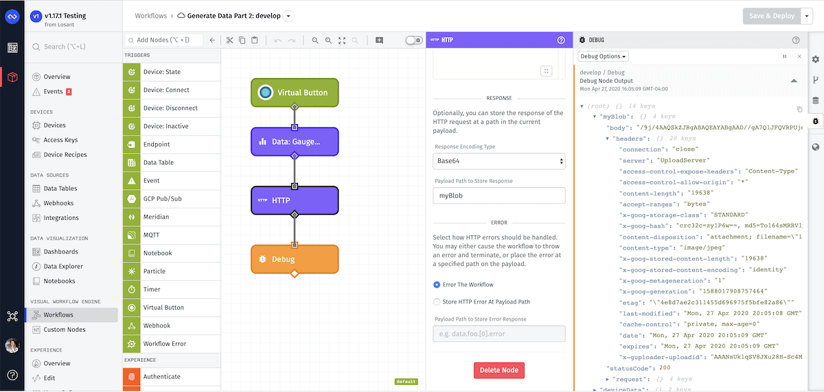

Downloading within a Workflow
Downloading the Blob Data from a Signed URL within a workflow can be accomplished with the HTTP Node.
The most important field to set is the "Response Encoding Type" to Base64
. Then the Blob Data will be within the body
of the response.

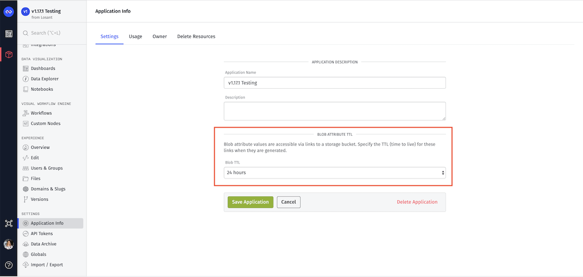

Signed URL TTL
Signed URLs don't last forever. The time to live for the Signed URL is configurable on an application level.
To update the Blob Attribute TTL:
- From the Application Menu, navigate to the "Application Info" page.
- Select "Blob Attribute TTL".
The maximum time a Signed URL can live is a week and the shortest is an hour. The default for each application is 24 hours.

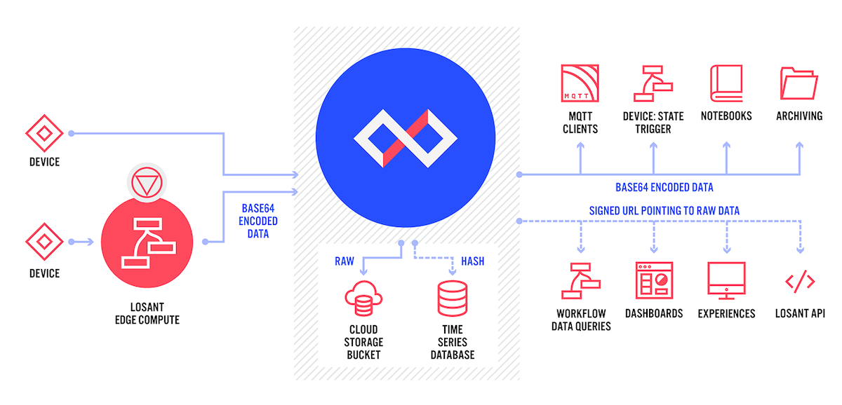

Raw Data
Raw data is the original base64 state data that was reported.
The following is an example of a payload on a Device State Trigger:
"data" : {
"blob_attribute": "/9j/4AAQSkZJRgABAQEAYABgAAD//gA7Q1JFQVRPUjogZ2===",
The Device State Trigger gets the raw data, allowing you to analyze the data as it is coming into Losant.
The following resources allow you to utilize the raw base64 encoded data:
- Notebooks
- Device State Trigger
- Archiving
- Device Exports (when selecting "Include blob data inline in the export")
