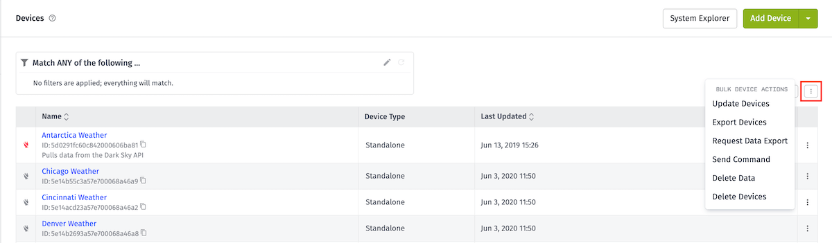

Bulk Device Actions
Bulk device actions provide an easy way to perform a number of actions on multiple devices at once. Access to all bulk action options can be found in the "Bulk Device Actions" menu on the Devices page in the application.
Bulk Device Actions Menu

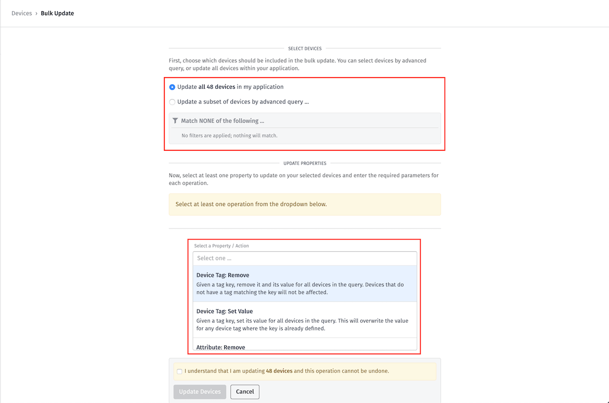

Update Devices
You may provide one or more update operations to perform on multiple devices in a single request by choosing "Update Devices" from the device list dropdown menu.
Update Devices
Select Devices
First, select the devices to update in the "Select Devices" section. Select either "Update all devices in the application" or choose to query a subset of devices. By default, the bulk-update device query matches the query applied to the Devices List when the "Update Devices" option was selected. Confirm the number of devices being updated at the bottom of the page before submitting the form.
Configure Operations
Once the devices to be updated have been selected, choose at least one operation to perform on those devices in the "Update Properties" section. Details of each available operation are listed below.
Note: Some operations may only be applied once per bulk update request - for example, Device Class: Set. Similarly, some operations cannot be applied to a property / attribute if a previous operation is applied to the same property / attribute. For example, an Attribute: Remove operation targeting a "temperature" attribute canot be followed by an Attribute: Rename operation also targeting a "temperature" attribute.

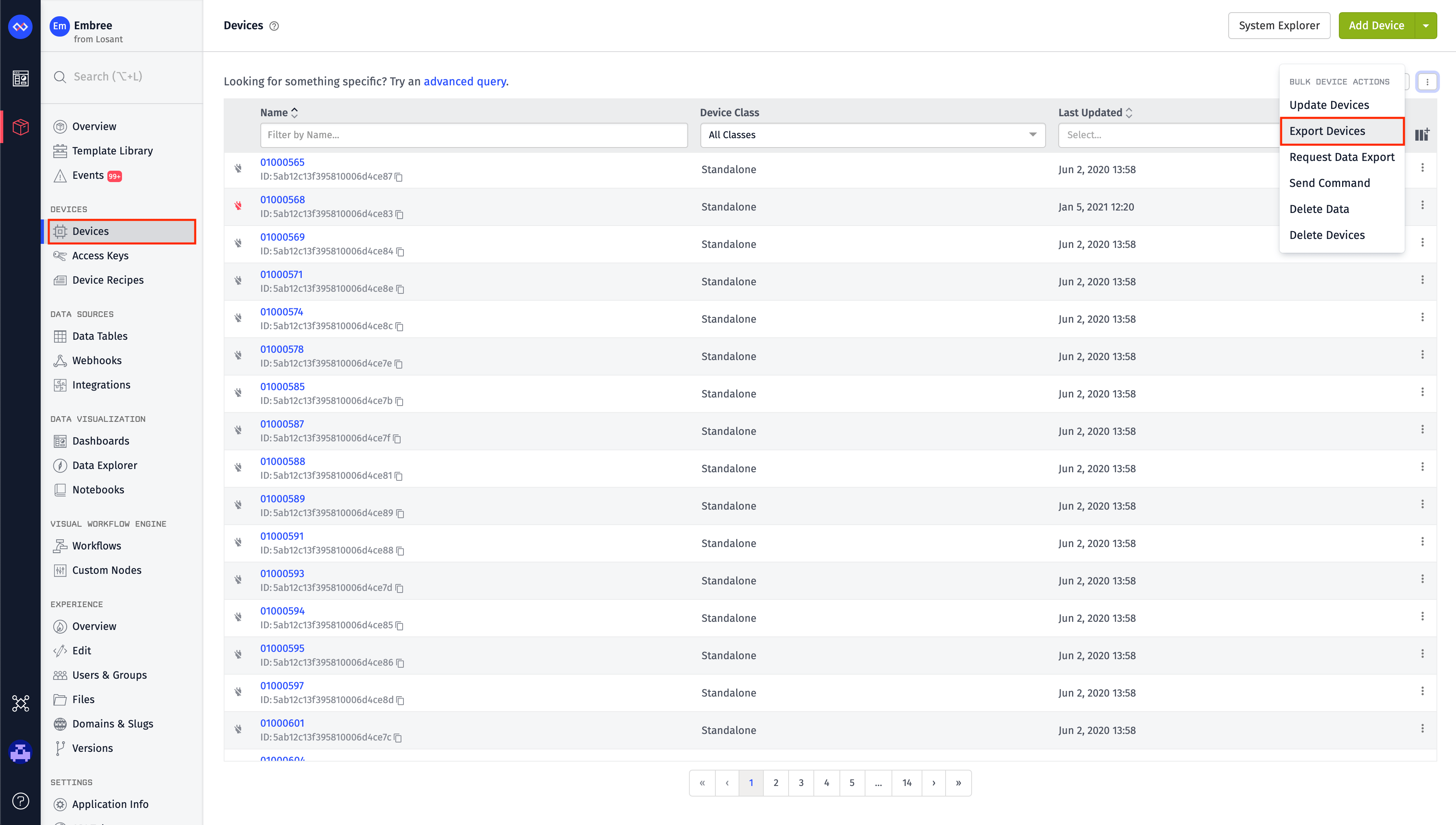

Export Devices
Export Devices
To export a list of application's devices, select the "Export Devices" item from the "Bulk Device Actions" dropdown menu in the top right corner of the list. Then, enter an email address and/or a callback URL for where to send the resulting export file. You may choose to export the device metadata in either a CSV format or in a JSON format.
Note: Device exports filter devices based on the advanced query applied to the devices list. To export a different set of devices, update the query applied to the table behind the modal.
