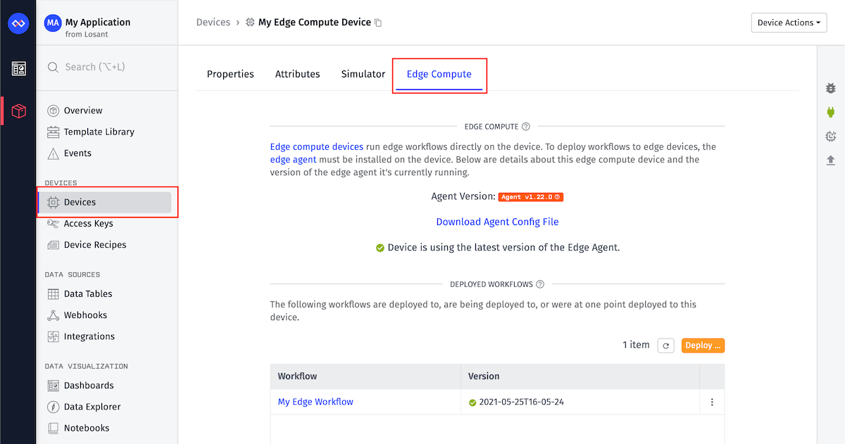

Managing Per Device
Device Edge Deployments
After selecting a device from your device list, click "Edge Compute" or "Embedded" (depending on the class of device selected) in the device's tabbed navigation. This will bring you to a page where you can view the agent version currently deployed to the device, as well as a list of all workflows deployed to the device and their version status.
Creating New Per-Device Deployments
To create a new device deployment, click the "Deploy" button at the top right of the table in the "Deployed Workflows" section. A dialog will appear that will allow you to select a workflow, and then select an existing version of that workflow to deploy to this device. If you choose a workflow that is already deployed (or is scheduled to be deployed) to the device, you will have the option of changing the version of the workflow to use as if you had clicked the "Settings" icon for that workflow in the list below the button.

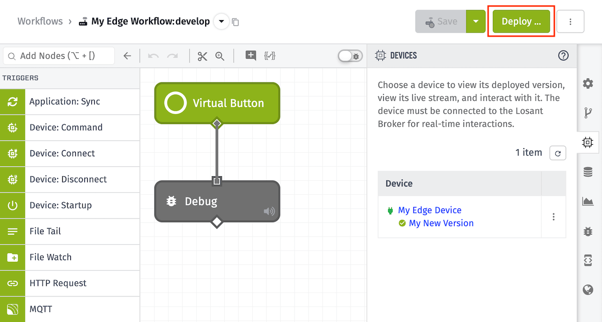

Managing Per Workflow
Workflow Edge Deployments
You can manage workflow deployments right from the workflow editor. You may view all current deployments of the workflow you're viewing in the "Devices" tab on the right side panel in the editor.

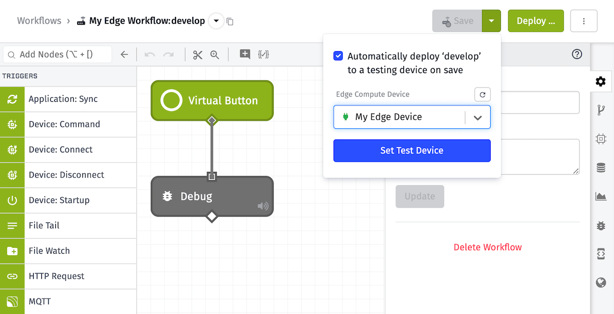

Setting a Workflow Test Device
Edge workflows have a unique feature that allows for a test device to be configured if the workflow and device both utilize GEA version 1.39.0 or greater. When there is a test device for a workflow, any saved changes to the "develop" version will be automatically deployed to that device. This method of testing as you iterate over your workflow will save you from needing to create a new version to deploy when you want to test a change.
Workflow Edge Test Device
To deploy the "develop" version of a workflow to a single device for testing, click on the down arrow button on the right side of the "Save" button. When the workflow meets the minimum GEA version requirement, the dropdown will contain a short form for configuring a test device.
It is required to check the box acknowledging that "develop" will be automatically deployed to the testing device on save. Once that field is satisfied, the device dropdown will become enabled and you can choose which of your edge devices to use as the test device.
If the edge device selected in the form already has a version of the workflow running on it, the form will require you to acknowledge that the version will be removed and replaced with the "develop" version of the workflow.
Creating New Per-Workflow Deployments
To create a new deployment from a workflow, click the "Deploy ..." button next to the "Save" button in the top right corner of the workflow editor. A dialog will appear that will allow you to roll out a deployment of the workflow version you are currently viewing. Select the devices using a device query (by name and/or by tag).

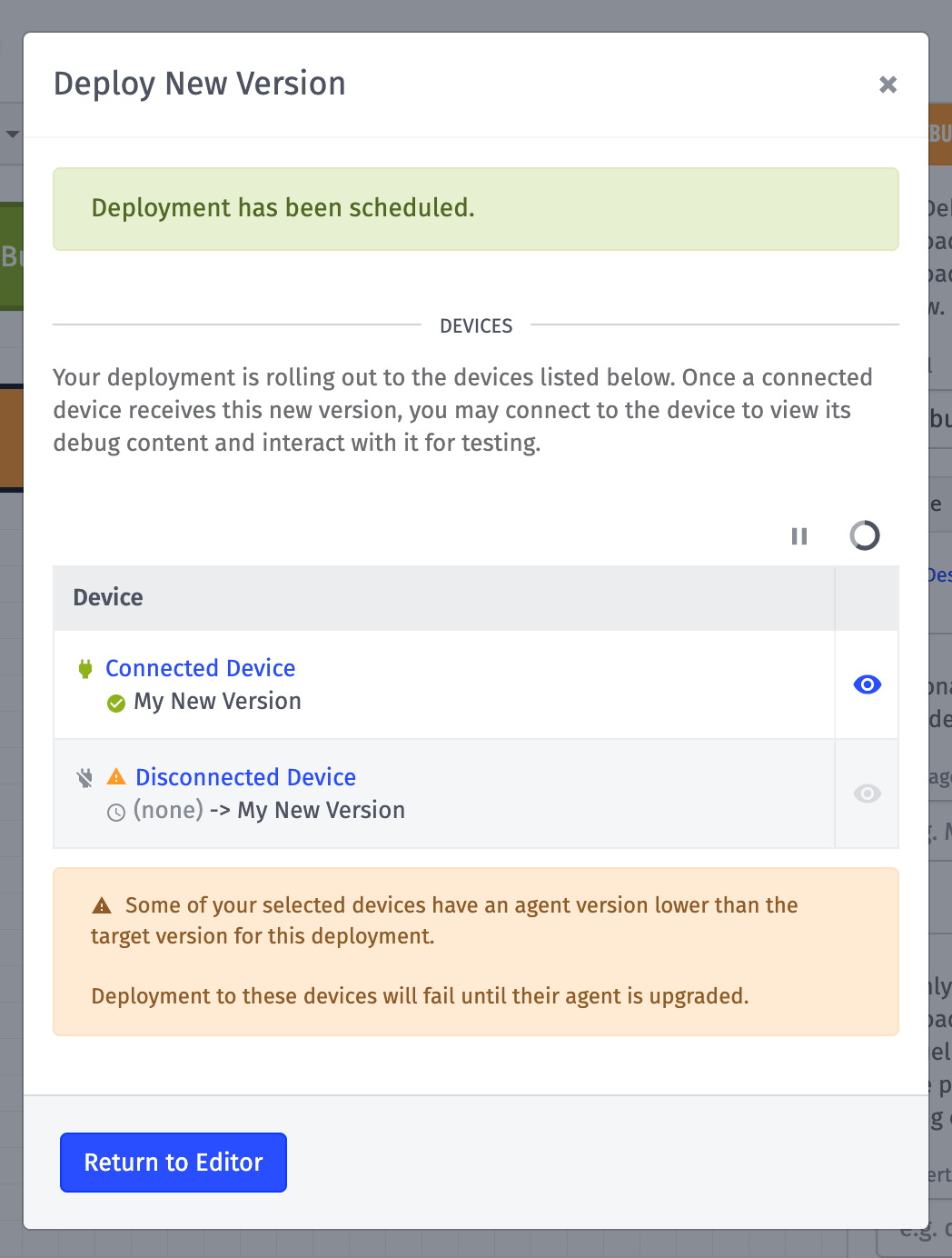

When selecting your devices, you will also be presented with a preview of the devices matching your query, including their current deployment status for the selected workflow. If the version you are deploying is incompatible with the agent version on a device, the preview table will warn you of the issue; however, you will still be allowed to proceed with the deployment.
After you press "Deploy Version," the dialog will change to show the deployment status of each device:
Workflow Post Deployment
For each new deployment that is up to date, you may view the Live Look by clicking the eye icon next to the selected deployment. Live look is enabled for a deployment if the icon is blue; otherwise, the icon will be grayed out and disabled. Note that some deployments may take longer to actually deploy to the device—the list of deployments will update every 5 seconds to stay current.

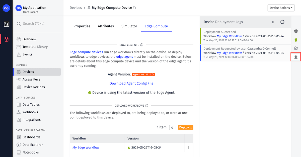

Deployment Logs
The per-device deployment manager has a "Device Deployment Logs" tab in which you can see a list of scheduled, succeeded, and failed deployments for that device. This list allows you to see who scheduled a deployment, if scheduled deployments were overridden by later deployments, and if any deployment failed, why the error occurred.
