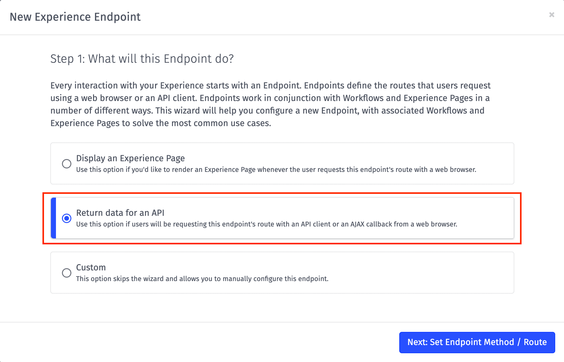

Let's create a Steaming Endpoint by configuring an endpoint with a GET method and "No Static Reply". We can do this using the Experience Endpoint wizard:
First, we select "Return data for an API":
Experience Endpoint Wizard Return Data

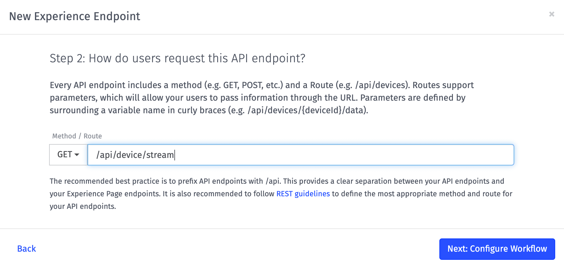

Next, we select "GET" as the method and we name the endpoint /api/device/stream.
SSE Experience Endpoint Wizard Get
For the rest of the wizard leave all the other options as default. If you chose to make your route authenticated, you must have a valid Experience User logged in for the Streaming Endpoint to work.

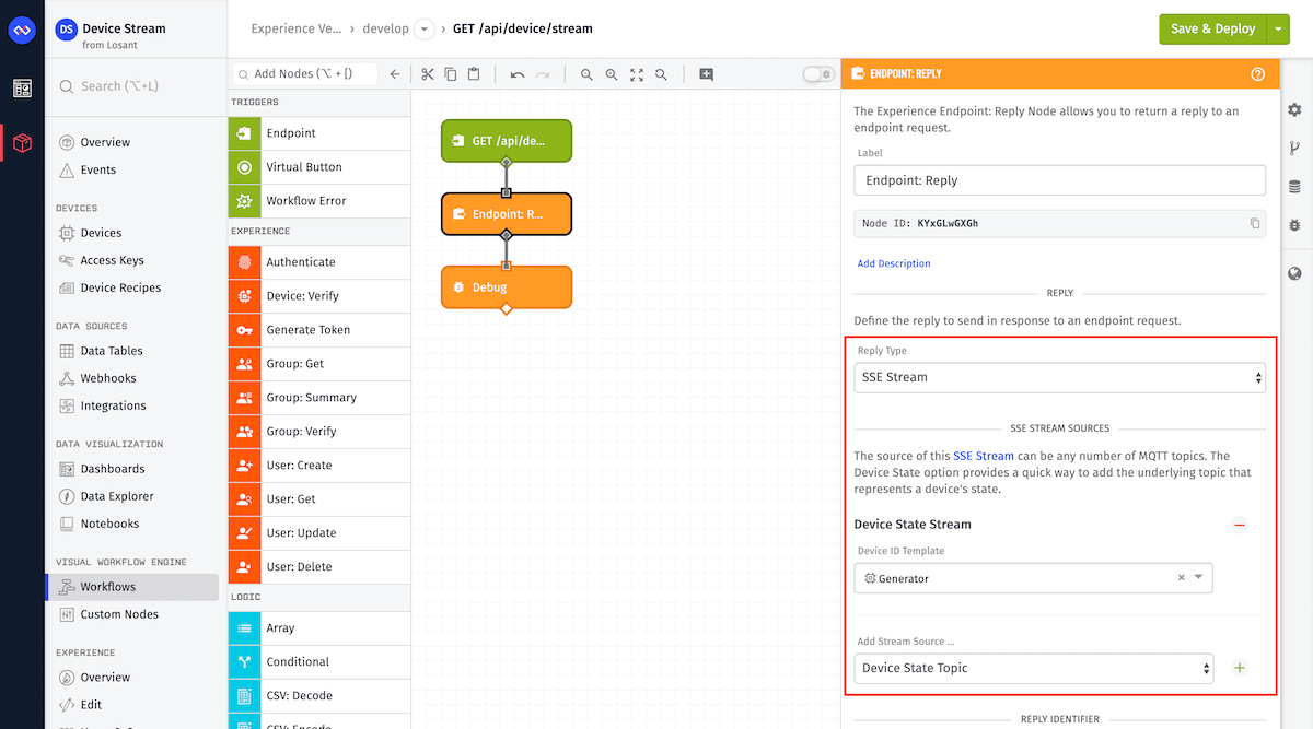

The Experience Endpoint wizard will create the Experience Workflow for this Endpoint, but we'll need to edit the Endpoint Reply Node in the workflow.
SSE Example Workflow
  1. Under the "Reply" configuration select the Reply Type of "SSE Stream".
  2. Choose "Individual Topics as the Topic Source.
  3. Select the default "Device State Topic" as the "Stream Source".
  4. Select a device that reports state on a regular interval under for the "Device ID Template".
We are now ready to access this endpoint from a web interface.

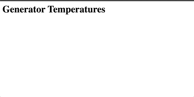

Here is the Experience Page output:
SSE Example Generator Temperatures
