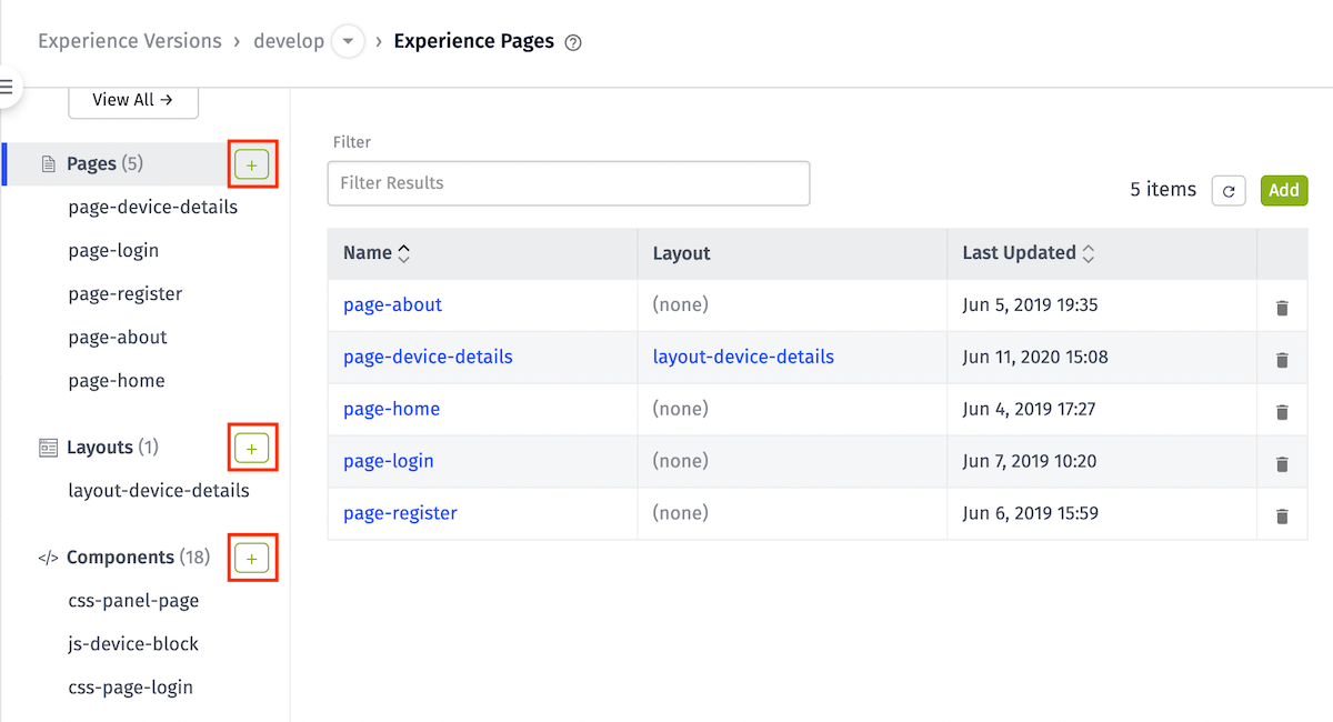

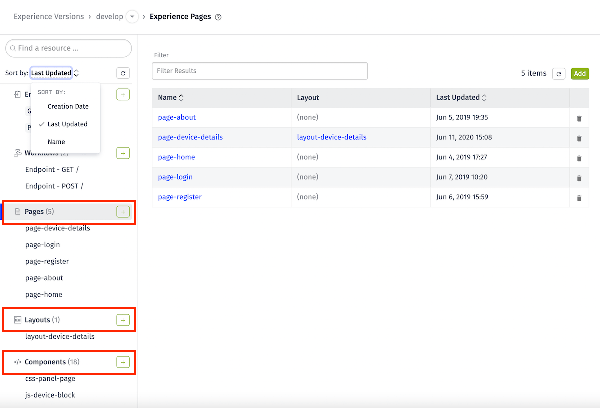

Viewing Experience Views
Experience Views List
Views are versioned resources, so you must first choose one of your Experience Versions. (You may reach your application's "develop" version by clicking the "Edit" link in the sub-navigation.) After doing so, a list of your Experience Views is accessible in the left column tree view, categorized by type. This list is filterable and sortable using the tools at the top of the column. Clicking the view type folder will also display all views of the chosen type in a table view.
To view or edit the contents of an Experience View, click the name of the view in the left column tree view or within the view's table.

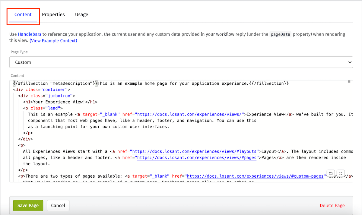

Editing an Experience View
After creating the view, you will be redirected to its "Content" tab, where you may enter the HTML and Handlebars templates that make up the view - or, in the case of Dashboard Pages, the properties of the dashboard to render.
There are special notes to consider when providing content for the different page types; refer to the documentation below for more info on Layouts, Pages, and Components.
View Content Tab

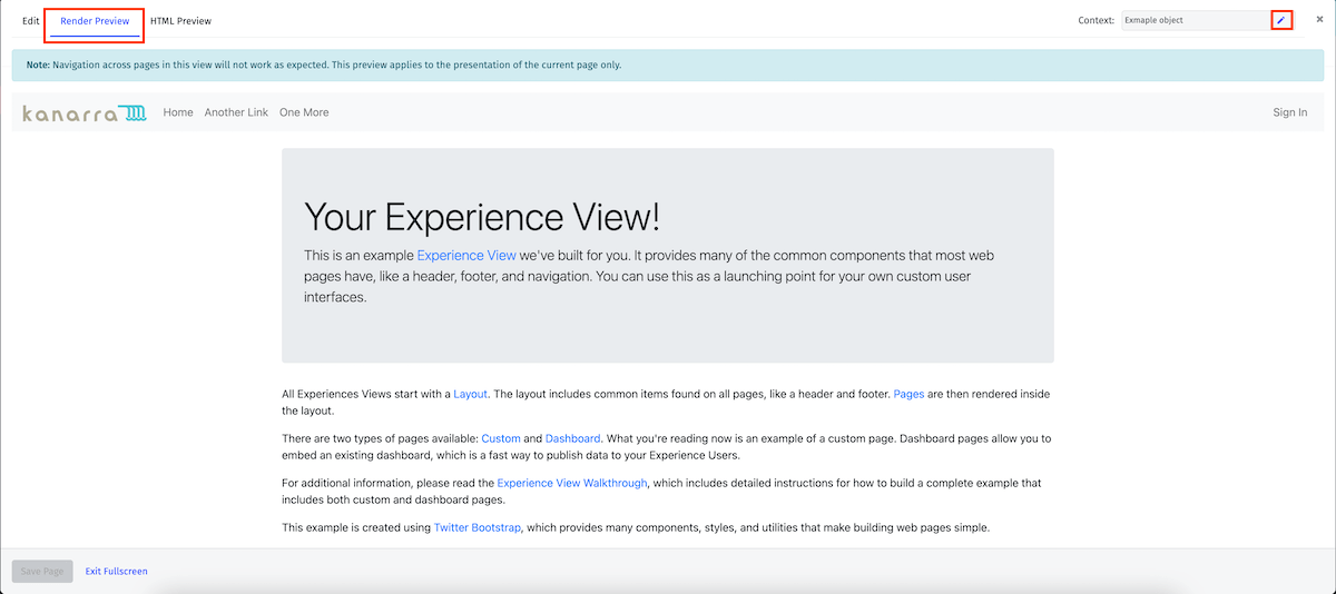

View Render Tab
Navigate to the Render tab to view a rendered preview of your current, unsaved view content. This will be rendered against an example context object; however, you may change the context by clicking on the "Edit" button in the top right corner. Layouts will show a placeholder page unless a valid pageId is specified in the context.

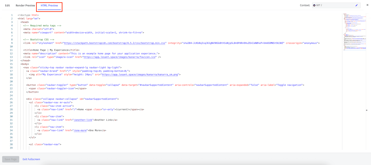

View HTML Preview
Selecting the HTML Preview tab allows you to preview the actual HTML that is rendered with the given view and context.

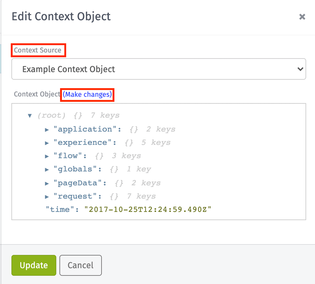

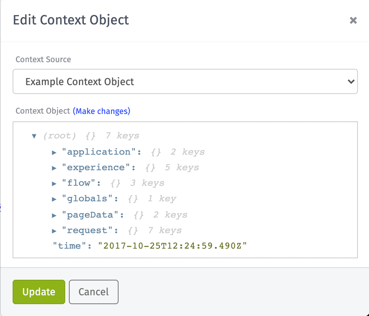

View Edit Context
Inside the "Edit Context Object" modal you can use the Context Source dropdown to change the context against which to render your page. Depending on the selected option, additional input is required. Clicking Update will apply your changes.
Example Context Object
View Example Context
The Example Context Object option provides a boilerplate example context with some relevant properties such as your page and/or layout objects filled in.

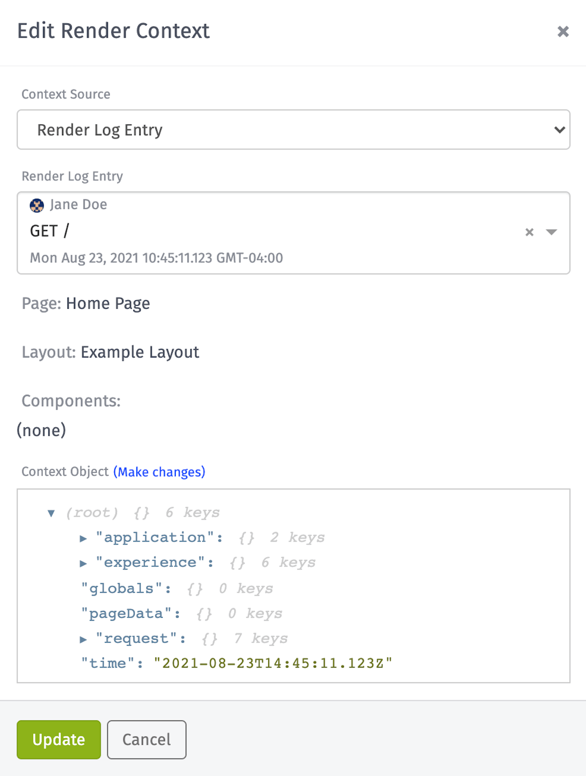

Render Log Entry
View Render Log Context
The Render Log Entry option allows you to see exactly what was rendered for your user on a given view rendering.
Note: To use the Render Log Entry option, you must have render log entries available.

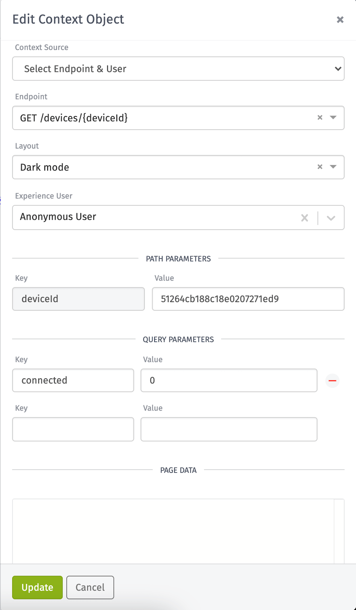

Select Endpoint & User
View Select Endpoint User Context
The Select Endpoint & User option allows you to build a context object by selecting the endpoint, page or layout, and user. Path Parameters are only available when selecting an endpoint that contains path parameters. Optionality is honored for path parameters. Query Parameters are always available and fully customizable. Page Data is treated as JSON and can provide custom data for your context object.
Note: To add HTTP request headers to your context object we recommend building your object with the above options, then clicking (Make Changes) to add headers from the Custom Context Object option.

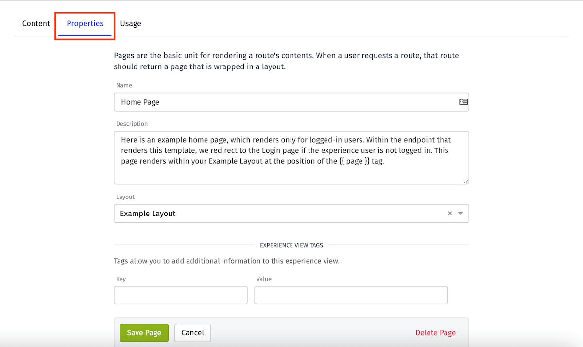

Other View Properties
View Properties Tab
Navigate to the Properties tab to edit your view's name, description, and tags. For pages you may also set the layout in which to render the page.

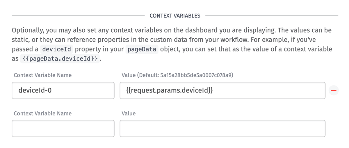

Context Variables
You have the option to define the context variables for a dashboard page. Context variable values - but not variable names - support templates from the request context.
Page Dashboard General Context
If you select a specific dashboard, the context variables name will auto-complete and show their default information. When context variables are not provided, the defaults defined on the dashboard will be used.
Note: When defining the value for a tag context variable, if you have picked a specific dashboard there will be both a tag key field and a tag value field (and both can be defined with templates). If you have not picked a specific dashboard, any tag context variable must be defined with a single JSON value that follows this format:
{ "key": "myKey", "value": "{{pageData.tagValue}}" }

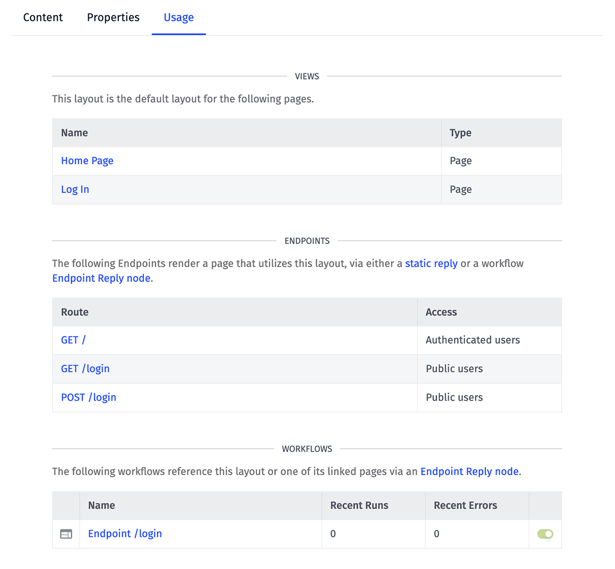

Linked Resources
All views have a "Usage" tab, which allows developers to see the places where the selected view is referenced or utilized. This can be helpful in determining if a view can be safely deleted or edited without breaking existing functionality.
Depending on the view type, the "Usage" tab will display one or more lists of linked resources ...
Experience View Linked Resources
  • Layouts display three lists ...
  • Pages display two lists ...
  • Components display a single list ...
    • All Views that utilize the component in their content, as well as the view type.

You also have the option to build your dashboard context object:
{{element 'dashboard' dashboardId=pageData.dashboardId ctx=(obj deviceId-0=pageData.deviceID deviceTag-0=(obj key=pageData.deviceTagKey value=pageData.deviceTagValue ))}}
In the snippet above, we are giving pageData.deviceID as the deviceId-0 context variable and pageData.deviceTagKey/pageData.deviceTagValue as the deviceTag-0 context variable. While it's recommended to use the obj helper to declare each context variable explicitly, you may directly pass in an object like so: ctx=pageData.context.

Referencing Context
Data passed down to your views can be referenced using standard Handlebars paths. It is through this method that different user interfaces can be provided depending on the user requesting the page, the endpoint being viewed and the data returned by your backing workflow.
Data That is Always Provided
The following data is available in your root context from any layout, page or component:
time, // the time of the request
application, // object containing the application name and ID
experience: {
user, // object containing info on the user who made the request (if available)
endpoint, // object containing info on the endpoint config
page, // object containing info on the page config
layout, // object containing info on the layout config,
version // the version of the experience for the request
flow, // object containing the backing workflow's name, ID and version
globals, // key/value mapping of any global variables from the application / workflow
request: {
path, // the actual request path
method, // request method (e.g. get, post, patch, delete)
headers, // object with header names as keys and their values mapped to them
params, // object with path params as keys and their values mapped to them
query, // object with query params as keys and their values mapped to them
body, // request body (if applicable, e.g. in a post or patch request)
cookies // object with cookie names as keys and their values mapped to them
pageData // object containing the custom data passed down from the workflow
The pageData Property
When replying to your endpoint request with an experience page, you have the option of passing additional information down to the view; that data is generated by the workflow replying to the request. All of that data is available under the pageData property within the view's context.
