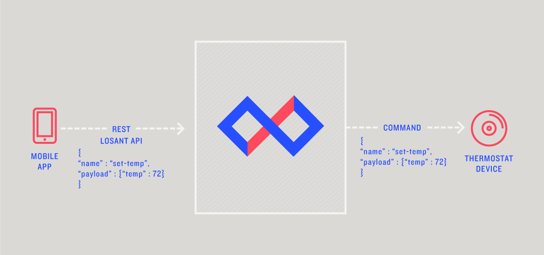

Command Diagram
Sending Commands
Commands are generally invoked from Losant workflows. Another common way to invoke commands is using the Losant API from a custom interface like a mobile app. For example, a thermostat may have a companion mobile app that allows the user to remotely set the temperature. The developer sends a command over the Losant REST API to set the temperature. The device receives the command and takes the appropriate action, which is likely to turn on or off the furnace or air conditioner.

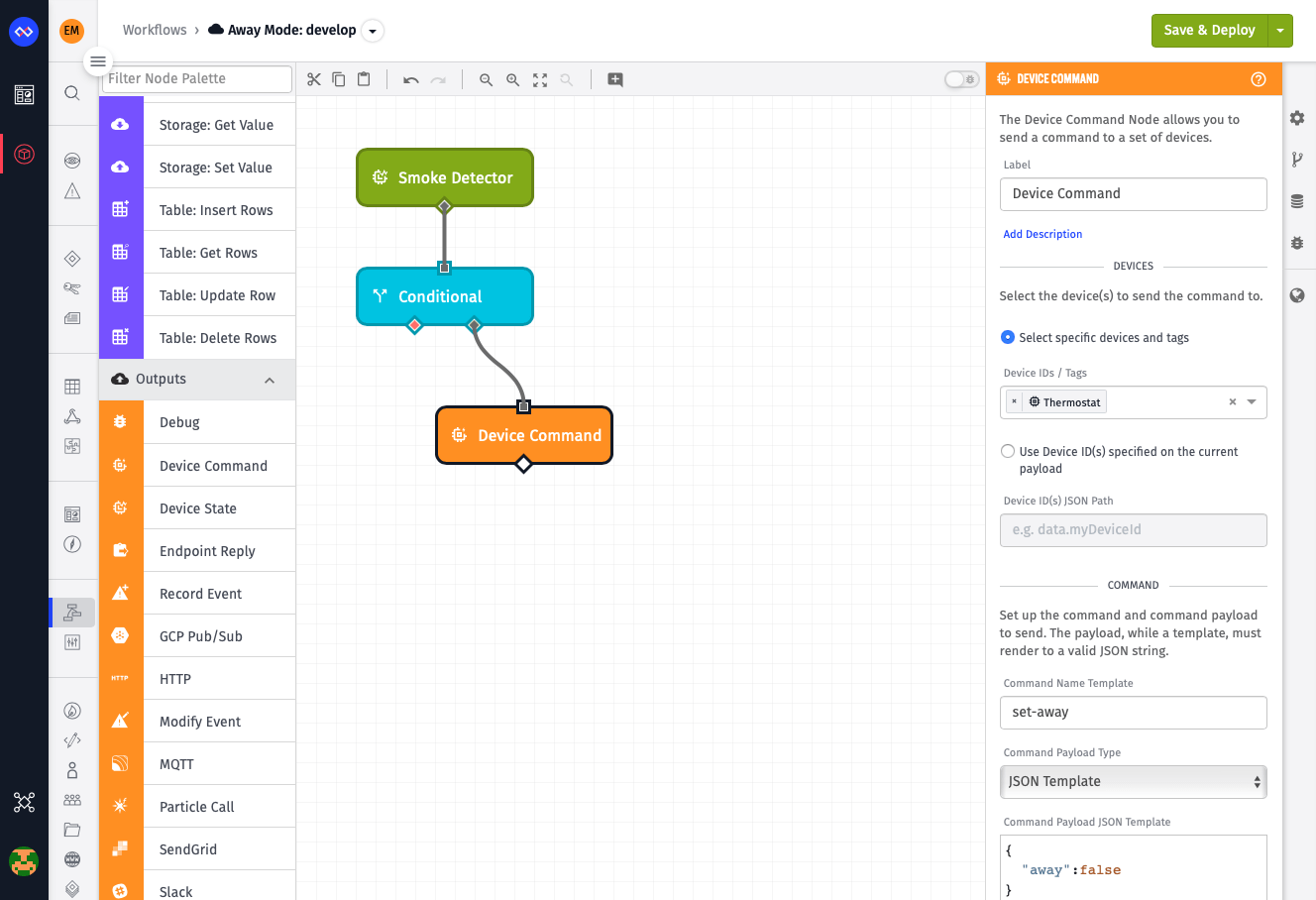

Losant workflows provide a way to send commands to devices based on any number of triggers. The example below sends a command to a thermostat to disable "away" mode when a person is detected by a separate smoke detector device that has a motion sensor.
Away Mode Workflow
In the above example, the smoke detector is reporting state whenever motion is detected or not. The condition node checks that motion is detected. The condition might look something like {{ data.motion }} == true. If motion is detected, it then sends a command to the thermostat to disable its "away" mode. The command name is set-away and the payload is { "away" : false }.
