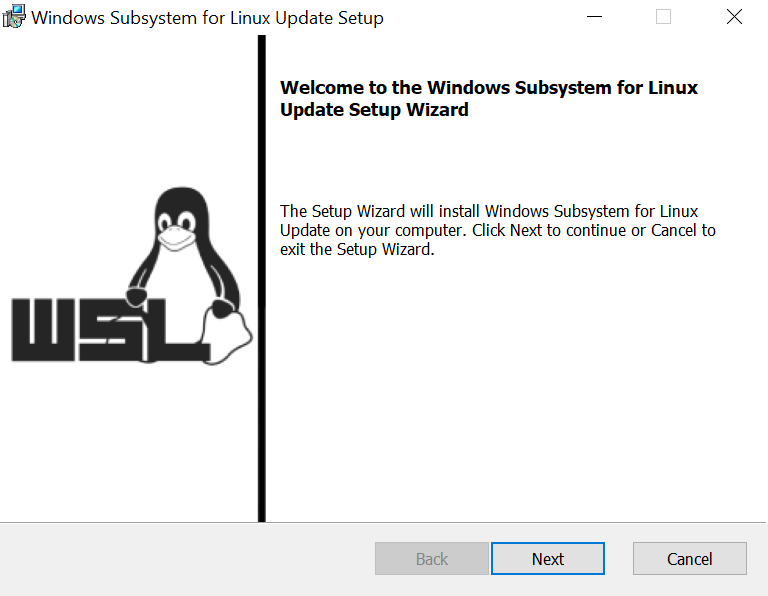

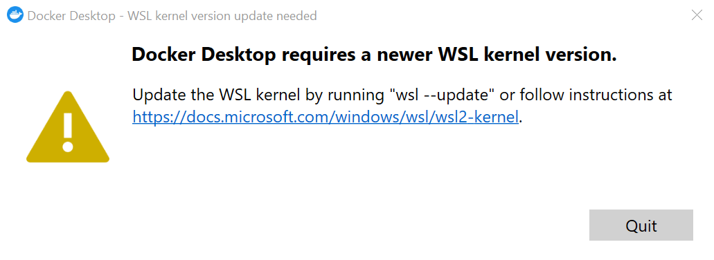

At first launch, after accepting the service agreement, the Docker Desktop app will walk you through installing or updating Windows Subsystem for Linux (WSL2) and the WSL kernel, if necessary:
Docker Windows WSL Setup
Docker Windows WSL Kernel
Once installed, you can open your command-line tool and proceed to pull the Gateway Edge Agent image using the steps below. For information, please see our documentation on using the Gateway Edge Agent with Docker on Windows.
