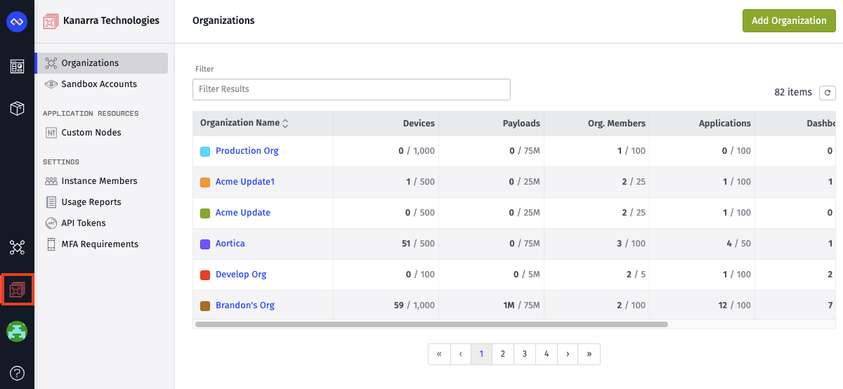

Gaining Access
If your Losant account is currently a member of a Losant Instance, you will find an icon that provides access to the tool in the main navigation of the platform interface.

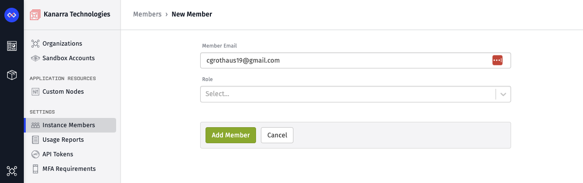

Adding Members
To add a member to an instance, click the "Add Member" button above the members list. This will bring you to a screen where you may enter the email address, as well as select a role, for the new member.
Add Instance Member Form
Unlike for organizations, where new members are added by invitation, adding a member to your instance is instantaneous and does not require opt-in from the new member. Also, any new member must already have an existing Losant account before being added to the instance. (For organizations, the new member has the option of creating an account if they do not yet have one.)

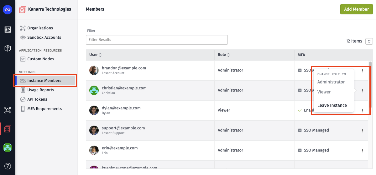

Editing Member Roles
Administrators have the option of changing the role of any instance member (including their own role) by opening the "Actions" dropdown in the user's row in the list of members. Then, select the user's new role.
Removing Members
Administrators may also remove any member using the same dropdown menu and selecting the "Remove Member" option. The member may be re-added at any time in the future.
Leaving an Instance
If you would like to leave your company's instance, you may open the "Other Actions" dropdown within your user's row in the members table and select "Leave Instance", which is in place of the "Remove Member" option. This action cannot be undone, and in order to regain access to the instance, another administrator will need to add you again.
