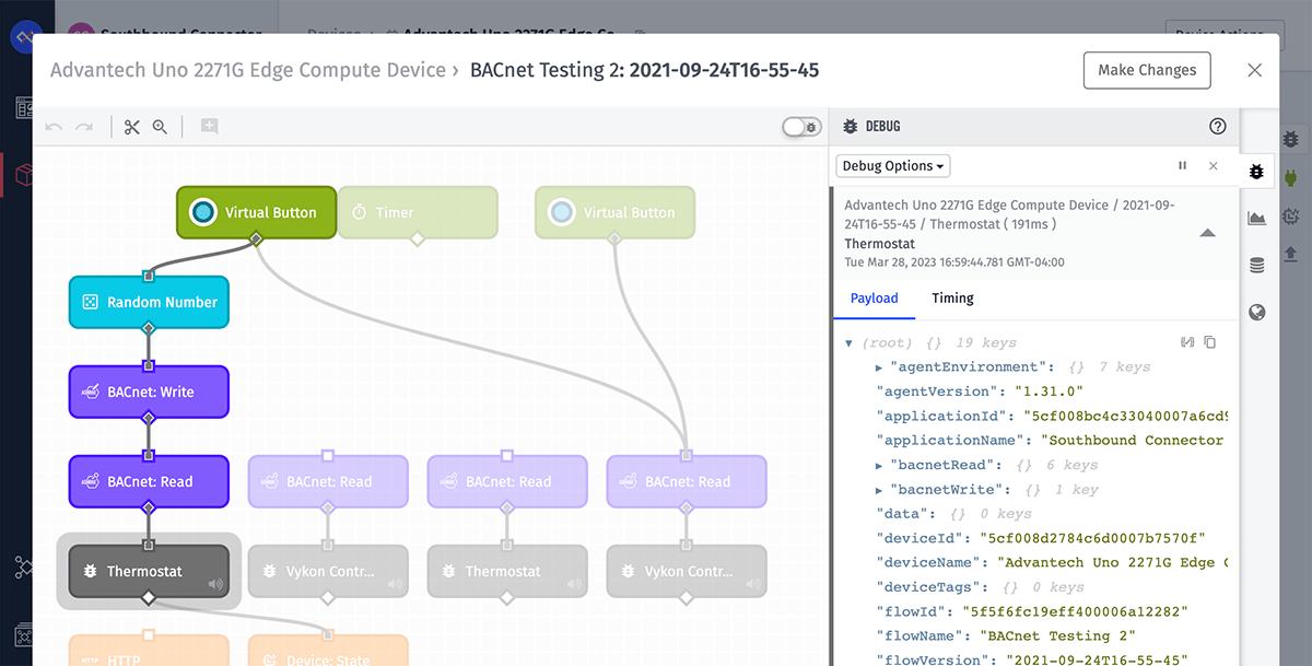

Edge & Embedded Workflows (Overview)
Viewing debug output for an Edge Workflow or an Embedded Workflow is quite different from viewing the output for workflows that execute in Losant's cloud environment. To facilitate this, Losant provides two debugging options:
  • A Live Look into a device that displays the version running on the device and connects to the device's debug stream. Live Look is available for all versioned Edge and Embedded workflows.
  • An Edge Workflow Test Deployment to a single Edge Compute Device. A test deployment allows for quick testing of an Edge Workflow or an Edge Custom Node by automatically deploying the "develop" version to a single device on every save of the workflow.

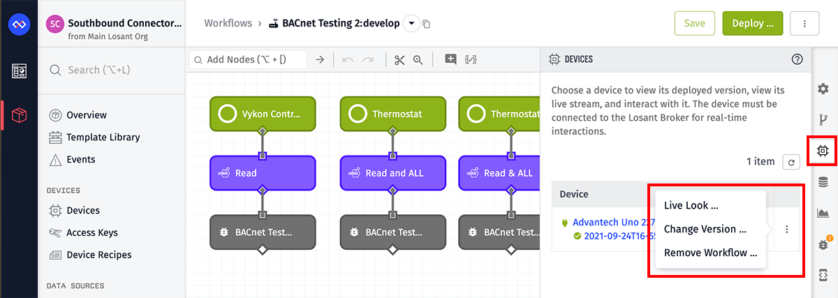

From a Workflow
Live Look Trigger Workflow
While viewing a workflow, open the "Devices" tab in the right column to see a list of devices that have a version of the workflow deployed to it (or with a pending deployment). Any device that is connected to the MQTT broker and has a version running will have a "Live Look" option in its dropdown menu. Select this option to launch the Live Look modal for that device, which will allow you to view debug output.

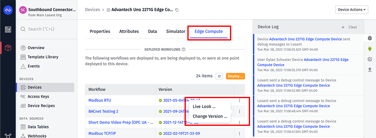

You may also view all the workflows deployed to a given device by visiting the "Edge Compute" or "Embedded" tab (depending on the device class) on the device's detail page. This displays a table of all workflows on (or actively deploying to) the device. You may launch the "Live Look" for any workflow on the device, provided the device is connected to the MQTT broker and the desired workflow version has completed deployment.

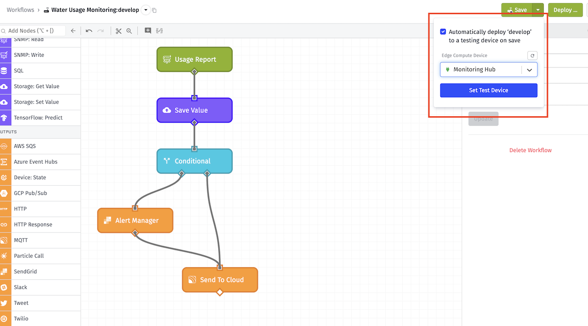

Edge Workflows (Test Deployment)
Test deployment of the "develop" version is supported for Edge Workflows starting with GEA v1.39.0, and for all GEA versions that support Edge Custom Nodes. Once "develop" is deployed to a device, workflow updates are sent to the device each time the flow is saved. If a named version of the Edge Workflow exists on the device, it must be removed prior to deployment of "develop"; standalone deployments of Edge Custom Nodes is not supported.
The "develop" version of a given workflow or custom node may only be deployed to a single Edge Compute Device at a time. If a new test device is selected, "develop" is removed from the device on which it is currently deployed before deployment to the new device is requested.
Deploying Develop To An Edge Device Detail

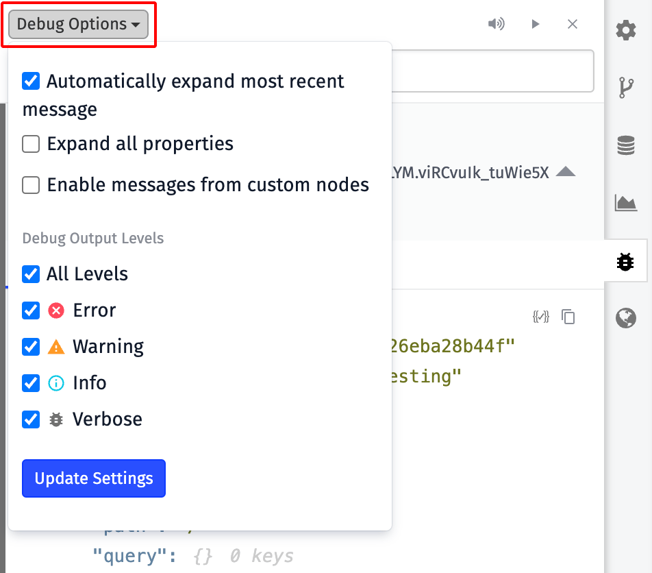

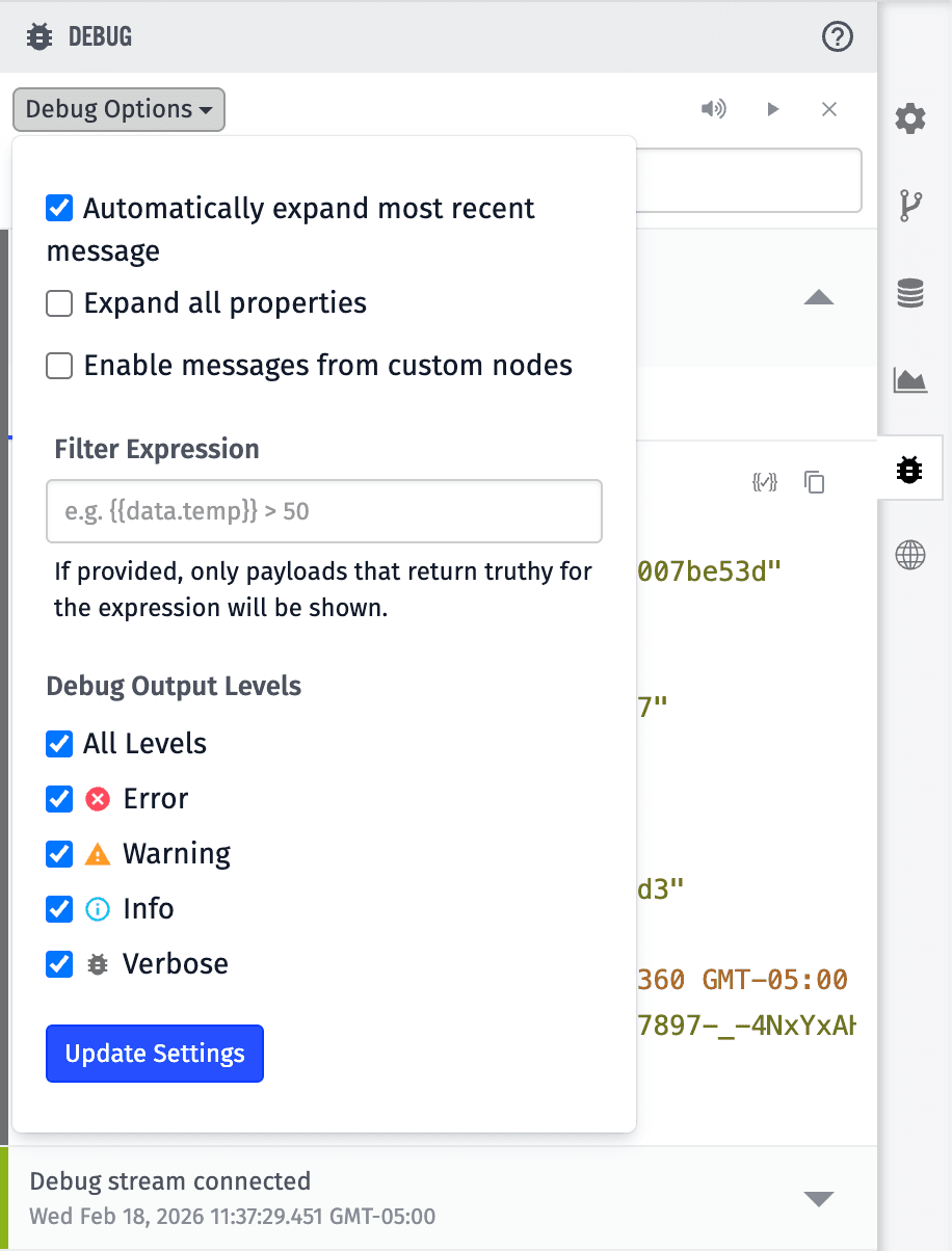

Debug Options
In addition to the options for filtering debug output described above, there are additional settings for adjusting which messages appear in the log and how they are displayed by default. Note: These options, and the filtering options described previously, affect only the user viewing the workflow; other users viewing the same workflow are not affected by your chosen settings, and those users are able to apply their own options to the debug panel.
Workflow Debug Options
Automatically expand most recent message
When checked, the latest message to appear in the debug panel will expand to display the message body by default. Once a message is no longer the most recent within the panel, the body will collapse unless the user has explicitly collapsed and re-expanded the body already. Uncheck this option to not automatically expand the most recent message.
Expand all properties
When checked, objects within a debug message will display all of their properties and sub-properties all the way down the message's JSON structure by default. If unchecked, only the data property will be expanded to show its sub-properties by default. Note, users may expand or collapse any properties within the panel at any time regardless of this setting.
Enable messages from custom nodes
If your workflow utilizes Custom Nodes, and those Custom Nodes have Debug Nodes within them, checking this option will display the messages produced within those Custom Nodes in the debug panel alongside messages produced by the workflow.
Debug Output Levels
By default, all workflow debug messages regardless of their urgency level are displayed within the debug panel. Users may wish to suppress debug messages of one or more of these levels to limit the debug output. Select or deselect the urgency levels you would like to appear in the panel.
Function Node console messages are also subject to these settings; for example, a Function Node with a console.log() statement will not generate a debug message if "Verbose" messages de-selected.
Similarly, Custom Node messages will only appear in the log if the Debug Node within the custom node has an urgency level that is selected as an output option.
Fatal error messages will always appear in the panel regardless of selected output settings.

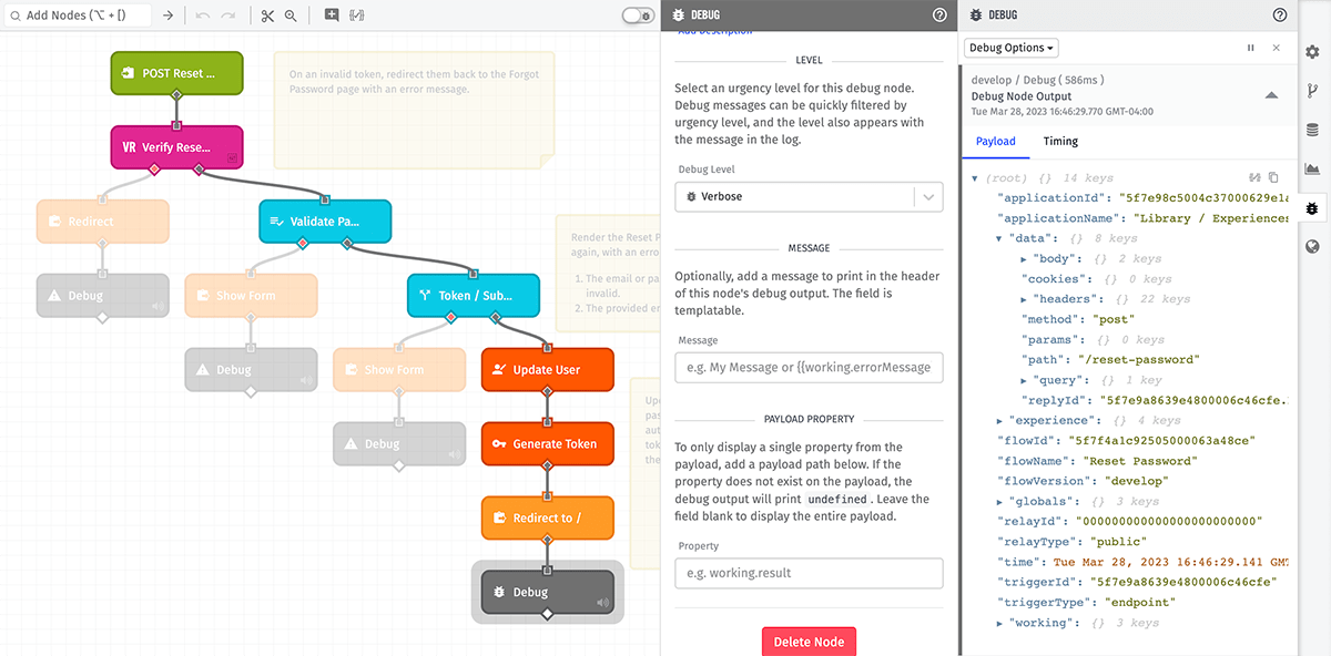

Debug Node Messages
The most common type of message that appears in the debug panel is those generated by Debug Nodes. These are messages the user explicitly opts in to receiving by placing these nodes within the run of a workflow, usually as the very last node at the end of a chain.
Debug Node Message
Regardless of where it appears in a run or the configuration applied to it, Debug Nodes have no impact on the behavior of a workflow; they do not mutate payload properties, and they take very little time to run (usually no more than 1ms).

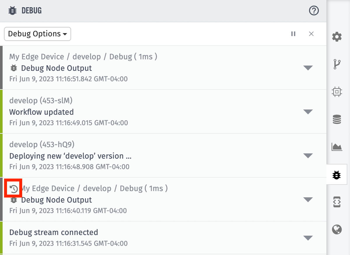

It is important to look out for the history icon beside the label of an item in your workflow's debug log. The presence of this icon indicates that the log item was generated from a previously saved develop version and does not necessarily reflect what is current for your workflow.
Debug Log with History Icon

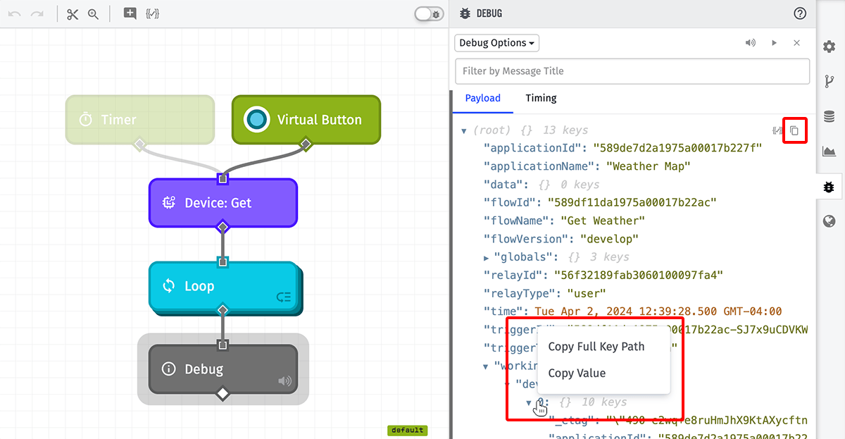

Copying Debug Output
A Debug Node's payload output can be copied to the clipboard by clicking the copy icon in the top right corner of the message's "Payload" tab. This will copy the full JSON output to the device's clipboard, where it can then be pasted into a text editor, a Virtual Button payload, and more.
You may also context-click (e.g. right-click, or click while holding your operating system's modifier key) on any property in the debug output. This will display a dropdown menu with the following options:
Copy Payload
  • Copy Full Key Path: This will copy the full payload path of the clicked property to the device's clipboard. This can be useful in development when trying to target a deeply nested property for use in a workflow node's configuration.
  • Copy Value: This will copy the value found at the clicked property - including any deeply nested values if the clicked property is an object or array - to the device's clipboard.

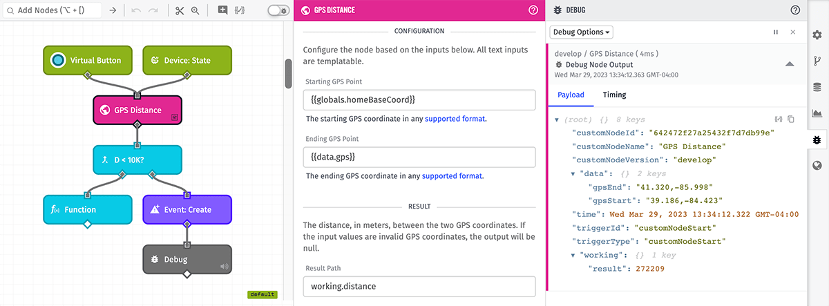

Custom Node Messages
When the "Enable messages from custom nodes" option is enabled, and your workflow makes use of Custom Nodes, and those Custom Nodes produce debug output through their execution, those debug messages will appear in the workflow's debug panel as having originated from the instance of the Custom Node.
Custom Node Debug Message
Note that a given Custom Node may or may not produce any debug messages; whether a message is produced depends on the content of the custom node itself. Whether a Debug Node from within a Custom Node generates messages in the debug panel is also subject to the chosen debug output levels; as in, a "Verbose" Debug Node in a Custom Node will not generate a message if "Verbose" is not selected as an output level.

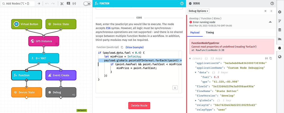

If any node throws an error that causes the workflow to halt execution, those messages will also appear in the debug panel. The messages will outline the encountered error and, like other debug messages, will display the payload as it was at the time of the node's execution.
Fatal Error Debug Message

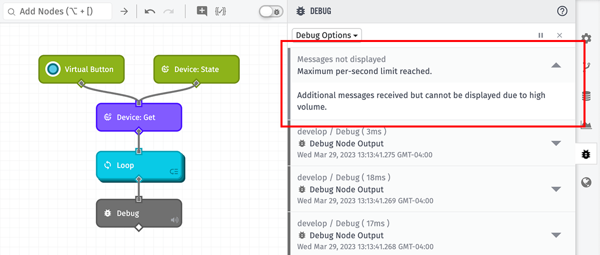

Throttle Limit Messages
A workflow will only output a maximum of 10 debug messages per half-second. If that limit is exceeded, the debug stream will publish an additional message to notify the user that the throttle limit has been reached and that some debug messages are not being displayed.
Throttle Debug Message
Cases where you may run into debug message throttling include:
  • Workflows that run on a very high frequency, such as those kicked off by Device: State Triggers matching a large number of devices that report state several times per minute.
  • Workflows that utilize Debug Nodes inside of Loop Nodes. Depending on how long each iteration of the loop takes to execute, you may hit this throttle limit.
  • Workflow paths that utilize multiple Debug Nodes in a single run, as these will produce one debug message per node.
  • Numerous console.log messages within a Function Node.

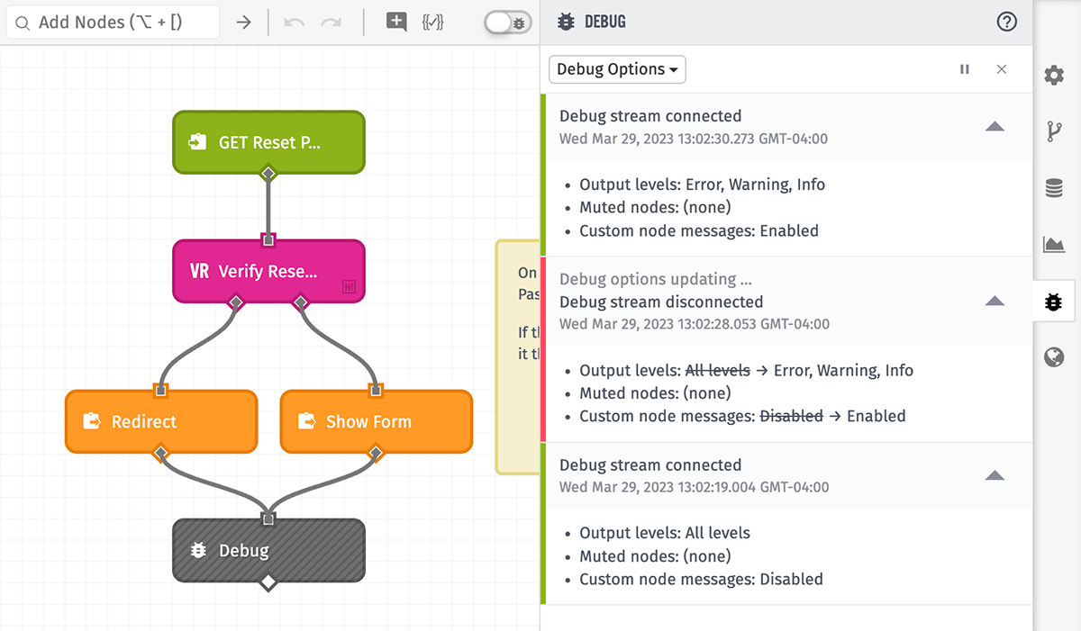

Debug Stream Status Messages
Upon opening a workflow in your browser, a "Debug stream connected" message will appear in the debug log indicating that the stream has been established with the chosen debug options. If the stream disconnects - which is most likely to happen when changing certain output options or if the browser tab is left idle for a long period of time - a "Debug stream disconnected" message will appear along with the reason for the disconnection.
Connection and Disconnection Debug Messages
Shortly after that (assuming the browser has a stable internet connection), another "Debug stream connected" message will appear indicating that debug messages will begin appearing again with the user's applied output settings.

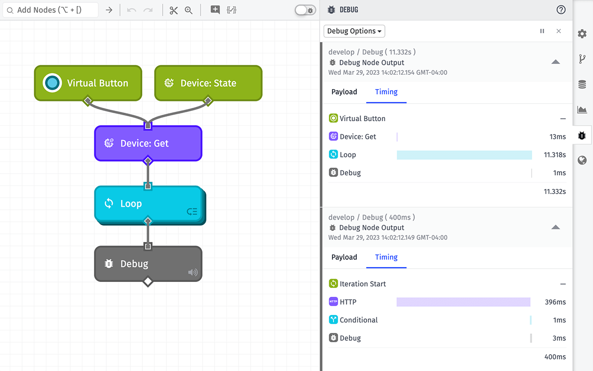

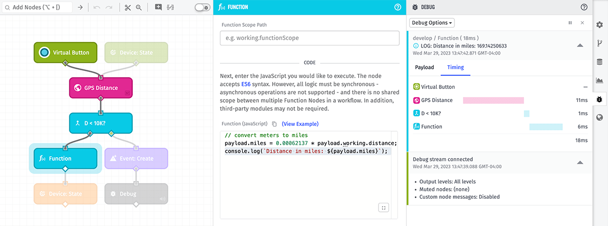

Workflow Node Timing
In addition to displaying the payload at the time a debug message was delivered, each message also contains detailed, per-node execution timing information for all nodes preceding and including the node that triggered the debug message. This is helpful for identifying nodes that take especially long to execute (for example, when interacting with a third-party API using an HTTP Node).
Debug Message Timing
Per-node debug timing is displayed as a waterfall chart under the "Timing" tab of each debug message, with a line dedicated to each node in the execution path. Furthermore, the total elapsed time from the trigger to the message-generating node is also displayed in the header of each debug message.
Loop Node Timing
Loop Nodes are a special case when it comes to workflow node timing:
Loop Debug Timing
  • For messages generated outside of a loop (such as a Debug Node following a Loop Node), the Loop Node is treated as a single entry in the timing table as if it were any other node in the run, with the total time to execute all iterations of the loop aggregated into one line.
  • For messages generated inside of a loop (such as a Debug Node within a loop's contents), message timing is for the individual iteration of the loop that generated the message. In other words, the timing calculation begins with the iteration of the loop and ends at the point where the debug message was generated. Note: Debug Nodes inside of loops can generate a large quantity of messages in a short period of time, which can lead to your debug stream hitting throttling limits.
