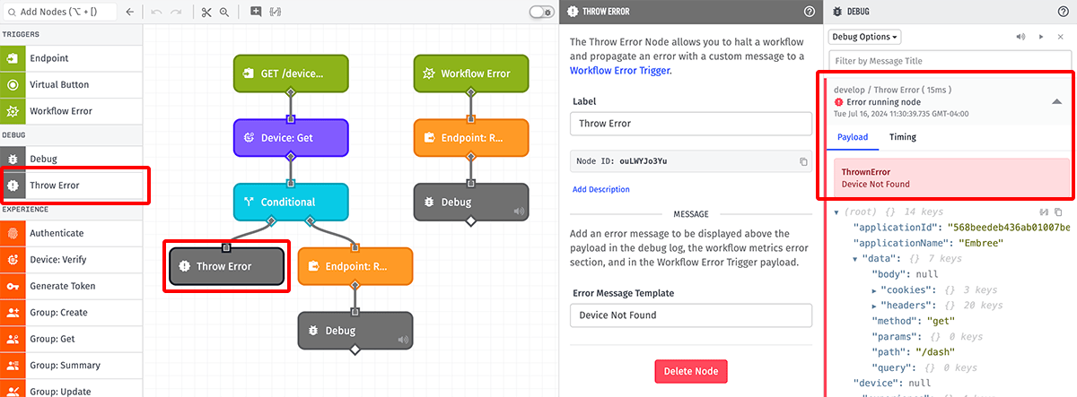

Throw Error Node
The Throw Error Node halts a workflow execution, logs an error to the debug panel and to workflow metrics, and fires any associated Workflow Error Triggers.
The Throw Error Node takes a single configuration property: a required Error Message Template, which is the message associated with the thrown error. The value is a string template that supports dynamic values rendered from the workflow payload. This value will appear in several places ...
- As the title of a new debug message in the workflow debug panel.
- In the payload of any Workflow Error Triggers fired by this node, under the property
data.errorInfo.error.message
. - As an error name in workflow error metrics.
Unlike most workflow nodes, you may not connect other nodes after a Throw Error Node. This is because invoking the node causes the workflow execution to halt, and any nodes following the Throw Error Node would never run.
Usage
Invoking the Throw Error Node causes the following to occur:
- Halts the workflow execution and displays the error generated by the node in the workflow debug panel.
- Executes any Workflow Error Triggers scoped to the flow that invoked the node, in order of specificity.
- Logs the error to the invoking workflow's error metrics.
