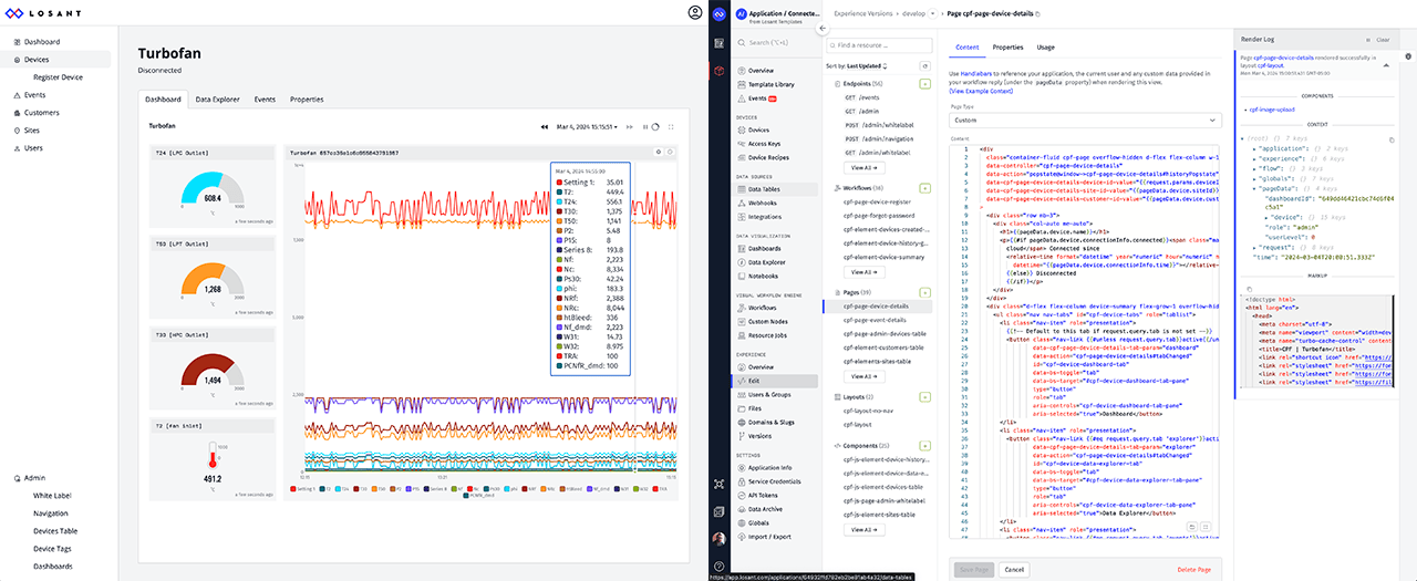

Experiences are a means by which you can build a fully functional web interface, allowing users to interact with your connected Devices. Set a subdomain at which your Experience Views can live; return user-specific Dashboards with content that is specifically relevant to them; configure Endpoints to respond to requests using the power of Losant’s Workflow Engine; register Experience Users against your application; or build a full multi-tenant application by assigning your users to Experience Groups.

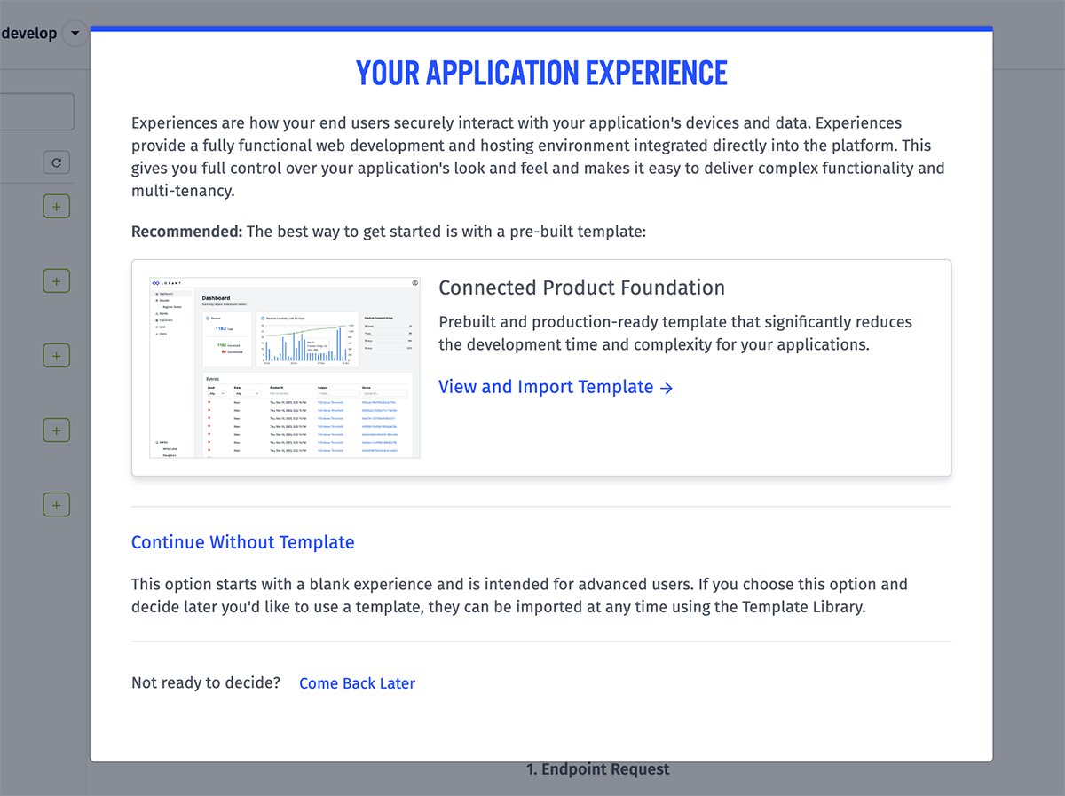

Connected Product Foundation
Starting your application from the Connected Product Foundation (CPF) template is the recommended way to begin developing an experience. The CPF provides many pre-built pages that are found in nearly all IoT applications. It also incorporates many implementation best practices and a standard web architecture that provides a scalable framework in which to develop.
Building from Scratch
If you started from a blank application or a template that does not include experience resources, your experience must first go through a short bootstrapping process before you can begin building.

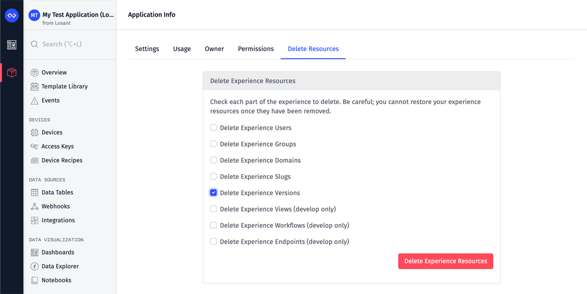

Deleting Experience Resources
If for any reason you need to delete parts or all of your Experience, you can do so under the “Settings” -> “Application Info” tab in your application’s sub-navigation and then selecting “Delete Resources” in the top navigation tabs. Select all the resources you wish to delete and then submit the form.
