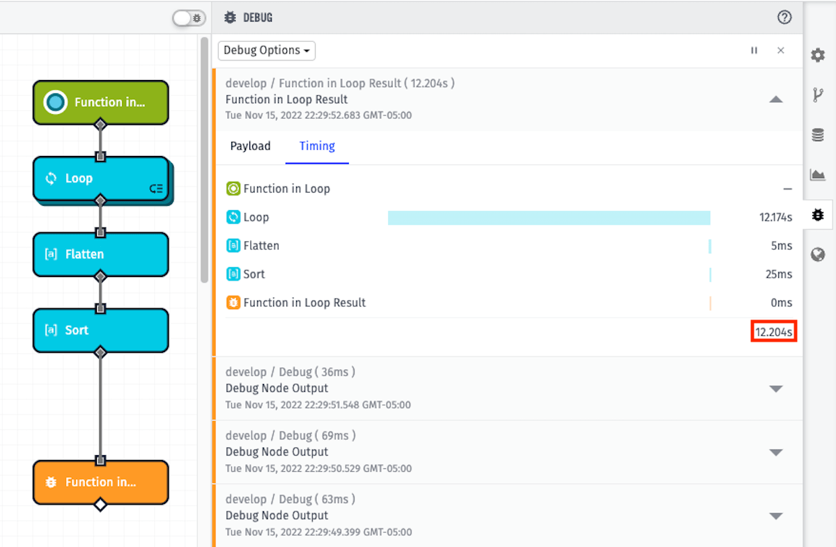

Function Node Within a Loop
In this first demonstration, we've placed a Function Node within a loop to accomplish the test scenario described above. This means the Function Node container is being constructed and deconstructed 1000 times.
const getRandomInteger = (min, max) => Math.floor(Math.random() * (max - min + 1) + min);
payload.randomX = getRandomInteger(payload.currentItem.index * -10, payload.currentItem.index * 10);
payload.randomY = getRandomInteger(payload.currentItem.index * -10, payload.currentItem.index * 10);
payload.randomZ = getRandomInteger(payload.currentItem.index * -10, payload.currentItem.index * 10);
payload.myArray = [];
payload.myArray.push(payload.randomX);
payload.myArray.push(payload.randomY);
payload.myArray.push(payload.randomZ);
Function In Loop
12.204s is the completion time.

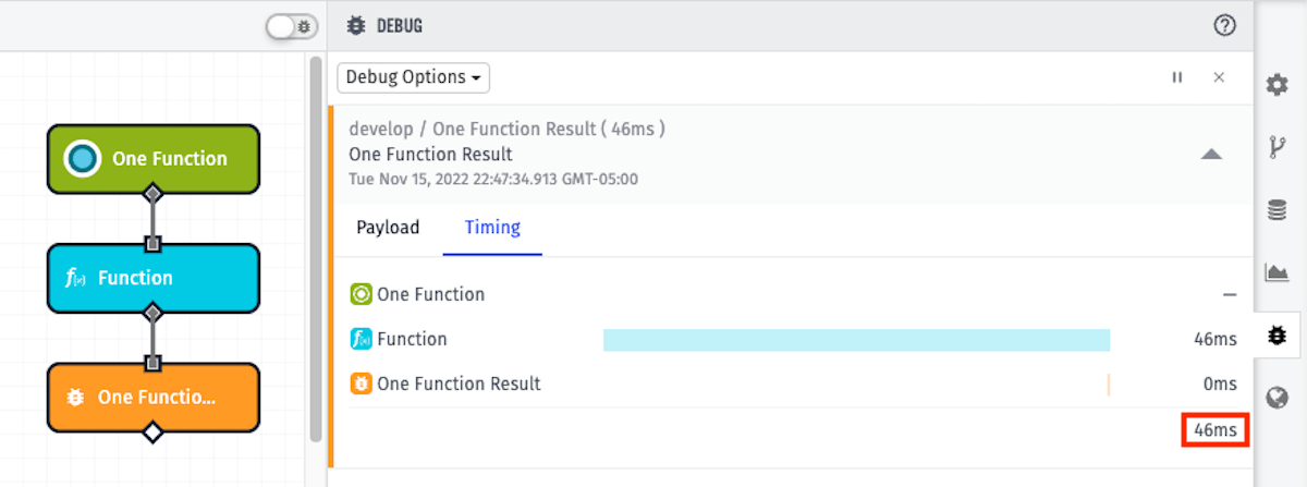

For the next test, we're going to complete the same tasks listed above, but rather than looping through a Function Node 1000 times, we're going to execute everything in just one Function Node.
payload.result = [];
for (let i = 0; i < 1000; i++) {
const randomX = getRandomInteger(i * -10, i * 10);
const randomY = getRandomInteger(i * -10, i * 10);
const randomZ = getRandomInteger(i * -10, i * 10);
const myArray = [];
myArray.push(randomX);
myArray.push(randomY);
myArray.push(randomZ);
payload.result.push(myArray);
payload.result = payload.result.flat();
payload.result.sort((a, b) => a - b);
Single Function Node
46ms is the completion time, which is significantly less than when the Function Node was placed in a loop in the first example. This is because the construction and deconstruction of the Function Node's container only occurred once - not 1000 times.

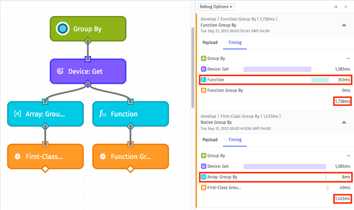

Single Native Node vs. Single Function Node
In the above examples, we determined for that particular set of tasks, a single Function Node provided the best performance. However, let's take a look at another task:
  • Fetch 1,000 devices.
  • Group the array by the value of the given tag key, comparing the Array Node's "Group By" method to using a Function Node.
Since the native node doesn't have to construct and deconstruct a container to operate within, we will see that native nodes oftentimes outperform Function Nodes when given an equivalent task.
Function vs Native
The important takeaway from the example above is the difference between the Function Node execution time (353ms) and the Array: Group By Node (8ms).

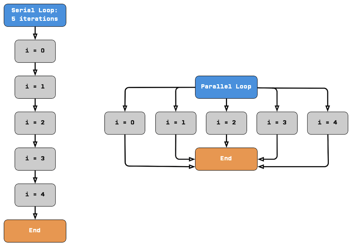

Loop Nodes: Serial vs. Parallel
The Loop Node allows for iterating over values on your payload, or for performing a certain operation a set number of times. When configuring a Loop Node, you must specify whether the loop should run in Serial Mode or Parallel Mode.
Serial loops run one iteration of a loop at a time, while parallel loops run up to five iterations of a loop at a time. This means that parallel loops are almost always the most efficient option, executing up to five times faster than serial loops. This is especially true when the loop is making calls to external services (via the HTTP Node, Losant API Node, etc.), since multiple iterations can execute concurrently while waiting for a response.
Here's a diagram that visualizes the difference:
Serial vs Parallel Loops
There are some cases in which it's necessary to use a serial loop. If you need to mutate the original payload from one iteration to the next, or if you need the ability to prematurely end the loop, a serial loop might be your best option. However, we encourage you to adjust your workflow as needed to facilitate parallel loops where possible.

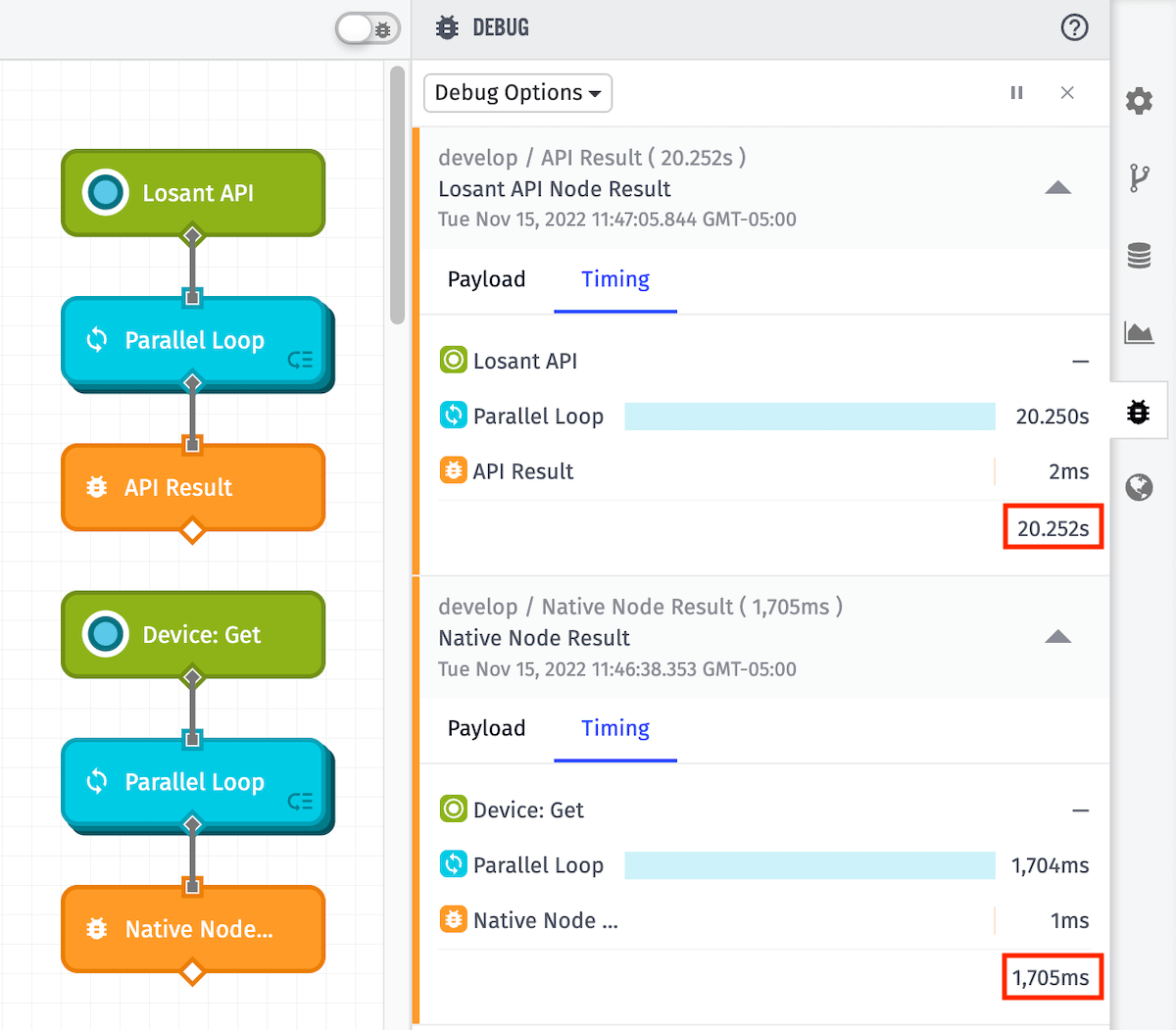

Losant API Node vs. Native Nodes
Losant is powered by a full REST API. The Losant API Node allows a workflow to utilize this API to access any resource under an application.
Many of the features available in the Losant API are also available as discrete native nodes. One example is the Device: Get request, which can be performed through the API or through the native Device: Get Node.
Since the Losant API Node has to make a full API request that leaves the private Losant infrastructure, this introduces an additional time cost. Therefore, native nodes will almost always outperform equivalent requests made through the Losant API Node.
Let's see how they perform in comparison to each other:
API Node vs Native Node
In the example above, we're utilizing a loop to fetch 1000 devices. The path at the top is using the Losant API Node in the loop, while the path at the bottom is using the native Device: Get Node in the loop. What a massive improvement; the native node is more than 10x faster!

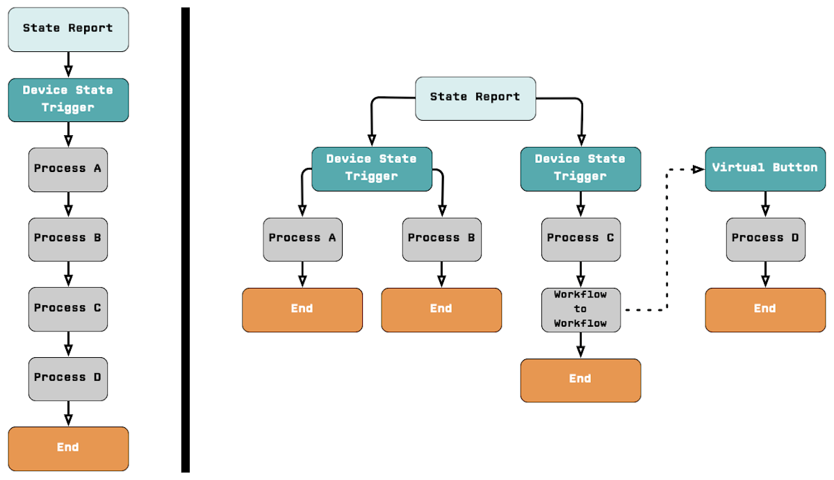

Spinning Off Heavy Processes
When building out your workflows, spinning off heavy processes across multiple triggers and/or parallel paths will generally be more efficient than stacking them sequentially.
The below diagram demonstrates breaking down a heavy process (on the left) into multiple paths that run in parallel (on the right):
Heavy Processes Diagram
The efficiency improvements realized by making these changes vary considerably from workflow to workflow. In addition to improving performance, this can keep a workflow from timing out.

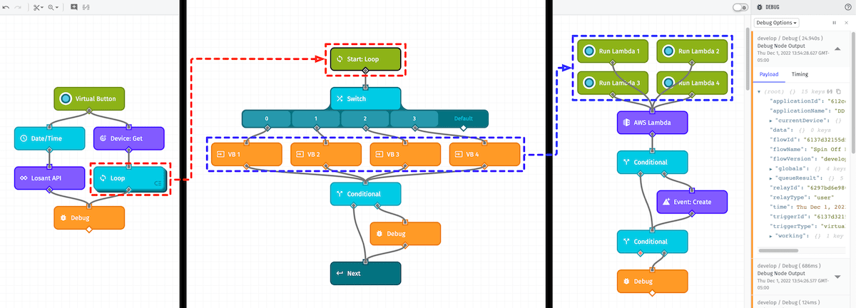

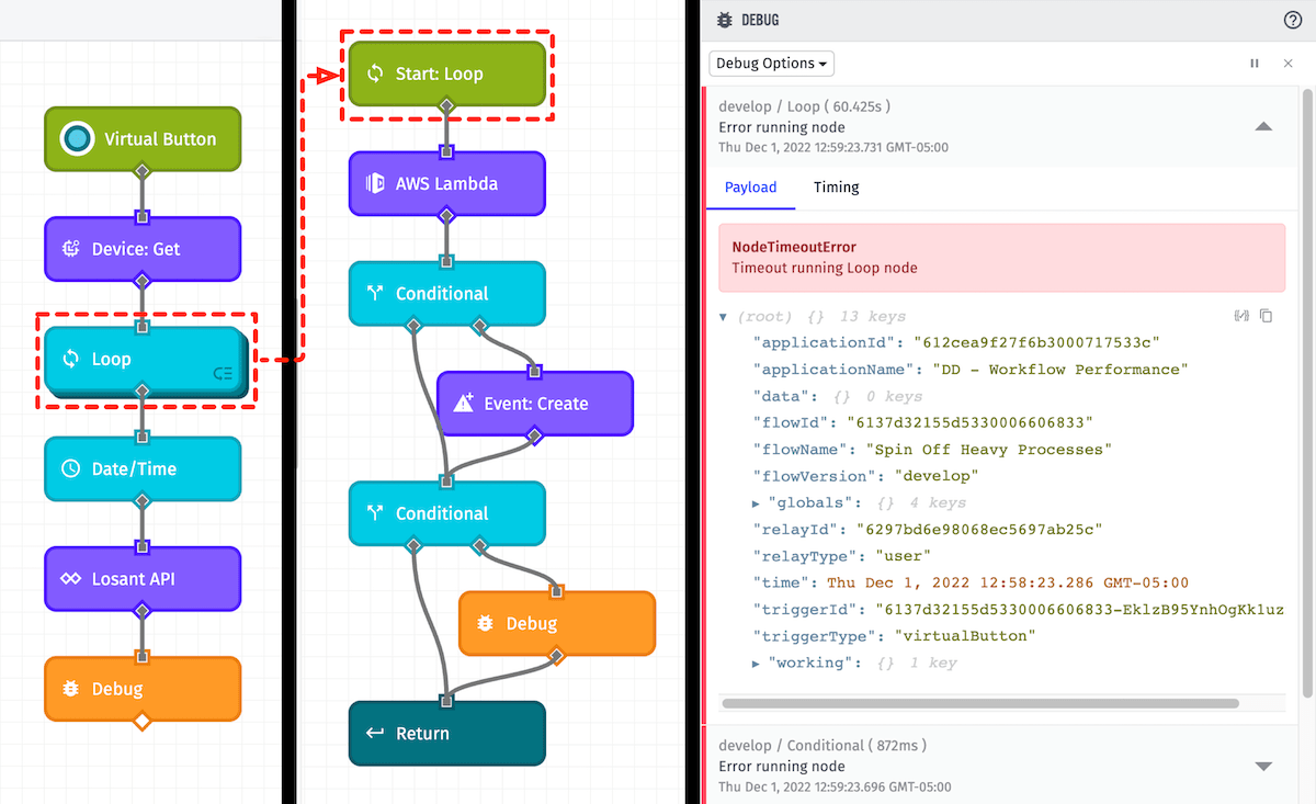

To demonstrate, we've constructed the following test:
  • Loop over the devices and send each object to an AWS: Lambda Node.
  • Separately, request a data export (via the Losant API Node) for all device data from the start of the month until now.
This is a relatively heavy process, with each invocation of the AWS: Lambda Node taking ~500ms or longer.
In our first workflow, we're going to stack all of these nodes sequentially, including those within the loop (superimposed in the middle below):
Heavy Processes Sequential
The above workflow timed out at 60 seconds before it could complete successfully. Let's see what we can do to break it down into several parallel processes. In the workflow below, we're going to make the following changes:
  • Spin the data export (Losant API Node) into a parallel process.
  • Inside of the loop (superimposed in the middle), utilize a Switch Node with multiple Workflow Trigger Nodes to distribute the AWS: Lambda Node workload to multiple Virtual Button Triggers in a separate chain of processes on the right.
Heavy Processes Parallel
Now we can see that the workflow completes successfully!

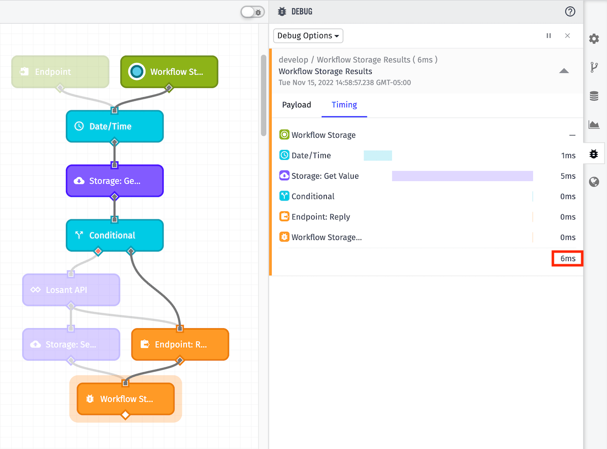

Caching with Workflow Storage

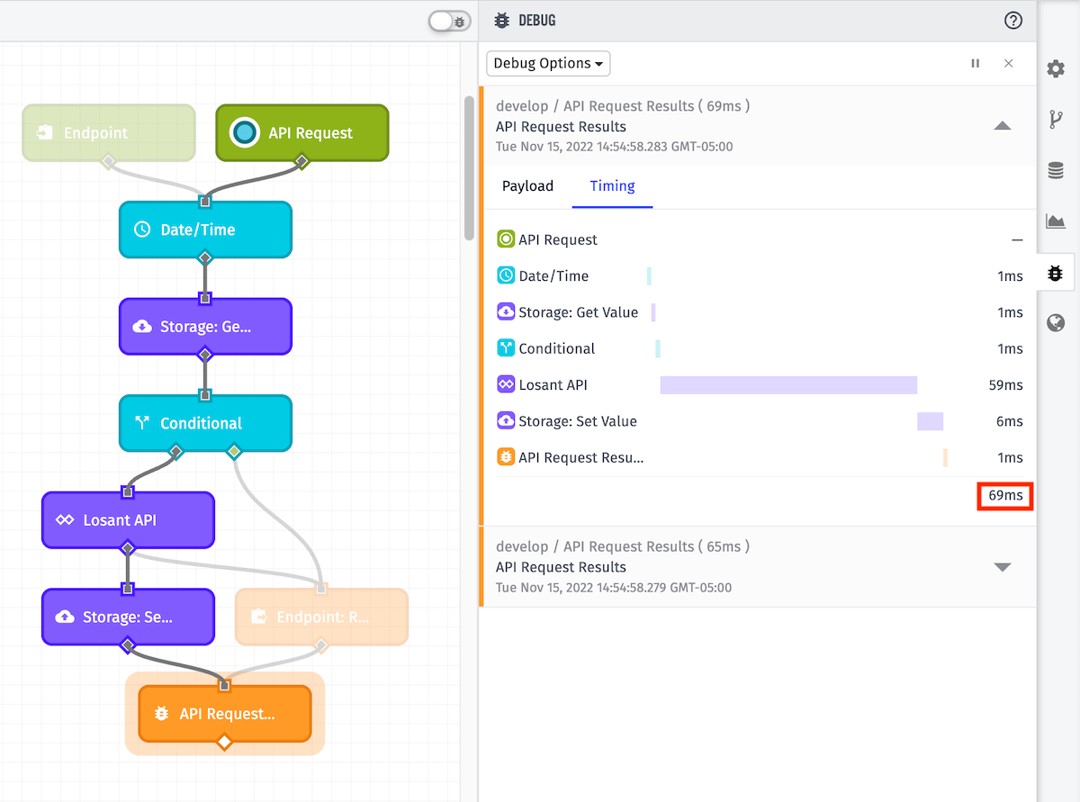

You can cache responses from third-party services using Workflow Storage. If a value needs to be referenced multiple times across a workflow, this will help to reduce the number of API calls. It's generally best practice to use Workflow Storage to cache API responses when relevant to your workflow.
To demonstrate the difference in performance, let's first look at a new request to a third-party API using the Losant API Node:
Workflow Storage API Request
Now, let's pull the returned value above from Workflow Storage, rather than re-requesting it through the API:
Workflow Storage Cached Request
The completion time dropped from 69ms to 6ms.

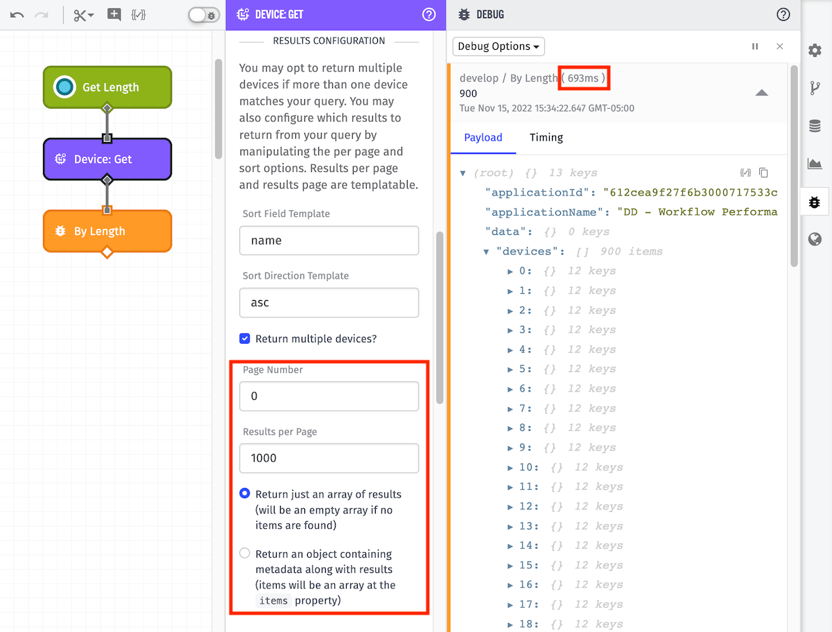

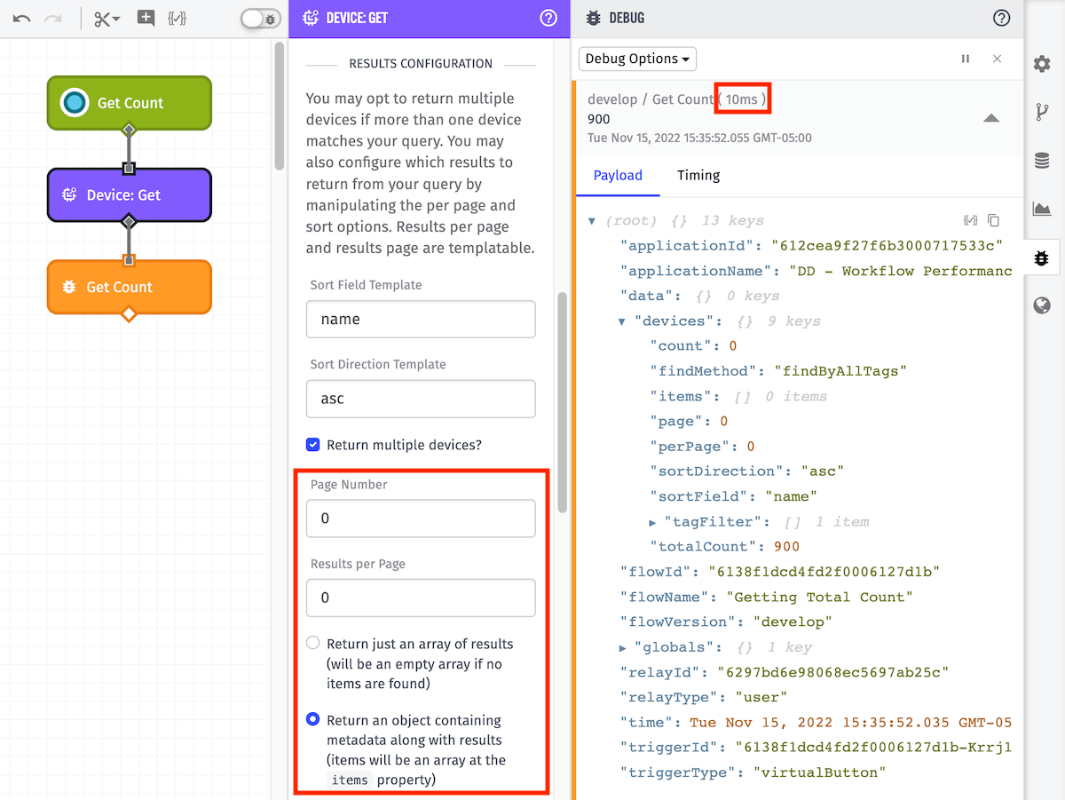

Device Count
If you only need to know the total device count of a given query, returning an object with device count metadata is more efficient than returning an array containing all matching devices.
First, select a query method that can return multiple results (all options other than Device ID). This reveals the Results Configuration section. Then, check Return multiple devices?:
Device Get Count
In the above configuration, we've set the Page Number and Results Per Page to 0, and selected Return an object containing metadata along with results. As we can see in the Debug tab (under devices), we have a totalCount value of 900. No other device details are returned. We can also see this request processed in 10ms.
Alternatively, if we were to request an array containing the details of all devices matching our query:
Device Get Array
In this case, we've set the Page Number to 0, the Results Per Page to 1000, and selected Return just an array of results (will be an empty array if no items are found). Our Debug tab now shows an array containing 12 keys for each of the 900 matching devices. As expected, the processing time has also increased to 693ms.

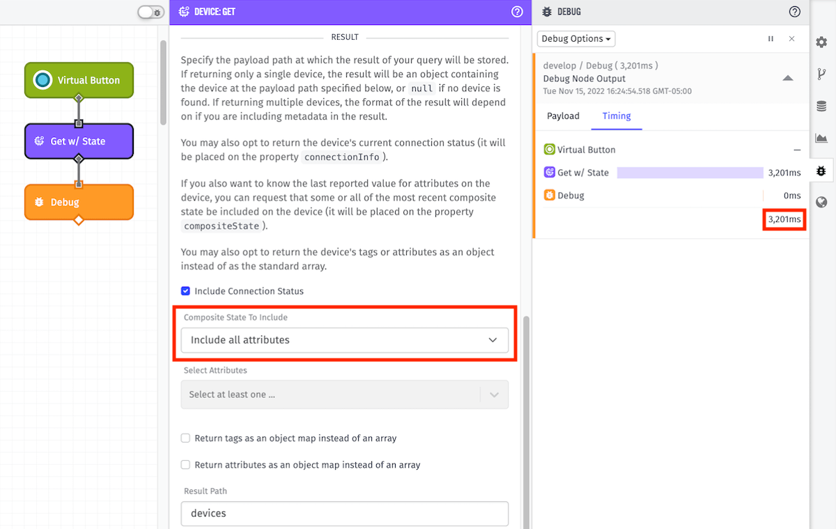

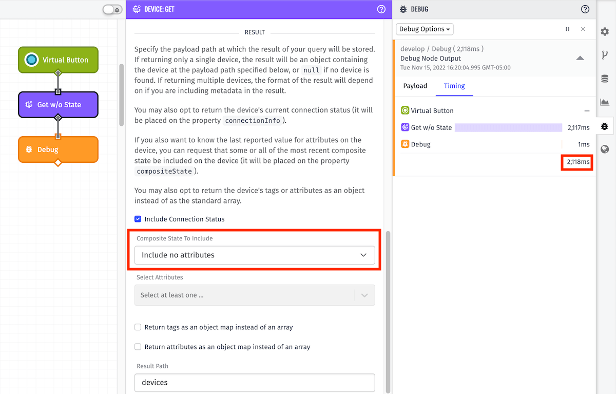

Composite State
The Device: Get Node has an option to include the most recently reported device attributes in the result path. This is referred to as Composite State and is configured in the Result section. As we'll demonstrate below, it's more efficient to not include Composite State when it's not needed.
The default option is Include no attributes, which will obviously not include any device attribute data:
Device Get Without Composite
If you want to return Composite State in your result path, you can select Include all attributes or Include the following attributes:
Device Get With Composite
As we can see in our example, processing time increased from 2,118ms to 3,201ms when including Composite State.
