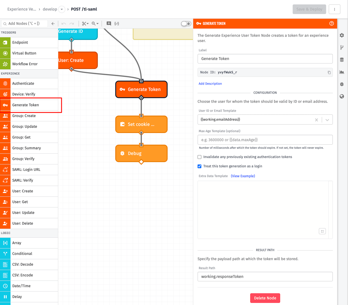

Generate Experience User Token Node
The Generate Experience User Token Node allows a workflow to create a token for an Experience User that can be used for authorized requests against Experience Endpoints.
The Authenticate Experience User Node has two sections:
  • Configuration: You must specify a user for the new token. You can also configure the expiration of the token and include extra data.
  • Result Path: Payload path to store the new token.

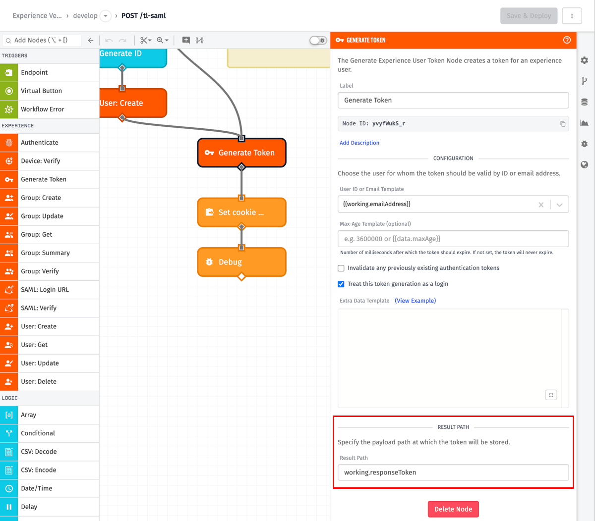

Result
The generated token is then stored at the payload path specified in the "Result Path" field.
Generate Experience User Token Node Result
If the user specified in the "ID or Email Template" field was not found, the value stored at this path on the payload will be null. Otherwise, it will be the generated token string. In the example above, the token string will be placed at the path data.generatedToken.
Here's an example output from running the above workflow...
"generatedToken": "*****REDACTED*****",
This node will never place an error on the workflow payload.
