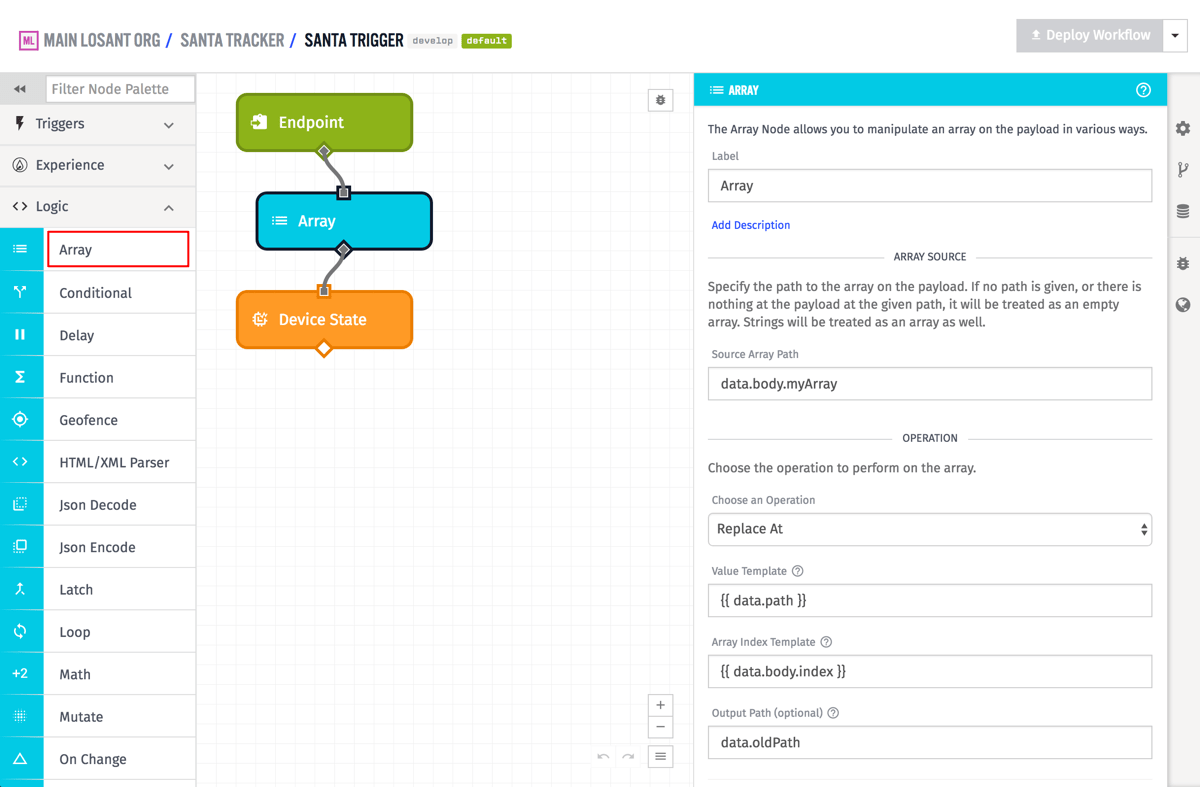

Array Node
The Array Node allows a workflow to perform operations against an Array on the payload.

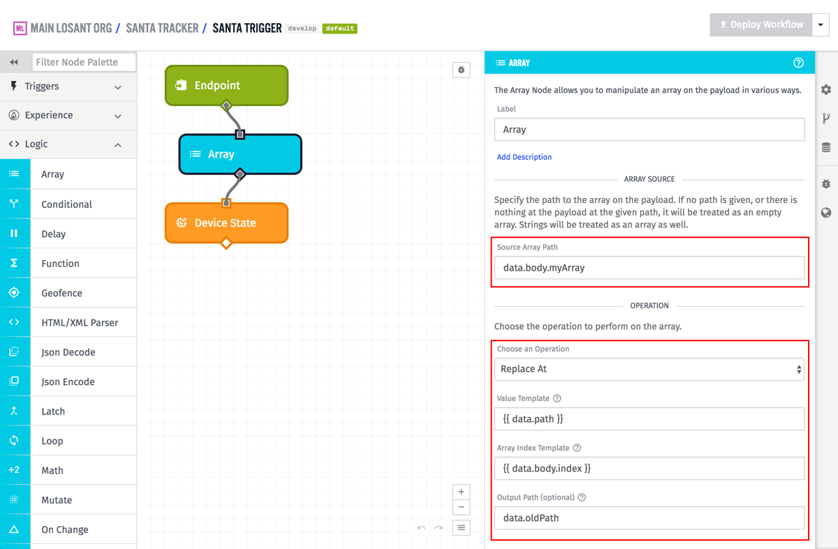

Array Source
The Source Array Path is the location on the payload at which the node will look for an array. If there is not an array at the given payload path, an empty one will be created at that path. If the given payload path is a string, the string will be treated as an array of characters for the array operation, but will remain a string on the payload.
If the operation modifies the original array, you can specify a destination path where the altered array will be stored.
Operation
Once you have configured the array that the node will operate on, then you can choose and configure one of the following operations to perform.

Remove At
The Remove At operation is used to remove am item at a particular index in the array. It takes two arguments, the first of which is a templatable array index. Negative numbers are acceptable, and will operate from the end of the array instead of the beginning. The second argument is optional, and is a payload path where the removed element will be placed. If the index was not within the bounds of the array, the removed element will be undefined.
Replace At
The Replace At operation is used to replace an element at a particular index in the array. It takes three arguments, the first of which is a templatable value that will be used as the replacement element. The second is a templatable array index. Negative numbers are acceptable, and will operate from the end of the array instead of the beginning. The third argument is optional, and is a payload path where the replaced element will be placed. If the index was not within the bounds of the array, the replaced element will be undefined (but the replacement element.will still be added to the array at that index).
