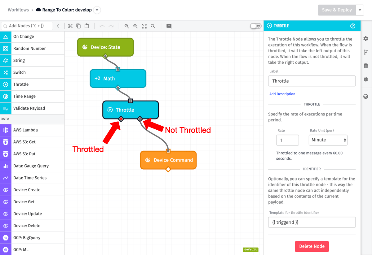

Throttle Node Example
In the above example, the workflow will follow the right route out of the Throttle Node and proceed to send a device command only if it has been at least a minute since the last time the workflow went down that route. If it has been less than a minute, the workflow follows the left route - and since there is no node attached to the left route, the execution of the flow stops.
