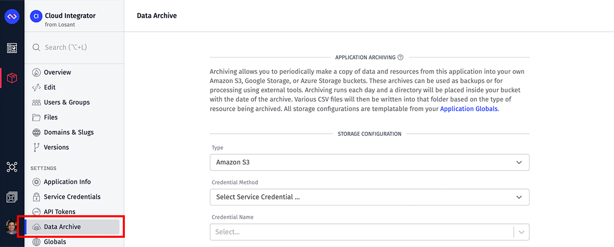

Application Archiving
Application Archiving is a way to save a copy of an Application's Device data, Events, and/or Data Tables on either Amazon S3, Google Cloud Storage, or Microsoft Azure Blob Storage. Application archiving configuration can be found under the "Data Archive" link in an application's subnavigation.
Application Archive
The archive configuration allows you to specify which Devices', Events', and Data Tables' data should be backed up. After your archive configuration has been set, you have the option to backfill your device data archive and fully archive Events and Data Tables.
Note: Application archiving is only available in organization-owned applications.

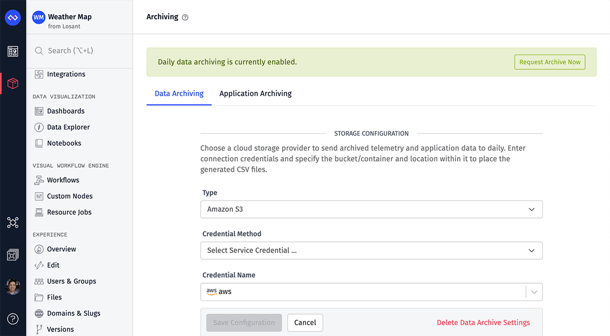

For each storage service provider, you can select a Service Credential to authenticate the request. If selected, you'll be required to provide a Credential Name from a dropdown list of your Service Credentials.
If a Service Credential is not selected, each storage service provider requires its own connection configuration:
  • Amazon S3: Requires "Region", "Access Key ID", and "Secret Access Key" for configuration.
  • Google Cloud Storage: Requires "Account Key (JSON)" for configuration. You may optionally provide a "Project ID", which will override the Project ID associated with the service account key.
  • Microsoft Azure Blob Storage: Requires "Account Name", and "Account Key" for configuration.
All three require a "Bucket" (or "Container" for Azure).
All three have the optional field "Directory Inside the Bucket" (or "Container" for Azure), which specifies a directory for archival files to go; if left unset, the files will be appended to the top-level directory.

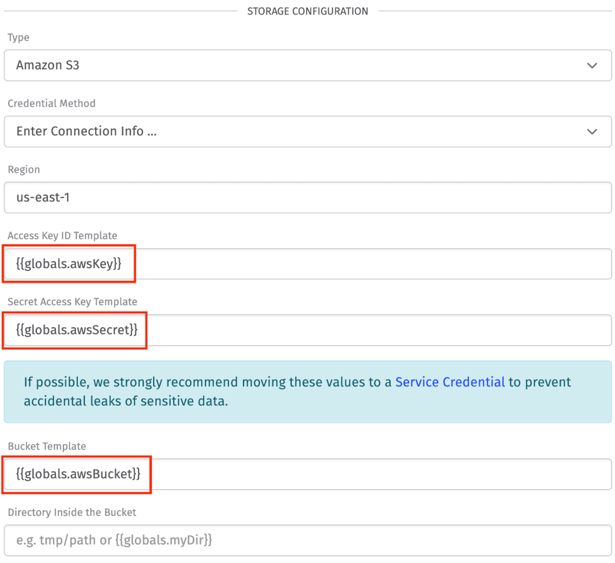

Templating
All archive configurations are templatable (except for Credential Method and Credential Name) via your application globals.
Application Archive Templating
Note: If a template is provided for a configuration field, it must resolve to a valid value in order to save the archive configuration.

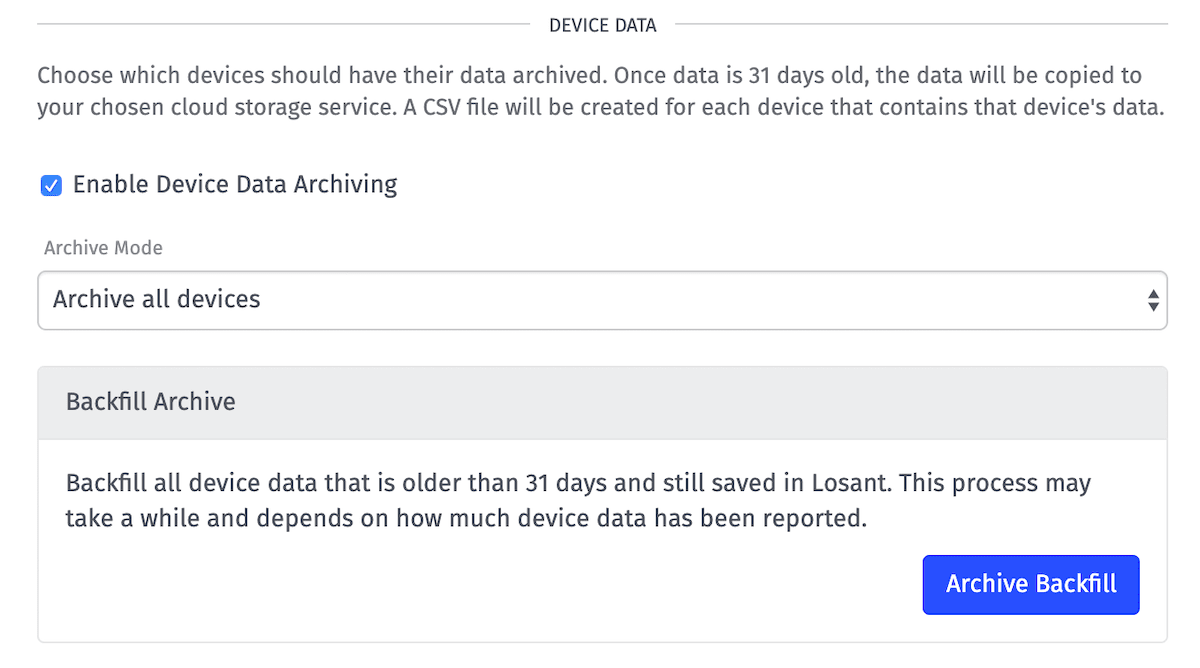

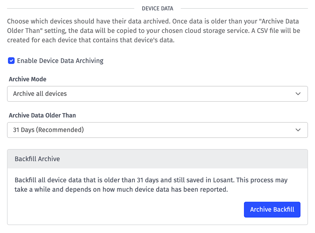

Device Data
If "Enable Device Data Archiving" is selected, Devices matching your Archive Mode will be archived.
Application Archive Device Data

Device Data Archive Modes
When specifying the "Archive Modes," the following options are available:
  • Archive all devices: All Devices within the application will be selected for data to archive.
  • Archive all EXCEPT these devices...: A blacklist of Devices and/or Device Tags.
  • Archive ONLY these devices...: A whitelist of Devices and/or Device Tags.
There is also an "Archive Backfill" button which will immediately enqueue a job to archive data from 31 days ago.

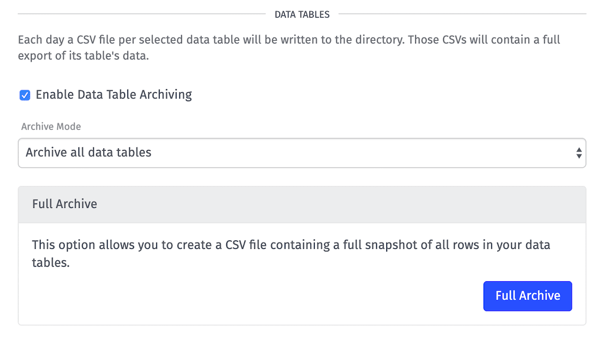

Data Tables
If "Enable Data Tables Archiving" is selected all Data Tables matching your "Archive Mode" will be archived.
Application Archive Tables
Data Tables Frequency
Data Tables are archived daily. Each day, Losant will create a directory in the configured storage service that represents the archived date. The directory will contain a CSV for each Data Table.
Data Tables Archive Modes
  • Archive all data tables: All Data Tables within the application will be selected for data to archive.
  • Archive all EXCEPT these data tables...: A blacklist of Data Tables.
  • Archive ONLY these data tables...: A whitelist of Data Tables.
There is also a "Full Archive" button which will immediately enqueue a job to archive all Data Tables connected to the application.
