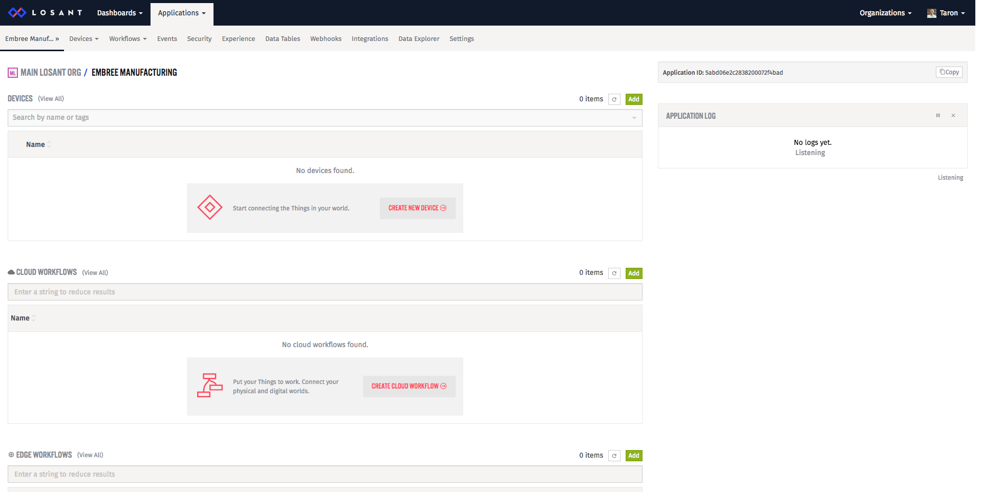

Next, you’ll need to create an application.
New application

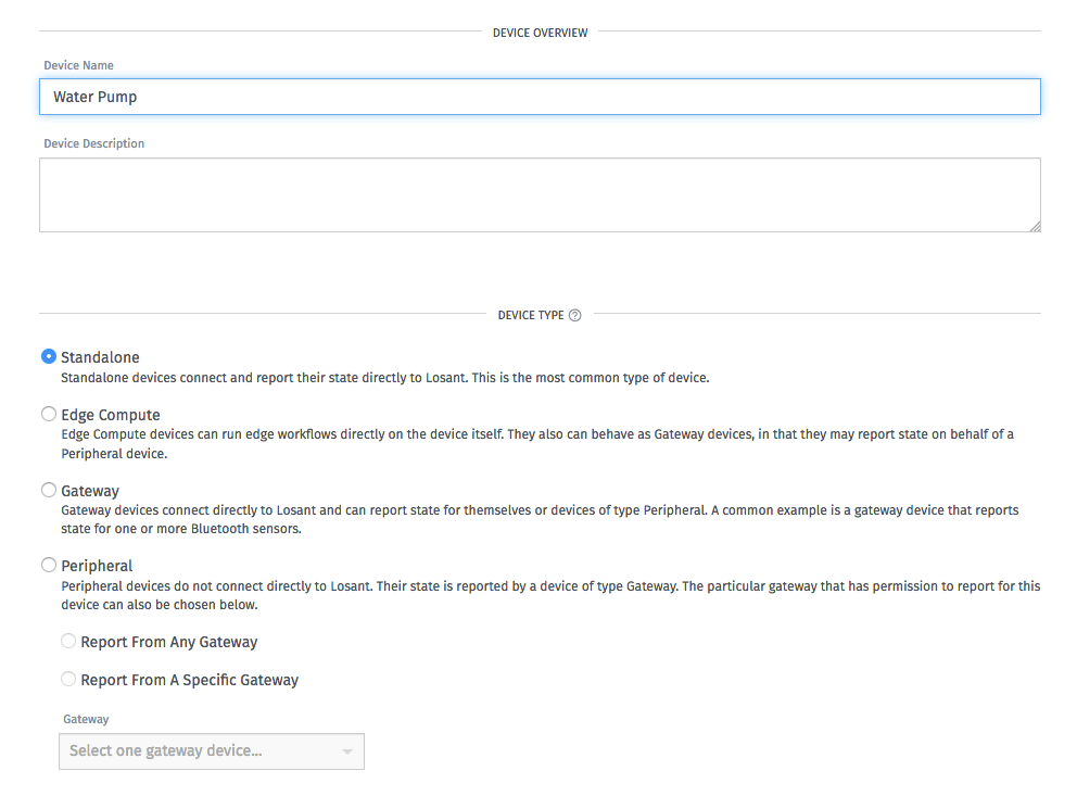

Next, we can create a new device for our water pump.
New Device
For this experiment, Embree connected a pump to the internet using cellular—so it has the ability to send data directly to Losant. Because it connects directly, the device will be a standalone device type in Losant.

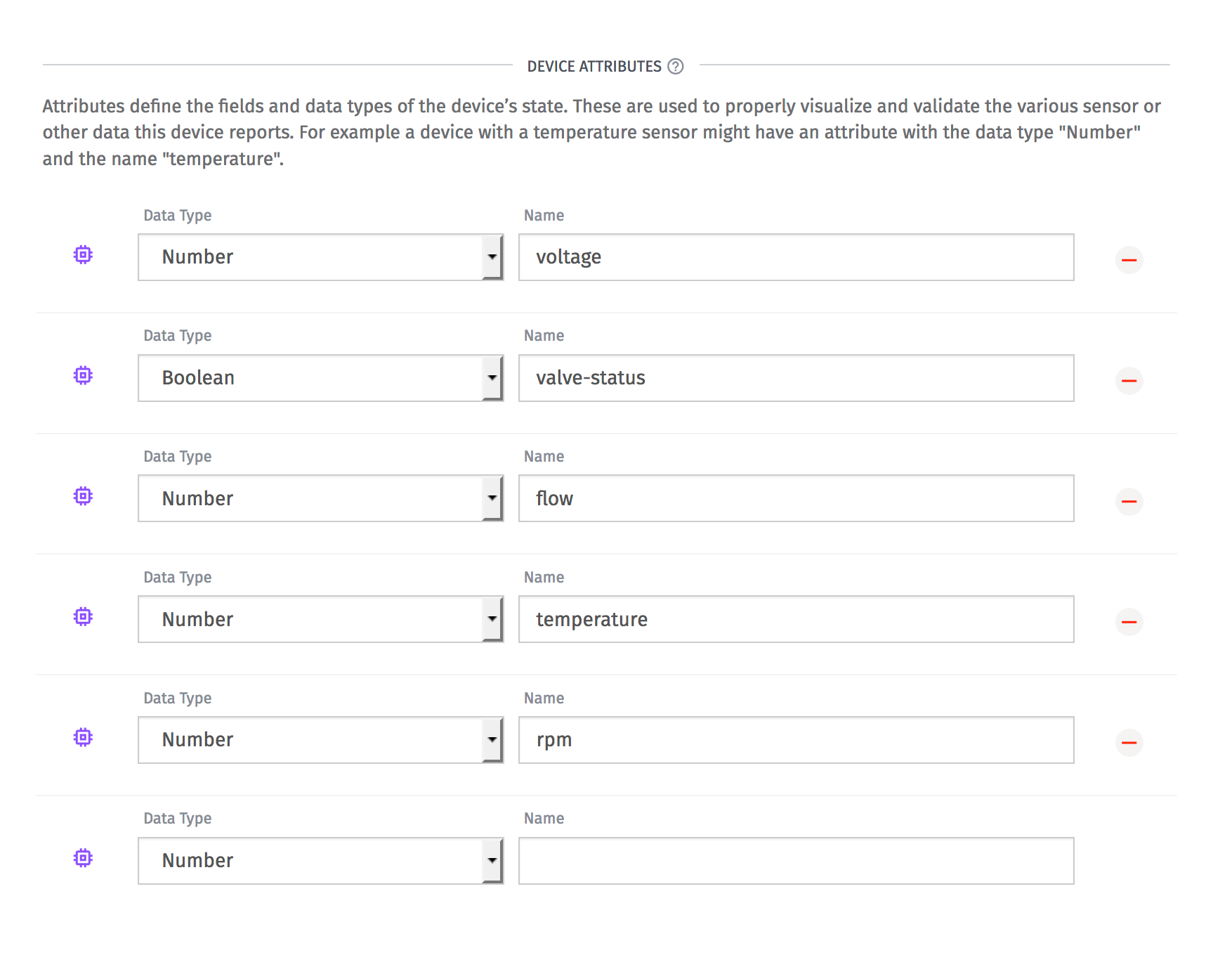

Next, we need to give the device some attributes. Right now, all pumps are actively measuring:
  • Battery Voltage
  • Valve Status
  • Flow (liters per second)
  • Temperature
  • RPM
Each of these data points will be an attribute in Losant. All of them will have the type of number except for the valve status, it will have a boolean type. Here is how that looks within Losant:
Device Attributes
When you are all done with your device settings, save this new device.

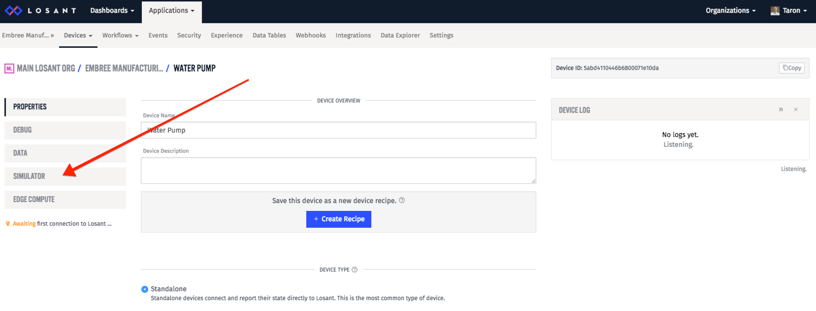

Now, fire up the Device Simulator. If you open up the device page, on the left side, you'll see simulator.
Device Simulator
Device Simulator

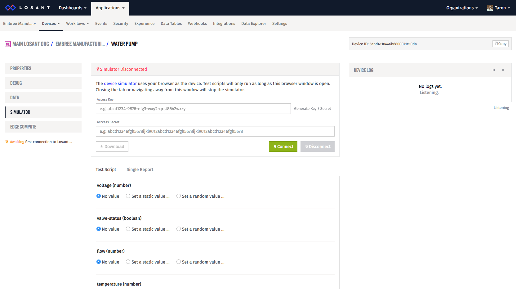

Remember, the simulator is using your browser window as the device. So, you must leave this browser window open for your device to simulate data.
Pro Tip: If you want to simulate data without having your browser window open, you can use the workflow engine. With the Timer Trigger, Random Number Node, and Device State Node, this becomes an easy task.

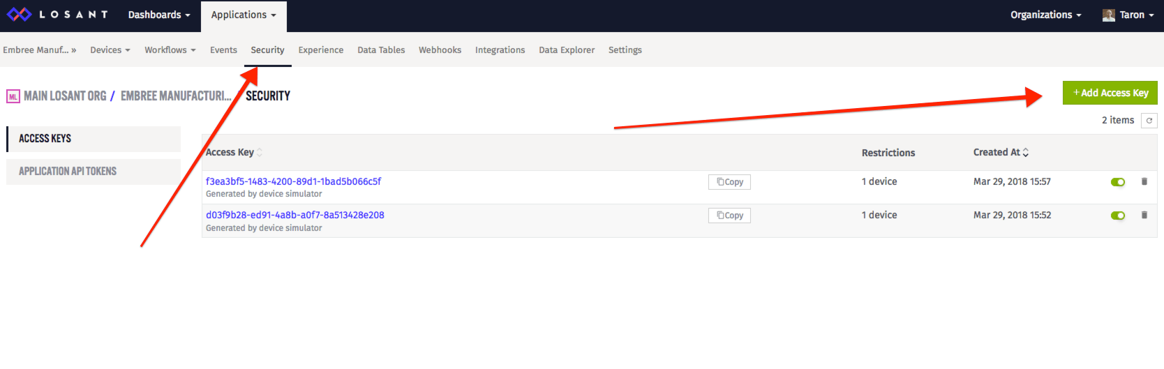

Next, generate a key/secret pair and connect your device**.** Here, we can easily press the “Generate key/secret” button. However, normally, one would go to the “Security” tab in the navigation and create new keys there like so:
Security

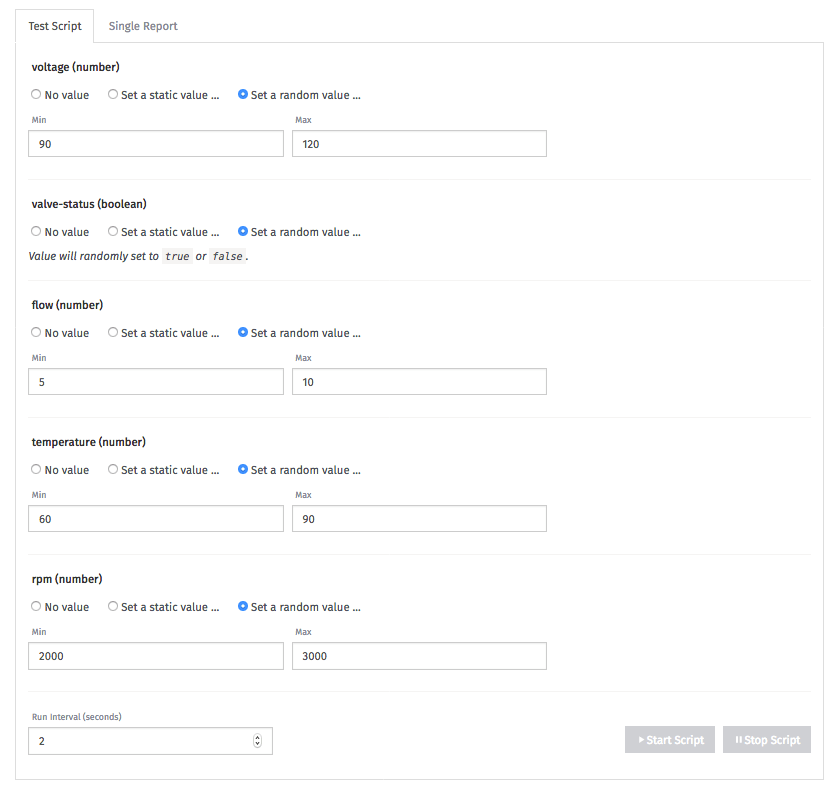

Now, create a test script. You can set all the values to be random:
Device Simulator
Once done, press “Start Script”.

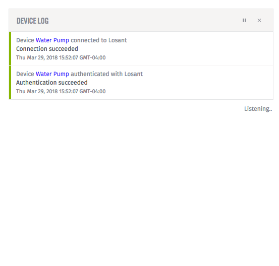

Be sure to check out your Device Log. It’s an indicator that everything is working properly:
Device Log

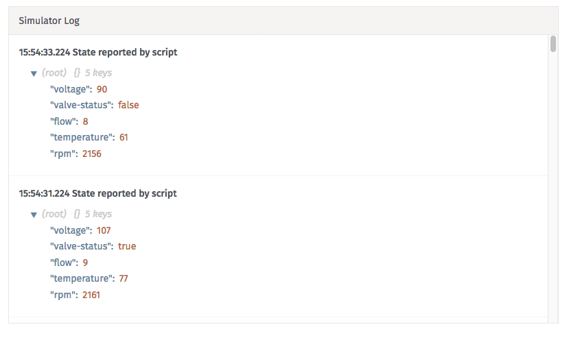

You can also look at the Simulator Log to see the simulator activity.
Simulator Log

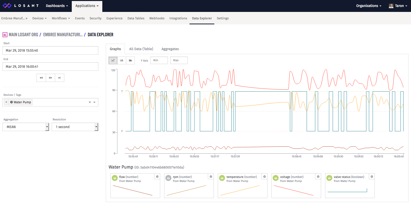

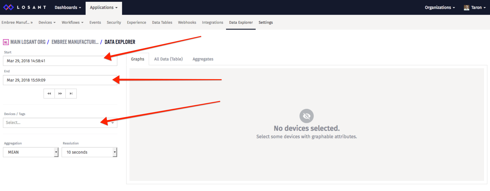

In a new tab, open up your Data Explorer. Once there, choose a proper start time, end time, and device.
Since our simulator hasn’t been running for that long, you can update your start and end time to be the last five minutes. That way, you’ll have a more interesting graph.
Data Explorer
After you choose your device and some attributes, your explorer should look similar to this:
Data Explorer
