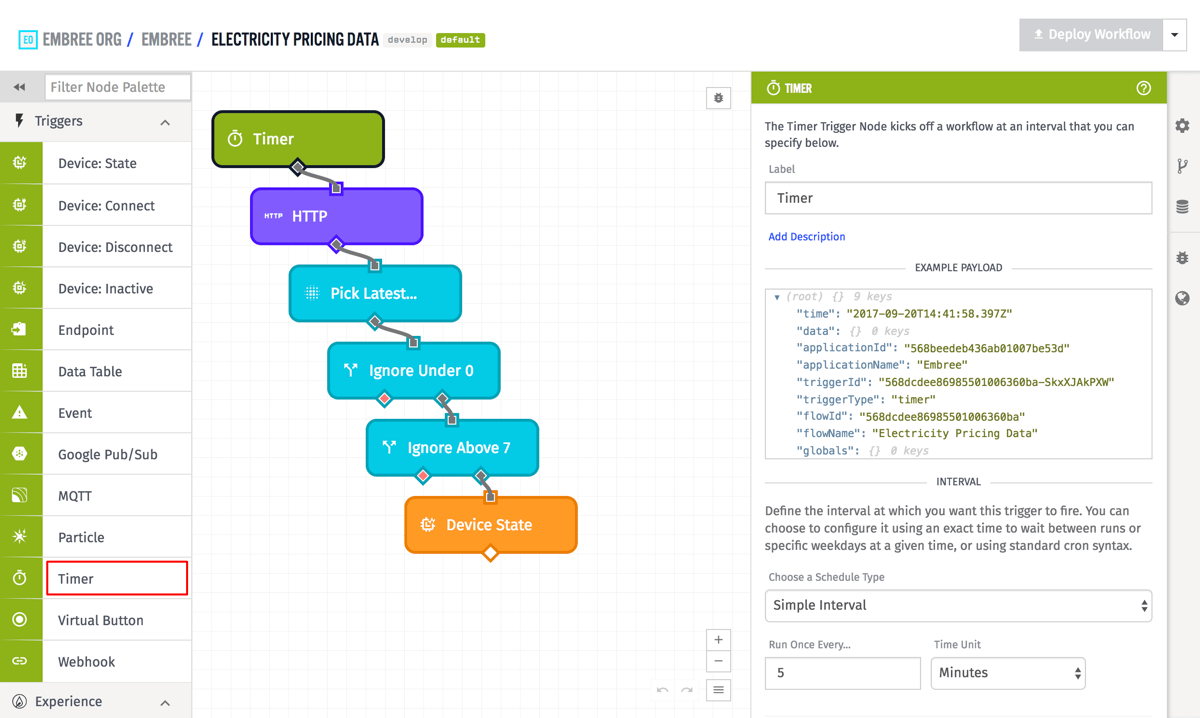

Timer Trigger
The Timer Trigger will fire a workflow on a scheduled interval.

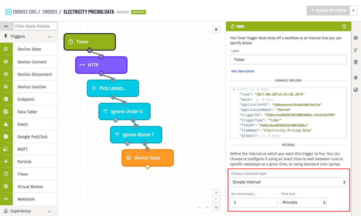

The Timer Trigger can be configured in three different ways:
Simple Interval
Configure the timer to fire after a repeating period of time. Choose an amount (a positive number) and a unit.
Application Workflows: The unit can be "Seconds", "Minutes", "Hours", or "Days". The interval can be any positive number that evaluates to at least 1 second and less than 1 year (fractional intervals are allowed).
Edge Workflows: The unit can be "Milliseconds", "Seconds", "Minutes", "Hours", or "Days". The interval can be any positive number that evaluates to at least 100 milliseconds and less than 1 year (fractional intervals are allowed).
For Gateway Edge Agent v1.12.0 and below, the interval can be any positive number that evaluates to at least 1 second and less than 1 year.
Embedded Workflows: The unit can be "Milliseconds", "Seconds", "Minutes", "Hours", or "Days". The interval can be any positive number that evaluates to at least 100 milliseconds and less than 1 year (fractional intervals are allowed).
Embedded Workflows only support simple intervals; it is not possible to define an embedded workflow's timer frequency using a simple schedule or advanced cron strings. Also, the behavior of the Timer Trigger can vary depending on how time is managed on your Embedded Device.

In the above example, the timer is configured using Simple Interval
, and is set so that the timer will fire every 5 minutes.

For the example workflow above, a specific payload for a triggered workflow might look like this:
"data": {},
"applicationId": "56311a8e51645b2054eb258b",
"applicationName": "Embree",
"triggerId": "78fbb050d7f811e5b995b3a5b31df7d8",
"triggerType": "timer",
"flowId": "56c8967bb8df0f0100d62912",
"flowName": "Electricity Pricing Data",
"globals": {}
