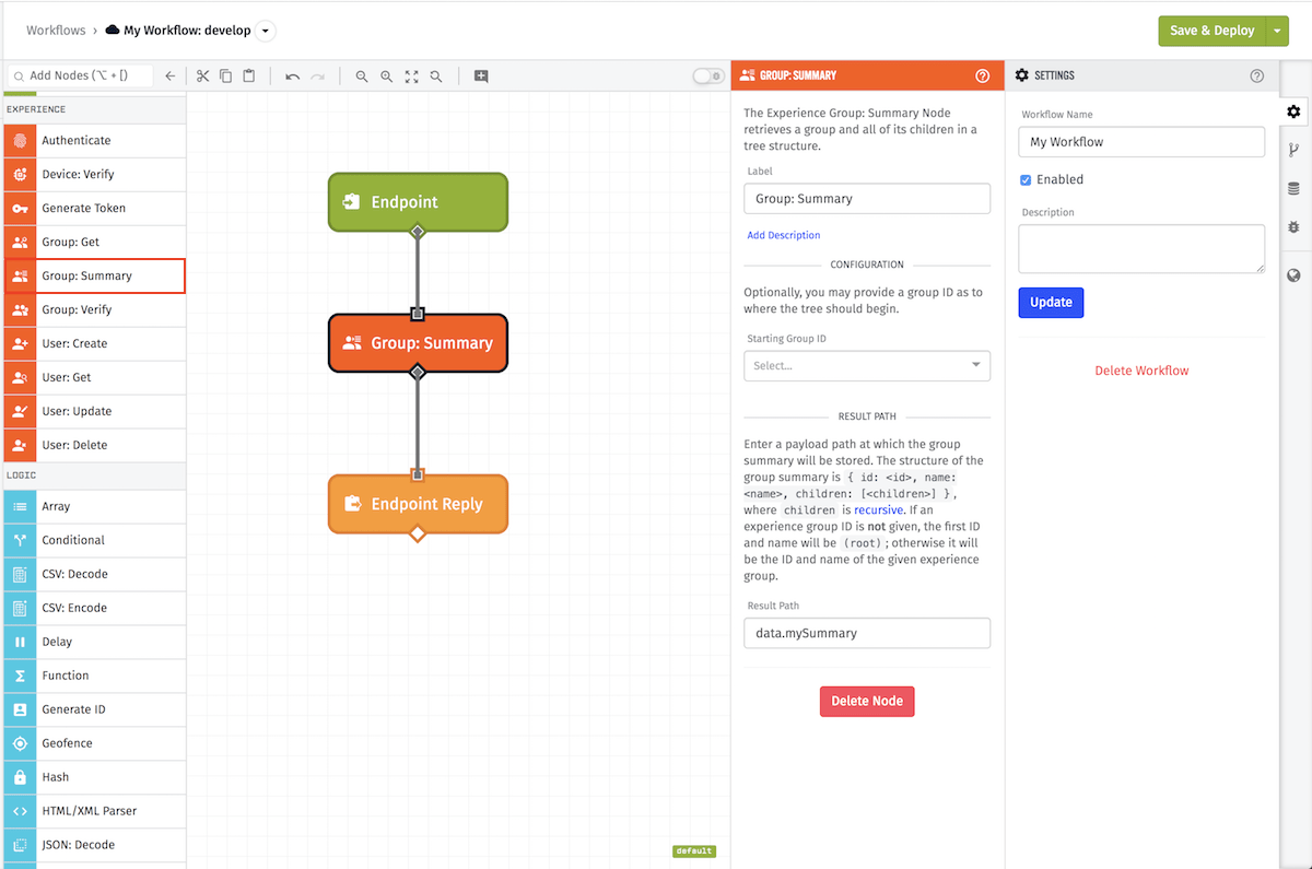

The Group: Summary Node is a node to get the Experience Group tree format. This can start from a given Experience Group ID or it can give you all of your groups. This is useful to display Experience Groups within an Experience Page.
Get Experience Group Node Configuration
  • Starting Group ID: (Optional) You may input a starting node, to begin the tree. This name and id will be the first on the tree, and it's children, if any, will be in it's children list.
Get Experience Group Node Result
Result path is required, and it is the location on your payload where the results of the tree will be placed.
This example would be of an entire tree being returned.
