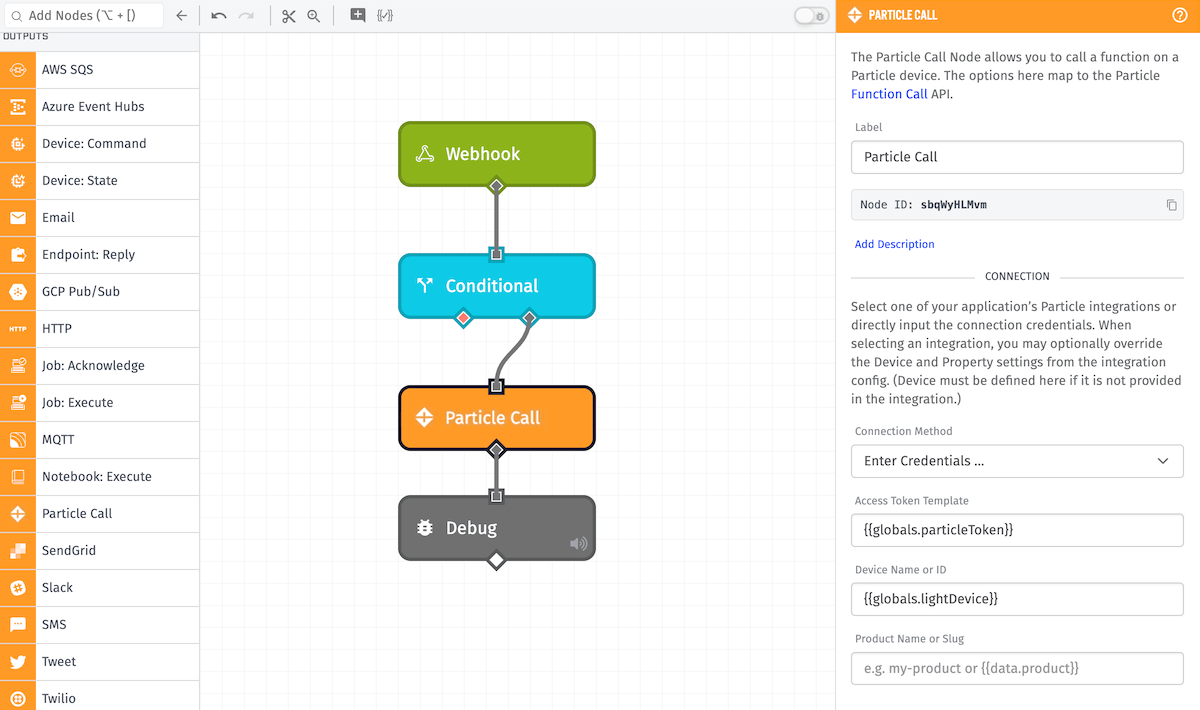

Particle Device Function Call Node
The Particle Call Node allows a workflow to call a remote function on a device within Particle.
Configuration for the node is broken up into three sections.
Connection
There are two Connection Method options available:
- Choose an Integration: Retrieves your Particle configuration from the selected Integration.
- Integration: Choose which of your application's Particle integrations you would like to publish the message on. The ID is templatable. Note: Integrations are not accessible from Edge Workflows, so only direct configuration is available to them.
- Enter Credentials: Configure the Particle connection directly within the node.
- Access Token Template: A Particle access token that has access to the target device.
This section also takes the following inputs:
- Device Name or ID: A device identifier. If it is not provided by an integration, then this field is required.
- Product Name or Slug: The product that this device belongs to inside of Particle. This field is optional, and templatable.
