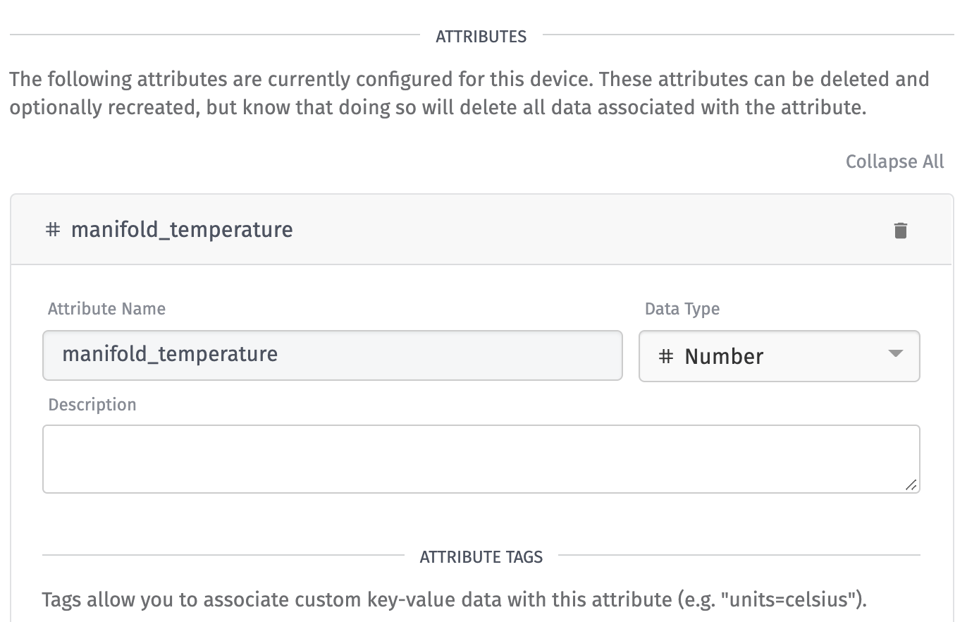

  2. Add one or more device attributes depending on the telemetry information your device reports.
The device below reports the temperature, so there is one attribute named "manifold_temperature" with the data type set to "Number".
New Temperature Device Attribute

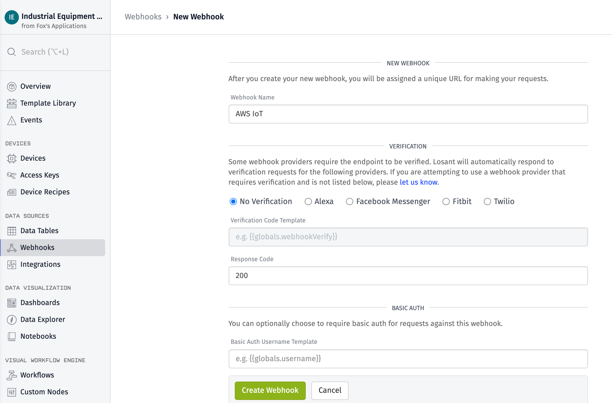

Let's create a Webhook:
  1. Navigate to “Webhooks” in the Application Menu.
  2. Name the webhook.
  3. Click “Create Webhook.”
Creating a Losant Webhook
After you create the webhook, you'll be presented with its URL.
https://triggers.losant.com/webhooks/YT6wZZcDB-SYrDKbbM5NTm1U4cqATjTYdd58rNSb
Keep note of the URL as we will use it in our Lambda Function.

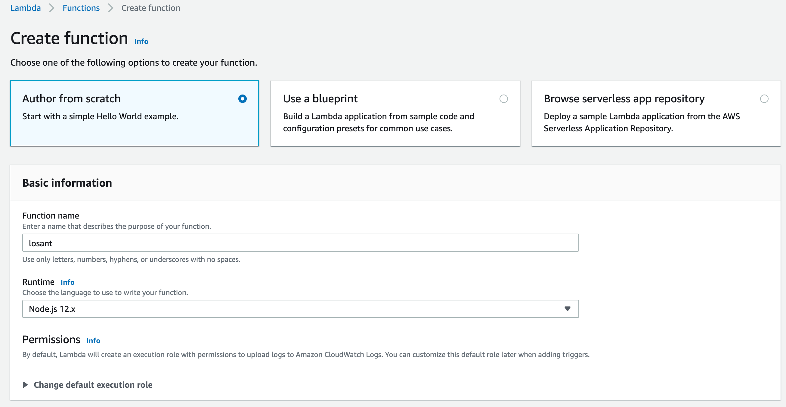

Create the Lambda Function
Within the AWS portal, create a new blank Lambda function.
Creating a Lambda Function

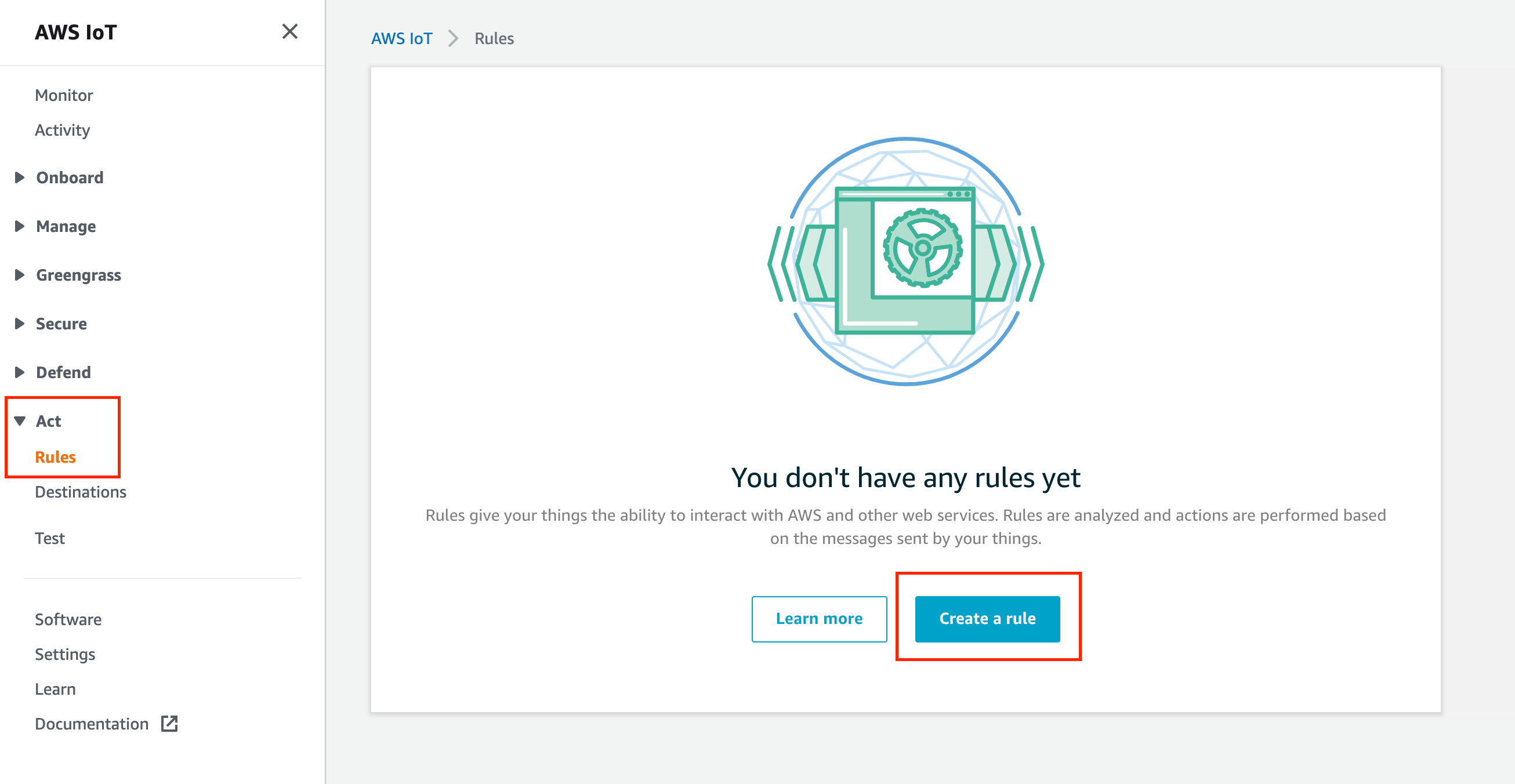

Create the AWS IoT Rule
The rule you create will send data into Lambda whenever specific topic or attribute is recorded. To create the rule:
  1. Within AWS IoT, navigate to the Rules section.
  2. Create a new rule.
Create a new AWS IoT Rule

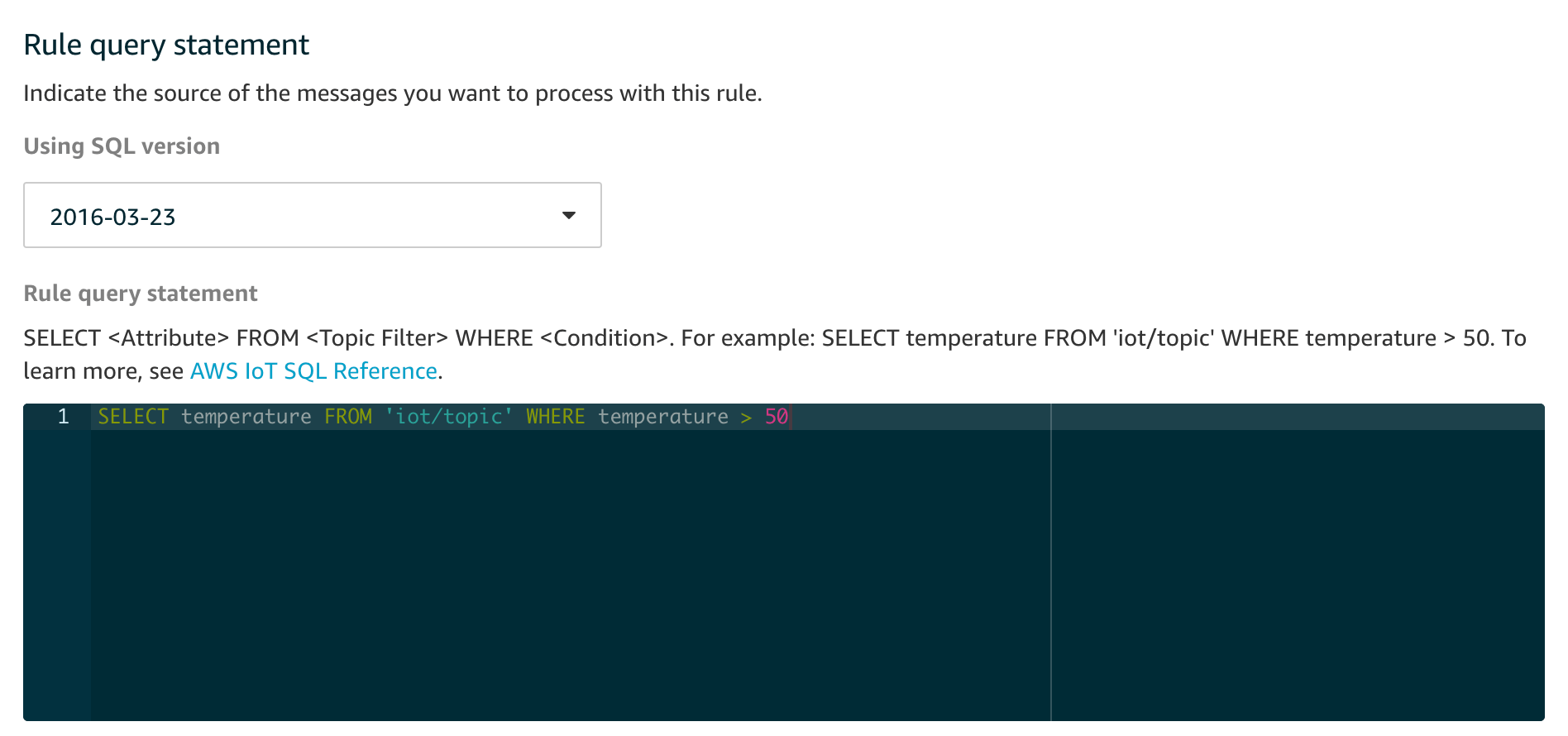

  1. Configure the "Rule Query Statement";
Configure the "Rule Query"
Here is an example query:

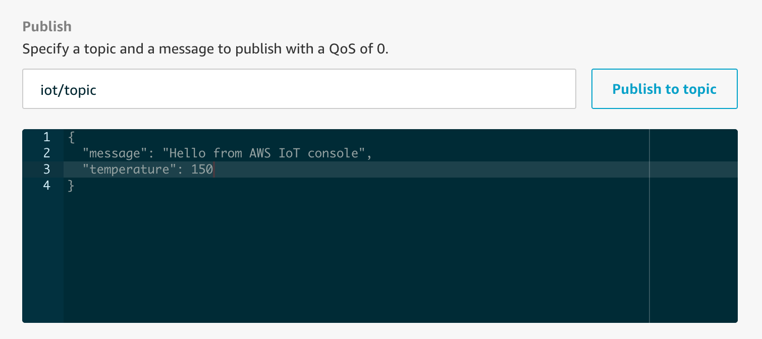

SELECT temperature FROM 'iot/topic' WHERE temperature > 50
With the above query, we can trigger the rule using AWS Publishing Tool with the following data:
Example Temperature Publish to AWS IOT to trigger Rule
For more information see AWS IOT SQL Reference.

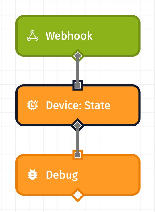

Here is the Application Workflow we are going to create:
Lambda to Losant Workflow

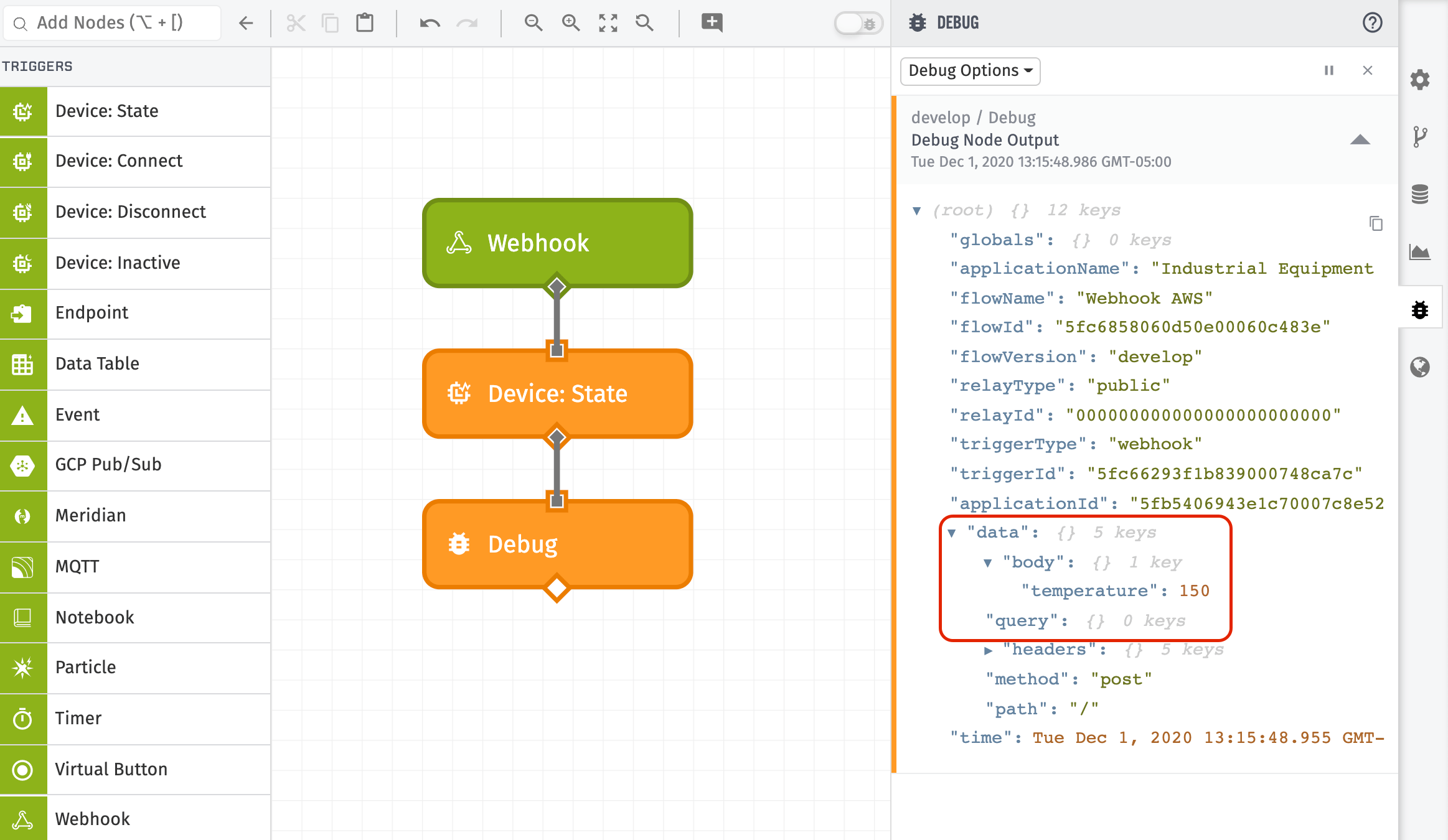

When this Workflow is triggered, you will get a payload that looks like this:
AWS IoT Core payload
We can see that the data from the Lambda HTTP POST request can be found at:
data.body.temperature
We can now build our workflow to use this data within Losant. To create this workflow:
  1. Drag a Webhook Trigger onto the workflow canvas. Select your Webhook in the node's configuration.
  2. Connect a Device: State Node to the Webhook Trigger. This allows a workflow to save data to Losant's time-series database.
  3. Connect a Debug Node to the Device: State Node.

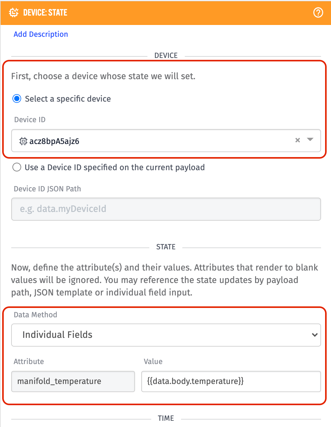

Next, we can configure the Device: State Node:
  1. Select your Device you created in the previous step.
  2. In the state configuration, add a template with the payload payload path of: {{data.body.temperature}}.
Configure Losant Device: State Node

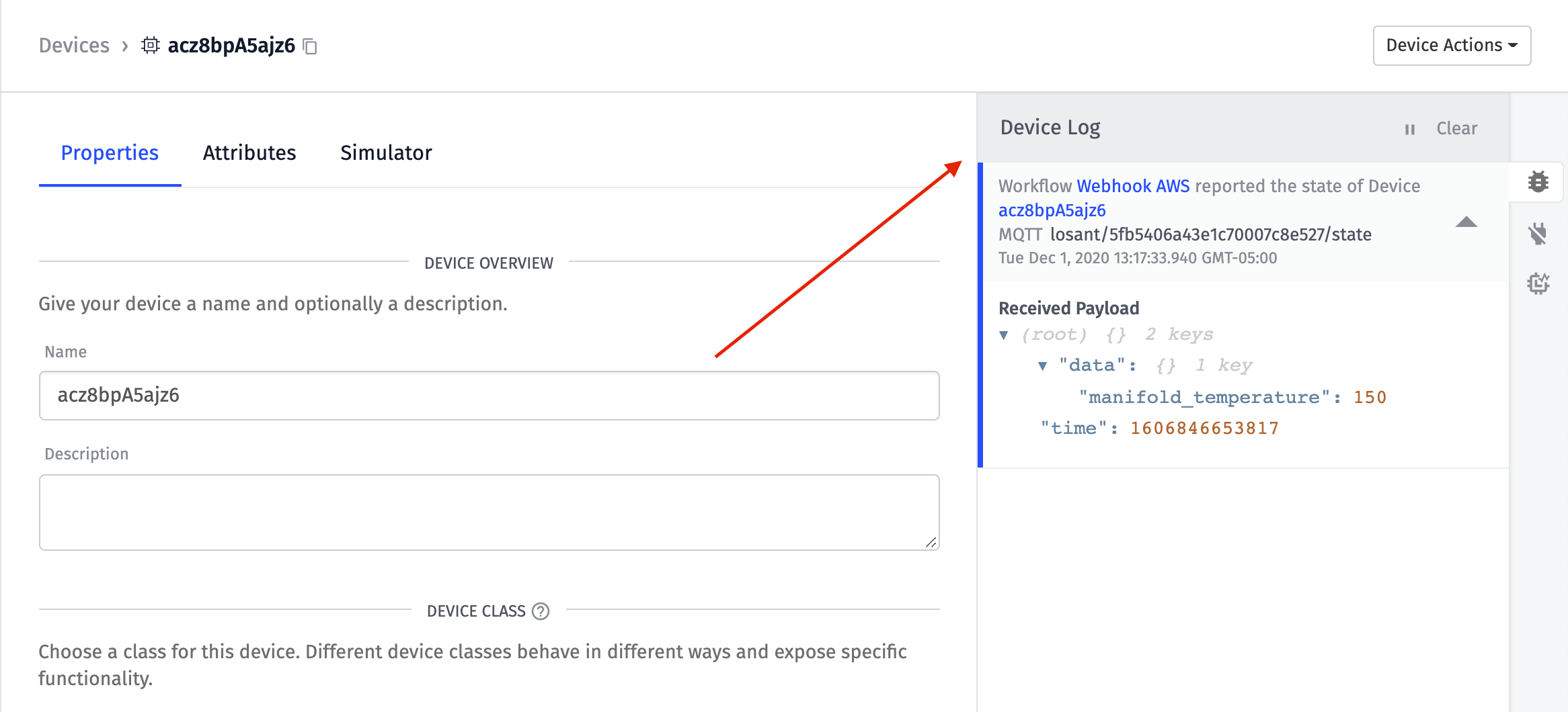

If your device is properly reporting state, you can see this reflected in your Device Logs:
Viewing Losant Device Log
