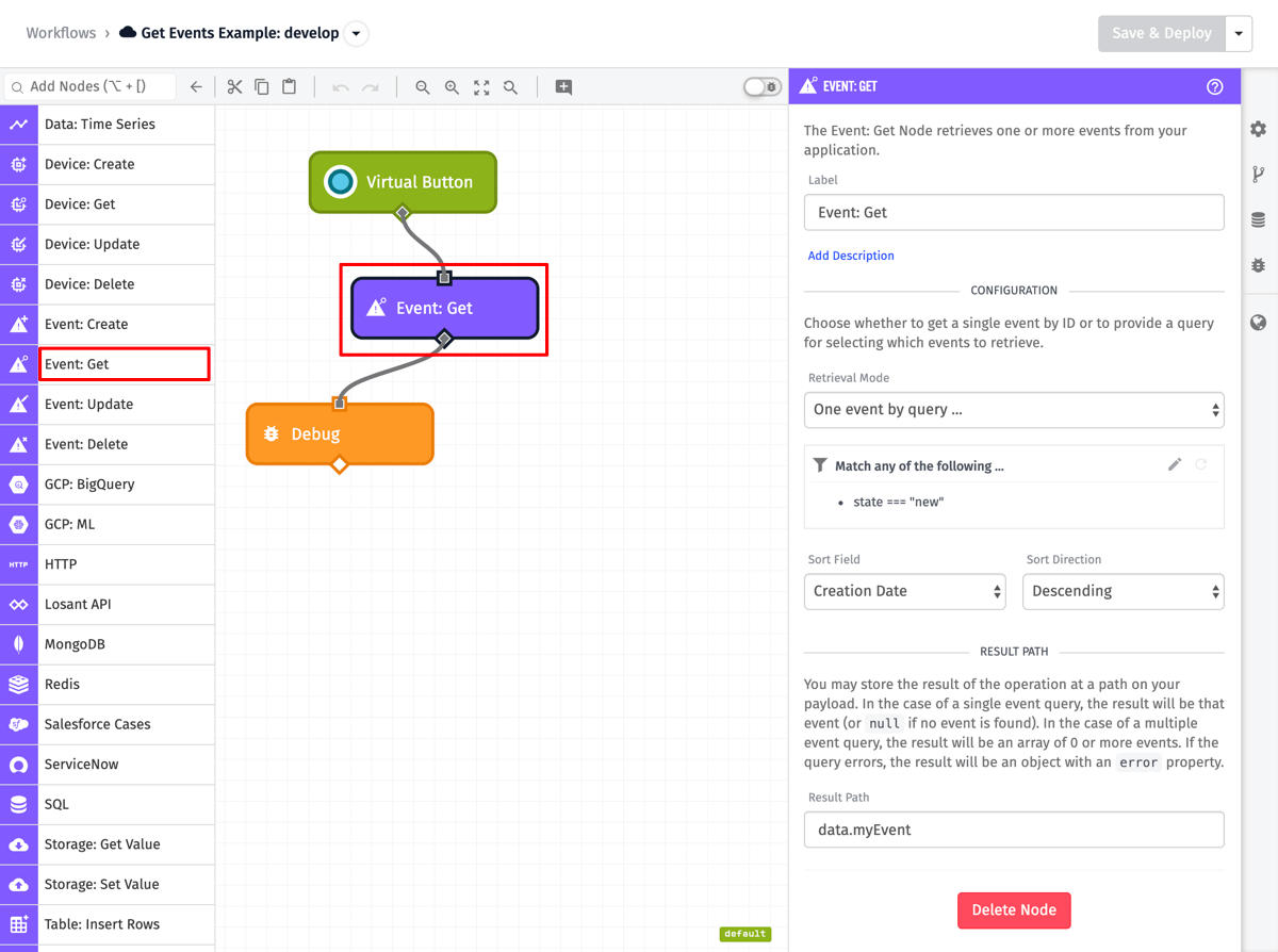

Event: Get Node
The Event: Get Node allows a workflow to retrieve one or more Events from the current application and add them to the current workflow payload.
The configuration for the Event: Get Node requires a query method and parameters to find a device connected to Losant.
Retrieval Mode
The first step is selecting a retrieval mode method to use to find an event or group of Events. The Event: Get Node has three different options:
One Event By ID: You can input a specific event's ID to retrieve it or use a value on the payload. The ID can be hardcoded in the workflow editor or derived from a property on the current payload.
One Event By Query: You can create an advanced query to retrieve a single event. This query is templatable, and so part or all of the query can come from the current payload.
Multiple Events By Query: You can create an advanced query to retrieve multiple Events. This query is templatable, and so part or all of the query can come from the current payload.
Sort Field and Direction
When retrieving one or multiple Events by query, you can set the Sort Field
and Sort Direction
In the case of retrieving a single event, this controls what event will be returned when multiple Events match the query. In the case of retrieving multiple Events, this controls the order of the Events returned.
By default this will sort by creation date, descending (which means in the single event case, it will return the most recently created event matching the given query).

It is required you specify where on the payload path you want the event or group of Events to be placed.
If you are querying for a single event, the event will be placed at that path (or null
if the event is not found). If you are querying for multiple Events, the result will be an array of Events (potentially an empty array if no Events were found).
