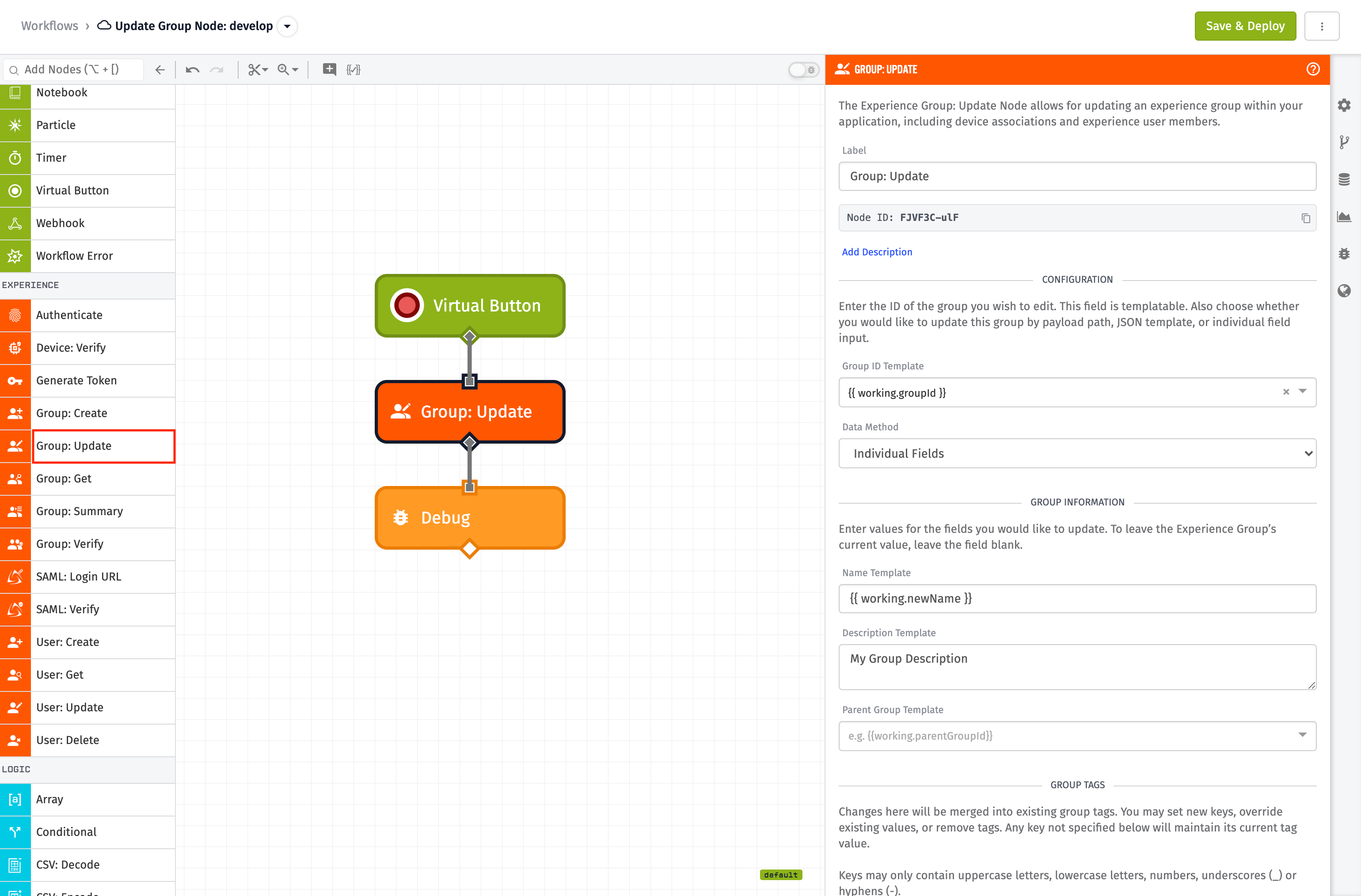

The Group: Update Node allows a workflow to update an existing Experience Group inside the current application, and optionally add the updated group to the current workflow payload.
Group: Update Node

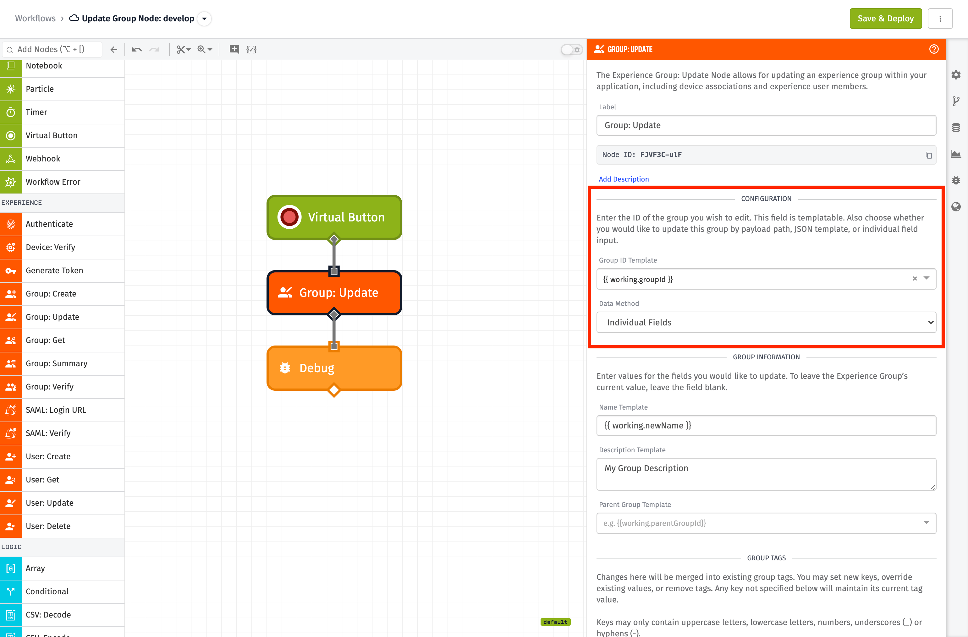

For finding the group to update, the node can find by group ID. This field is templatable, so it supports finding a group based on the current workflow payload. The example below is doing exactly that, and is referencing the field working.groupId on the workflow payload.
Group: Update Node Configuration

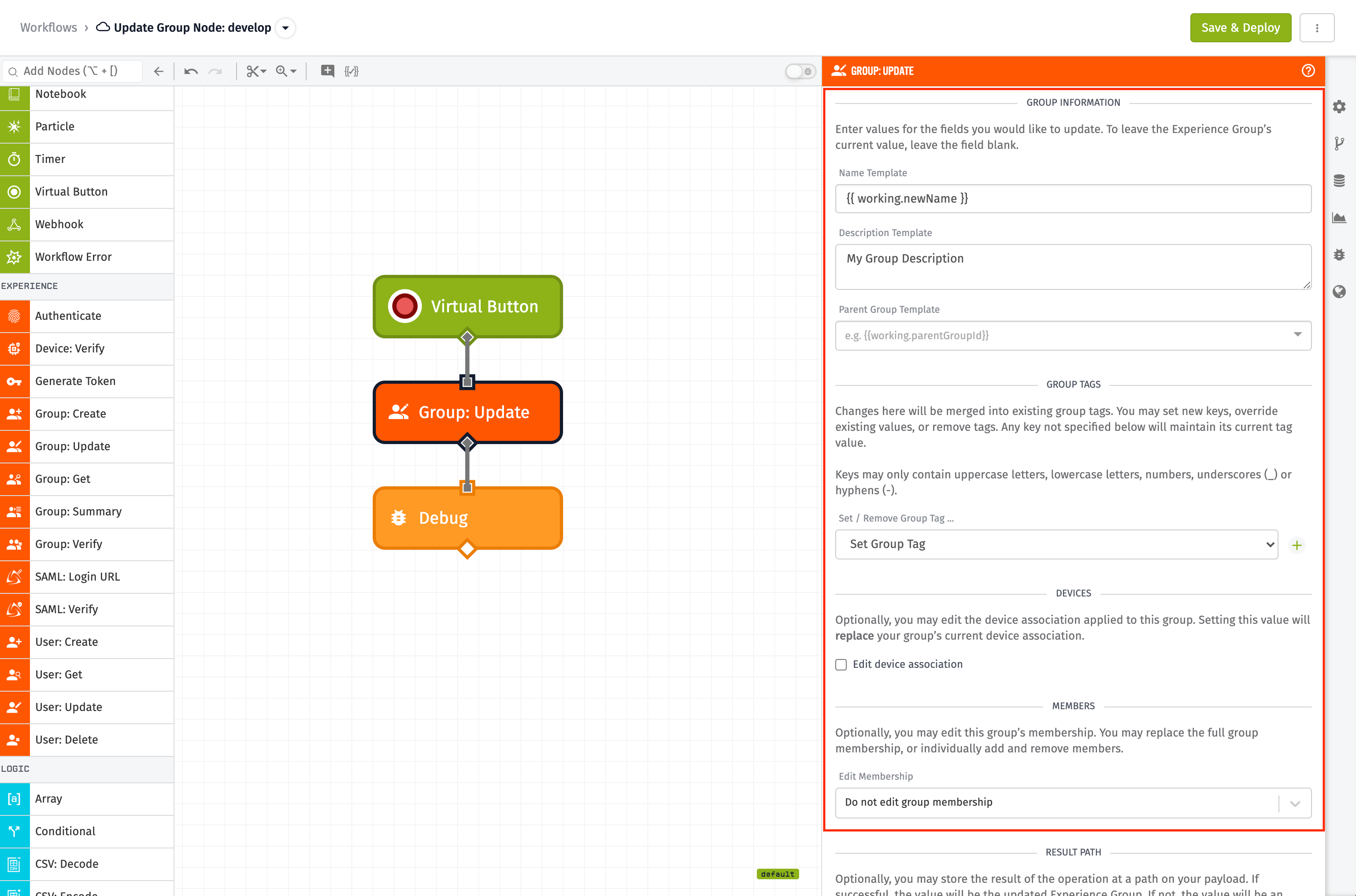

Using this option, the block configuration is separated into various string templates fields:
  • Name—Name of the group.
  • Description—Description of the group.
  • Group ParentParent group of the group to be updated.
  • DevicesAdvanced query that defines the devices to be associated with the updated group.
  • Group TagsTags to apply to the new group.
  • Members—Add, remove, or replace all existing group users.

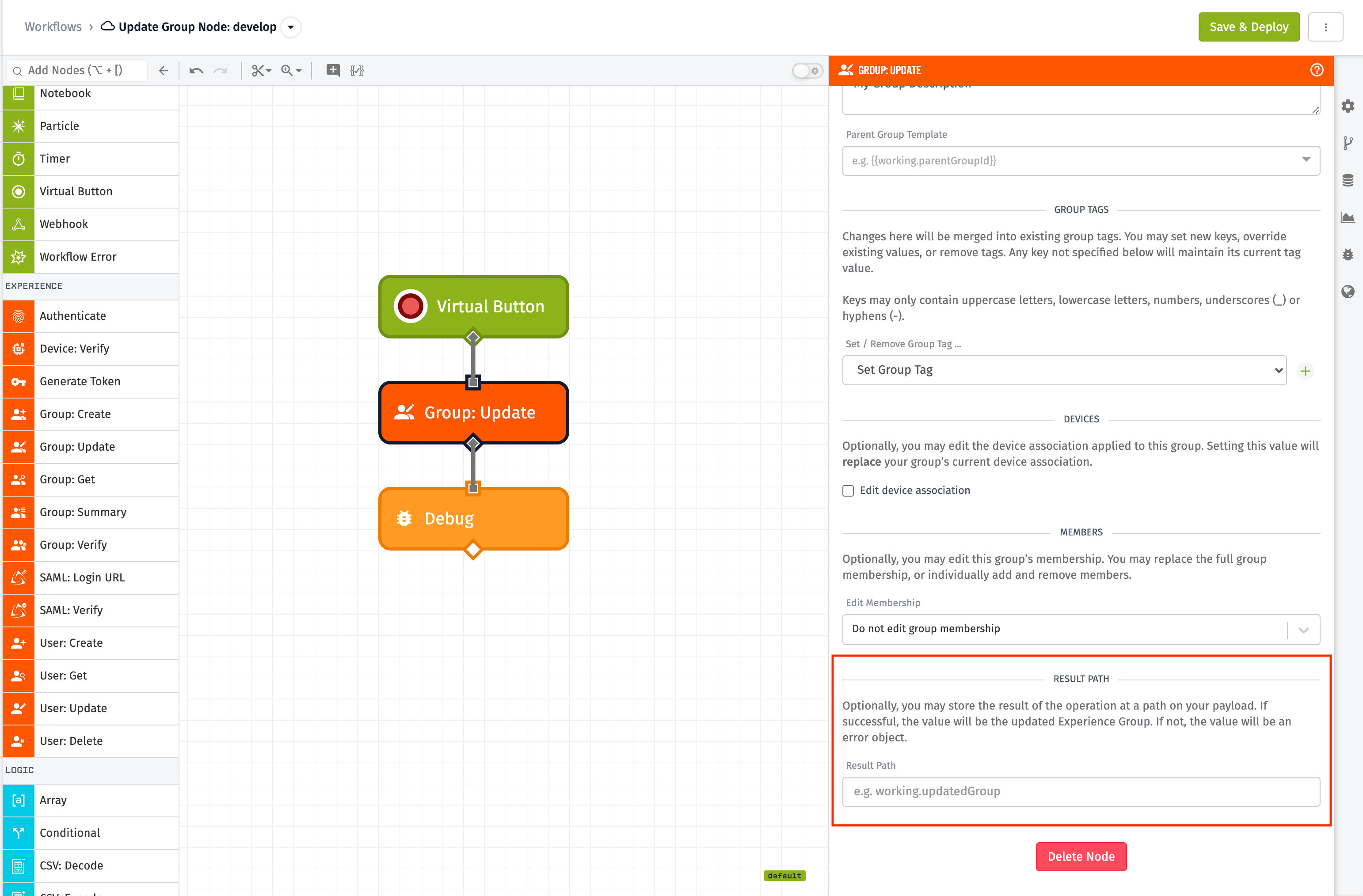

Result
Optionally, you may provide a payload path at which to place the result of the operation.
Group: Update Node Result
