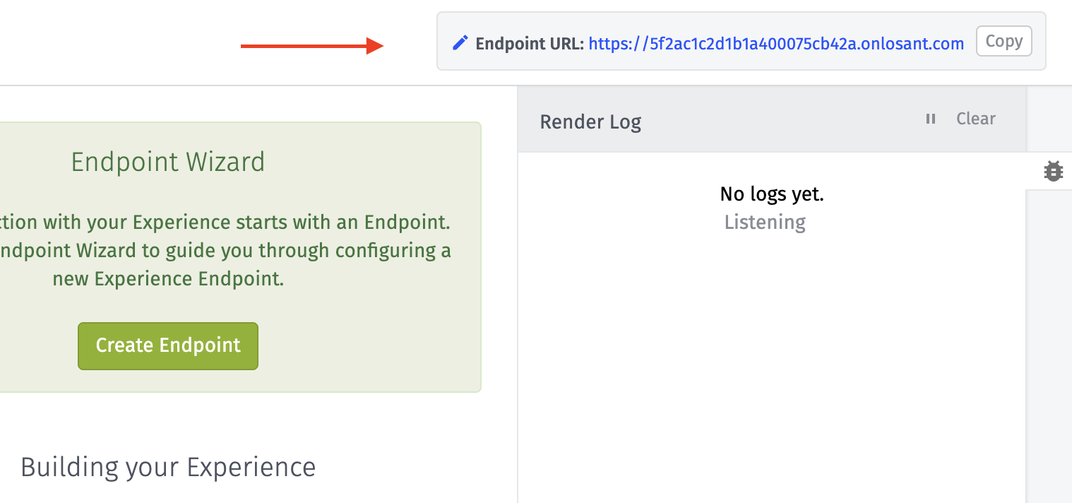

Getting an Endpoint URL
To follow along, you’ll need a Losant Experience with an Endpoint URL. You can acquire this in three ways:
Once you have an experience, you can find the URL on the “Edit” page within the Experiences Menu:
"Endpoint Url"

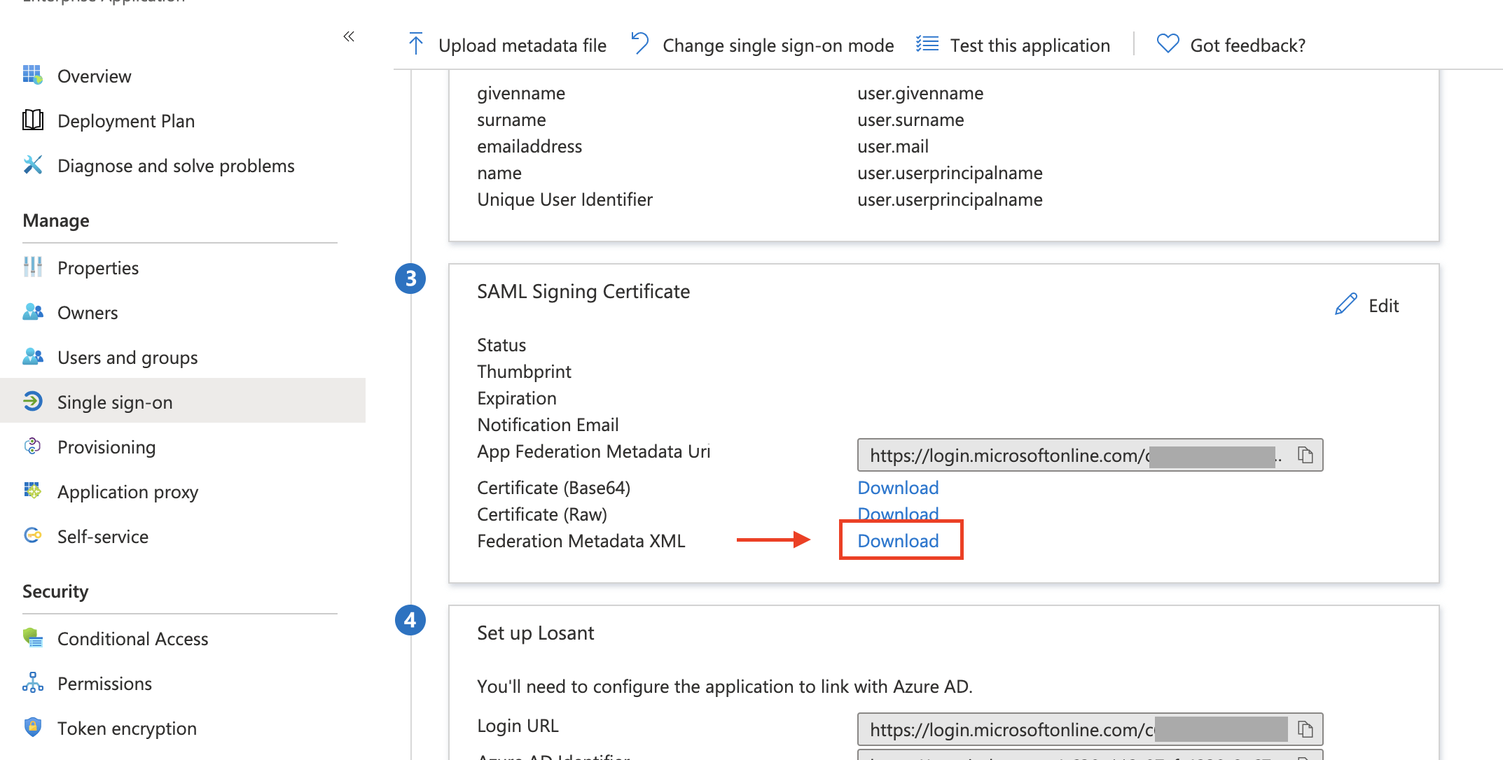

Next, you need to acquire an Identity Provider Metadata Template from the identity provider, which in this case is Active Directory:
  1. Add an application to your Azure Active Directory.
  2. Set up single sign-on (SSO) for an application in your Azure Active Directory.
  3. Download the “Federation Metadata XML.” You can find this within your Azure Active Directory single sign-on application settings:

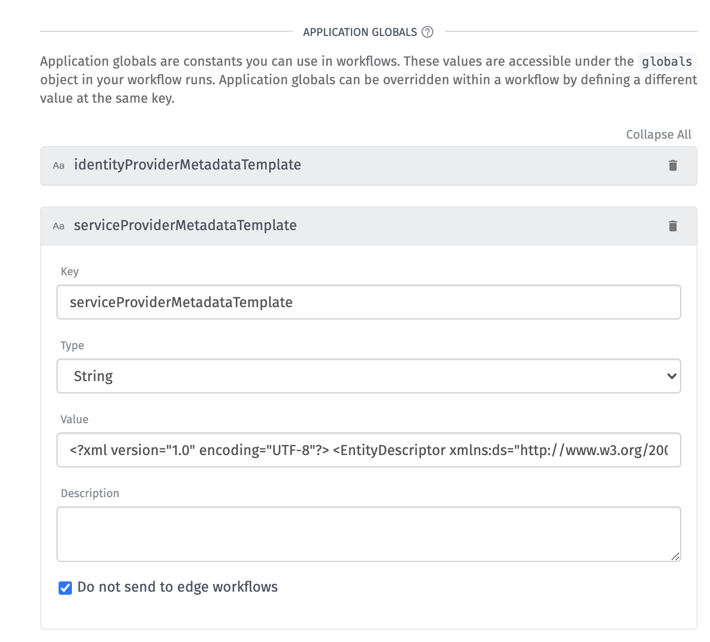

Setting Global Configuration
It’s best practice to use application globals to store application-wide configuration that may be used across multiple workflows, like phone numbers or API keys. Application globals are a set of key/value pairs that are accessible inside of a workflow.
In this case, you can use them to store the SSO configuration to be used later within the SAML Nodes.
Application Globals

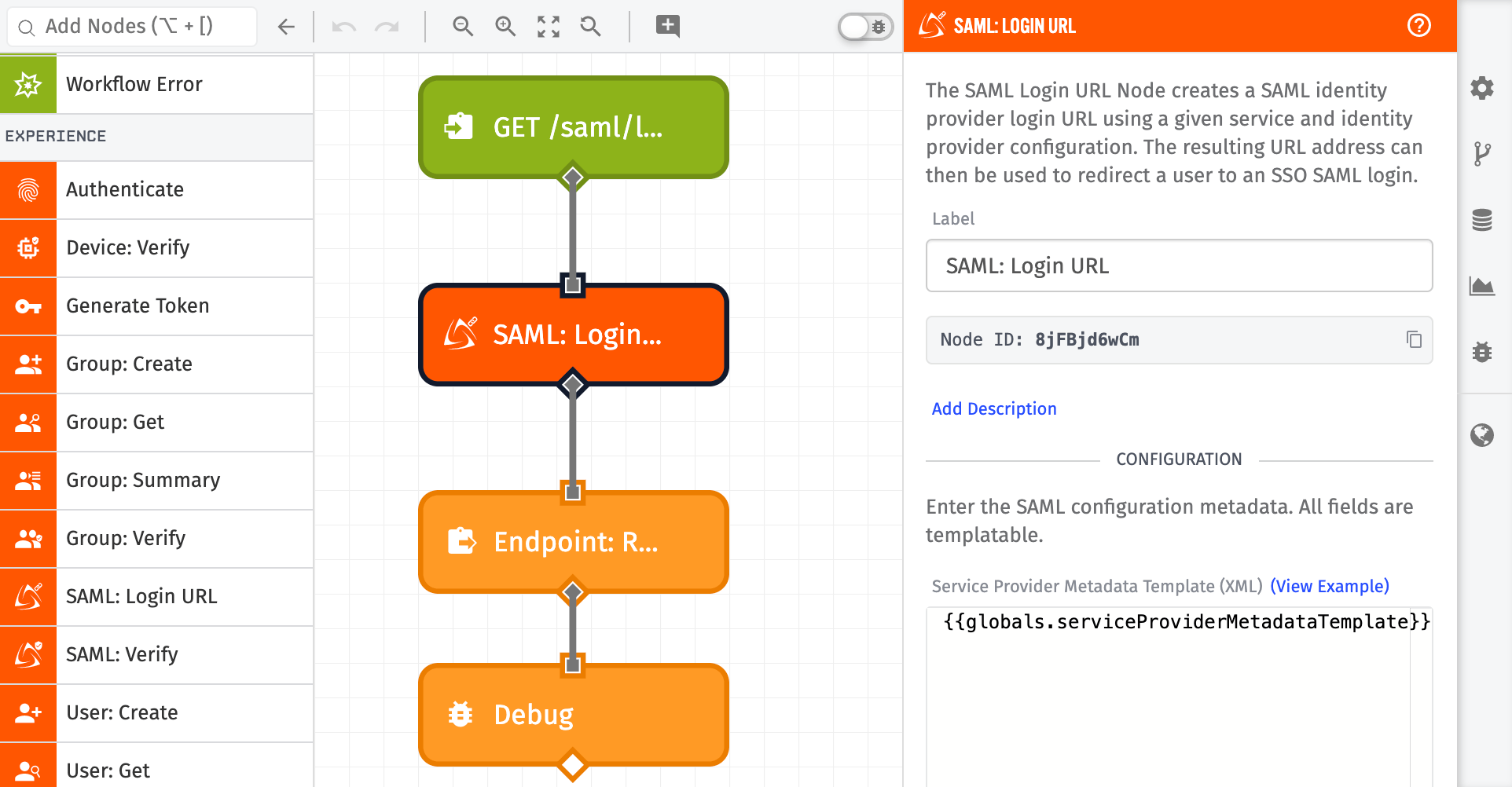

  1. Navigate to the GET /saml/login Experience Workflow.
  2. Connect a SAML: Login URL Node between the Endpoint Trigger and the Endpoint Reply Node.
To configure the SAML: Login Node:
  1. Set the “Service Provider Metadata Template (XML)” to {{globals.serviceProviderMetadataTemplate}}.
  2. Set the “Identity Provider Metadata Template (XML)” to {{globals.identityProviderMetadataTemplate}}.
  3. Set the “Result Path” to working.samlUrl.

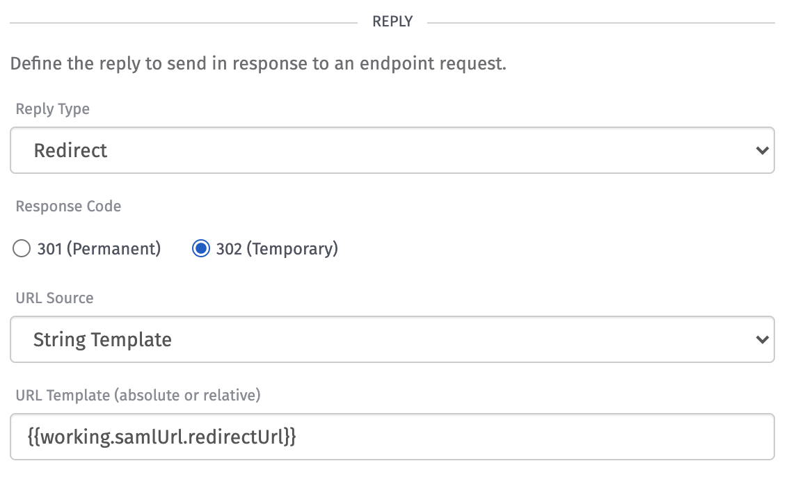

To configure the Endpoint Reply Node:
  1. Set the “Reply Type” to Redirect.
  2. Set the “Response Code” to 302 (Temporary).
  3. Set the “URL Source” to String Template.
  4. Set the “URL Template” to {{working.samlUrl.redirectUrl}}.
Endpoint Reply

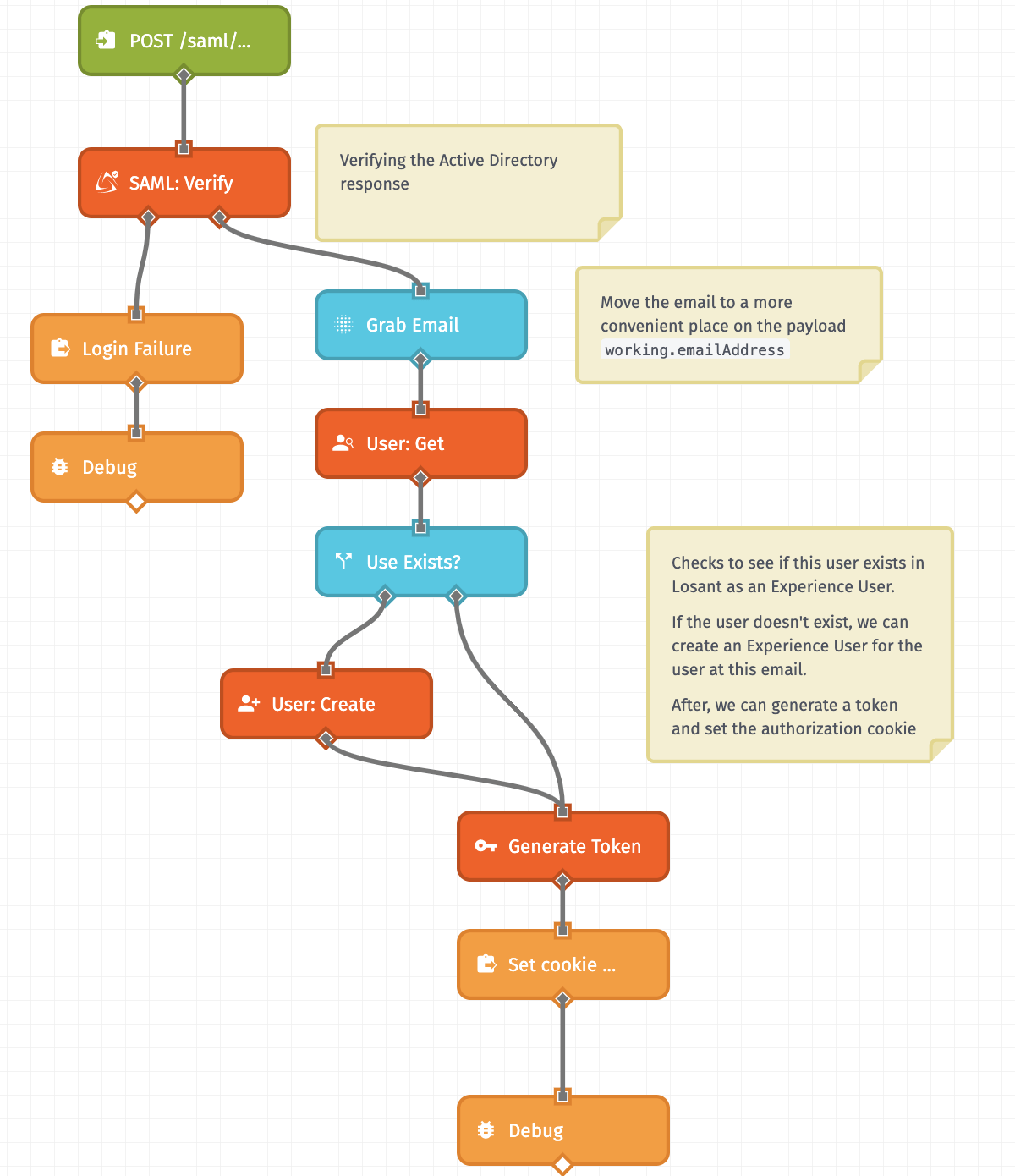

When complete, the workflow will look similar to:
SAML Verify Workflow
To update this Experience Workflow:
  1. Navigate to the POST /saml/assert Experience Workflow.
  2. Connect a SAML: Verify Node to the Experience Endpoint Trigger.
  3. On the left path of the SAML: Verify Node, connect an Endpoint Reply and Debug Node.
  4. On the right path of the SAML: Verify Node, connect a Mutate Node.
  5. Connect a User: Get Node to the Mutate Node.
  6. Connect a Conditional Node to the User: Get Node.
  7. On the left path of the Conditional Node, connect a User: Create Node.
  8. On the right path of the Conditional Node, connect a Generate Token Node.
  9. Connect an Endpoint Reply Node and a Debug Node to the Generate Token Node.
To configure the SAML: Verify Node:
  3. Set the “SAML Response Template” to {{data.body.SAMLResponse}}.
  4. Set the “Result Path” to working.samlUser.
If the SSO fails, this node allows you to redirect the user to the most appropriate page. If the SSO succeeds, the workflow can continue to log in the user.
To configure the Mutate Node:
  1. Select “Set a new value.”
  2. Set the “Value Template” to:
{{working.samlUser.attributes.[http://schemas.xmlsoap.org/ws/2005/05/identity/claims/emailaddress]}}
  1. Set the “Destination Path” to working.emailAddress.
The Mutate Node allows you to move a value on the payload from one place to another. It’s useful to avoid long payload paths. In this example, the Mutate Node is moving the email address of the user to working.emailAddress. The email address is returned from the Identity Provider.
To configure the User: Get Node:
  1. Set “Find By” to “Email or User ID.”
  2. Set the "Experience User ID or Email Template” to working.emailAddress.
  3. Set the “Result Path” to working.experienceUser.
This allows you to check if an Experience Users exists with the same email provided by Active Directory.
To configure the Conditional Node:
  1. Set “Expression” to {{working.experienceUser}}.
This node allows you to branch the workflow in separation actions based on whether an Experience User was found.
To configure the User: Create Node:
  1. Set “Email Address Template” to working.emailAddress.
  2. Set “Password Template” to {{working.samlUser.nameID}}.
If the user does not exist, you can automatically create a new Experience User with the details provided by Active Directory.
To configure the Generate Token Node:
  1. Set “User ID or Email Template” to working.emailAddress.
  2. Set “Result Path” to data.responseToken.
If the Experience User does exist, or after we create one, you can generate a valid authentication.

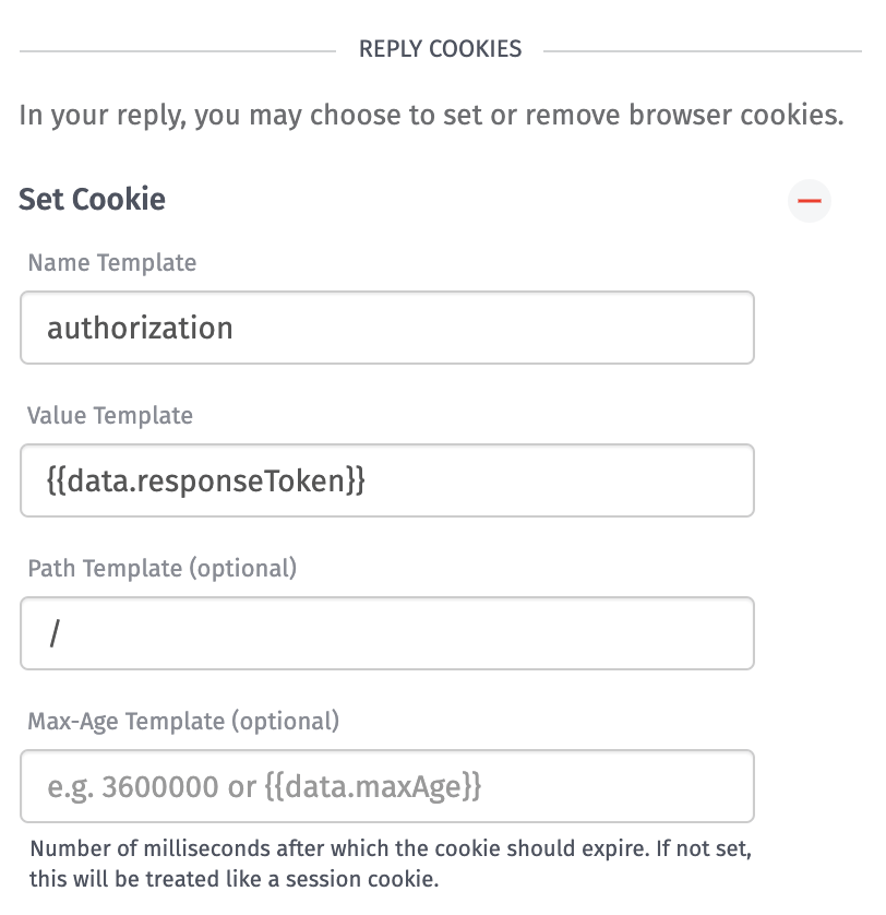

  4. Set the “URL Template” to /.
  5. In the “Reply Cookies” section, select “Set Cookie.”
  6. Set the “Name Template” to authorization.
  7. Set the “Value Template” to data.responseToken.
  8. Set the “Path Template” to /.
Endpoint Reply Verify
Now, the SAML Verify workflow is complete.

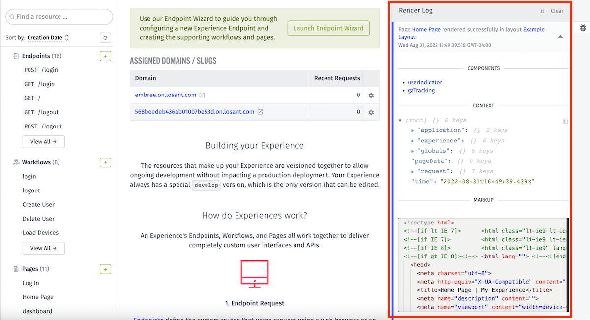

Here are some helpful tips to help you debug any issues:
Verify Workflow
Adding Debug Nodes allows inspection of the current payload at any point during a workflow. It is extremely useful when initially constructing a workflow to make sure that all the various components are acting on the payload as expected.
Debug Node Output
Testing Experience
For debugging purposes, Losant provides an Experience Render Log of render attempts for your experience views. This log creates an entry for every attempted page render (including failures).
Render Logs
