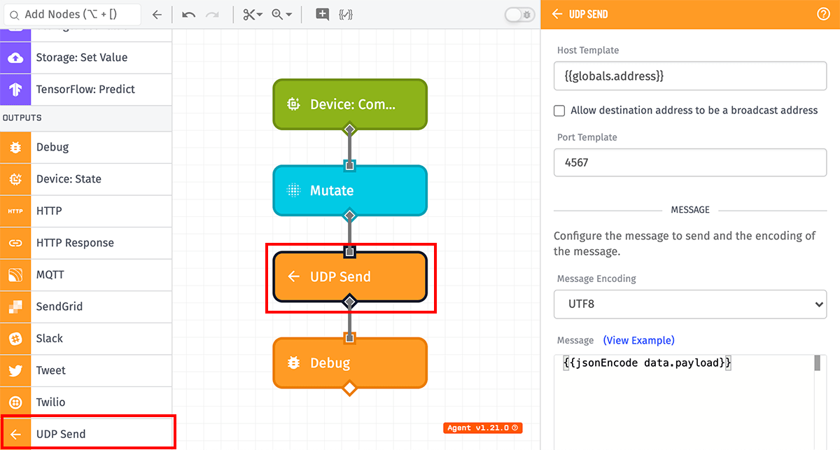

Configuration of the UDP Send Node is broken up into three sections.
Destination
  • Host Template: (Required) Enter a string template for destination address. This can be either an IPv4 or IPv6 address, or a hostname that resolves to an address.
  • Allow destination address to be a broadcast address: Starting with Gateway Edge Agent v1.19.2, you may elect to allow a broadcast address in the Host Template field (e.g. 255.255.255.255) if this checkbox is checked. Note: If you wish to use a broadcast address, the Gateway Edge Agent must be started in host network mode.
  • Port Template: (Required) Enter a string template for the destination port. This must resolve to a valid port (between 1 and 65535).
Message
  • Message Encoding: Choose an encoding method for the datagram (defaults to UTF-8).
  • Message: Enter a string template for the contents of the UDP datagram to send.
Result
You can optionally store the result of the UDP send on the payload for later use in the workflow. A successful UDP send will have the result { success: true }. A UDP send that results in an error will have a result of the form { error: <error> }.
