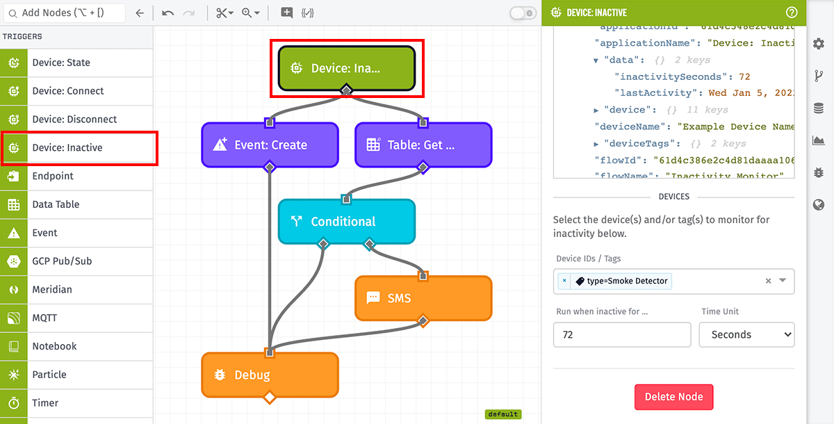

Device: Inactive Trigger
The Device: Inactive Trigger fires a workflow whenever one or more devices do not report state for the configured period of time.
Device Inactive Trigger
There are two configurable properties for the Device: Inactive Trigger ...
Device IDs/Tags
First, enter a device query targeting the devices you would like to fire this trigger for. You must choose at least one specific device or one device tag, but you may also enter a mix of the two.
Inactivity Time
Next, enter the length of time that must pass without a matching device reporting state before the trigger fires.
  • The inactivity time can be configured in seconds, minutes, hours, or days.
  • The value can be as short as 1 second or as long as 1 year.
  • Like the Device: Connect, Device: Disconnect, and Device: State Triggers, this trigger fires individually per device matching its query. In other words, if the trigger is configured to fire for devices matching the tag type=Smoke Detector, and there are 10 devices with such a tag, each one of those devices will cause the trigger to fire when the inactivity timer expires.
