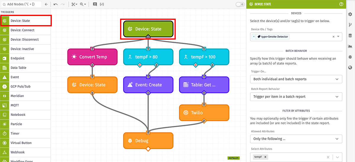

The Device: State Trigger can be configured with one or more specific devices, a selection of tags, or both. When a device that matches anything in the selection reports state, the workflow will trigger. See the device query documentation for more info about how ID and tag matching works.
In the above example, the workflow will trigger whenever any device with the type=Smoke Detector tag reports state.

In the example at the top of the page, the workflow triggers only when the tempF attribute is included in the state report. This is because the workflow is recording the same temperature in Celsius at the same timestamp (using a Device: State Node), and we do not want this workflow to run again from the recording of the converted value.
