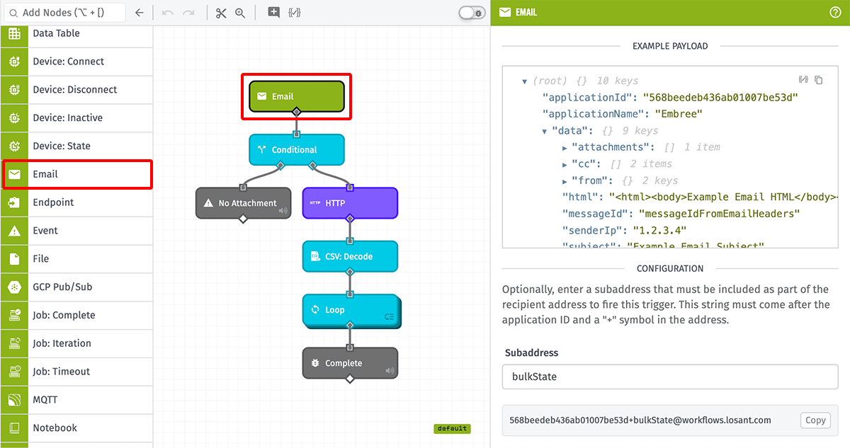

Email Trigger
The Email Trigger fires a workflow whenever an email is sent to your application's email address or one of its subaddresses.
Inbound Email Trigger
The Email Trigger takes one optional property: a Subaddress that, when defined, must be included as part of the application email address in order to fire the trigger. More information on subaddressing - also known as "plus addressing" - can be found here.
Usage
The trigger fires when an email is received at the application's email address, either as a "To", "CC", or "BCC" recipient. The message recipients, body, and attachments are available in the trigger's initial payload.
Your application's email address is <YourApplicationId>@workflows.losant.com. For example, given an application ID of "abc123def456abc789def012", you could fire an Email Trigger without a subaddress by sending an email to abc123def456abc789def012@workflows.losant.com. (The address is also listed at the bottom of the trigger's editor.)
If a Subaddress is configured in the trigger, the Subaddress must be included in the email address after the application ID and a plus sign (+). Given the example above and a Subaddress of "bulkState" provided in the trigger configuration, the trigger will only fire on emails sent to abc123def456abc789def012+bulkState@workflows.losant.com.
