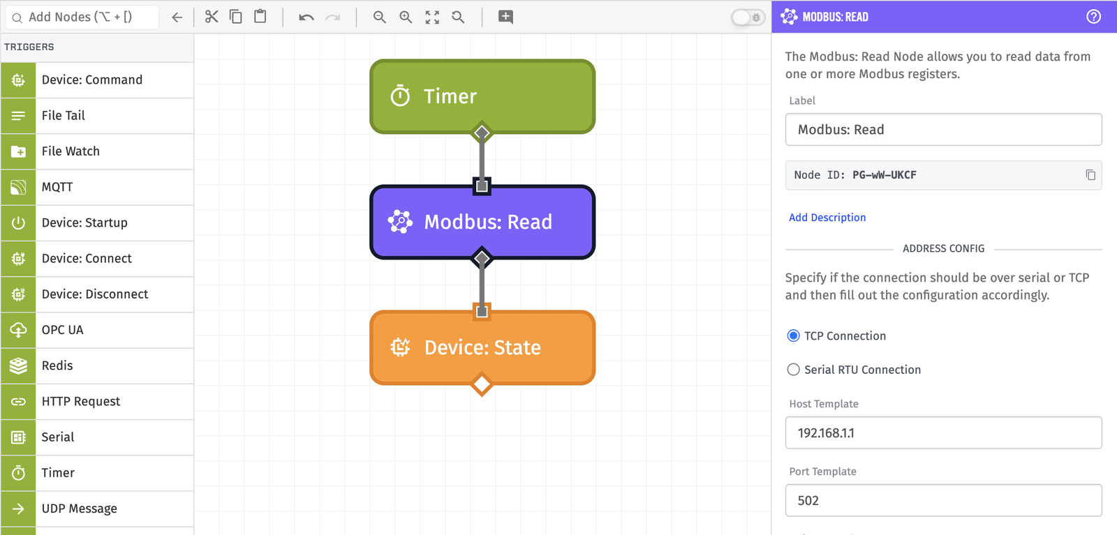

Reading Data Using Local Protocol
In most use cases that leverage a local protocol, you can build an Edge Workflow that reads a local protocol on a timer and reports data to Losant.
The following steps detail how to develop a workflow using a timer, Modbus Read Node, and Device State node to report state of a Modbus Enabled PLC to the Losant Cloud:
- Drag the Timer Node onto the workflow canvas. This enables you to trigger a read on a recurring basis.
- Connect a Modbus: Read Node (or the local protocol node of choice) to the Timer Node. This enables you to read the local protocol.
- Connect a Device: State Node to the Modbus: Read Node. This enables you report the data from the local device to the cloud as state.
