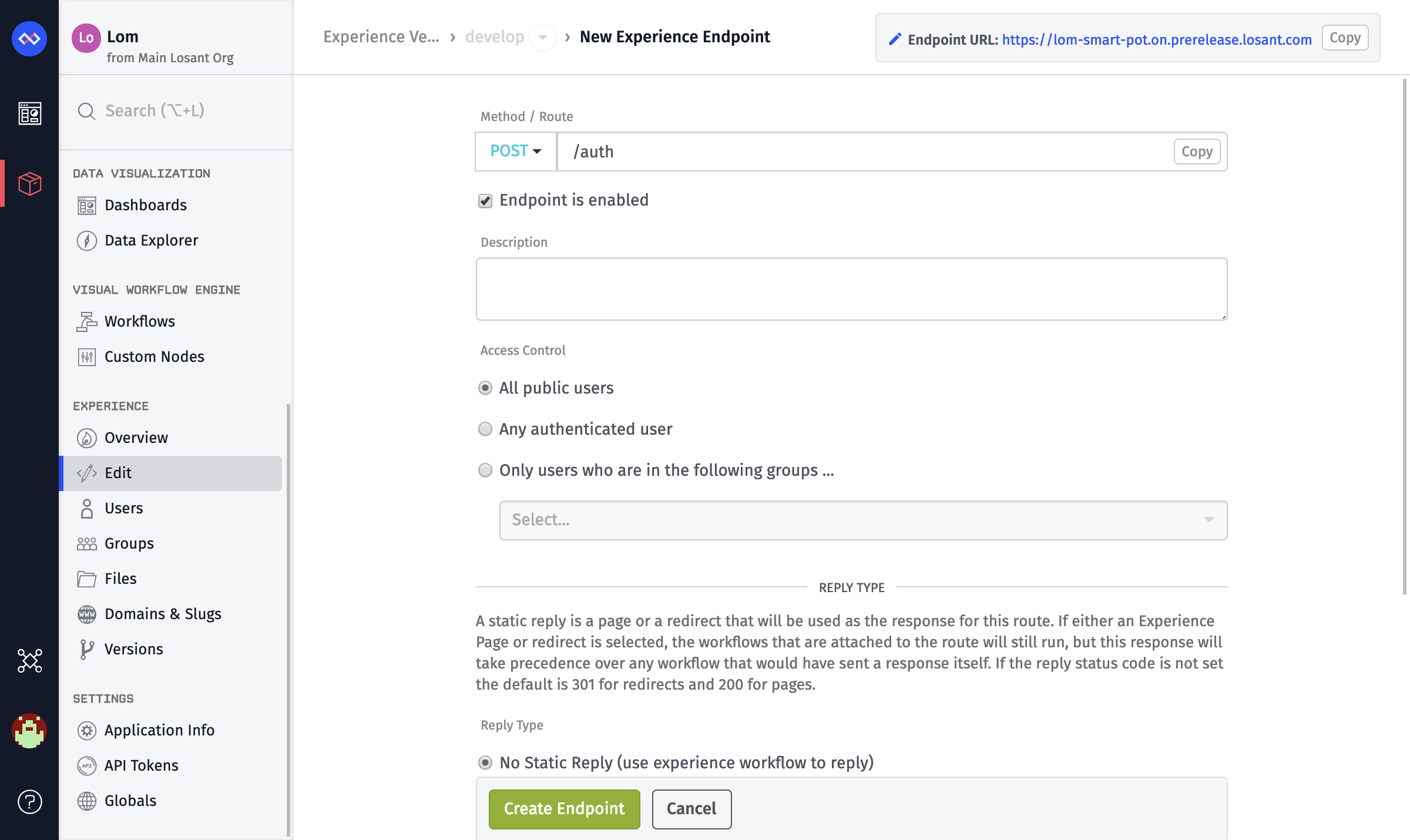

We need to create an endpoint and a workflow that does this authentication. First, create a /auth endpoint:
Auth Endpoint
  1. Set the Method to POST.
  2. Set the Route to /auth.
  3. Add a Description.
  4. Set the Access Control to All public users.

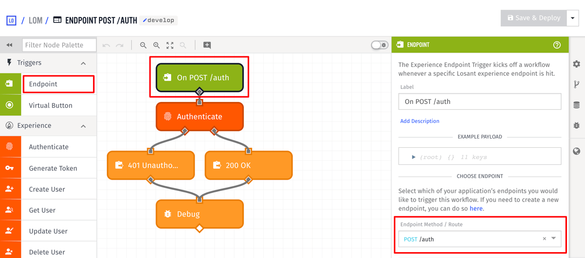

Next, create an experience workflow that handles the login requests for that endpoint.
Auth Workflow Trigger
Use an Endpoint trigger and select the /auth endpoint that you created.

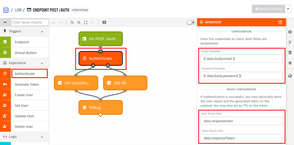

Auth Workflow Authenticate
Add an Authenticate node, and configure it as the following:
  1. Set the Email Template to {{ data.body.email }}.
  2. Set the Password Template to {{ data.body.password }}.
  3. Set the User Result Path to data.responseUser.
  4. Set the Token Result Path to data.responseToken.

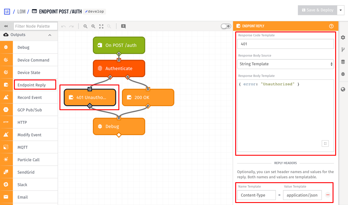

Auth Workflow 401 Response
Add an Endpoint Reply node to the false output of the authenticate node and configure it to the following:
  1. Set the Response Code Template to 401.
  2. Set the Response Body Template to `{ "error": "Unauthorized" }.
  3. Add a Content-Type header with the value application/json.

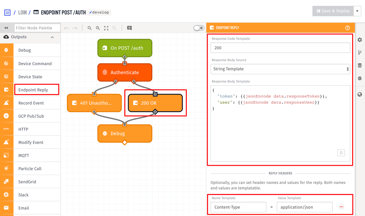

Auth Workflow 200 Response
Add an Endpoint Reply node to the true output of the authenticate node and configure it to the following:
  1. Set the Response Code Template to 200.
  2. Add a Content-Type header with the value application/json.
  3. Set the Response Body Template to:
"token": {{jsonEncode data.responseToken}},
"user": {{jsonEncode data.responseUser}}
The /auth requires the user's email and password to be sent as POST data. It then uses the Authenticate node to check if an Experience User has an identical email and password. If the authentication fails, a 401 (Unauthorized) is returned to the client. If the email and password are valid, the token and the user object, both of which are added to the payload by the Authenticate node, are returned to the client.

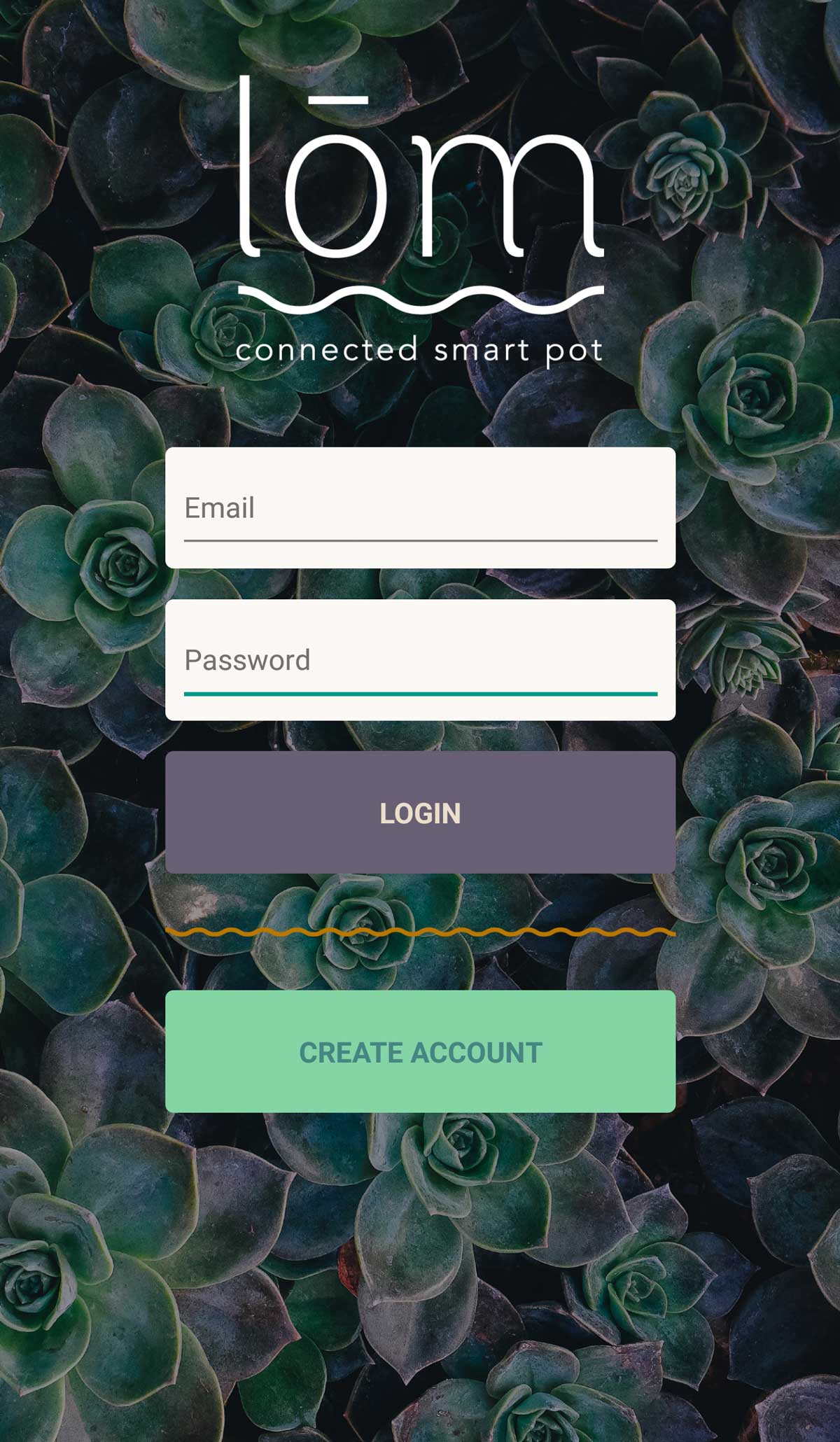

Now whenever a lōm user enters their email and password on the main screen, the client POSTs them to /auth and obtains a token to make authenticated requests against the API.

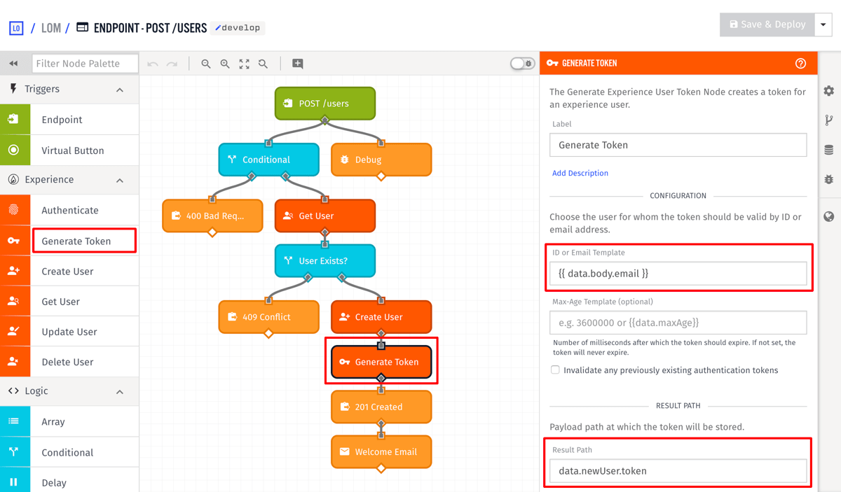

Using the /auth route is the most common method users authenticate against your API. For convenience, modify the workflow we created in Part 1 to return a token whenever a user is registered:
  1. Add a Generate Token node and insert it after the Create User node.
  2. Set the ID or Email Template to {{ data.body.email }}. The Generate Token node works by accepting the ID or email of an existing Experience User and then creating a token for that user.
  3. Set the Result Path to data.newUser.token.
This removes the need to register the user and then make an additional API request to get the user's token.
Token Workflow
As we saw above, the Authenticate node automatically creates a token, however, you can use the Generate Token node to create a token whenever you want. This provides a way to implement custom authentication mechanisms if needed. With this, in addition to the POST /users endpoint, whenever a new user is registered, the client is returned the new user object and its token as the result.
