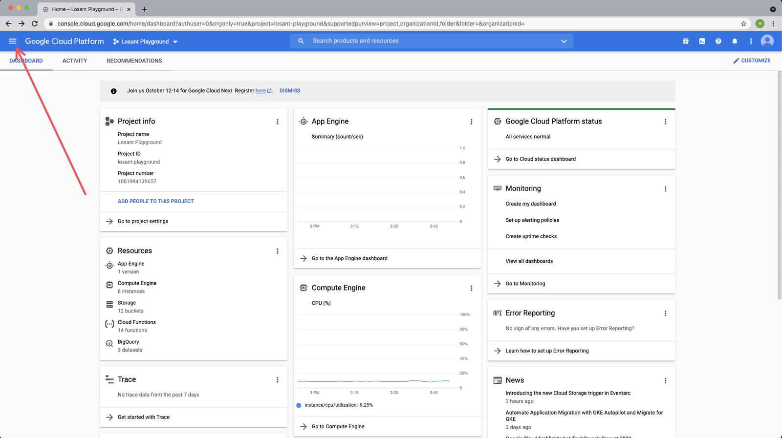

Once you have selected the project that you would like to work in, from the Google Cloud Platform (GCP) dashboard page, click the menu icon in the top left.
Open Left Nav

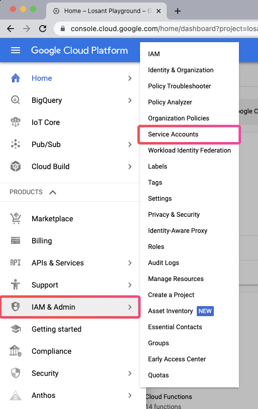

Then click “IAM & Admin” and then “Service Accounts”:
Select service account

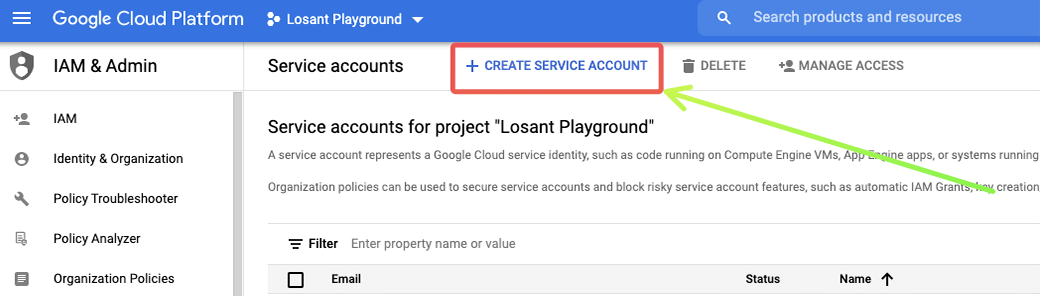

Then in the Service Accounts dashboard, in the top left, click “Create Service Account”.
Create service account

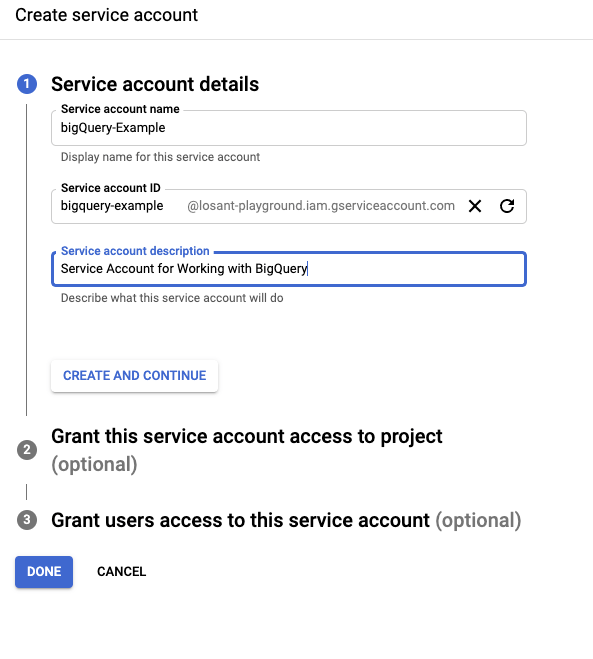

Next, we can give our service account a name, ID, and description. Then, click “Create and Continue”.
Name the service account

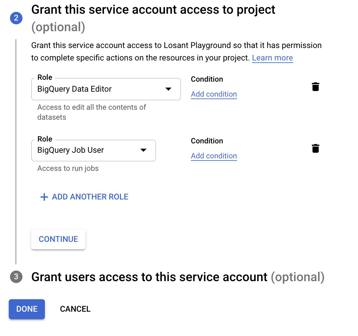

For this example, we need to grant two roles to our service account:
  • BigQuery Data Editor: Allows us to read and write to datasets.
  • BigQuery Job User: Gives us the ability to create “jobs” to query the dataset.
Set the service account roles
Here, you can either click “Continue” or “Done”. “Continue” will allow you to grant other users in your project access to this service account (an optional step). “Done” will skip the optional 3rd step and move into getting a key from Google for this service account.

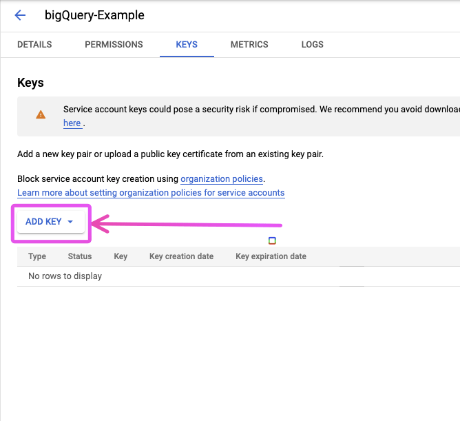

Then “Add Key”:
Click Keys button

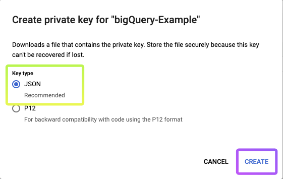

Leave the default option of “JSON”.
Select key-type JSON

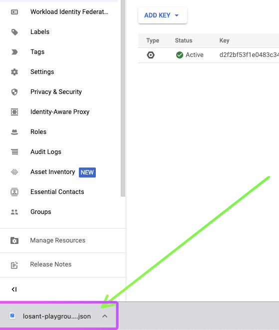

Once you click “Create”, a JSON file will be downloaded. Keep this somewhere safe because this JSON information is what you will use to send queries from Losant to GCP BigQuery.
Save the key

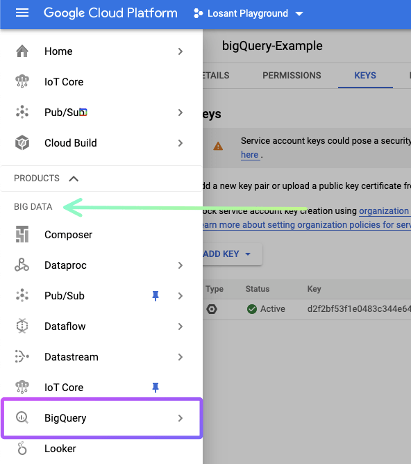

In the left navigation menu, under the “Big Data” section, go to BigQuery:
Use left navigation menu, select BigQuery from list

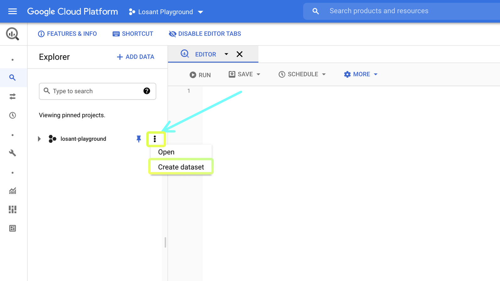

Then, on the BigQuery dashboard, click the three dots next to your project name, and click “Create dataset”:
Create dataset

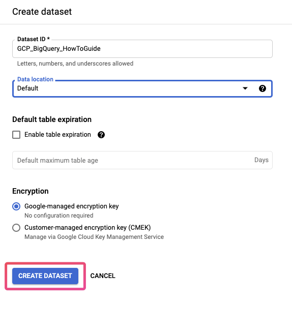

Here’s where we’ll create our dataset. Give your dataset an ID, and then click “Create Dataset”:
Name dataset

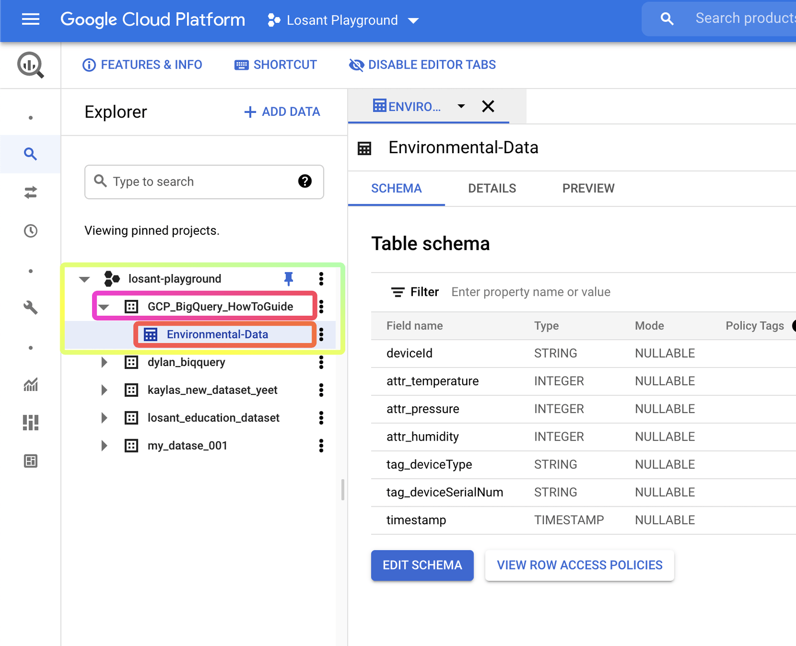

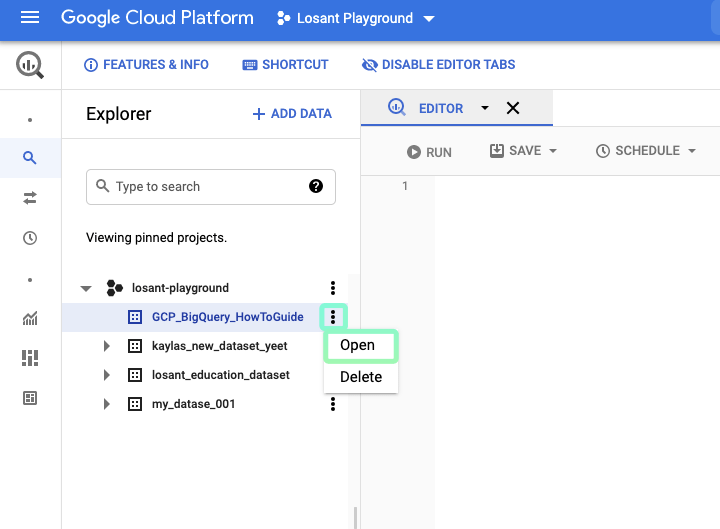

Now, if you open the dropdown for your project in the project list on the left side, you can see your dataset. Next, let’s create a table for our example data.
Click the 3 dots next to your dataset, and click “Open”:
Open dataset

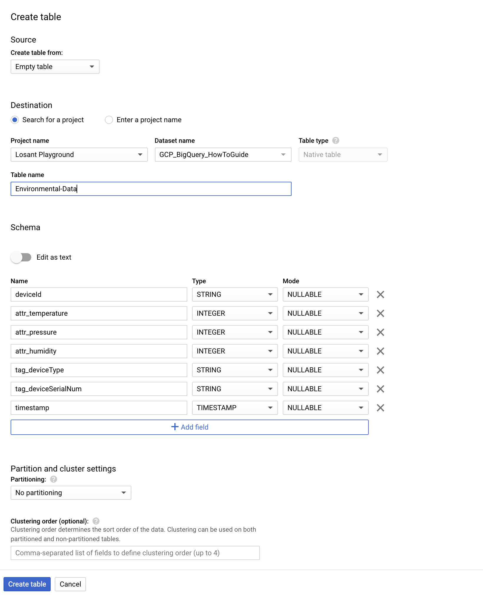

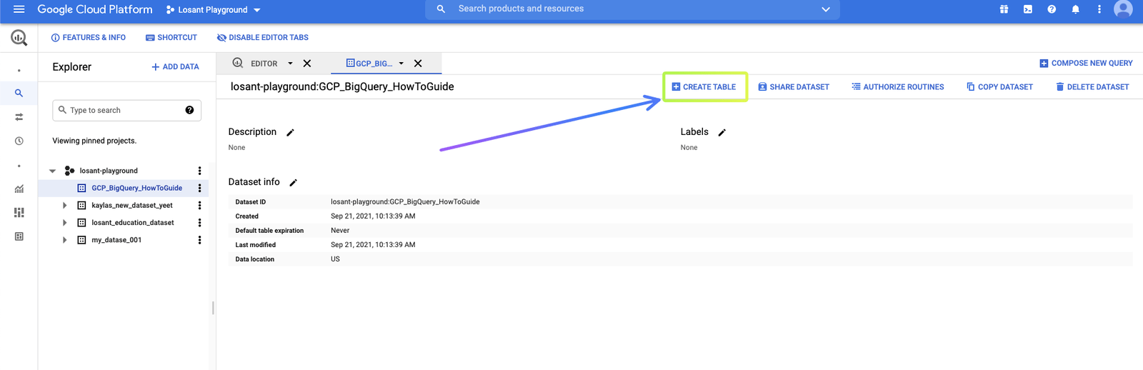

Then, in the project tab that was opened for us, click “Create Table”:
Create table
For this example, we’ll be generating simulated environmental data. So, we’ll name our table “Environmental-Data”. The schema that we create is very important moving forward. We want to, in a way, “begin with the end in mind” with our schema. So, we’ll create a schema that includes a Device ID field, a timestamp field, and some device tags. This schema allows for multiple different query options down the road.
To make this schema, click “Add Field” to create a new field for your schema. Here, we prefix device attributes with attr_ and device tags with tag_. The temperature, humidity, and pressure that we’ll be sending will be whole integers, but in a production scenario, it will be important to align your field Types to the type of the data that will be going into this table.
The timestamp field is an absolute point in time with microsecond precision, independent of any time zone or convention such as Daylight Savings Time. BigQuery does support multiple dates & times, but in this case (as you will see) we will be sending a timestamp with the format YYYY-MM-DDTHH:mm:ss.SSSZ.
Finally, click “Create table”:
Define table schema and save table

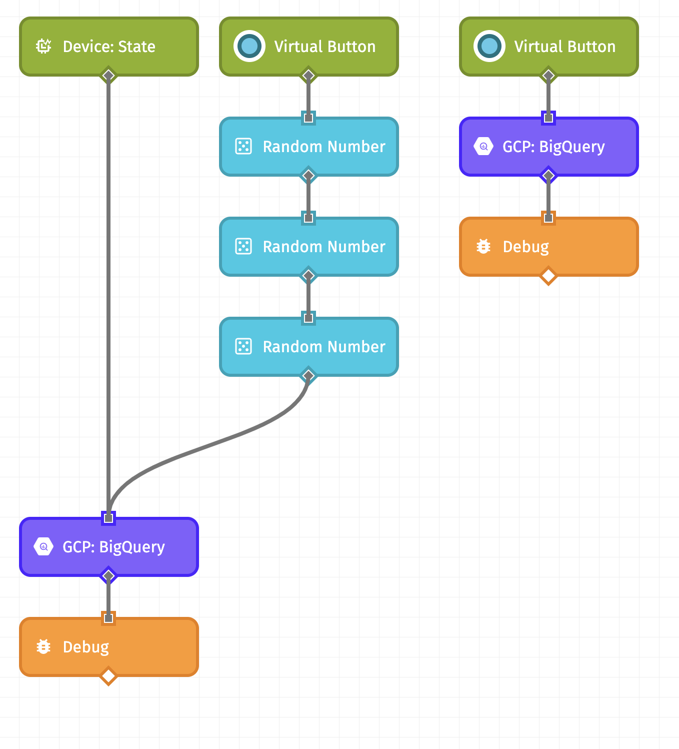

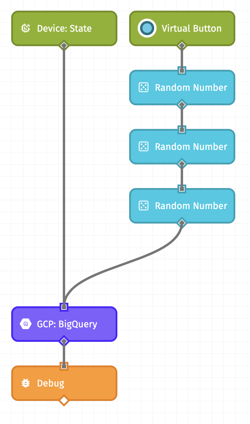

Let’s start by creating the following workflow (download it here):
Send data to BigQuery Losant Workflow
On the left, we are using a Device: State Trigger so that this workflow will execute every time a device reports its state to Losant. When using this trigger, we give you some things by default on the payload, namely the ID of the device that reported its state, as well as its tags. Therefore, in our BigQuery request configuration (which we’ll talk about shortly), we can reference these values directly.
On the right, though, we are using a Virtual Button Trigger and a few Random Number Nodes. The right side of this workflow is useful for testing since we can manually trigger this workflow when we need to.

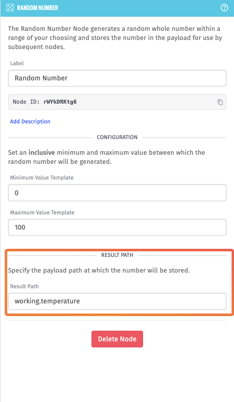

Each Random Number Node is generating a number between 0 and 100, and placing the result on the payload at working.<environmental attribute>. For example, the first Random Number Node is generating temperature:
Random Number Node configuration

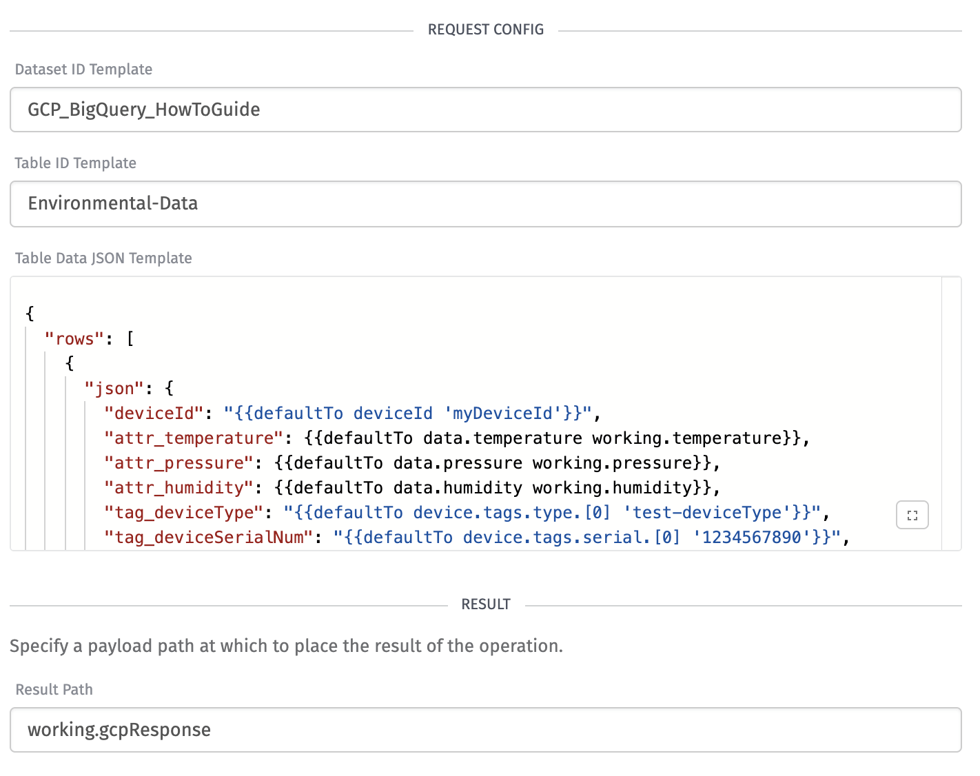

To insert data into our BigQuery Table, we’ll select the Tabledata: Insert All resource action. This resource action requires the ID of both our dataset and our table that we created in GCP. You can find these values in BigQuery as the names you see on the left panel:
Where to find dataset and table names
Here, you’ll just input the name of the dataset and table that you create. In this example, my dataset name is GCP_BigQuery_HowToGuide and my table name is Environmental-Data.
Request configuration for dataset and table in Losant workflow
We can now work on our Table Data JSON Template. Here’s what we’ll be sending:
"rows": [
"json": {
"deviceId": "{{defaultTo deviceId 'myDeviceId'}}",
"attr_temperature": {{defaultTo data.temperature working.temperature}},
"attr_pressure": {{defaultTo data.pressure working.pressure}},
"attr_humidity": {{defaultTo data.humidity working.humidity}},
"tag_deviceType": "{{defaultTo device.tags.type.[0] 'test-deviceType'}}",
"tag_deviceSerialNum": "{{defaultTo device.tags.serial.[0] '1234567890'}}",
"timestamp": "{{formatDate time 'YYYY-MM-DDTHH:mm:ss.SSSZ'}}"
You can read more about the structure of this request in the Google Documentation. Here we are inserting a row (you have the option to insert multiple rows at a time), where the json field matches our schema.
We are making use of the defaultTo helper to fill in the deviceId and tag values, which we'll need when we trigger this workflow using our testing Virtual Button. We are also making use of the formatDate helper to format the time value on the payload to the format that Google expects for the timestamp field.
The last bit of our node configuration will look like:
BigQuery Node full request configuration

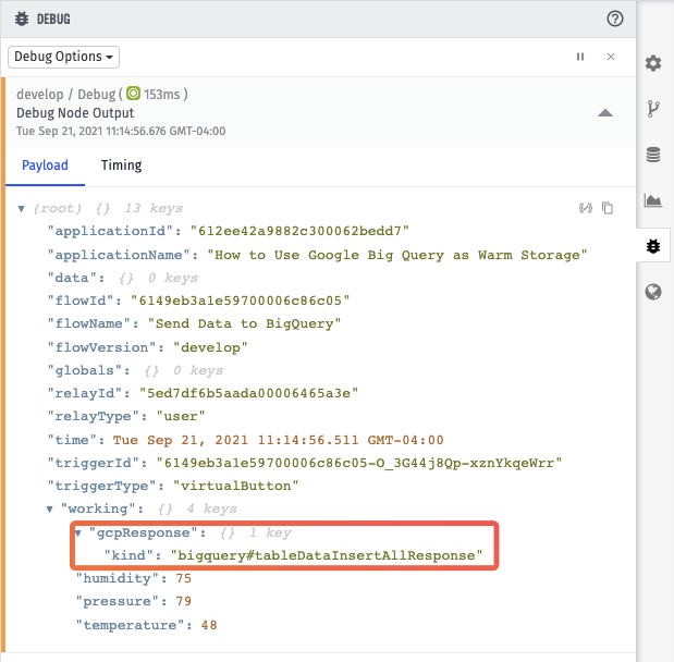

We’re putting the response from GCP on the payload at the path working.gcpResponse. Now, after clicking “Save and Deploy”, you can click the Virtual Button trigger, which should result in a debug message that is similar to the following:
Losant Debug message showing successful BigQuery request

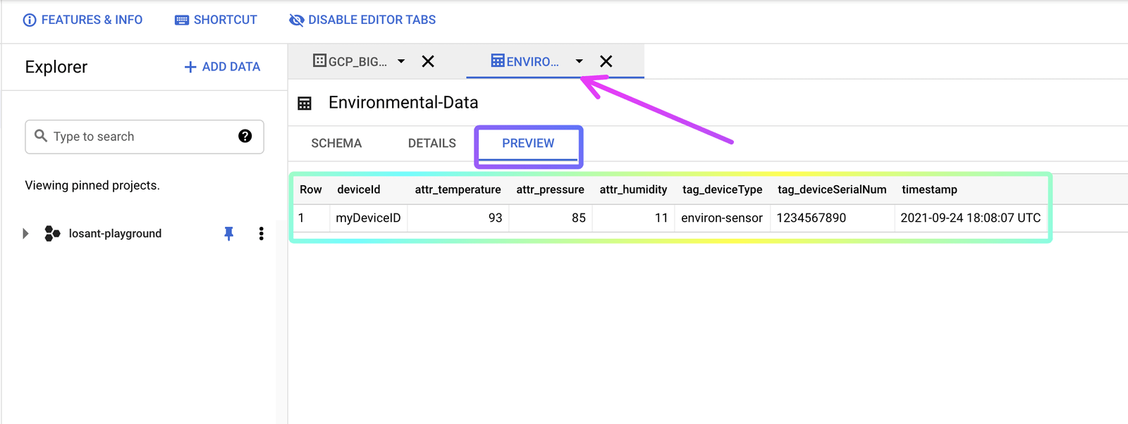

Then, return to GCP and refresh the page. Go to the Table tab and select the Preview option. You should see the data that was sent via the workflow:
Preview the data sent in Google Cloud Platform table viewer

In the same workflow we created at the beginning of Step Three, copy and paste the BigQuery node you have, add a Virtual Button Trigger, and a Debug Node so that your workflow looks like this (which are also included in the downloadable flow):
Losant workflow with query added

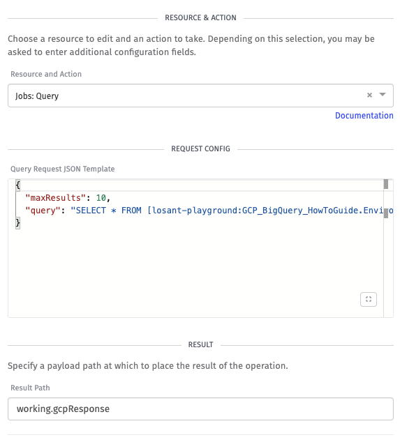

We copy and paste the BigQuery Node so that we can maintain the same configuration. But, we are going to change the Resource & Action of this node to Jobs: Query, and our new Request Configuration will look like:
"maxResults": 10,
"query": "SELECT * FROM [losant-playground:GCP_BigQuery_HowToGuide.Environmental-Data] WHERE attr_temperature > 90"
So, the BigQuery Node configuration will look like:
BigQuery Node configuration for query
This request configuration contains two items:
  1. maxResults is the maximum number of times the query will return.
  2. query is the SQL query that queries our data. Refer to Google’s documentation for other available options for this configuration.

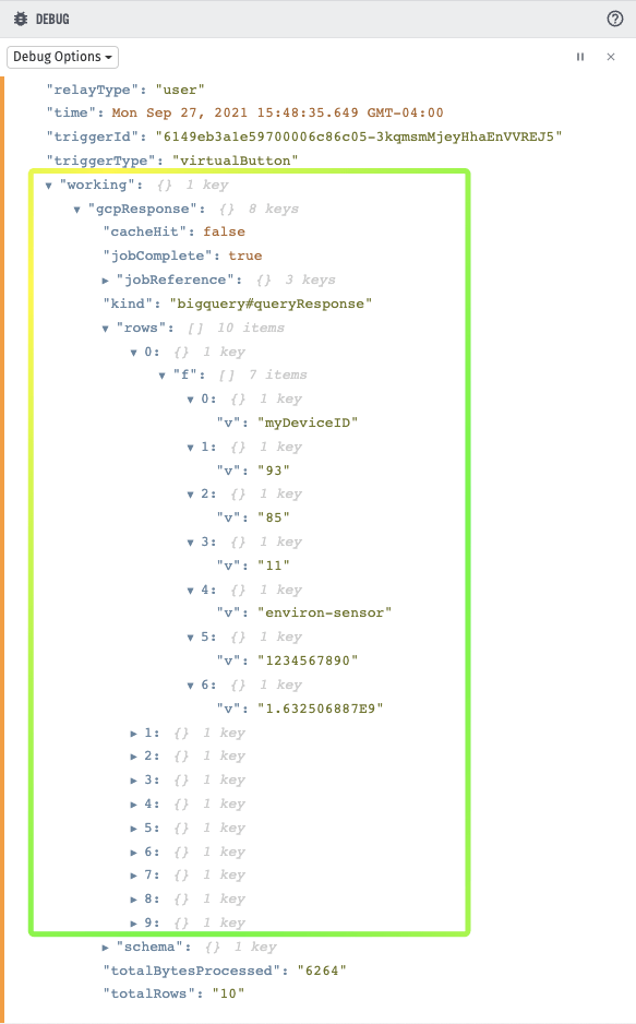

In this example, we’re querying all rows where the temperature is greater than 90 degrees. When we press the Virtual Button, our result should look something like:
Debug message showing raw data returned from BigQuery
We get an array of objects that contain the values for our queried data.
The data shown above is the raw data that you get back from the BigQuery query. While this data is very operable in its current form, we highly recommend using Array or Object Nodes to parse the data. BigQuery does also include the schema object in the response, so you can also verify that your data matches the schema.
