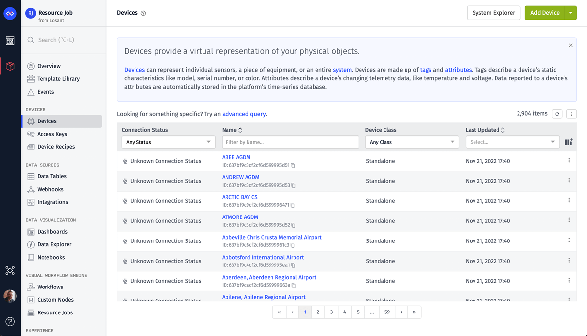

The result is 2,904 devices:
Device List

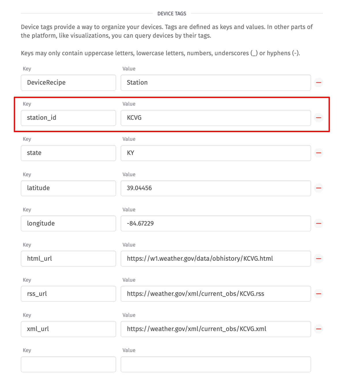

When iterating over devices, the workflow receives the full device object. For a resource job, the most important information is likely stored on the device’s tags. In our case, the API endpoint requires the station ID. Therefore, each of our devices has a station_id tag with its unique identifier.
Device Tags
Depending on your use case, you’ll need to replace station_id with whatever your API uses to identify devices.

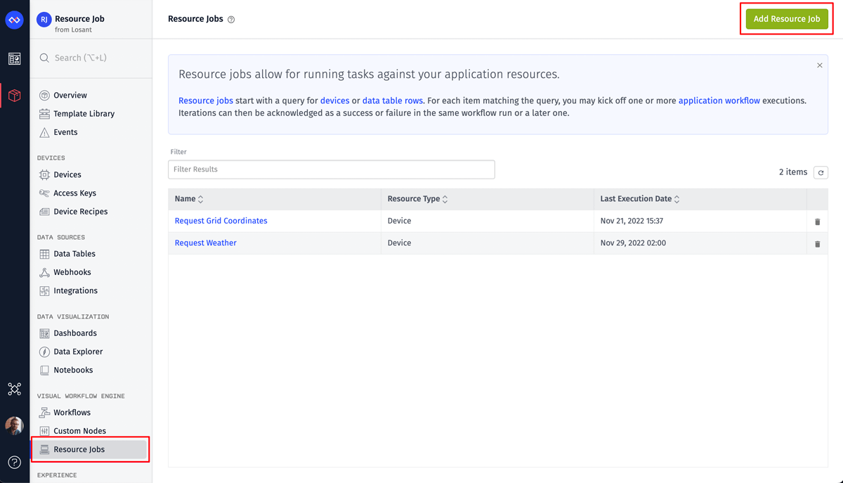

Create a Resource Job
On the left application menu, you’ll see a menu item called Resource Jobs. This is where your jobs are created and managed. Click the Add Resource Job button at the top right corner of the page to create a new job.
Create Resource Job

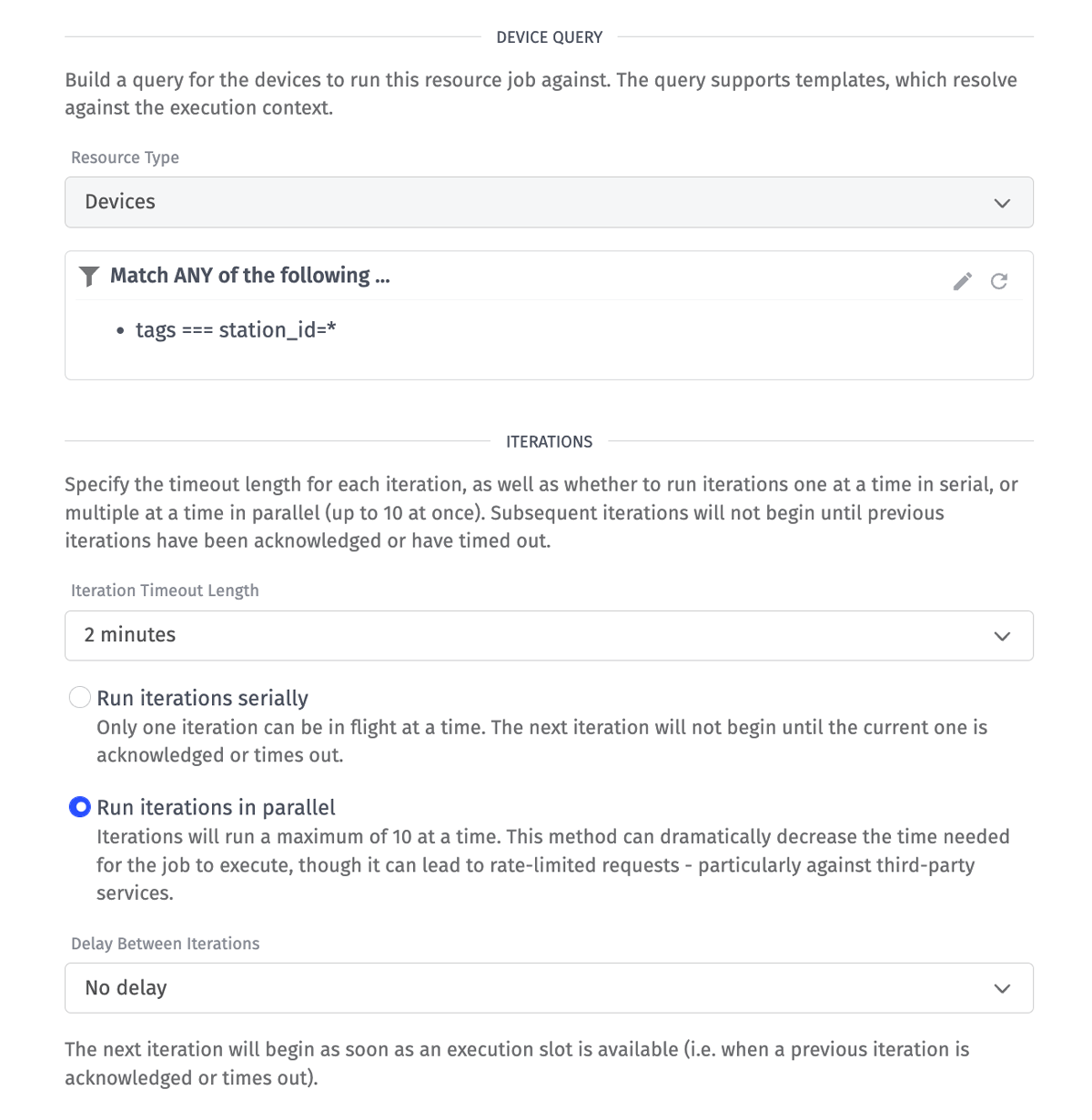

Below is a screenshot for our job’s configuration. The details of each option are described after the image.
Job Configuration

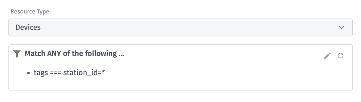

Resource jobs have two required configuration sections. The first section controls which resources to iterate over. For this job, we’re iterating over every device that has a station_id tag, regardless of its value. If your use case requires a job to only iterate over a subset of your devices, using tags is the recommended way to create those subsets.
The second required configuration section controls the execution behavior of the job’s iterations. Iteration Timeout Length controls how long the job will wait for each iteration to be acknowledged. Iterations do not have to be acknowledged in the same workflow that was originally triggered. Each iteration receives a unique ID and that ID can be provided to the Job: Acknowledge Node in the current or any workflow triggered in the future. This behavior is useful for things like over-the-air (OTA) updates that require back and forth communication with the device before the iteration can be eventually acknowledged.
The Run iterations serially and Run iterations in parallel options control how many iterations will execute at the same time. This option is particularly important when polling an API. It’s very common for APIs to implement some form of rate limiting, and a job running iterations in parallel can easily exceed limits. The NWS API we’re using does say a rate limit exists, but does not document the specific details. In our testing, the parallel option has not exceeded their limit.
The Delay Between Iterations option is intended to be used when running iterations serially. This option provides further control over how fast iterations will execute. For example, if your API has a rate limit of 10 requests per second, setting the delay value to 100ms or greater will guarantee the job will never exceed the API’s limit.

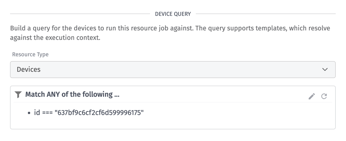

The first thing you’ll want to do when initially building and testing a workflow is to modify the job’s configuration to run on a single resource. This lets us rapidly execute the job to test the workflow while it’s being built. This step is especially important if your job is modifying or destroying data. It’s very easy for workflows to have bugs while actively being developed. You don’t want to accidentally perform a destructive action on every device.
Testing a Single Device
For this example, we’ve changed the job to execute against a single device ID. It’s a good idea to manually test this device against your API to ensure it works. For our use case, we’ve confirmed that this device’s station_id returns valid data.

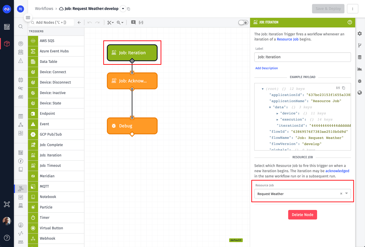

For our first attempt at executing a job, we’re going to make a workflow that only contains three nodes. We want to test that everything is plumbed together correctly before adding any real logic.
Getting Started
The first node is the Job: Iteration Trigger. This node only has one configuration field, which is the resource job that, when executed, should trigger this workflow.

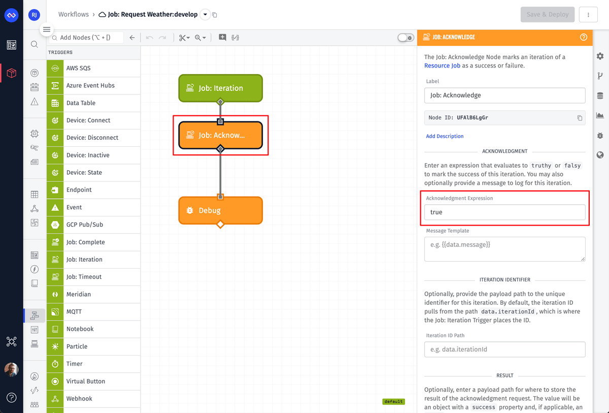

The next node is a Job: Acknowledge Node. For this test, the only configuration value we need to provide is an Acknowledgment Expression. This node acknowledges an iteration as either a success or a failure. In most cases, this value will be a simple true or false, but the field does support expressions to dynamically determine the value based on payload data.
The final node is a Debug Node. This lets us see that the workflow triggered and allows us to inspect the payload we receive on each iteration.

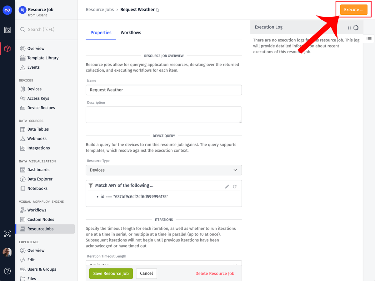

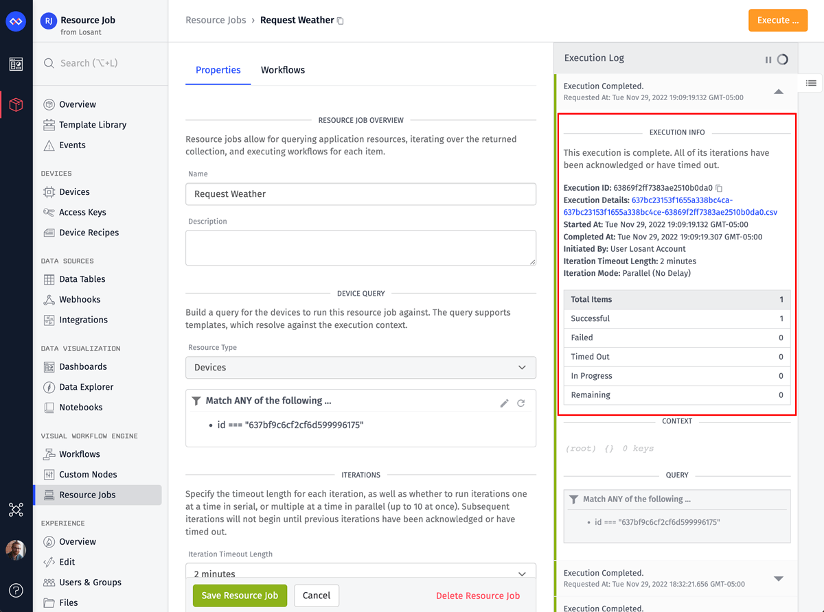

We can now execute our job and make sure everything is properly connected together. A workflow’s debug output does not persist if the workflow’s browser tab is closed. Therefore, during this test, it’s important that you keep the workflow tab open.
To execute this job, click the Execute button on your job’s configuration page. Clicking this button will bring up a modal where you can optionally provide custom context for each iteration. Our use case doesn’t require context, but it’s a useful feature to change the behavior of your job without having to modify the workflow.
Job Execute Button

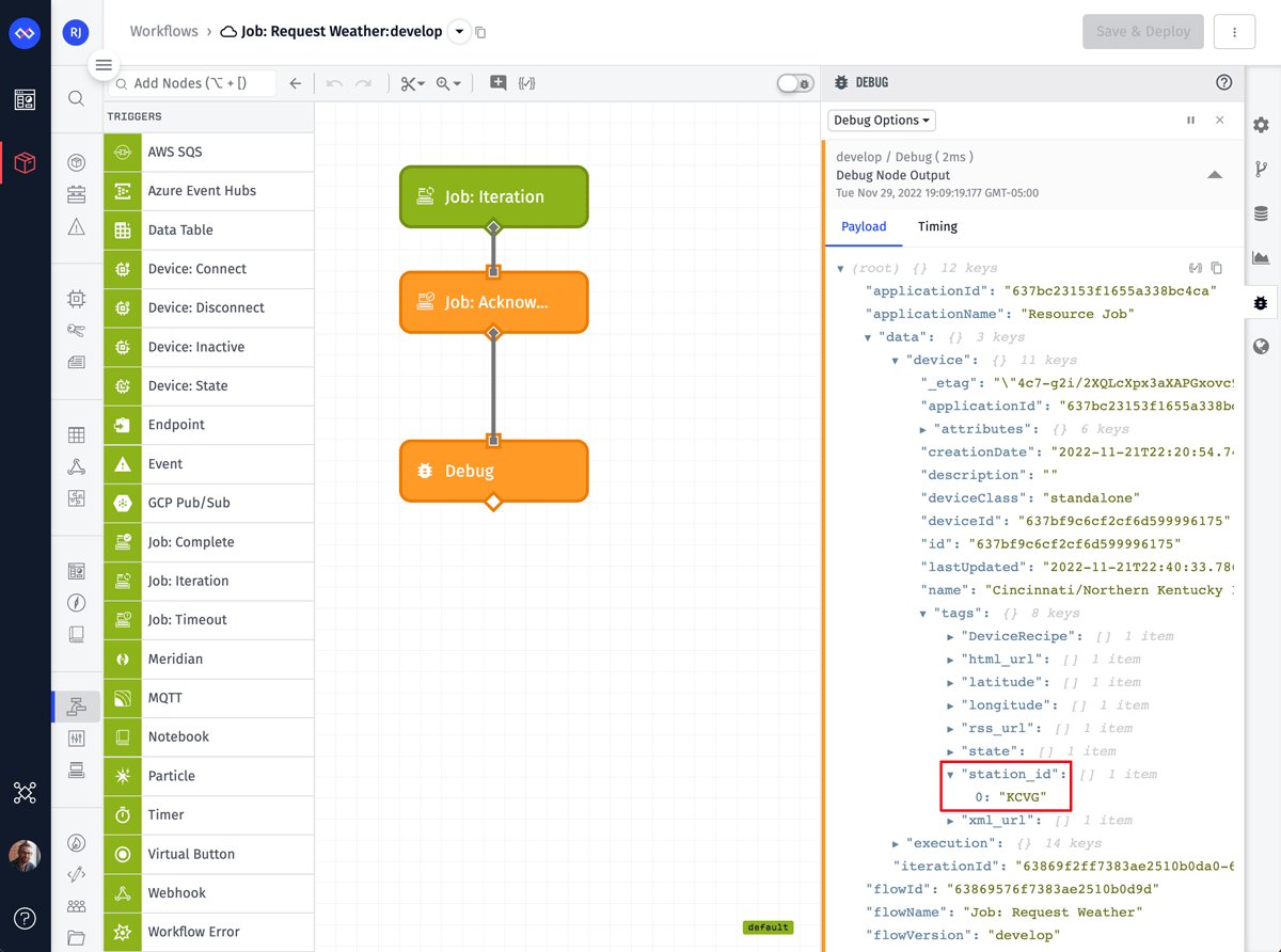

After executing the job, we can now return to the workflow, inspect the debug output, and verify everything is working properly.
Test Debug Output
As you can see in the screenshot above, this workflow triggered for our test device. The entire device object was put on the payload at data.device. Most importantly, we can see the value for the station_id tag, which is required to make our API request.
Returning to the job’s configuration page, we can also see a successful execution in the log. The execution log is covered in greater detail later in this guide.
Test Job Log

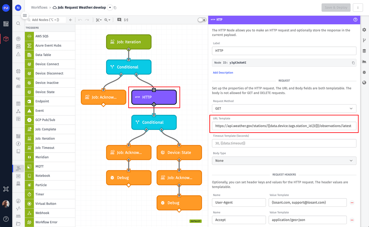

The HTTP Node is where the actual API request is performed. We’re using a template for the URL so that each iteration makes an API call specific to that device:
https://api.weather.gov/stations/{{data.device.tags.station_id.[0]}}/observations/latest

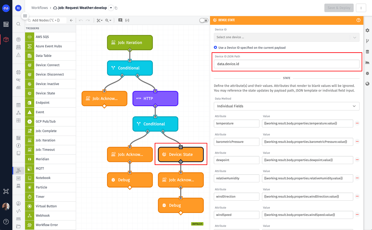

The Device State Node is where the result of the API request is being saved to the device’s attributes. The Job: Iteration Trigger places the ID of the device on the payload at data.device.id. This is the value we’re using for the Device ID JSON Path field so that state is saved for the correct device. As for the attributes and their values, they will be different for your devices and your API. You’ll have to modify your workflow accordingly.

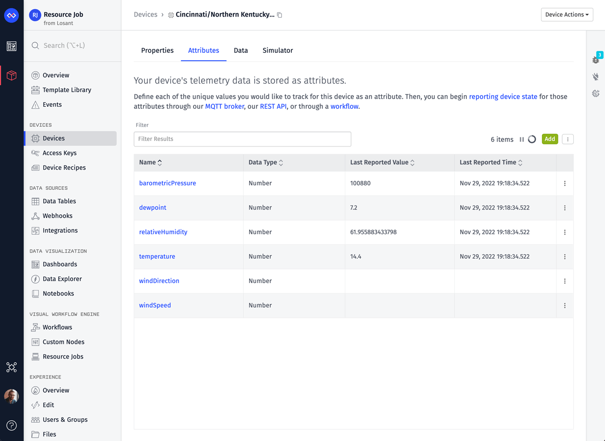

Since our workflow is recording device state, the last thing to verify is that state data is making it to our device. We can do this by opening the device overview page and switching to the Attributes tab.
Device State Data
Data is successfully being recorded and this specific station is not currently receiving data for windDirection or windSpeed.

Now that we have a job that successfully executes for one device, we can change the job to execute for all 2,904 devices.
All Devices Configuration

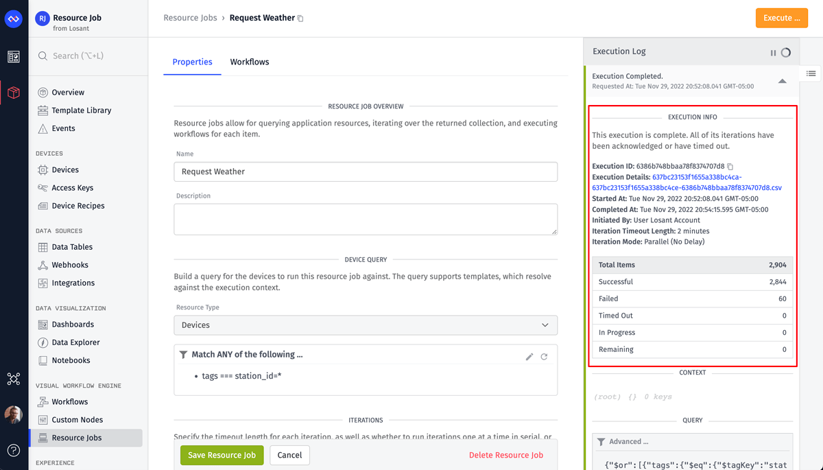

While a job is executing, you can view the results in real time by monitoring the Execution Log. Once the job is complete, you’ll be given a link to download a CSV file containing the results of every iteration.
Resource Job Execution Log
In the screenshot above, you can see that this job executed against all 2,904 devices, but 60 of them failed. Those failures correspond to any Job: Acknowledge Node that provided false as the acknowledgment value. Our workflow has two paths that result in a failure, but fortunately we made good use the failure message to help diagnose why a failure occurred.

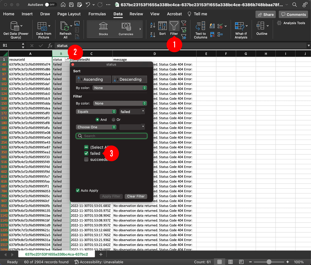

Let’s download and open the CSV file to find the iterations that failed. If you’re using Excel, you can filter the status column using the steps below:
Excel Column Filter
In this case, all 60 failures had the following message:
No observation data returned. Status Code 404 Error:
This means the API request was successful, but the API returned a 404 (Not Found) status code. It turns out that the NWS API does not return data for all 2,904 stations. This was not something we caught until we ran the test at full scale. At this point we have a few options:

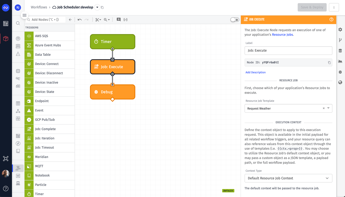

Up until this point we’ve been executing our jobs manually. However, one of the most powerful features of Resource Jobs is that they can be executed by other workflows.
The workflow below uses a Timer Node that’s configured to run every day at 2:00 AM EST. Once triggered, this workflow uses the Job: Execute Node to execute our job.
Schedule Resource Job Execution
The only required configuration for this node is the job to execute. This node also allows you to provide custom context data. Although we’re not using context, dynamically executing jobs with programmatic context is a powerful combination for advanced Resource Jobs use cases.
