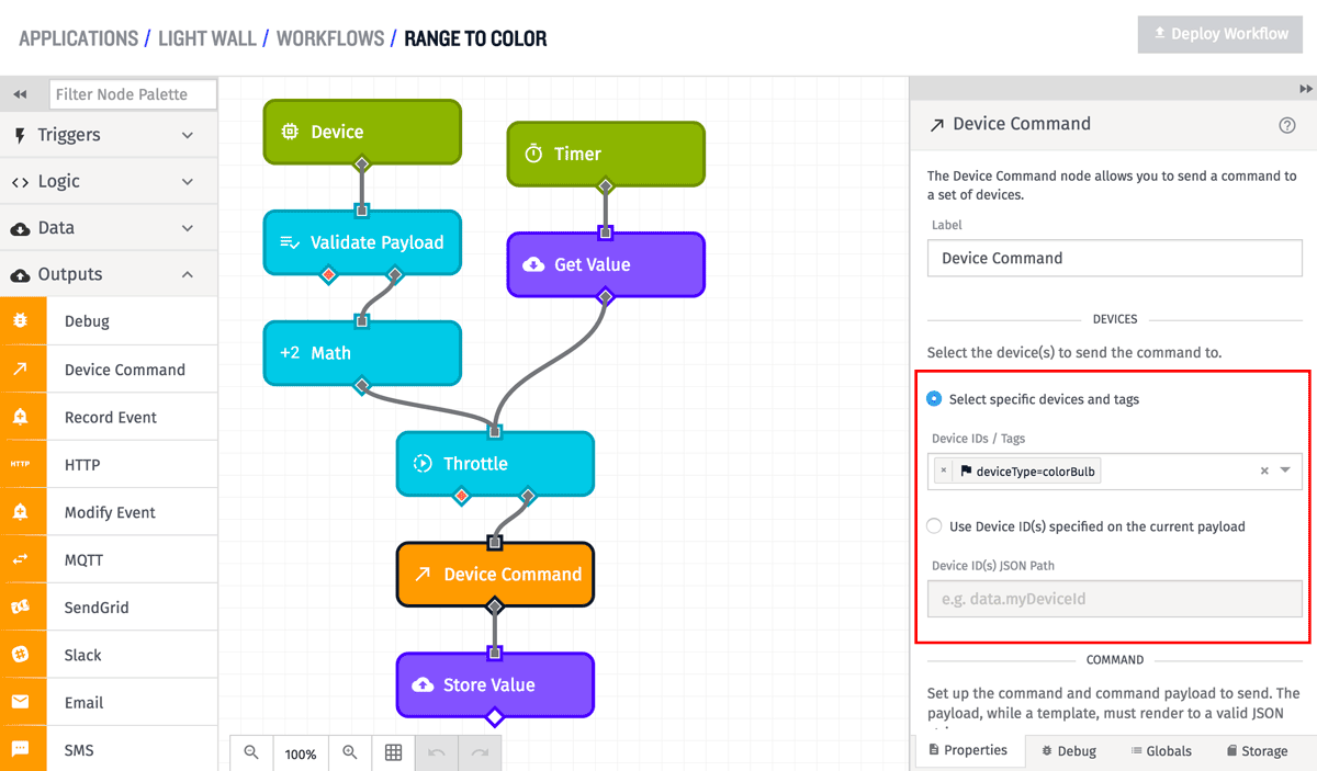

Device Selection
In the example above, the first option is being used, and the node will send the command all devices whose tag deviceType
is equal to colorBulb

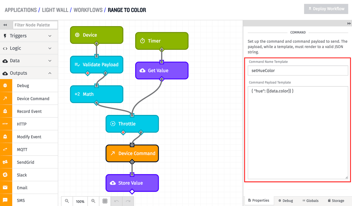

Command Configuration
In the above example, the Device: Command Node is sending the command setHueColor
with a payload. And given the following payload:
"voltage": 1.7,
"color": 1393
The Device: Command Node would send the following command payload with the setHueColor
command:
"hue": 1393
