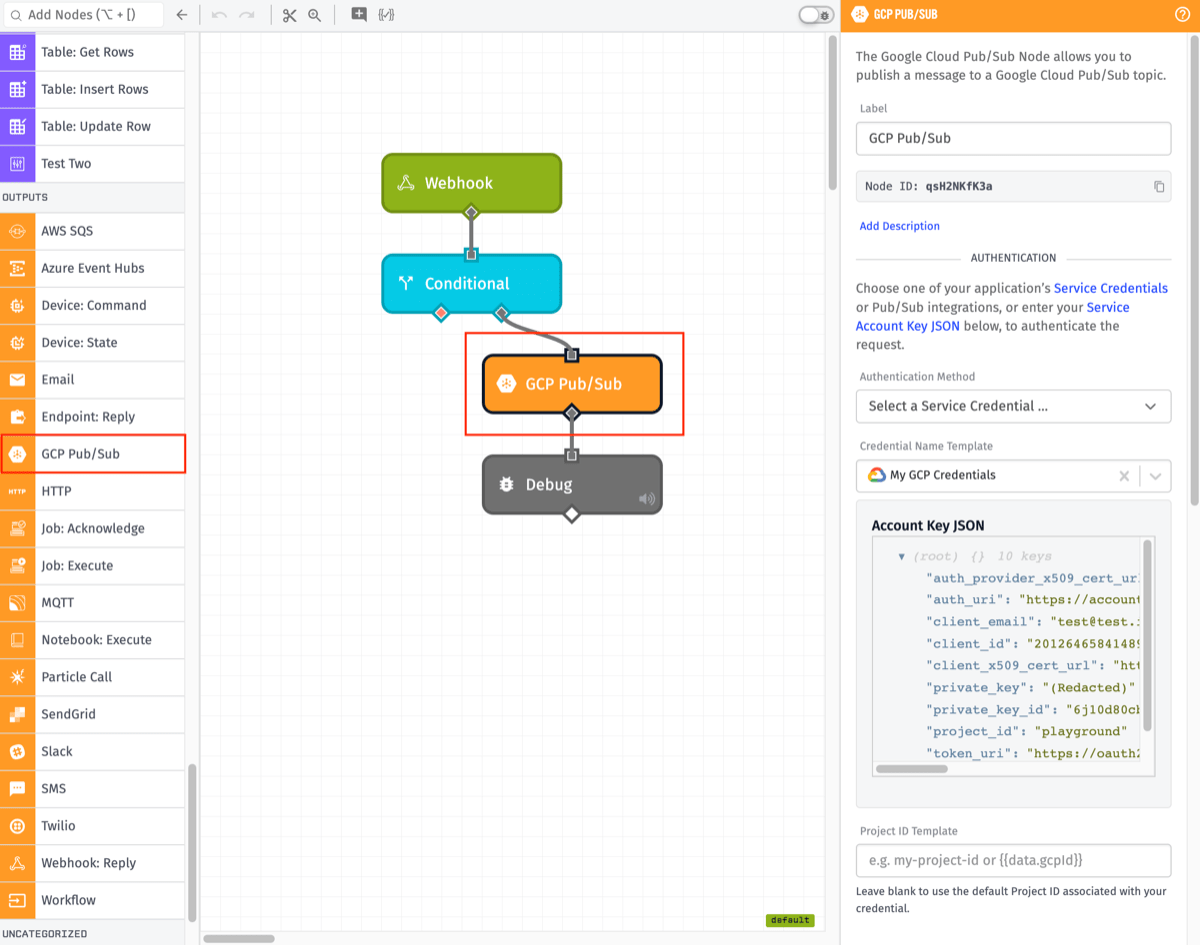

Configuration for the node is broken up into four sections.

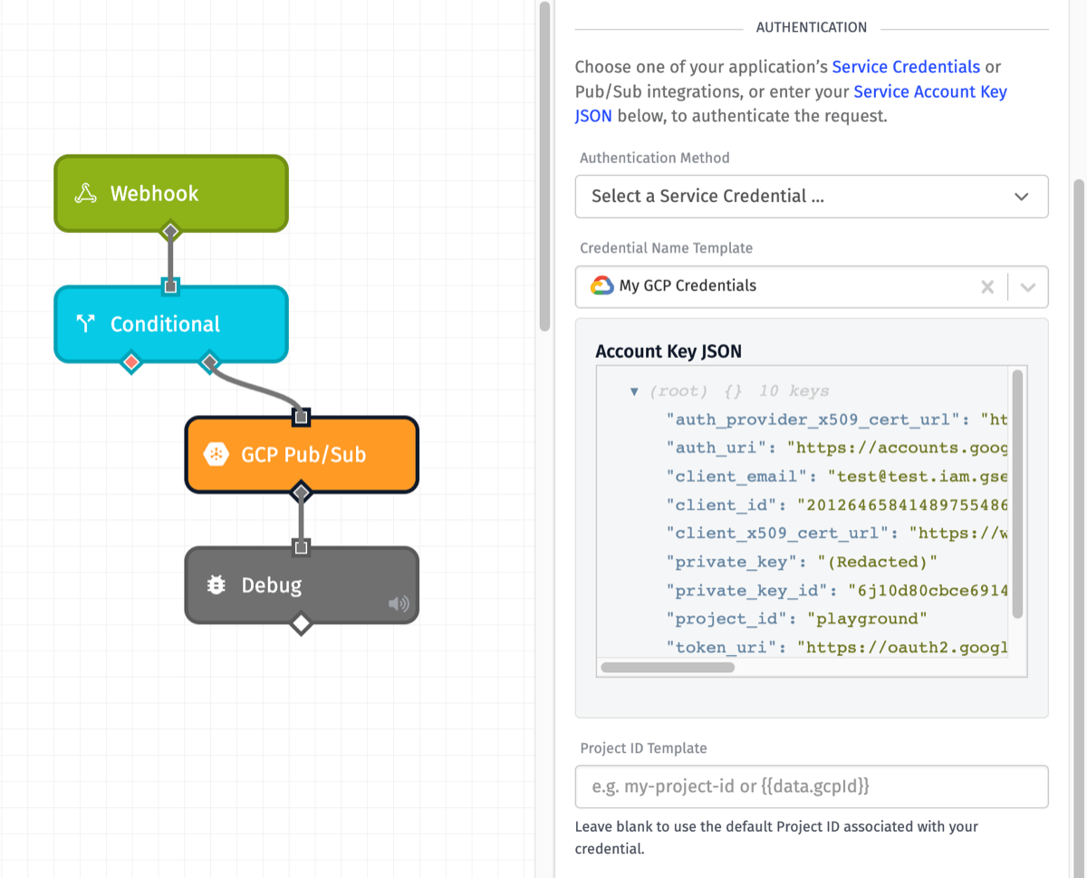

Authentication
First, we must enter our Google Cloud Storage credentials.
Note: We recommend that you create a service account key specifically for use in Losant workflows that has appropriate access to relevant storage buckets.
- Account Key Method: This may be supplied as either a Google Pub/Sub integration, a Service Credential, a JSON template, or a payload path. The integration ID and service credential name are both templatable.
The next configuration field will depend on the Account Key Method selected.
If you selected
Integration
as your Account Key Method, choose a Google Pub/Sub Integration you have created for your application. -
If you selected
Service Credential
as your Account Key Method, Credential Name Template can either be a string template that references your Service Credential name or you can select a Service Credential you have created for your application. -
If you selected
Direct Input (JSON Template)
as your Account Key Method, Account Key JSON Template can either be a string template that references your Google Service Account JSON Key or you may enter it in directly. -
If you selected
Direct Input (Payload Path)
as your Account Key Method, Account Key Payload Path is a payload path that references a Google Service Account Key that has access to publish to the selected topic.
The third configuration field appears for all Account Key Methods except for Integrations.
- Project ID Template: Can either be a string template that references your Project ID, or it can be left blank to use the default Project ID associated with your credential. This option is available for all Account Key Methods. In Edge workflows, this option can only be defined for Gateway Edge Agent version v1.42.0 or above.
