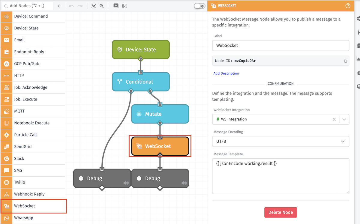

WebSocket Message Node
The WebSocket Message Node allows you to publish a message to a specific WebSocket integration.
WebSocket Message
The WebSocket Message Node takes three properties:
  • WebSocket Integration: The WebSocket integration to which the message should be published. The integration must be connected for the node to successfully publish. The ID is templatable.
  • Message Encoding: An encoding method for the message (defaults to UTF-8).
  • Message Template: A string template for the message to publish to the integration. If you would like to publish an object or array, the value should be properly encoded.
