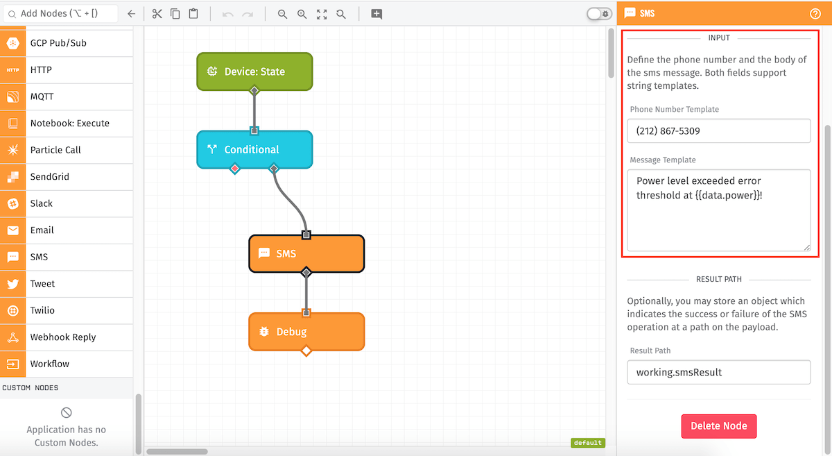

The SMS Node has two main configuration sections:
Input
- Phone Number (Required): The phone number of the recipient.
- Message Contents (Required): The contents of the message.
Both fields support string templates, and so can be dynamically determined from the payload of the currently executing workflow.
You may optionally store an indication of success or failure of the SMS operation at a path on the payload.
In the example above, the phone number being sent to is (212) 867-5309
and the contents of the message to being sent to that phone number will be Power level exceeded error threshold at {{data.power}}!
