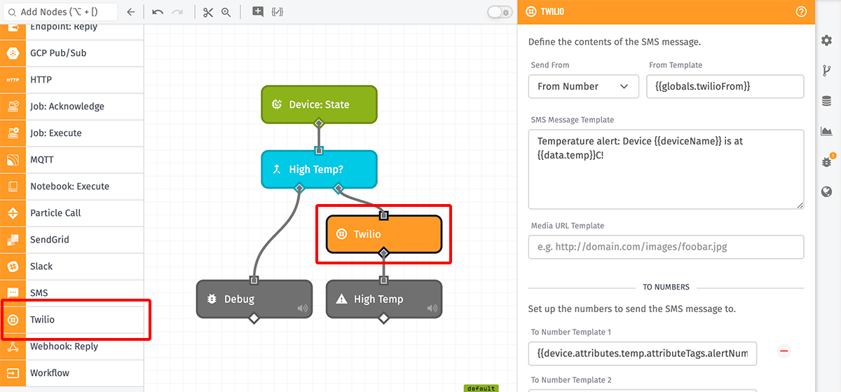

Twilio Node
The Twilio Node allows a workflow to send SMS messages using the configured Twilio account.
There are many configuration options to provide when setting up the Twilio Node, broken up into several sections ...

Message Configuration
Next, configure the content of the SMS message ...
- Send From: Choose whether to send the message from one of your Twilio phone numbers or from an SID.
- From Template: Depending on the "Send From" choice, provide a string template that resolves to either a phone number or an SID in this field. This value must be associated with your Twilio account provided in the Twilio configuration.
- SMS Message Template: Provide the body of the message. This should resolve to a short, plain-text message.
- Media URL Template: Optionally, you may also provide a publicly available URL to a multimedia object to include as an attachment.
Either the SMS Message Template or the Media URL Template must be provided; you may also provide both.
