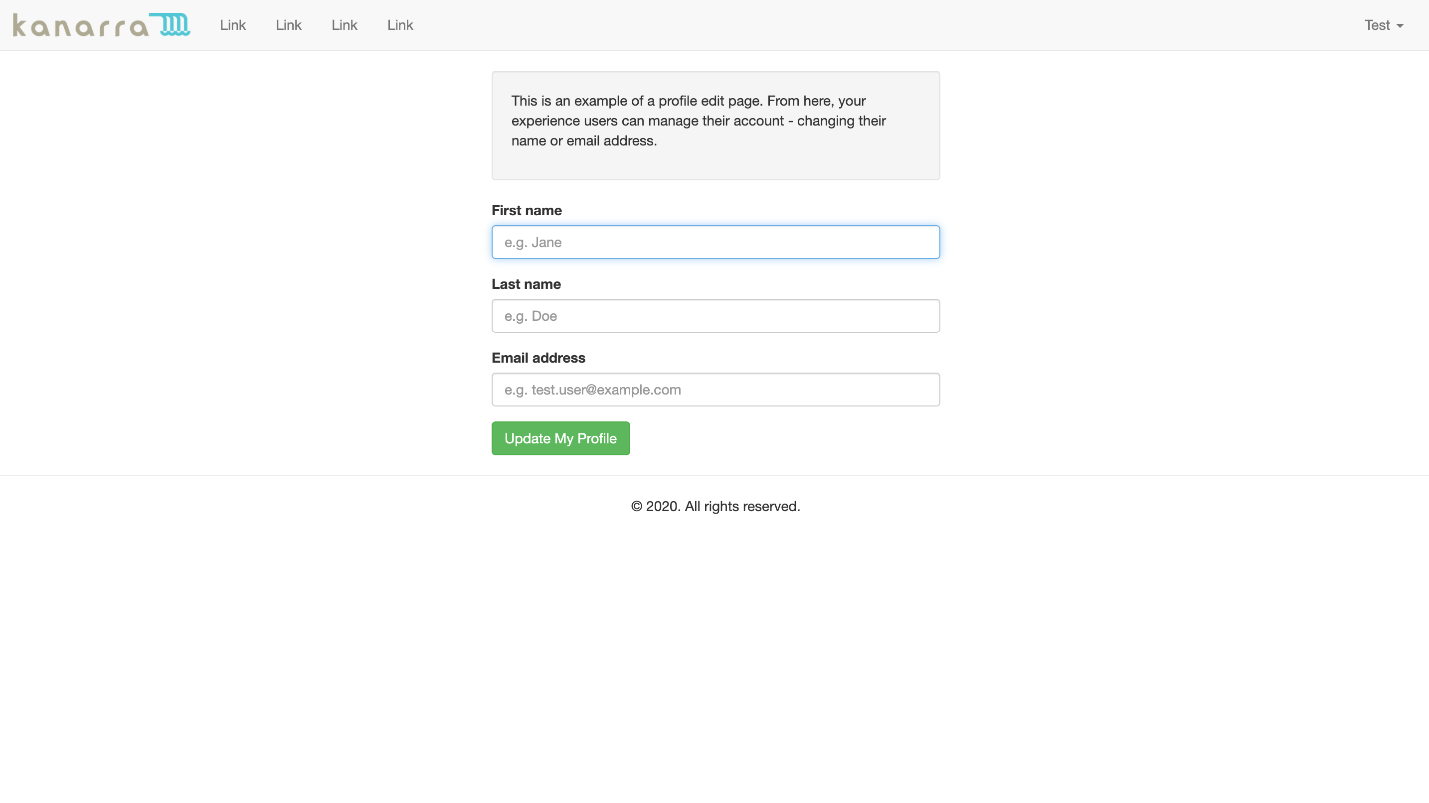

Page: Edit Profile
First, you'll create a new page to render when the /edit-profile endpoint is requested. From here, users can change their name and email address.
  1. Click "Views" in the left column to return to your Experience Views list.
  2. Click the "Add" button in the "Pages" list.
  3. Name the page Edit Profile.
  4. Add a description; the field is optional and does not affect the page as it is presented to your experience users.
  5. Select your previously created layout for the page's Layout.
  6. Click "Create Page". This will redirect you to a screen where you can edit the new page's content.
  7. Copy this snippet and paste it for the page's Content.
  8. Once the page is ready, click "Create Page" to save your work.

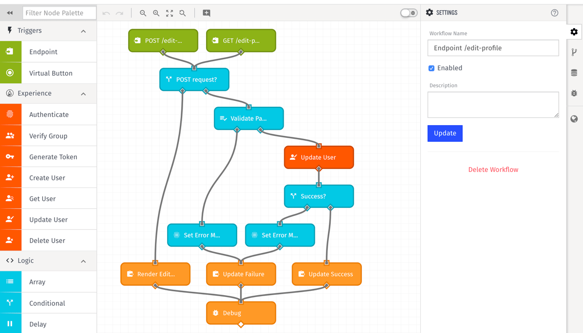

Edit Profile Workflow
  1. Download the workflow template.
  2. Import the file endpoint-edit-profile.flow as a new experience workflow.
  3. Update each of the endpoint triggers to point to the POST /edit-profile and GET /edit-profile endpoints you created above.
  4. Update the endpoint reply nodes to point to your Edit Profile page.
  5. Enable the workflow (since imported workflows are by default disabled).
As a general overview, this workflow handles the following:
  • If a user visits /edit-profile, you respond to the request with your new Edit Profile page.
  • When that user submits the Edit Profile form, you validate that they have submitted all fields correctly. Then, you attempt to make the update. It could fail if, for example, the user attempts to change their email address to one that is already registered to another experience user. If either of these operations fail, you re-render the Edit Profile page with an error message.
  • If the user update is successful, you redirect the user to the same URL with a success=true query parameter. The presence of this on the URL tells you if you should show your successAlert component.
There is a comment on each workflow node describing its function in more detail.

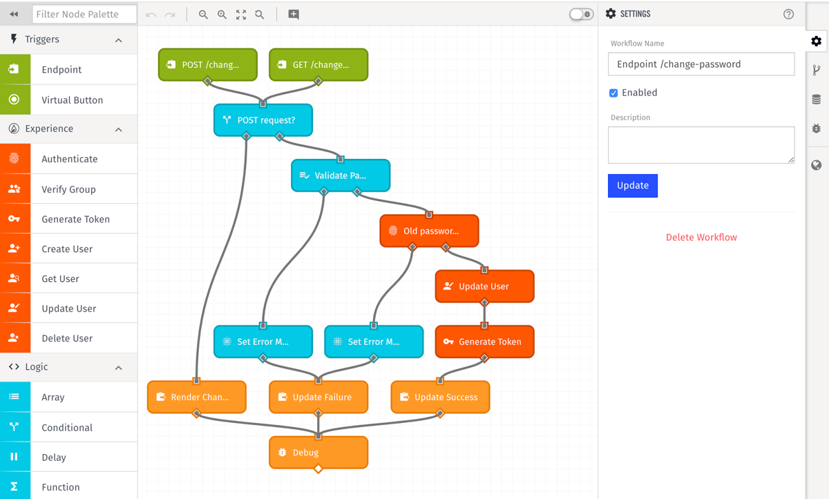

Change Password Workflow
Now create a workflow allowing your logged-in users to update their passwords.
  1. Download the workflow template, then import the file endpoint-change-password.flow as a new experience workflow.
  2. Update each of the endpoint triggers to point to the POST /change-password and GET /change-password endpoints you created above.
  3. Update the endpoint reply nodes to point to your Change Password page.
  4. Enable the workflow (since imported workflows are disabled by default).
  • If a user visits /change-password, you respond to the request with your new Change Password page.
  • When that user submits the Change Password form, you validate that they have submitted valid old and new passwords. Then, you try authenticating using the old password provided by the user. If any of those checks fail, you re-render the Change Password page with an error message.
  • If authentication succeeds, you change the user's password and display a confirmation message.

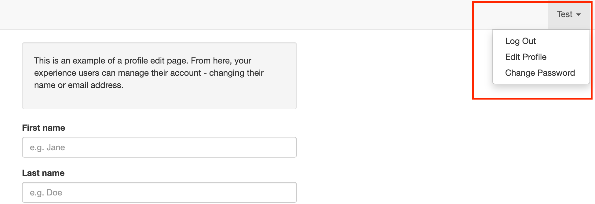

Edit Profile Links
Component Edit: userIndicator
Currently, your userIndicator component displays a single-item dropdown menu in your layout's top right corner when the user is logged in. Add links to our two new features into that menu.
Navigate to the userIndicator component from the "Components" list. In the Content, immediately above this line:
<li><a href="/logout">Log Out</a></li>
Add the following two links:
<li><a href="/edit-profile">Edit Profile</a></li>
<li><a href="/change-password">Change Password</a></li>
Alternatively, you can copy this content and overwrite the entire userIndicator component.
Now, a signed-in user can access the /edit-profile and /change-password links from their contextual menu.
