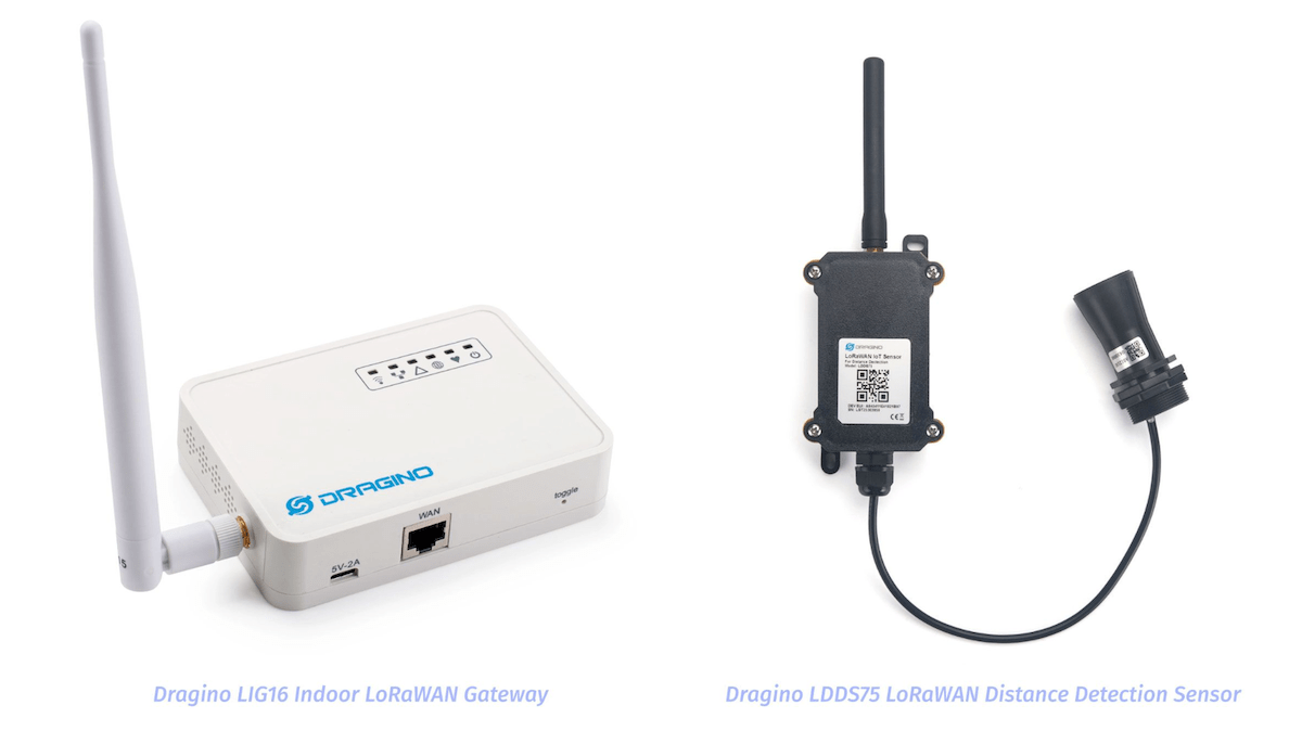

This How-To Guide will walk you through connecting a LoRaWAN device to the Losant Platform using The Things Stack (TTS). The hardware that is used in this tutorial is the Dragino LIG16 Indoor LoRaWAN Gateway and the Dragino LDDS75 LoRaWAN Distance Detection Sensor.
LoRaWAN hardware

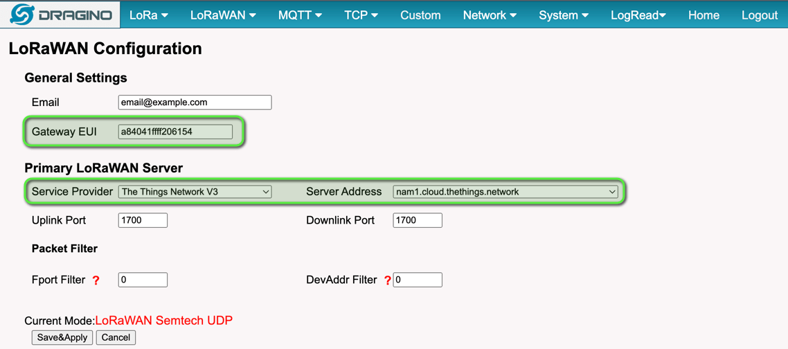

Log in to your gateway and configure the gateway to connect to TTS. For the Dragino LIG16, navigate to the LoRaWAN Semtech UDP page and enter the Primary Service Provider and Server Address that you will be using for your gateway. The remaining fields, including the Gateway EUI (which is required to register the gateway to TTS), are left at their default values.

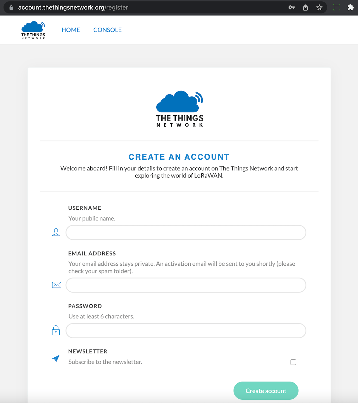

Register for a free TTS account. Once you register, open the verification email from TTS and click the provided link to activate your account.

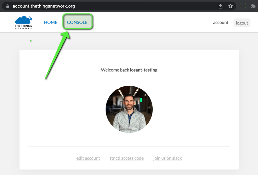

Once your account is activated, click on CONSOLE.
Click on Console

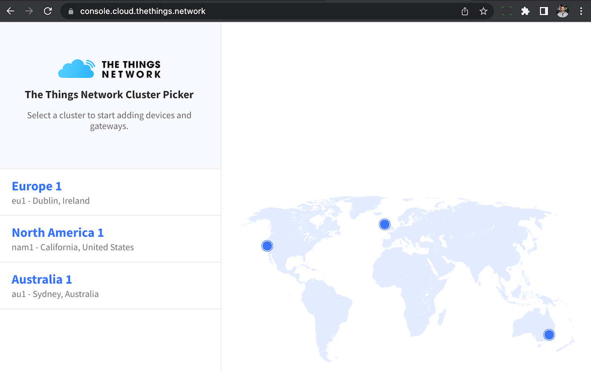

Select the region in which your LoRaWAN gateway and sensors will be deployed.
Select Region

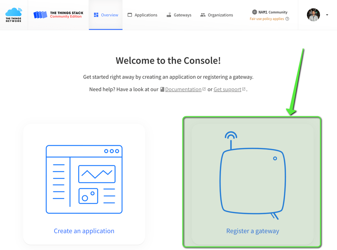

Click Register a gateway to register your gateway.
Register a gateway

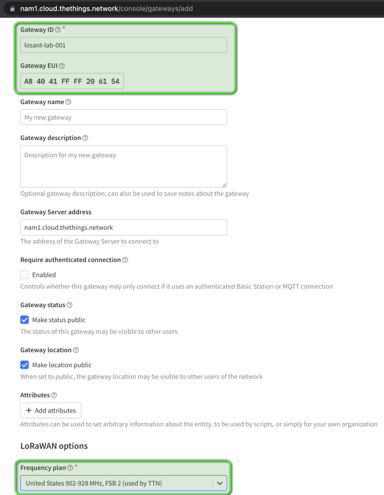

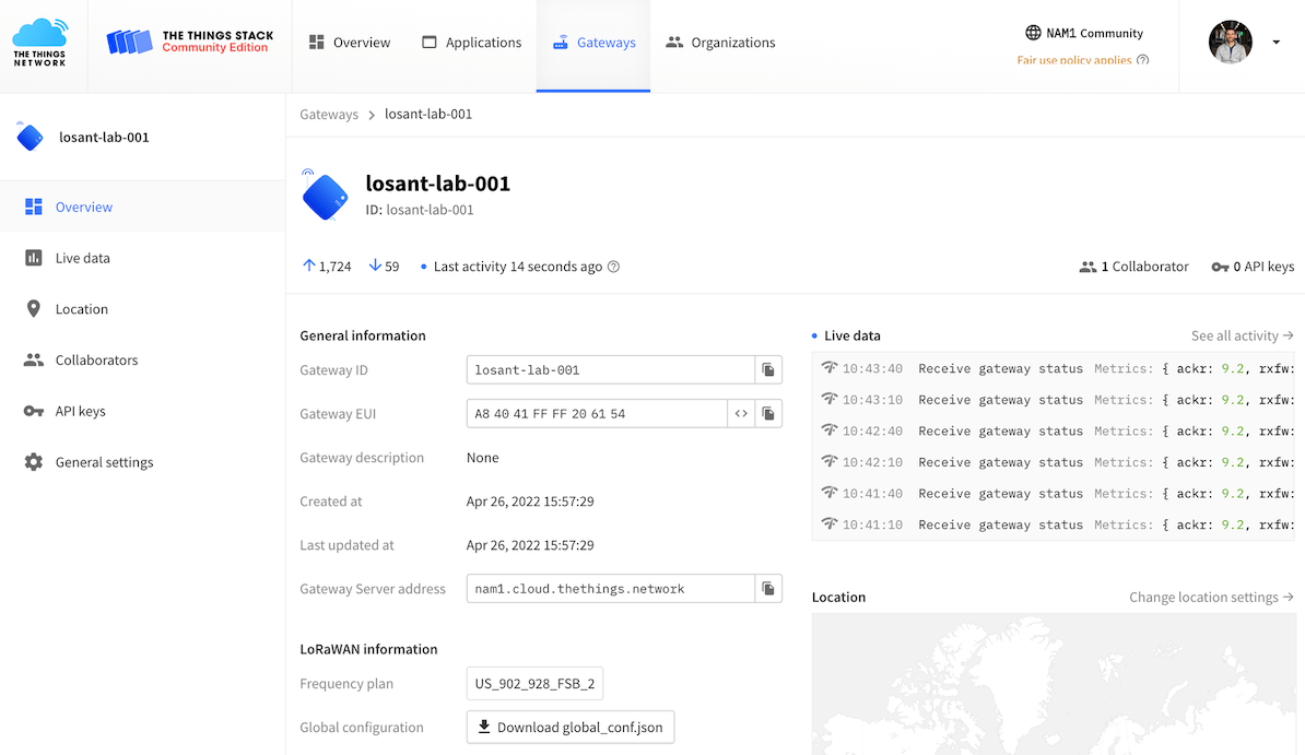

Enter a Gateway ID, Gateway EUI (which will come from the gateway), and frequency plan for your gateway, and then click Create gateway.
Create gateway
Verify that your gateway is connected to TTS by checking that live data (gateway status) is being received from the gateway.
Verify connection

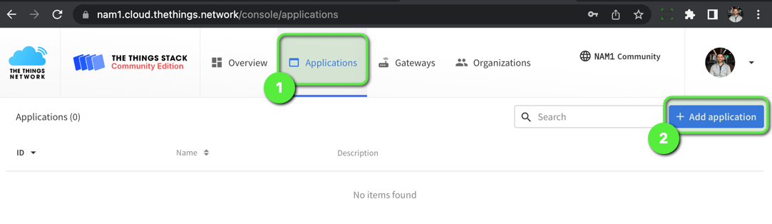

Click on Applications and then Add application.
Add application

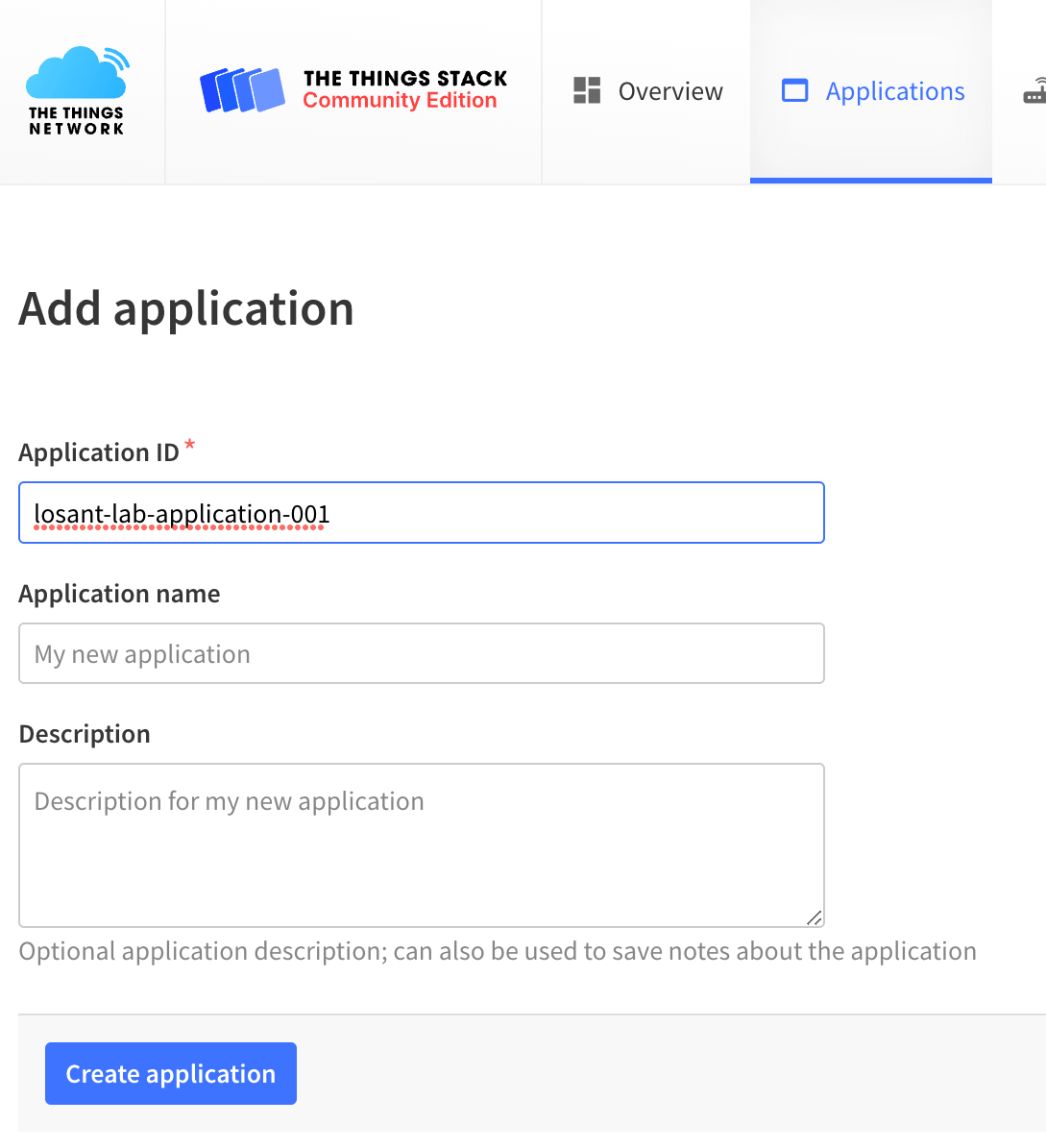

Fill in an Application ID (optionally, you may also enter a name and description) and then click Create application.
Application ID

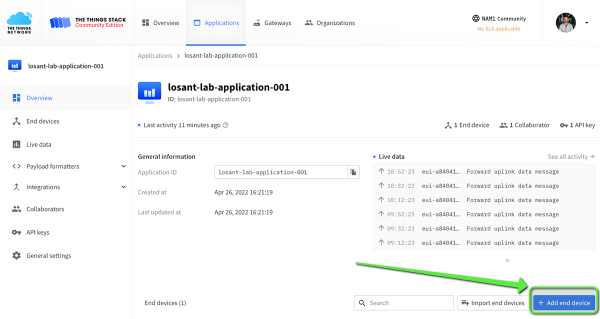

Now that the application is created, click Add end device. This can also be found by clicking on the side navigation bar and clicking on End devices and then Add end device.
Add end device

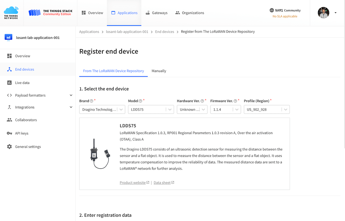

First, if your device brand and model has a first-class integration with TTS then select the Brand, Model, Hardware Ver., Firmware Ver., and Profile (Region). Note: If your device is not supported, then follow these steps to manually register your device.
Select the end device

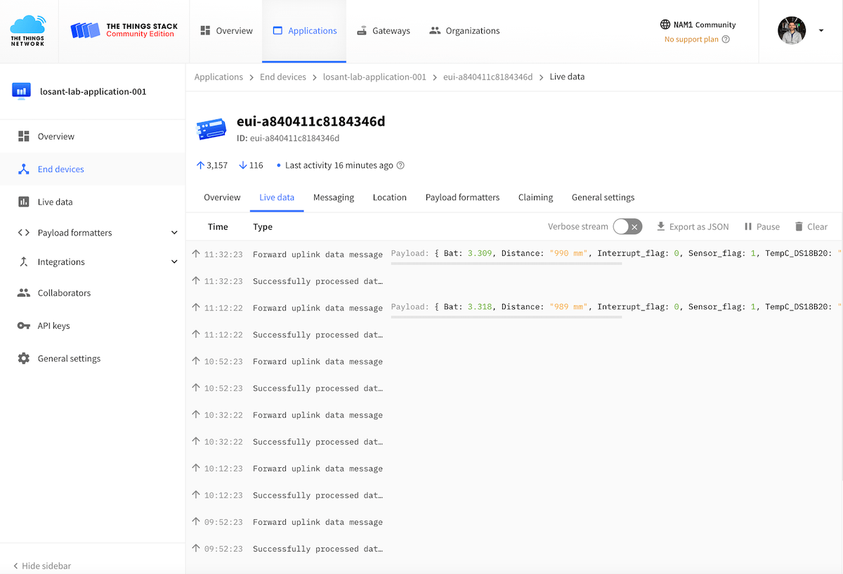

Confirm that you are receiving data from this device. You will only see activity when the sensor reports data; check with the manufacturer to see the default reporting interval for your device, which is likely several minutes or more.

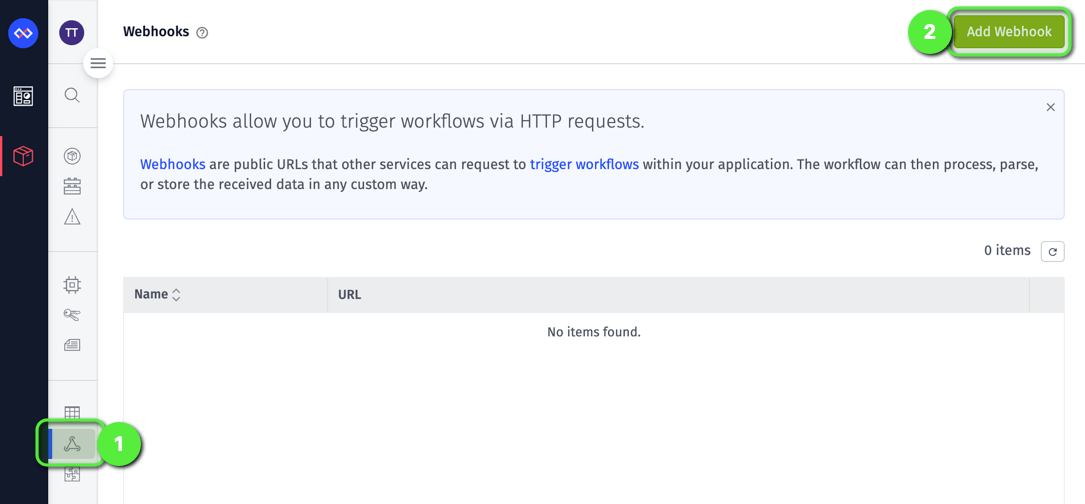

Once you’ve created a new application, click Webhooks and then Add Webhook.
Add Webhook

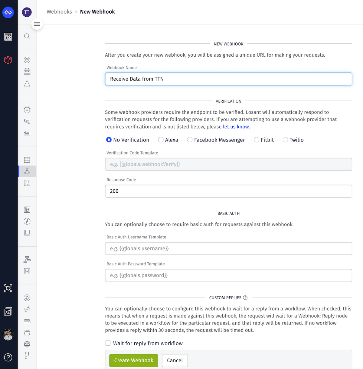

Enter a Webhook Name and then click Create Webhook. You may also enter a username and password to use Basic Auth. If you use Basic Auth, you will need to edit your Losant Webhook in TTS.

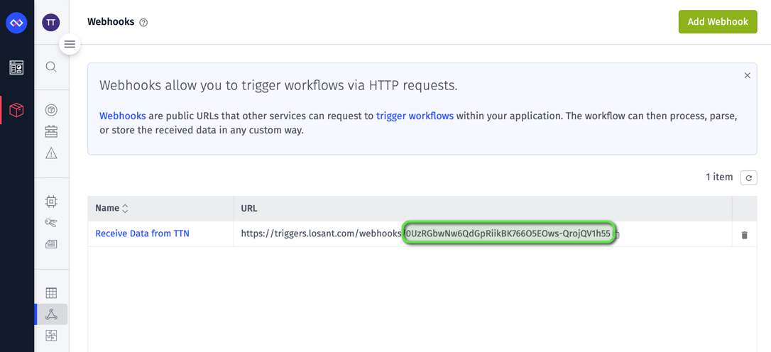

Once the Webhook is created, copy the unique identifier from the URL that comes after https://triggers.losant.com/webhooks/.
Unique ID

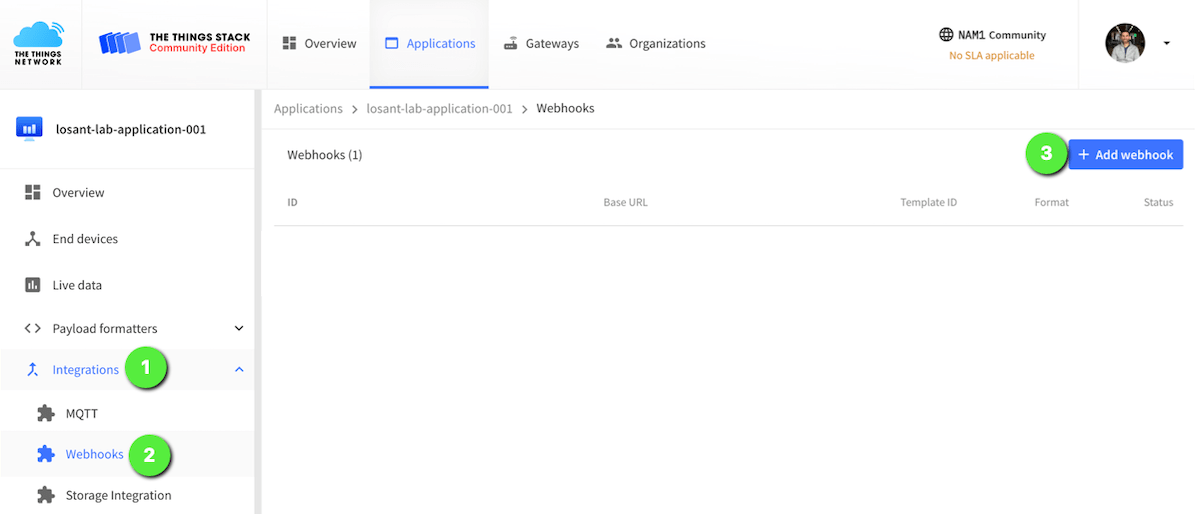

In the TTS application that was created in Step 4, click on Integrations, then Webhooks, and then Add webhook.
Add webhook

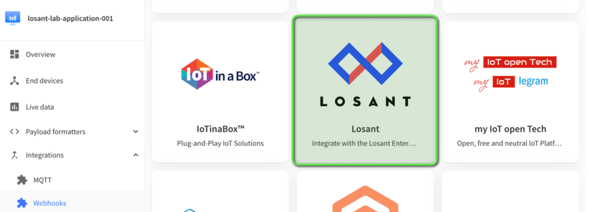

Click on the Losant Webhook tile. If you are using Basic Auth for this Webhook or need to subscribe to more than just uplink messages, then please review the end of this How-To Guide in the section named Editing Your Losant Webhook in TTS.
Losant Webhook

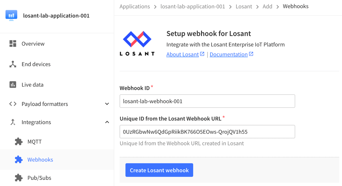

Enter the following information into the Losant Webhook configuration:
  • Webhook ID: Make up any name that you would like. This does not have to be the ID of the webhook as it is stored in Losant.
  • Unique ID of Losant Webhook URL: This is the Losant Webhook unique ID that was copied to the clipboard in Step 5.
Finally, click Create Losant webhook. If you need to configure additional options (e.g. Basic Auth or additional messages to subscribe to), use the TTS Custom Webhook Template or add these options once the Webhook in TTS is created by following the last section of this guide, Editing Your Losant Webhook in TTS.

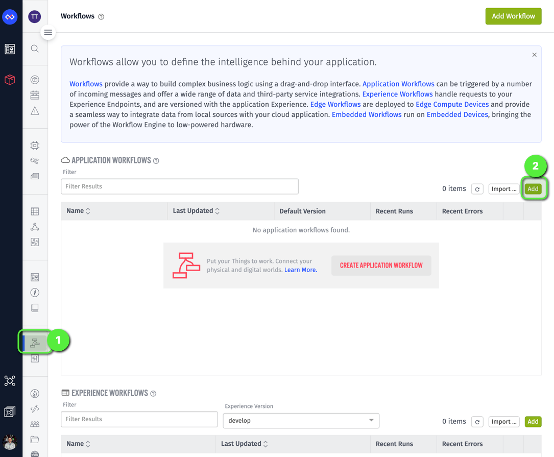

Since TTS is now configured to forward data to the Losant Webhook, let’s create a Losant Application Workflow to receive the data from TTS.
Click on Workflows and then in the Application Workflow section, click Add to create a new Application Workflow.
Application Workflow Add

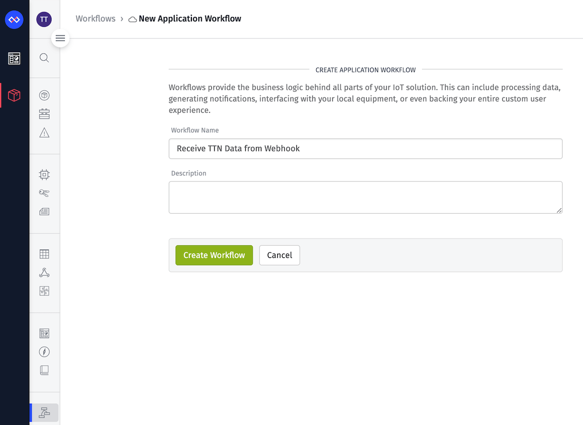

Enter a name for your Application Workflow (as well as a description if you'd like) and click Create Workflow.
Create Workflow

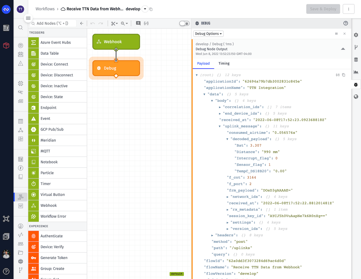

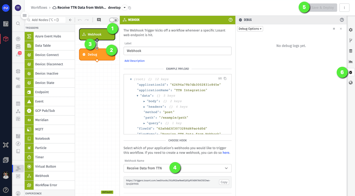

Drag and drop the Webhook Trigger and the Debug Node onto the visual workflow engine’s canvas and connect them together. If you have only one webhook in this Losant application, it will be automatically selected for the Webhook Trigger. If you have multiple webhooks, select the one that was created in Step 5. Next, click Save and Deploy. Now that this workflow is deployed, click on the Debug Panel.
Webhook Trigger
When TTS receives new data from the sensor, it will send that data to Losant over the Losant Webhook and trigger this workflow. Each time this workflow runs, new data will be displayed in the Debug Panel as shown below.
Note: If TTS is not automatically decoding your data as shown below in data.body.uplink_message.decoded_payload, then you can decode your LoRaWAN device data in this Losant Application Workflow. Check out the blog post How To Decode and Visualize Your LoRaWAN Sensor Data Using TTS and Losant to learn more about decoding LoRaWAN data in Losant.
Debug

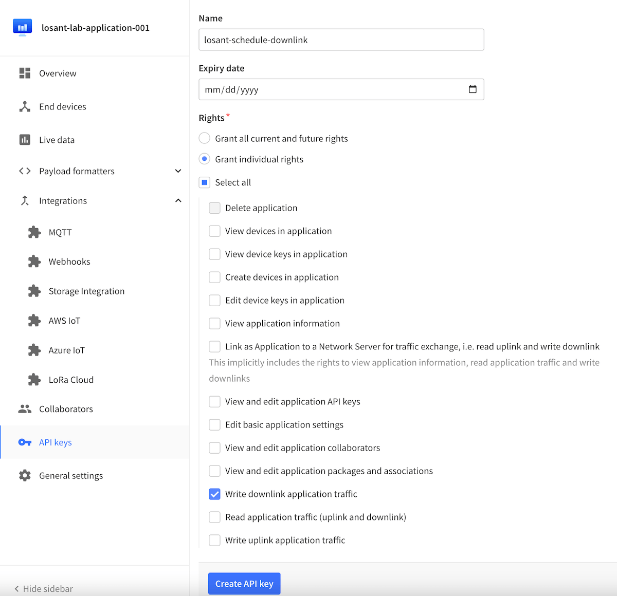

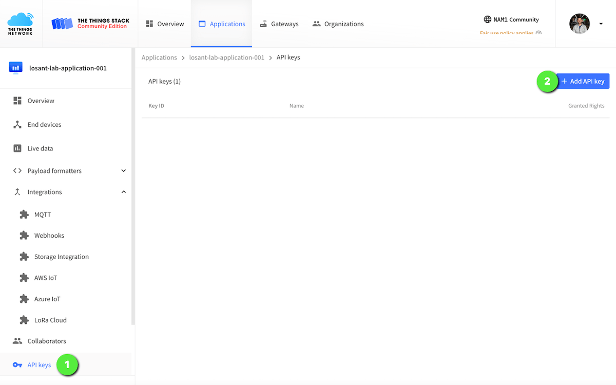

In the TTS application that was created in Step 4, click on API keys and then Add API key.
Add API key
Give the API key a name, select Grant individual rights, select Write downlink application traffic, and then click Create API key.
Create API key

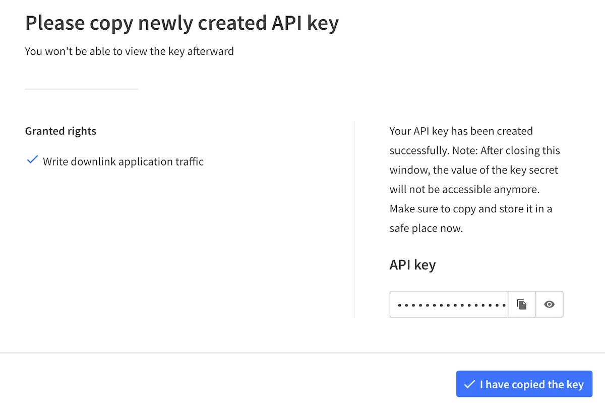

Copy the API key and then click I have copied the key.
Copy key

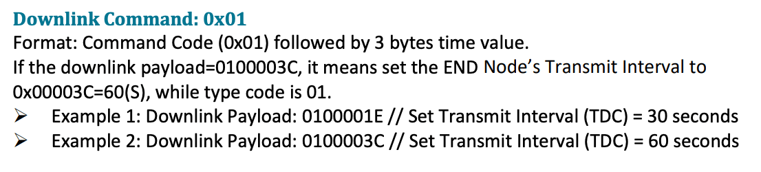

To send downlinks to your device, you will have to reference your device’s manual to find out which commands are supported by your device. For the Dragino Distance Sensor, we will update the interval at which the device sends data to TTS and ultimately to Losant. The Dragino End Device AT Commands and Downlink Commands Manual states that the downlink command is 0x01 followed by the interval time as shown below.
Dragino Downlink Command

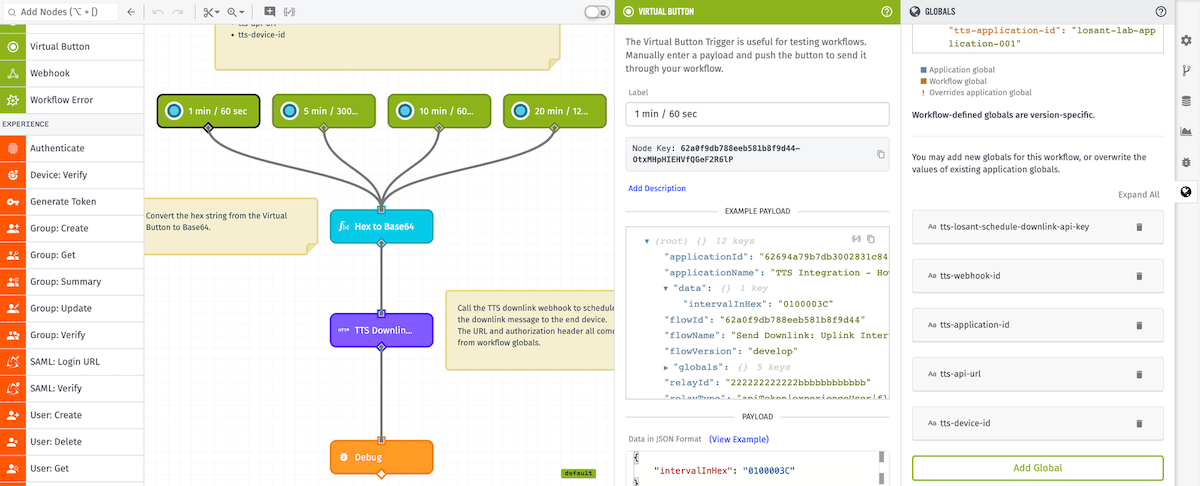

Once the variables have been set, save the workflow. Then, enable the workflow through the “Properties” panel to allow for pressing the Virtual Buttons.
The workflow contains:
  • Multiple Virtual Button Triggers for setting the downlink payload to different values.
  • A Function Node for converting the hex-encoded downlink value to Base64-encoded (which is what TTS accepts).
  • An HTTP Node that calls a TTS webhook.
    • The URL is constructed from the workflow’s global variables.
    • The request is authenticated using a token that is also set in a global.
    • The body is constructed as a JSON object, utilizing the Base64-encoded instructions from the pressed Virtual Button. The object format matches what our LoRaWAN device expects.
    • A User-Agent header is included based on recommended best practices from TTS, though the header is not actually required.
  • A Debug Node that prints the result of the request to your workflow’s debug log.

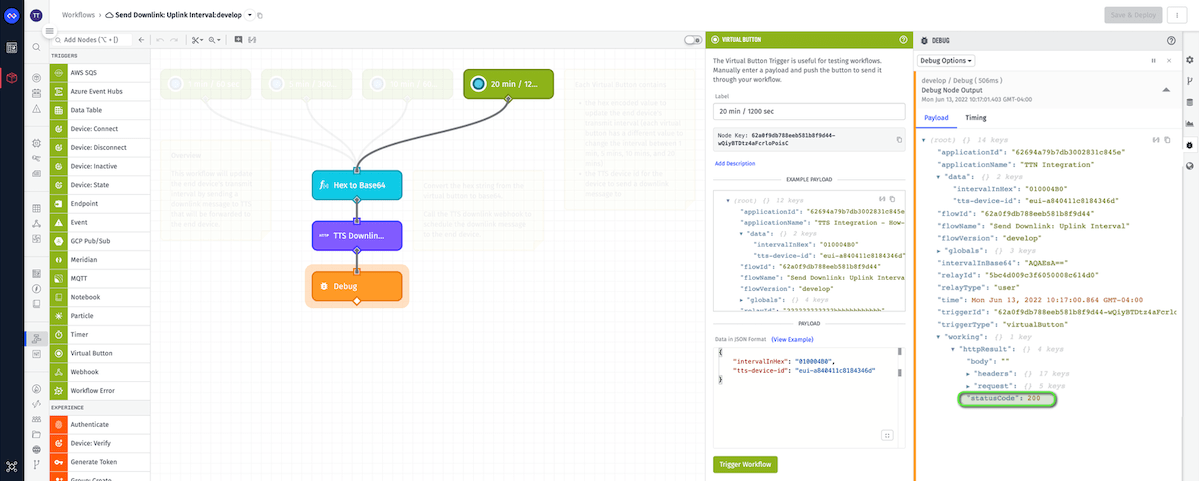

Debug log
As you can see in the screenshot above, there are four Virtual Buttons to command the device’s report interval to different times (1 min, 5 mins, 10 mins, and 20 mins). Each of these Virtual Buttons includes a different downlink command, starting with the hex-encoded value for the uplink interval command and followed by the hex-encoded uplink interval time.

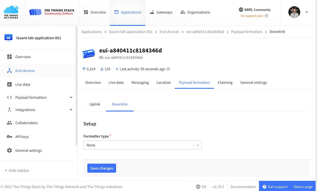

Since we are configuring the HTTP body in the format that the LoRaWAN sensor expects it in, we have to ensure that in TTS we set the downlink payload formatters to NONE as shown below for our device.
Payload formatters
Clicking the “20 min” Virtual Button will send the downlink command to TTS. The result of the HTTP request in Losant is shown below.
20 min Virtual Button

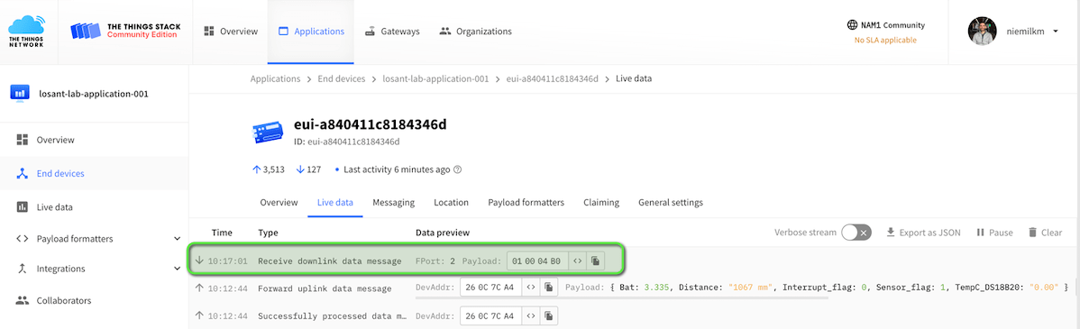

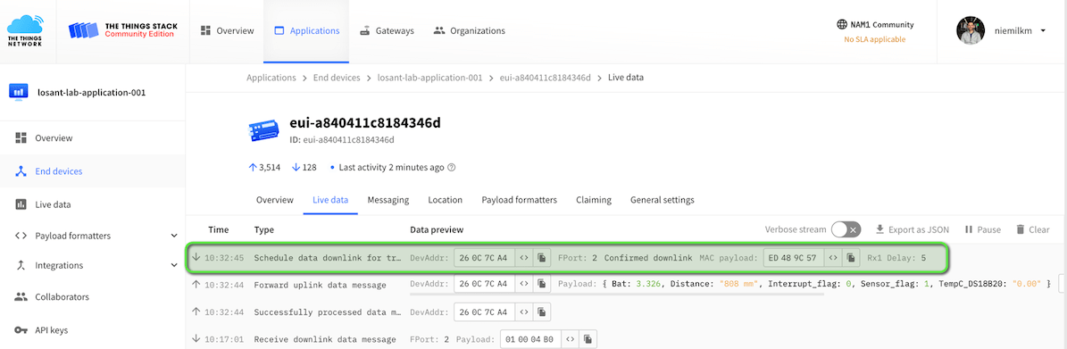

Once the downlink command is received from Losant in TTS, then the TTS Live data update will display that it received that command as shown below.
Live data received
Once the downlink to the device is successful, the Live data in TTS will update as shown below.
Live data updated
