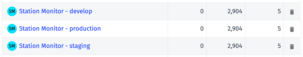

Applications List

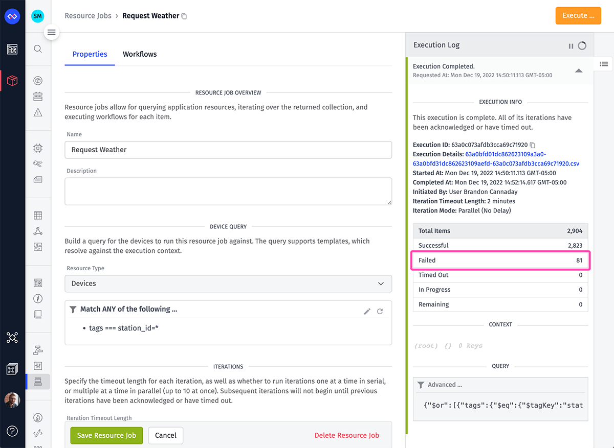

We have three applications representing the three lifecycle environments (develop → staging → production). This application uses a Resource Job to poll data from every U.S. weather station. For step-by-step instructions for building this application, please see the guide, How To Use Resource Jobs to Poll Device State From an API.
There is a change that needs to be made to this application and then promoted to staging and production. For a subset of stations, the weather.gov API returns a 404 Not Found response code. Currently, those are acknowledged as iteration failures.
Resource Job With Failures

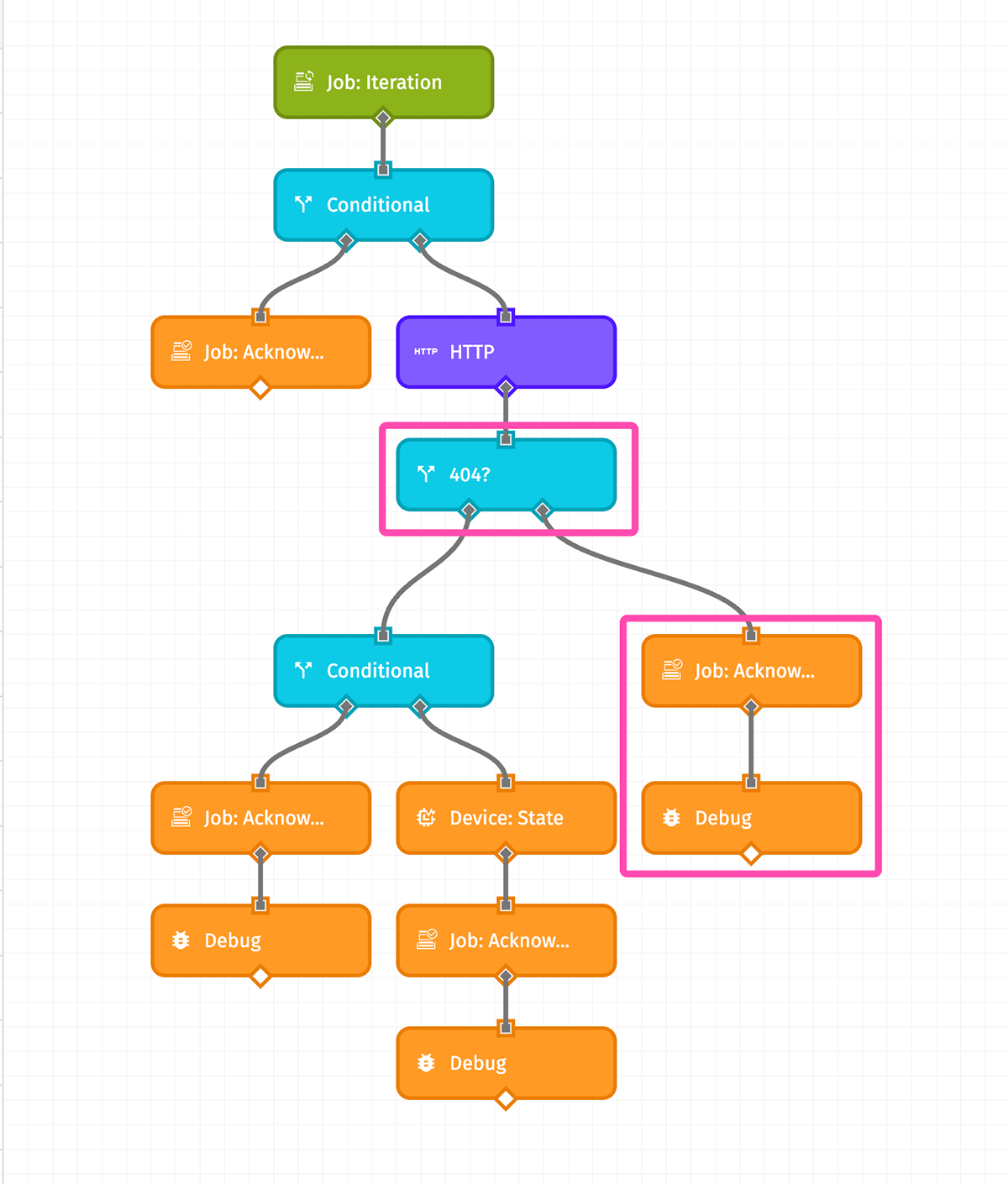

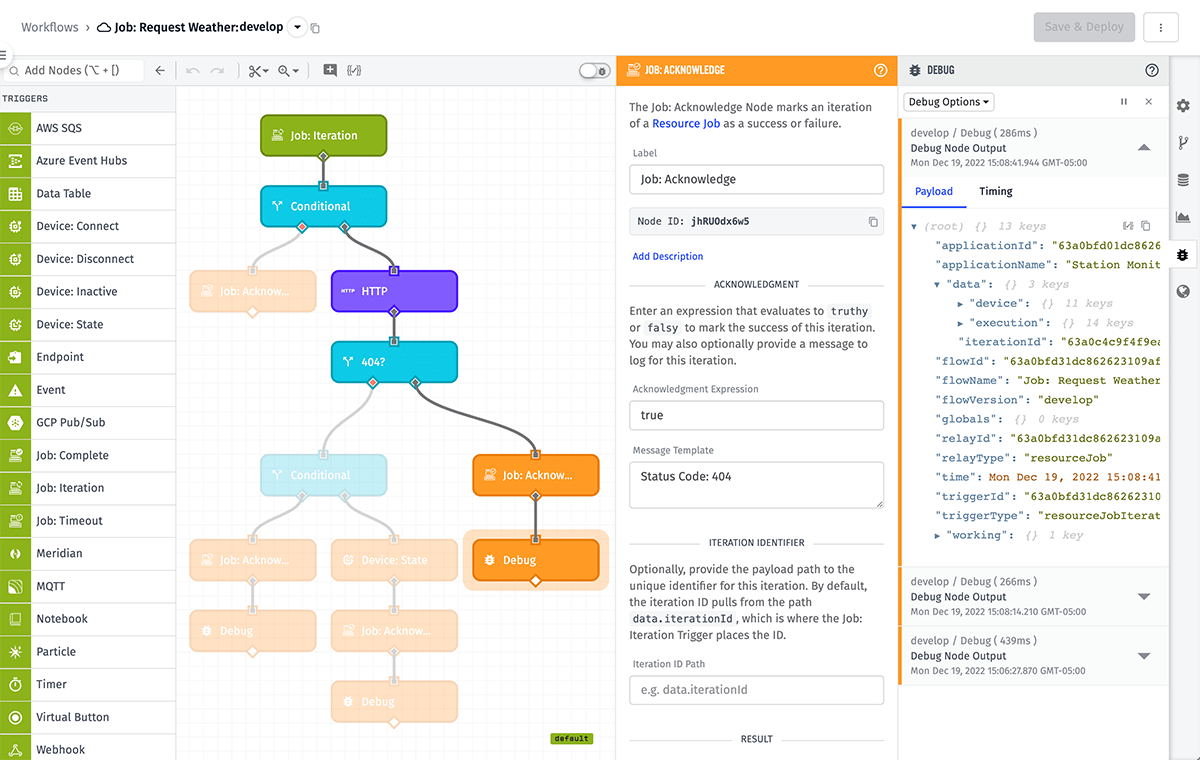

We instead want to change the job’s workflow to catch 404 responses, acknowledge the iteration as successful, and add a message to the final report indicating a 404 was received. Since all changes must be applied to the application representing the lowest stage in the application lifecycle, these changes are made to Station Monitor - develop.
The actual details of the workflow aren’t important for this guide, but the screenshot below shows the new workflow with added logic to catch and acknowledge the 404 status codes.
Workflow Catching 404 Errors
We can also see in the screenshot below that the 81 failures are gone with our changes.

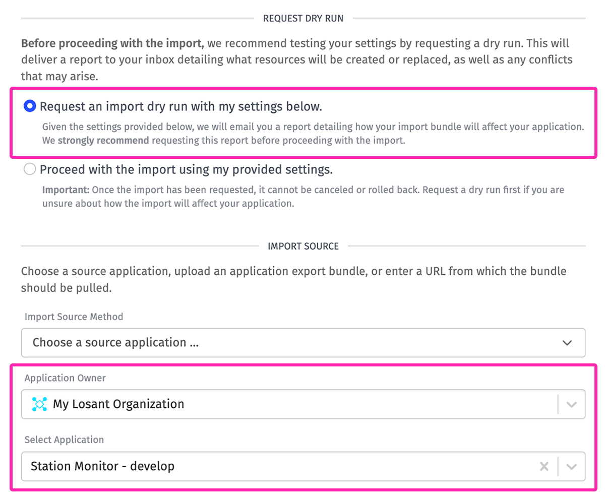

Request an Import Dry Run
Before performing any import, it’s important to always request a dry run. This returns a CSV file containing the action that will be performed on each resource given the import configuration you provide. This is a protection mechanism to ensure that you’ve selected the appropriate Conflict Behavior.
Switch over to the Station Monitor - staging application and visit its Application Import interface. "Request an import dry run" is selected by default.
Choosing a Source Application
In the Import Source section, the "Choose a source application" option is selected by default. Choose the Station Monitor - develop application as the source for this request.

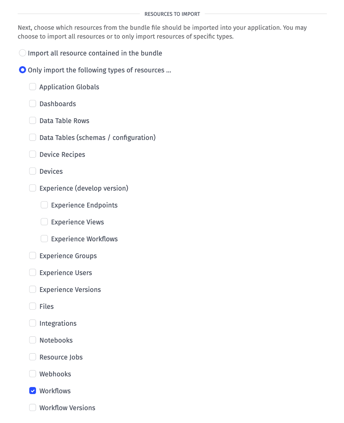

Resources to Import
When importing resources from any source, you have additional control over which types of resources to import using the Resources to Import section. In this example, we’re going to import all resources. However, since we know that only a workflow has been changed, we could choose only "Workflows" as an added measure of protection.

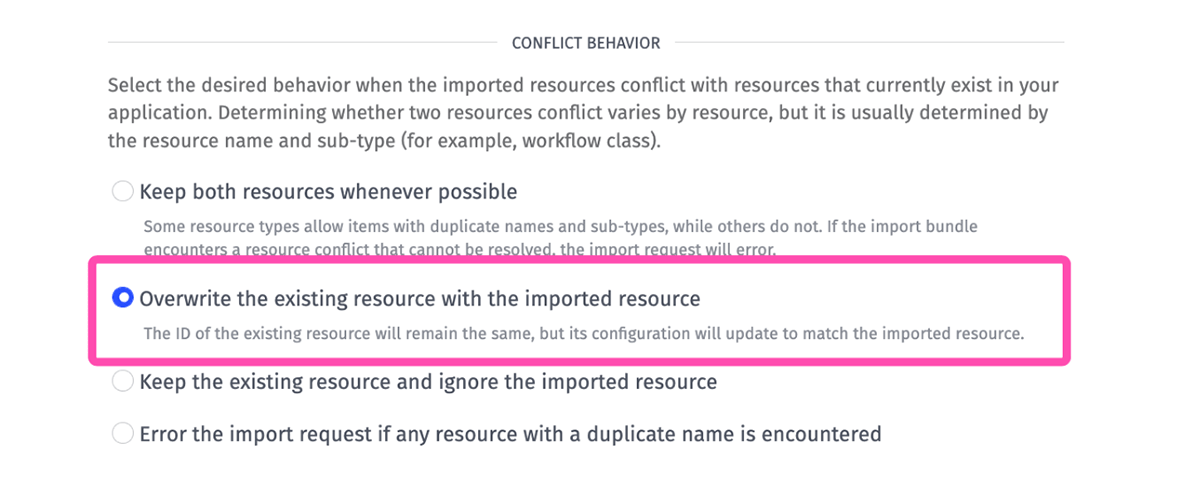

Conflict Behavior
The Conflict Behavior highlighted in the screenshot below ("Overwrite the existing resource with the imported resource") is specifically designed to facilitate application lifecycle. This option will find matching resources between the source and destination applications and determine how to apply changes to the destination application.

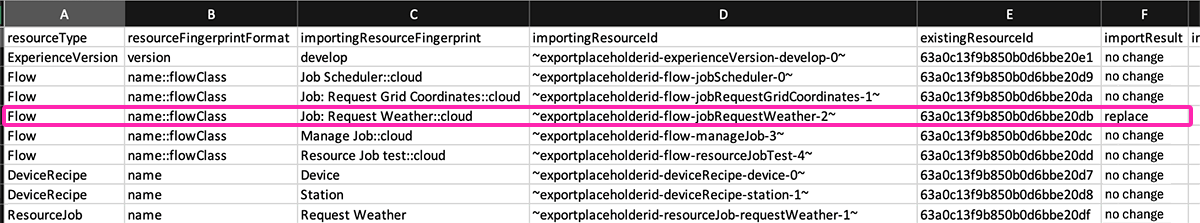

Dry Run Report
At this point we can request the dry run and inspect the results once the report is available:
Correct Dry Run Report
The screenshot above is showing the output of our dry run. It is telling us that it found several matching resources between our source application ("develop") and our destination application ("staging"). Notice how the majority of the resources are marked as "no change" - meaning that there were no updates to the "develop" resources since the last time the application was imported into "staging". The exception to this is our "Job: Request Weather", which we updated in the "develop" version. As a result, the dry run indicates that this resource will be “replaced” by the imported resource.

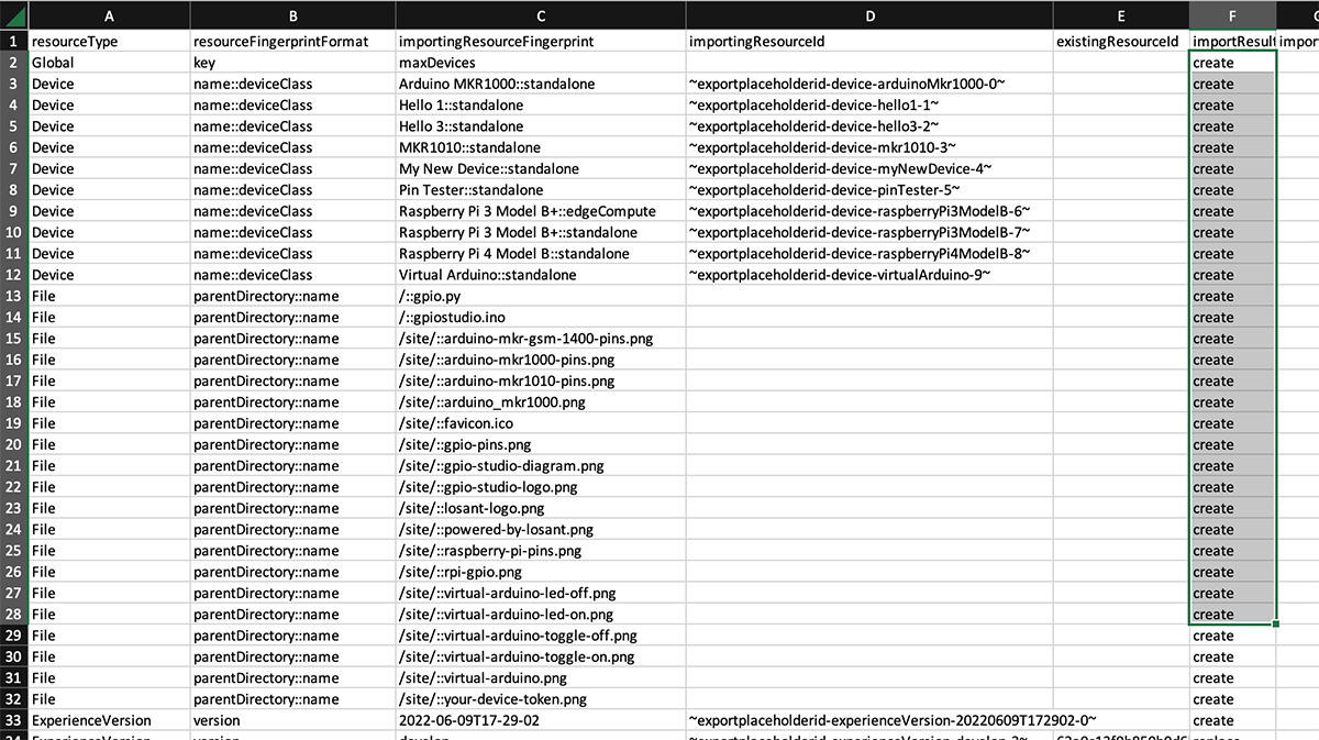

This CSV is important to review when performing a promotion. For example, below is a screenshot where the wrong application was imported.
Dry Run for Wrong Application Bundle
This CSV is reporting that several resources will be created, which is not the expected result. In most cases, we expect a relatively few number of new resources and a high number of identical ("no change" or "replace") resources. This report provides a quick confirmation that something is wrong and the import configuration should be reviewed.
