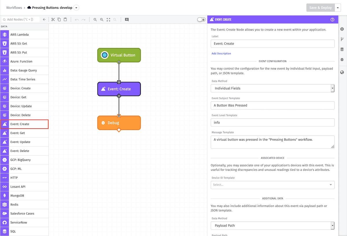

To use the Event: Create Node, you'll have to start by choosing how you wish to configure your new event. You can pick which of these options you want to use from the dropdown menu labeled "Data Method." There are three options:
  • Individual Fields: This option lets you input values for specific fields that can be filled in using individual string templates.
  • Payload Path: This option takes a path on the current payload that points to an event object and will be validated against the new Event schema.
  • JSON Template: This option takes a JSON template string that can be parsed into a JSON object that validates against the Events schema.
The Event: Create Node defaults to using the "Individual Fields" option because it is the most common and easiest to use, but "JSON Template" and "Payload Path" provide more control if needed for advanced solutions.
Event Configuration

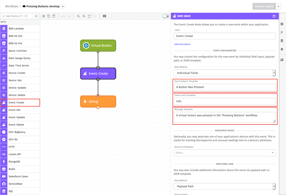

If you choose the "Individual Fields" option to create your event, you'll start by configuring the event itself. This section includes the following fields:
  • Event Subject Template: You'll need to provide a subject to include with your new event, which must be a valid string template. This field is required.
  • Event Level Template: Your new event also requires an event level, which can either be a valid string template or one of critical, error, warning, or info.
  • Event State Template: Optionally, provide a state to create the event in, which can either be a valid string template or one of new, acknowledged, or resolved. The event will default to new if no state is provided.
  • Message Template: You may optionally provide a JSON template string message to include as well. (Note: This cannot be changed after event creation.)

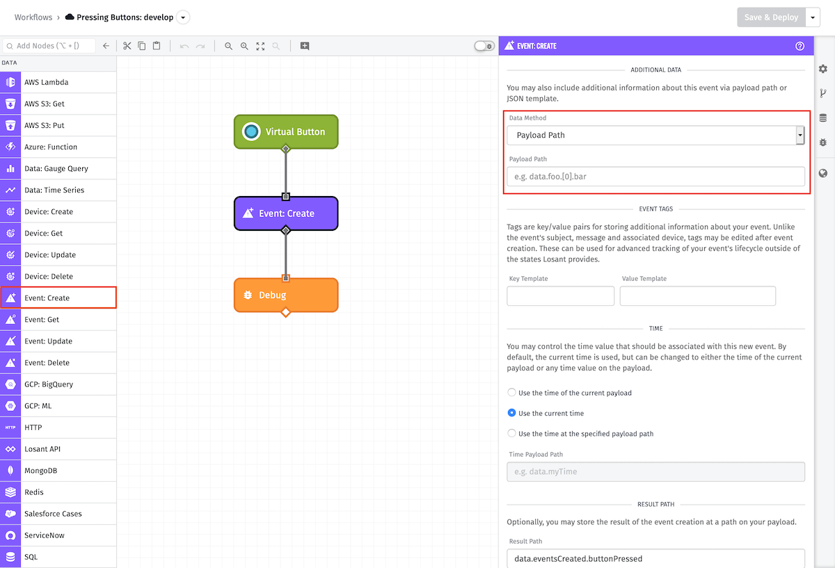

Additional Data
Your new event may also have additional data included with it.
  • Data Method: If you wish to provide any additional data with the event, you can choose how you'd like to provide it here.
  • Payload Path (only available with the "Payload Path" data method): Allows you to provide a valid payload path that points to an object on the current workflow payload.
  • JSON Template (only available with the "JSON Template" data method): Lets you create a valid JSON template string of data to use.
Note: Additional Data cannot be changed after event creation.

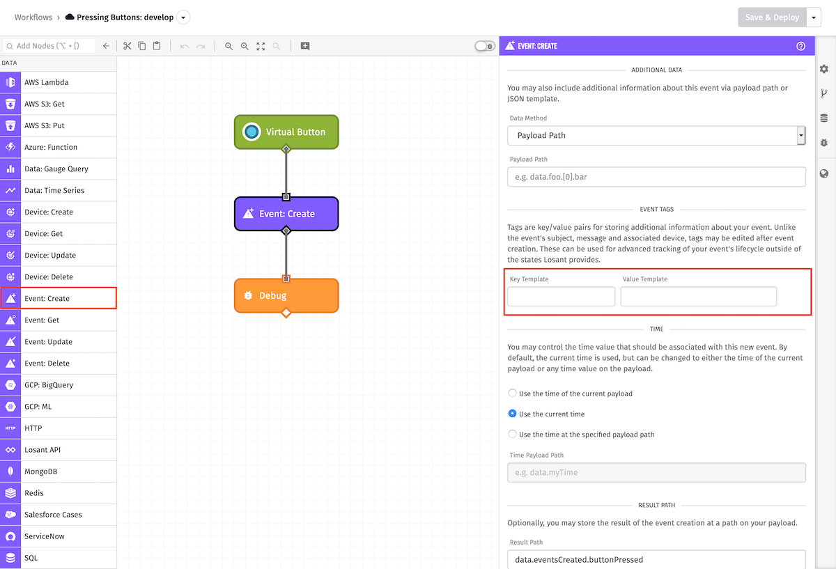

Event Tags
You may also include tags with your new event, which are key/value pairs for storing additional information. These can be used for advanced tracking of your event's lifecycle outside of the states Losant provides.
First, choose if the new event should Track changes to tags in event updates. If enabled, any changes to the event's tags will be tracked in the event's updates. This field is enabled by default; however, if your events go through several tag updates over time, you may wish to disable this option as events are limited to a maximum of 100 updates. (Note: This property cannot be changed after event creation.)
Each tag included must have both of the following:
  • Key Template: A valid string template to function as the object's key for the tag.
  • Value Template: A valid string template to function as the value of the key provided above.

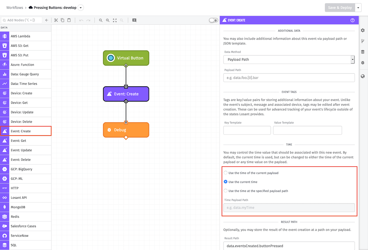

Time
Finally, you can choose what time to associate with your new event. There are three options:
  • Use the time of the current payload: Will use the value of the time key at the root of the current payload path.
  • Use the current time: Will use the current time. This is the default option.
  • Use the time at the specified payload path: Allows you to specify another location on the payload from which to grab time from.
If you choose "Use the time at the specified payload path", you'll also have to include:
  • Time Payload Path: Allows you to provide a valid payload path that points to a time on the current workflow payload.
The Event: Create Node will include the current time by default.
