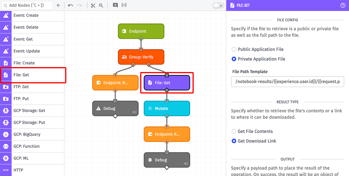

File: Get Node
The File: Get Node allows a workflow to retrieve an Application File, including its meta information and either its contents or a URL to download the contents.
File: Get Node
There are three main configuration sections for the File: Get Node ...
File Configuration
First, choose whether the node is retrieving a Public Application File (default) or a Private Application File.
Then, enter a File Path Template, which is a string template that resolves to the path of the file to retrieve (relative to the Application Files root directory). For example, to retrieve a file named report.pdf in a directory named documents, the File Path Template would be /documents/report.pdf.
Result Type
Next, choose what to place on the payload by selecting either Get File Contents or Get Download Link.
When selecting Get File Contents, you must also select a File Encoding. This determines how the file's raw binary data is converted into a string for placement on the payload. Options include: ASCII, UTF-8, UTF-16LE, Base64, Binary, Hex. The default is UTF-8.
Output
Finally, enter a Result Path, which is a payload path for where to store the result of the operation.
When selecting Private Application File in the file configuration and the Get Download Link result type, you may also provide a custom URL TTL Template. This is a string template that resolves to the number of seconds the generated URL will remain valid. If left blank, the default TTL of 900 seconds (15 minutes) will be used.
