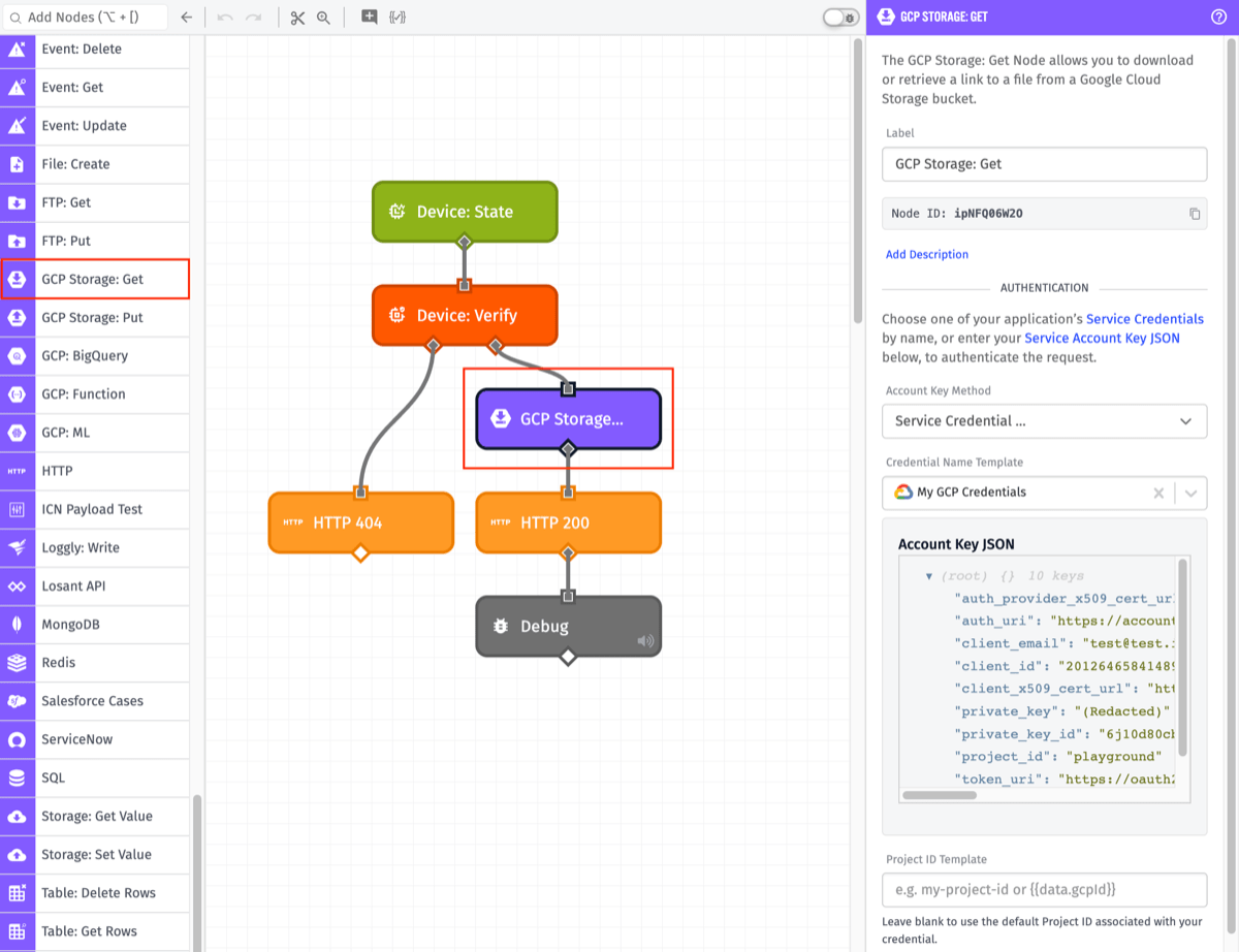

GCP Storage: Get Node
The GCP Storage: Get Node allows a workflow to download or retrieve a link to a file in a GCP Storage bucket.
There are four main configuration sections for the GCP Storage: Get Node ...

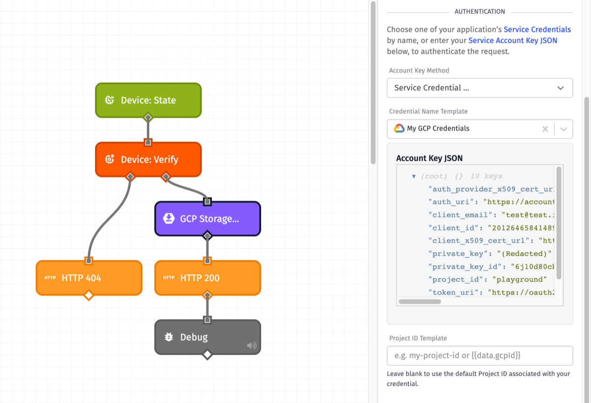

Authentication
First, we must enter our Google Cloud Storage credentials.
Note: We recommend that you create a service account key specifically for use in Losant workflows that has appropriate access to relevant storage buckets.
GCP Storage: Get Node Credentials
The next configuration field will depend on the Account Key Method selected.
  • If you selected Service Credential as your Account Key Method, Credential Name Template can either be a string template that references your Service Credential name or you can select a Service Credential you have created for your application.
  • If you selected Direct Input (JSON Template) as your Account Key Method, Account Key JSON Template can either be a string template that references your Google Service Account JSON Key or you may enter it in directly.
  • If you selected Direct Input (Payload Path) as your Account Key Method, Account Key Payload Path is a payload path that references a Google Service Account Key that has access to the bucket containing the requested file.
The third configuration field appears for all Account Key Methods.
  • Project ID Template: Can either be a string template that references your project ID or it can be left blank to use the default project ID associated with your credential. This option is available for all Account Key Methods. In Edge workflows, this option can only be defined for Gateway Edge Agent version v1.42.0 or above.

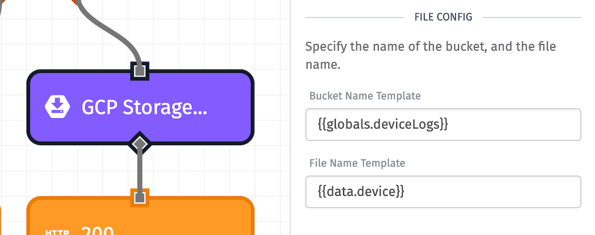

File Configuration
Next, we enter the basic details of the file we will be retrieving. All applicable fields are templatable.
GCP Storage: Get Node Config
  • Bucket Name: (Required) The name of the bucket containing the file to retrieve.
  • File Name: (Required) The name of the file to retrieve, including the extension. If the file is in a subdirectory within the bucket, the path to the file should be included in this field. (e.g. "path/to/my/file.ext")

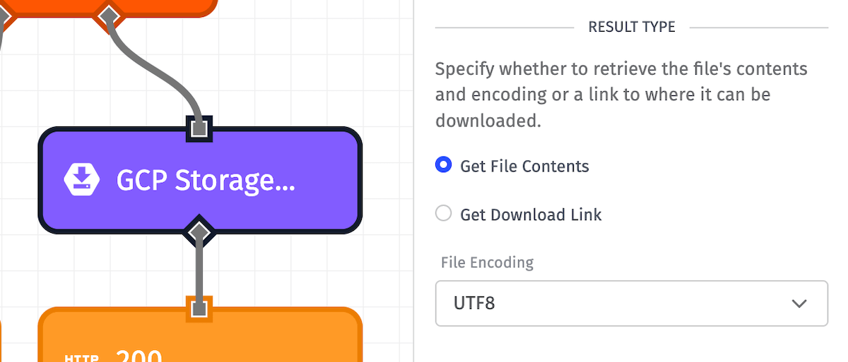

Result Type
Next, choose what to return from the file request. Options are the following ...
  • Get File Contents: (Default) If selected, the file contents will be placed on the payload under the result path defined below. Files retrieved by this method have a maximum size of 5MB.
  • Get Download Link: If selected, a pre-signed URL to download the file will be placed on the payload under the result path defined below. This option is useful for larger files, as it does not have a size limitation. (Note: Download links retrieved this way will expire after 7 days.)
  • Local File Path Template: In edge workflows running GEA version 2.1.0 and higher, you can save the retrieved file to the edge device's file system. If selected, specify a path to where the file should be saved within the agent's Docker container. The field supports string templates.
When selecting the Get File Contents or Local File Path Template options, you must also specify a File Encoding. Default is UTF-8.

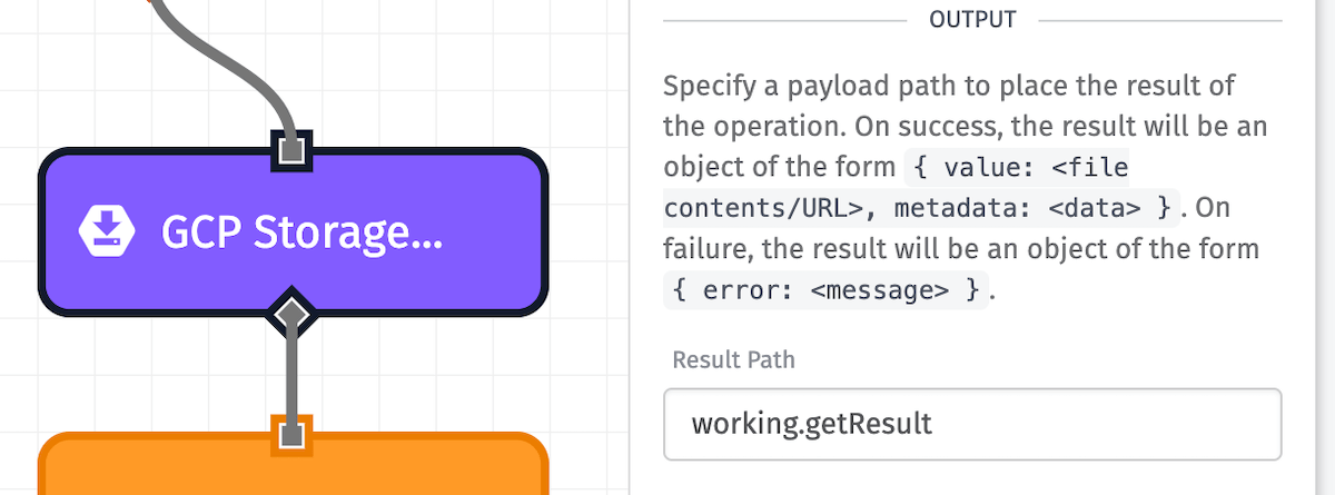

Output
Finally, provide a Result Path as a payload path for where the result of the operation will be placed. This value is required.
When the operation successfully executes, the result will contain two keys: the value (whose contents depend on the selected result type as described in the examples), and some metadata about the file. When the operation encounters an error, the result will contain a single error key.
