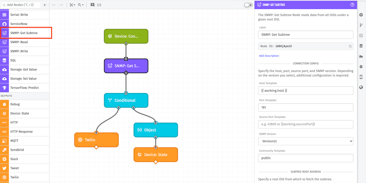

The SNMP: Get Subtree Node allows you to read values from multiple OIDs on your SNMP device. This node is available in edge workflows.
SNMP: Get Subtree Node Configuration
There are three categories to the configuration for the SNMP: Get Subtree Node: the connection, the subtree root address, and the result.

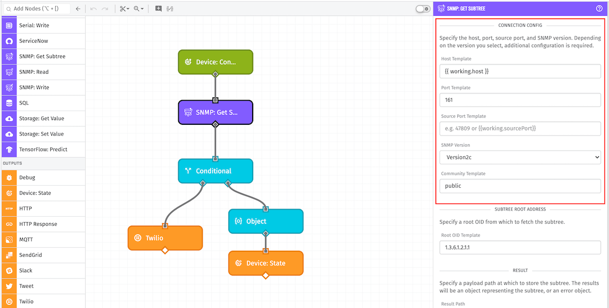

Connection Configuration
SNMP: Get Subtree Session Configuration
First, configure the information to establish a connection to the device.
  • Host Template: (Required) A string template for the destination address. This can be either an IPv4 or IPv6 address, or a hostname that resolves to an address.
  • Port Template: (Optional) A string template or integer for the UDP port at the target address. Default is port 161.
  • Source Port Template: (Optional) A string template or integer for the UDP port from which the message should be sent on the edge device. If not provided, a random port is selected at runtime.
  • SNMP Version: (Required) The version of SNMP with which to establish a connection. Options are Version1, Version2c, or Version3. Defaults to Version2c.
Depending on the version selected, additional input is required.
Version1 and Version2c Configuration
  • Community Template: (Required) A string template for the community credential delivered with the request. Defaults to public.

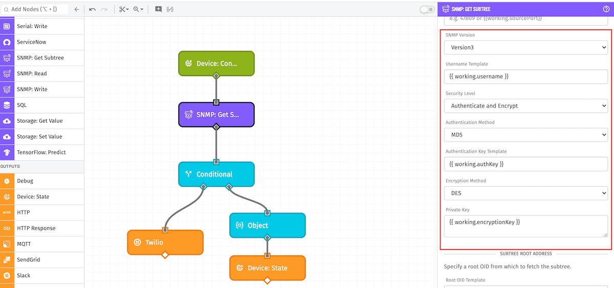

Version3 Configuration
SNMP: Get Subtree Version 3 Configuration
  • Username Template: (Required) A string template for the username.
  • Security Level: (Required) The amount of security to use when establishing the SNMP connection. Options are No Authentication or Encryption, Authenticate, No Encryption, and Authenticate and Encrypt.
  • Authentication Method: The protocol to use for authentication. Required if the selected security level requires authentication. Options are SHA or MD5. Defaults to SHA.
  • Authentication Key: A string template for the authentication key. Required if the selected security level requires authentication.
  • Encryption Method: The method to use to encrypt the requested data. Options are DES or AES. Defaults to DES. Required if the selected security level requires encryption.
  • Private Key: A string template for the key to use when encrypting the requested data. Required if the selected security level requires encryption.

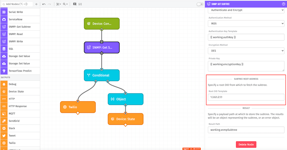

Subtree Root Address
SNMP: Get Subtree Root OID Configuration
Next, indicate the Root OID under which to search. The Subtree Root Address is a templatable field representing the prefix for all OIDs to be returned. This should be a valid OID template of integers separated by periods.

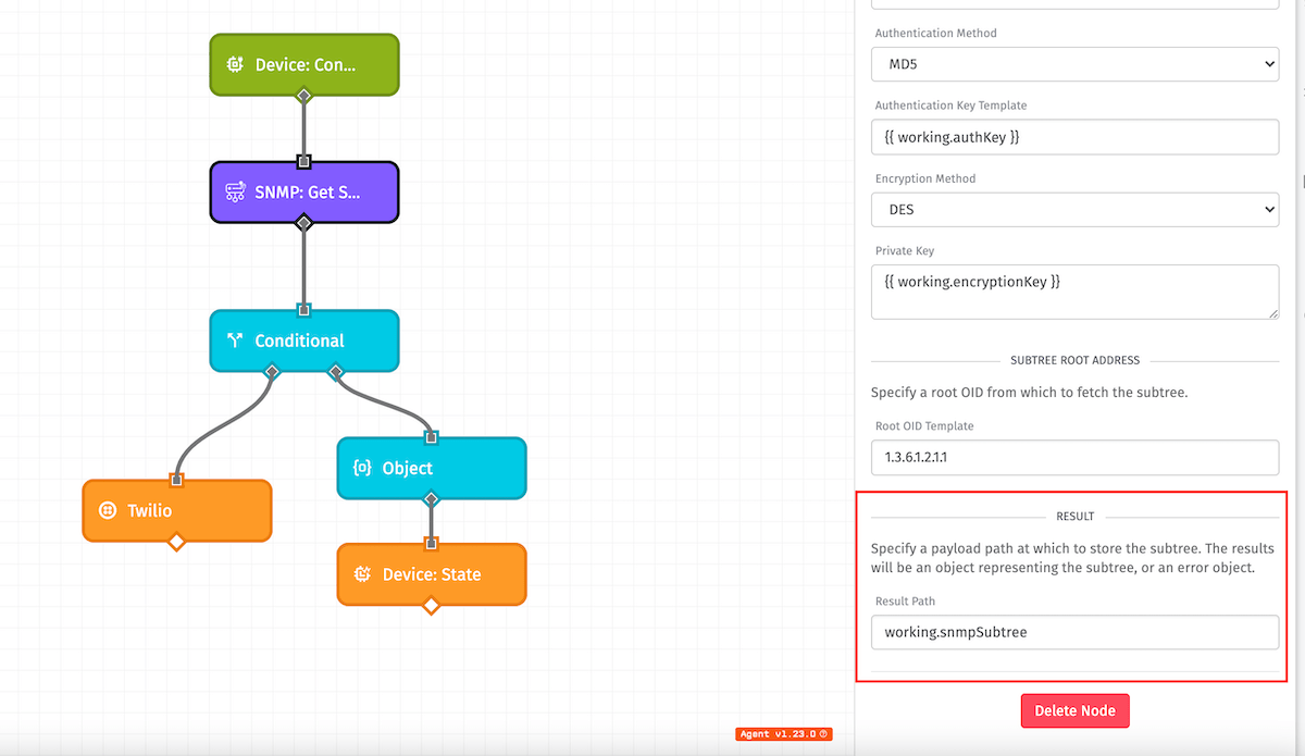

Result
SNMP: Get Subtree Result
The result path defines where on the payload to store the result of the subtree read. If values are successfully read, this represents an object with key-value pairs representing each OID and associated value. If there are any errors, the result includes an object with details about the error.
