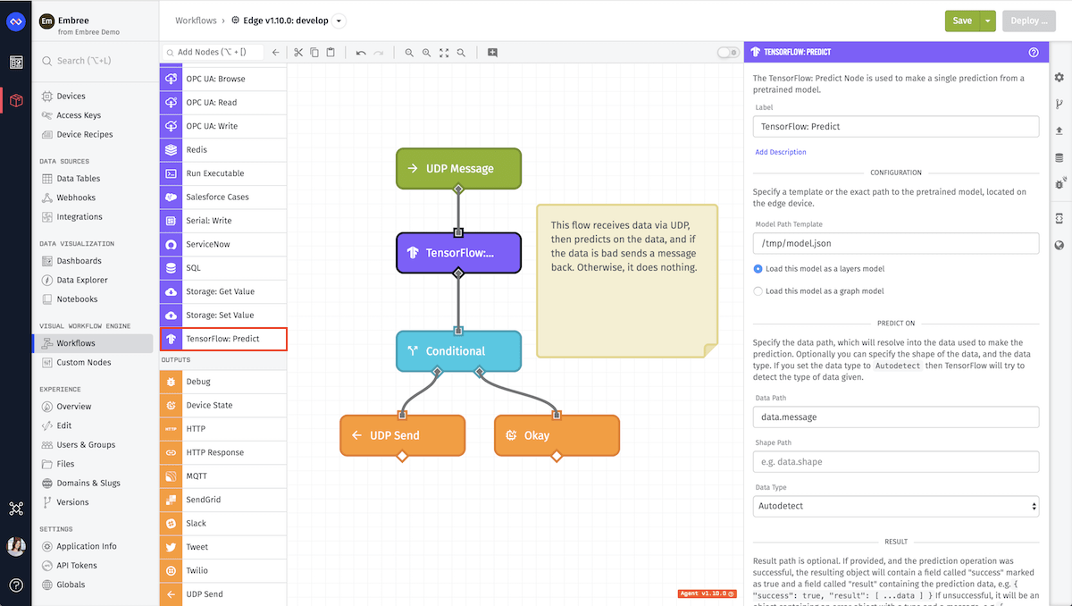

TensorFlow: Predict Node
The TensorFlow: Predict Node allows you to predict data on a pretrained TensorFlow model that has been loaded onto your edge device running Losant's Gateway Edge Agent. The TensorFlow: Predict Node can load graph or layers models and predict on either of them.
TensorFlow Predict Node
Node Usage
This node can only load TensorFlow.js models. If you have a TensorFlow Python model, you can use a converter to turn it into the proper TensorFlow.js format.

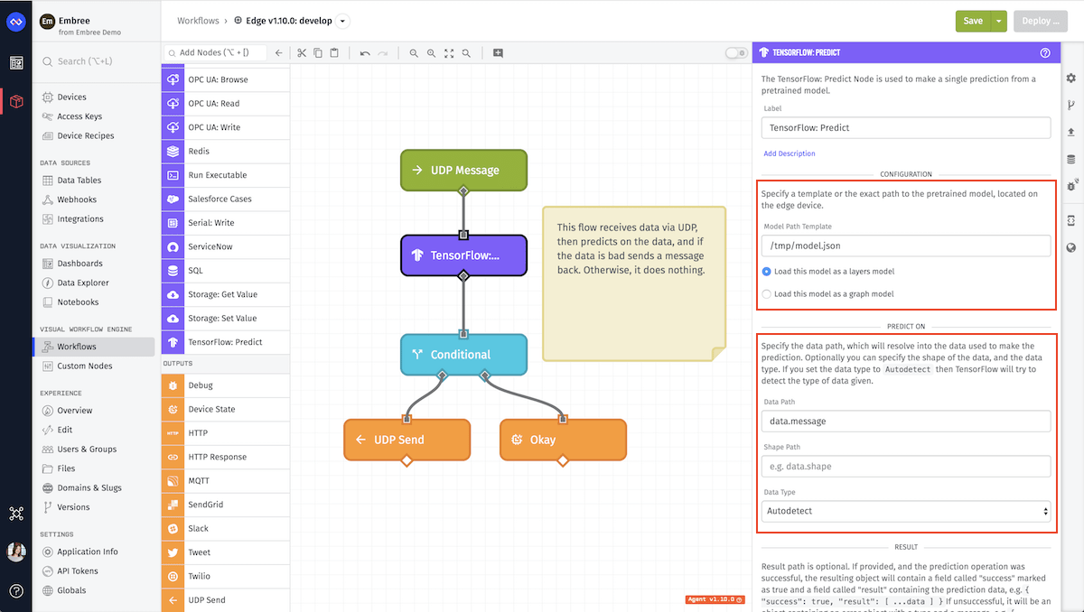

There are six pieces of configuration for this node.
TensorFlow Predict Node Configuration
First, specify a template or the exact path to the pretrained model, located on the edge device.
  • Model Path Template: (Required) This is the path to the model file that is on the edge device. This path should include the model file e.g. /tmp/model.json. The weights file should be put in the same directory, and will automatically be found by TensorFlow itself.
  • Load Model as a layers model: (Default) By default this box is checked. This will interpret the model path as a layers model path using the tf.loadLayerModel method to load the model and it's weights.bin file.
  • Load Model as a graph model: If this is checked instead of the Load Model as a layers model, then the model path will be loaded as a graph model using the tf.loadGraphModel method.
Predict On
Next, specify the data path, which will resolve into the data used to make the prediction.
  • Data Path: (Required) The path to the nested array of data (tensor) to predict on.
  • Shape Path: (Optional) The shape of the tensor (data path) given, if left blank it will be inferred by the array at the data path.
  • Data Type: (Optional) This is the data type of the tensor, by default this is set to Autodetect which means it will be inferred by the tensor at the data path. The following at valid data types: Autodetect, Float 32, Integer 32, Boolean, String.

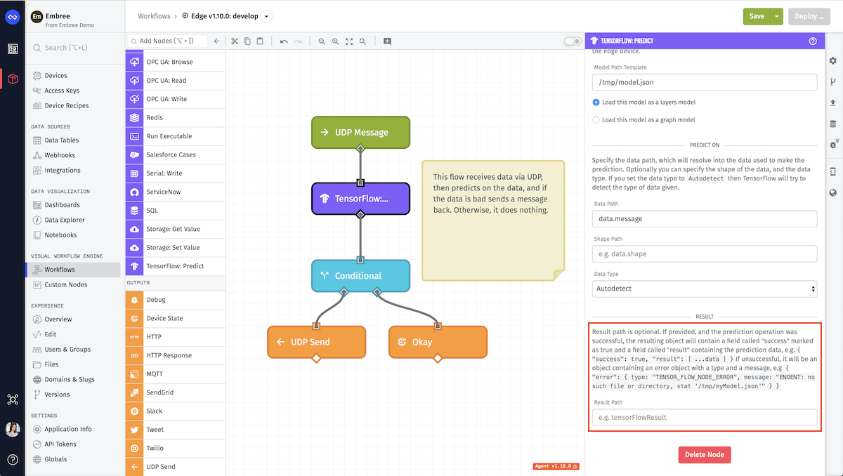

Result path is optional. If provided, and the prediction operation was successful, the resulting object will contain a field called success marked as true and a field called result containing the prediction data. If an error was returned from TensorFlow the result will be an object with an error field which will contain a type and message of the error.
TensorFlow Predict Node Result
The following is an example of a successful prediction, where the user set the result path to prediction:
"prediction": {
"successful": true,
"result": [
0.928,
0.072,
0.928,
0.072
This following is an example of a prediction failure if the path given was not found, where the user set the result path to prediction:
"prediction": {
"type": "TENSOR_FLOW_NODE_ERROR",
"message": "ENOENT: no such file or directory, stat '/tmp/model.json'"
