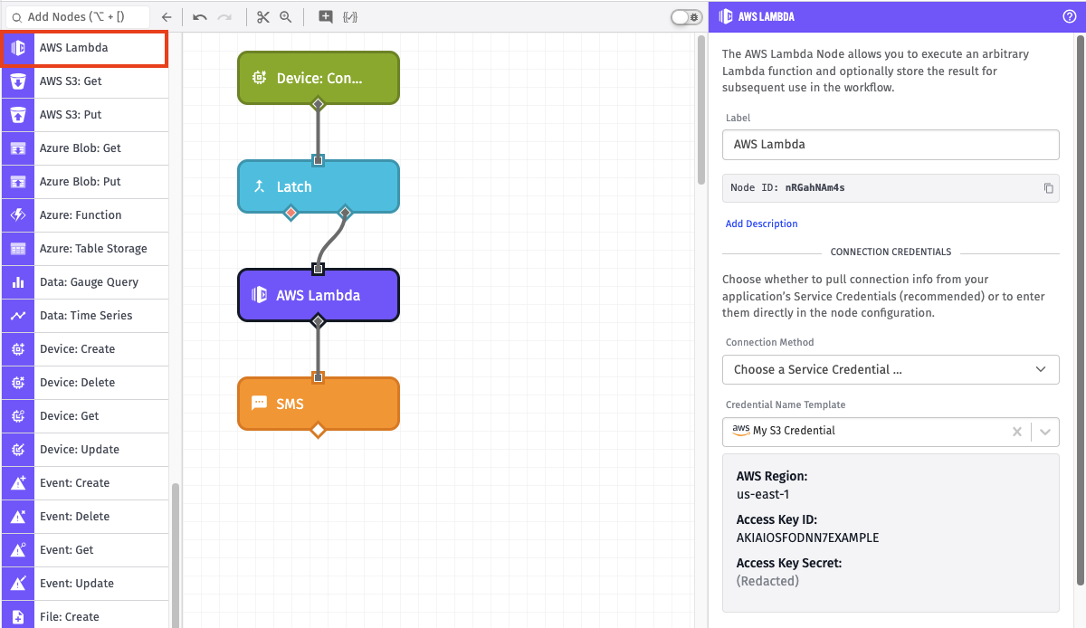

AWS Lambda Node
The AWS: Lambda Node allows a workflow to run an AWS Lambda function and optionally store the returned value from the function in the payload.
AWS Lambda Node
There are four sections of node properties for the AWS Lambda node: AWS Config, Lambda Config, Output, and Error.

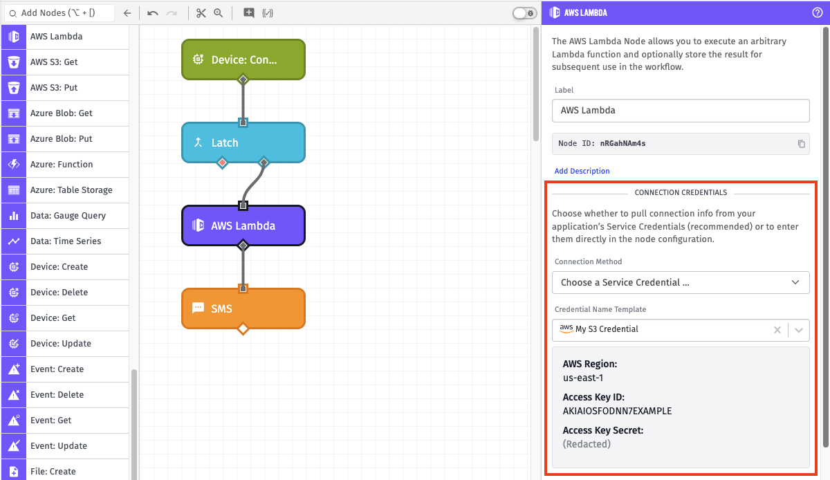

AWS Lambda Node Credentials
There are two options for configuring credentials:
  • Choose a Service Credential: Retrieves your AWS credentials from the selected service credential.
    • Credential Name Template: Choose which of your application's AWS service credentials you would like to use. Note: Service credentials are not accessible from Edge Workflows, so only direct configuration is available for them.
  • Enter Connection Info: Configure the AWS credentials directly within the node. All fields are required.
    • AWS Region Template: The AWS region to connect to.
    • AWS Access Key ID Template: The AWS access key ID associated with the AWS account you wish to use. This field is templatable.
    • AWS Secret Access Key Template: The AWS secret access key associated with the AWS account you wish to use. This field is templatable.
We recommend that you create an AWS Key/Secret pair specifically for use for our workflow nodes - one that only has access to your AWS Lambda functions. We also recommend that you store these values as service credentials.

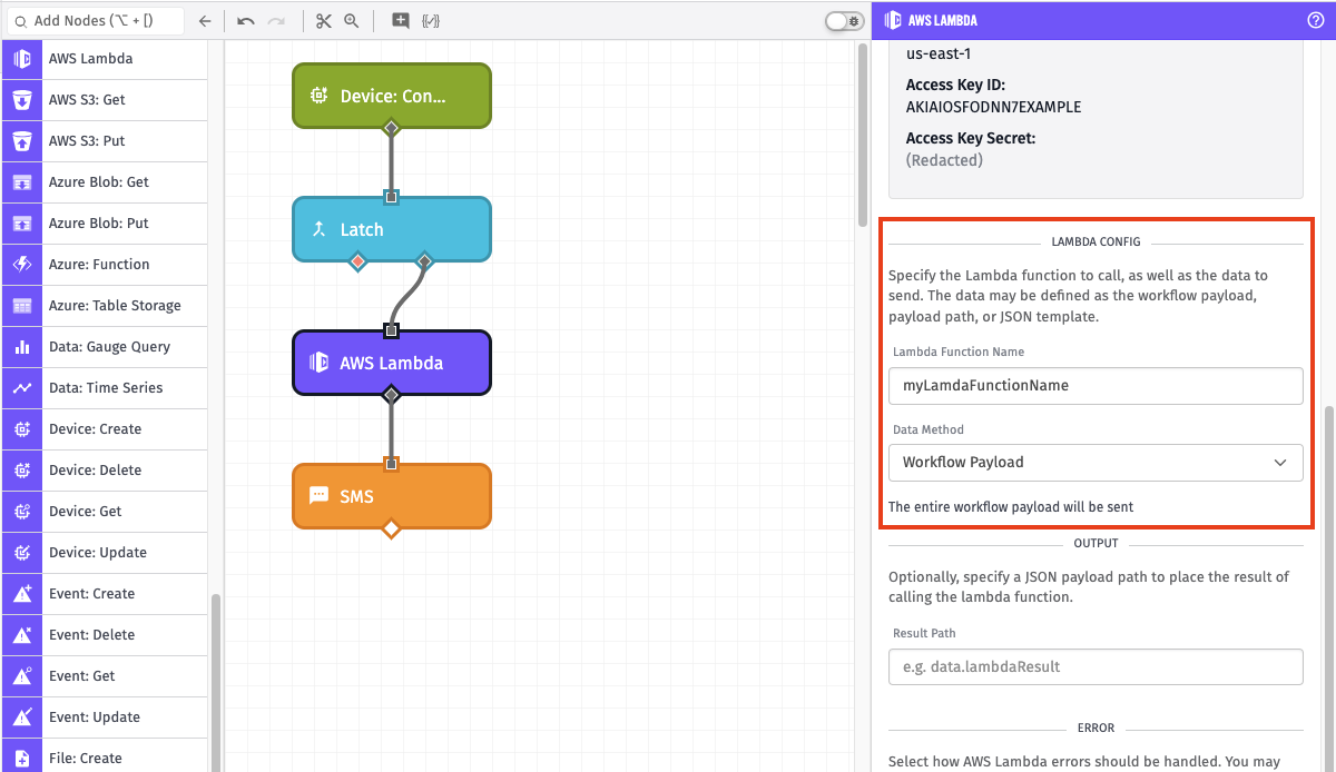

Next, define the function to execute and the data to provide as its argument ...
  • Lambda Function Name: The name of the function to execute. This must match the name of a function that's available to the credentials provided above. The function name accepts string templates.
  • Data Method: The data to provide to the function. Options are ...
    • Workflow Payload: When selected, the entire current workflow payload is sent as the data to the Lambda call.
    • Payload Path: When selected, you must provide a payload path, and the value at that path on the current payload is sent as the data to the Lambda call.
    • JSON Template: When selected, you must provide a JSON template, and the result of that template is sent as the data to the Lambda call.
  • Timeout Template: The length of time, in milliseconds, to wait before timing out the execution. For Edge Workflows, this defaults to the value of the MAX_EXTERNAL_CALL_TIME environment variable, and the Timeout Template option can only be set on the Lambda Node in GEA version 1.47.0 or higher. For all other workflows, this defaults to 30000 (30 seconds).
In the example above, Workflow Payload is selected, so the entire current payload will be handed to the myLambdaFunctionName call.

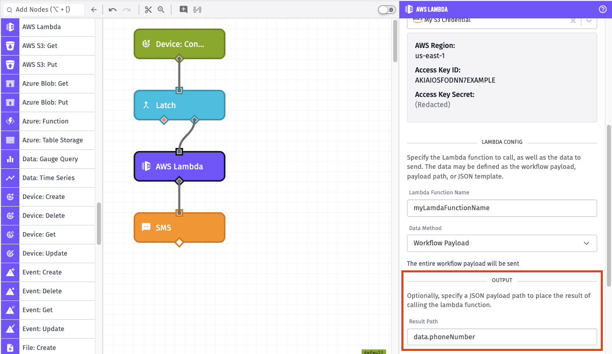

Output Configuration
AWS Lambda Node Output
If the Lambda function that is being called returns a result, it can optionally be stored for later use in the workflow. In the example above, the result will be stored at the payload path data.phoneNumber on the current payload.
